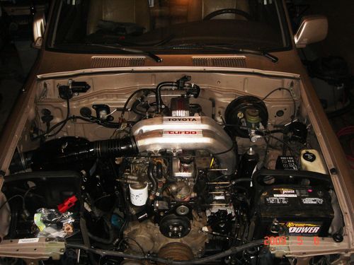

Yup...GG got it right...the A440 bolted right up to the 12H-T using the 12H-T bell housing and torque converter. Future upgrades being considered are extreme valve body and the lock-up torque converter from Oz.
Ross...spent the whole day there today and got the wiring pretty much done and buttoned up. Just have to wire in the Redarc Smart Start isolator and the manual glow.
I'm a bit confused how the two terminals work with the glow screen using 12V...if anyone's done this before and can give some guidance that would be greatly appreciated...otherwise I'm sure we'll figure it out soon enough. I'm just going to use a HD solenoid with a push button switch and manually glow my engine instead of trying to fool around and retrofit a glow timer.
The project is just about done...planning on firing her up for the first time on the weekend...that's if a couple of parts arrive from Japan in time.
Pics from today...
And...........BLING, BLING!!! :D :D :D
Oh yeah...I probably won't have AC for a little while...the compressor sits on the opposite side of the engine on the 12H-T, and it's going to be a major PITA and $$$ to probably get the custom pipes together along with sourcing the right 12V stator coil.

For the AC problem I think I'm going to use Skip's in Aldergrove. Ciaran has used him in the past with customer's rigs, and he says they can handle the custom stuff. I will need new hard lines fabricated to go to the compressor that now sits on the driver's side of the engine.
My rad will need a bit more custom tweaking. Sheldon and I installed the rad yesterday, and found that the bottom outlet point right to the PS pulley and there's no way we can get a hose to it without hitting the pulley. I'm going to try to get them to install a 90* elbow on that outlet pointing upwards. The trans oil cooling fitting will also need a fitting pointing downwards a bit.
Also asked Ciaran what he's done with past diesel swaps about the glow screen, and after speaking with him I've decided to power both terminals with 12V. Essentially the screens are going to be hooked up in parallel. I bought a Cole Hersee constant duty 12V 85A solenoid, and it's going to be fused with a 40A Maxi fuse...I think that should be enough. Sheldon gave me a great idea of changing the film on my dashboard to an HDJ81 film and hook up my manual glow so that when I hit the switch, the light in my cluster lights up with the glow symbol on it. :)
Jay had a similar problem swapping a 2H into his 40 series. He had the bottom outlet re-located to avoid the PS pump. Here's his transplant thread.

Interesting, Tapage...I think I might have the problem solved. I dropped off my rad today and they said it would be no problem to install a 90* elbow pointing up. I also left them my shroud to make sure the fitting can clear it. I'll just get a generic lower rad hose afterwards.

Putting in the finalized rad on Saturday, and completing some more wiring stuff. Then the cores will get a good flushing before I hook up the new rad and flush the whole system and fill with Toyota red. Rest of the fluids go in and then maybe flash her up. Hopefully my fuel water separator arrives in time for me to install it prior to filling up the tank with diesel.
