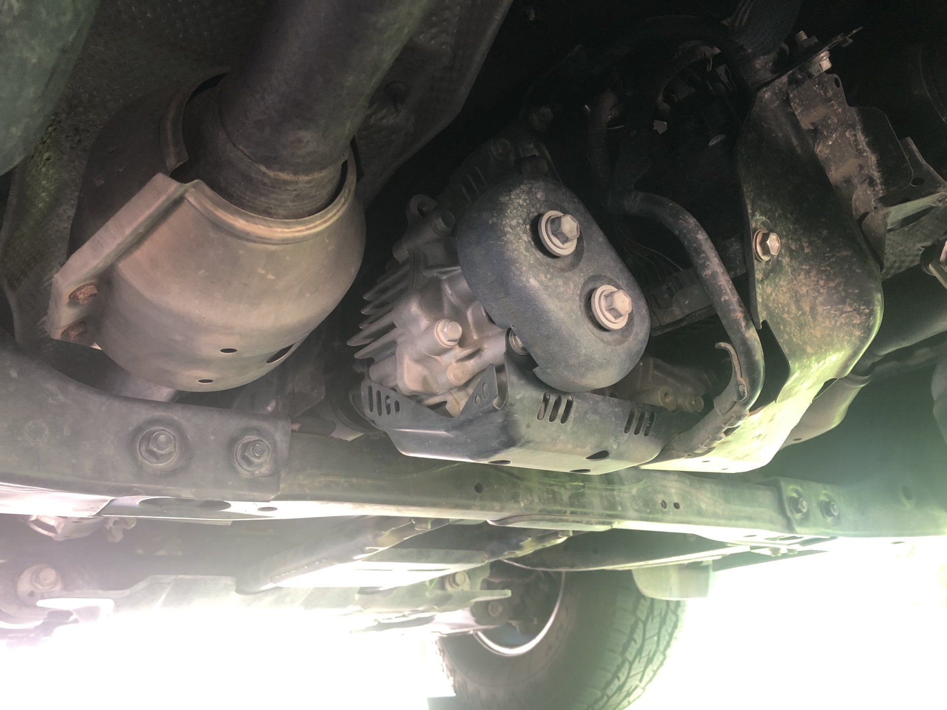

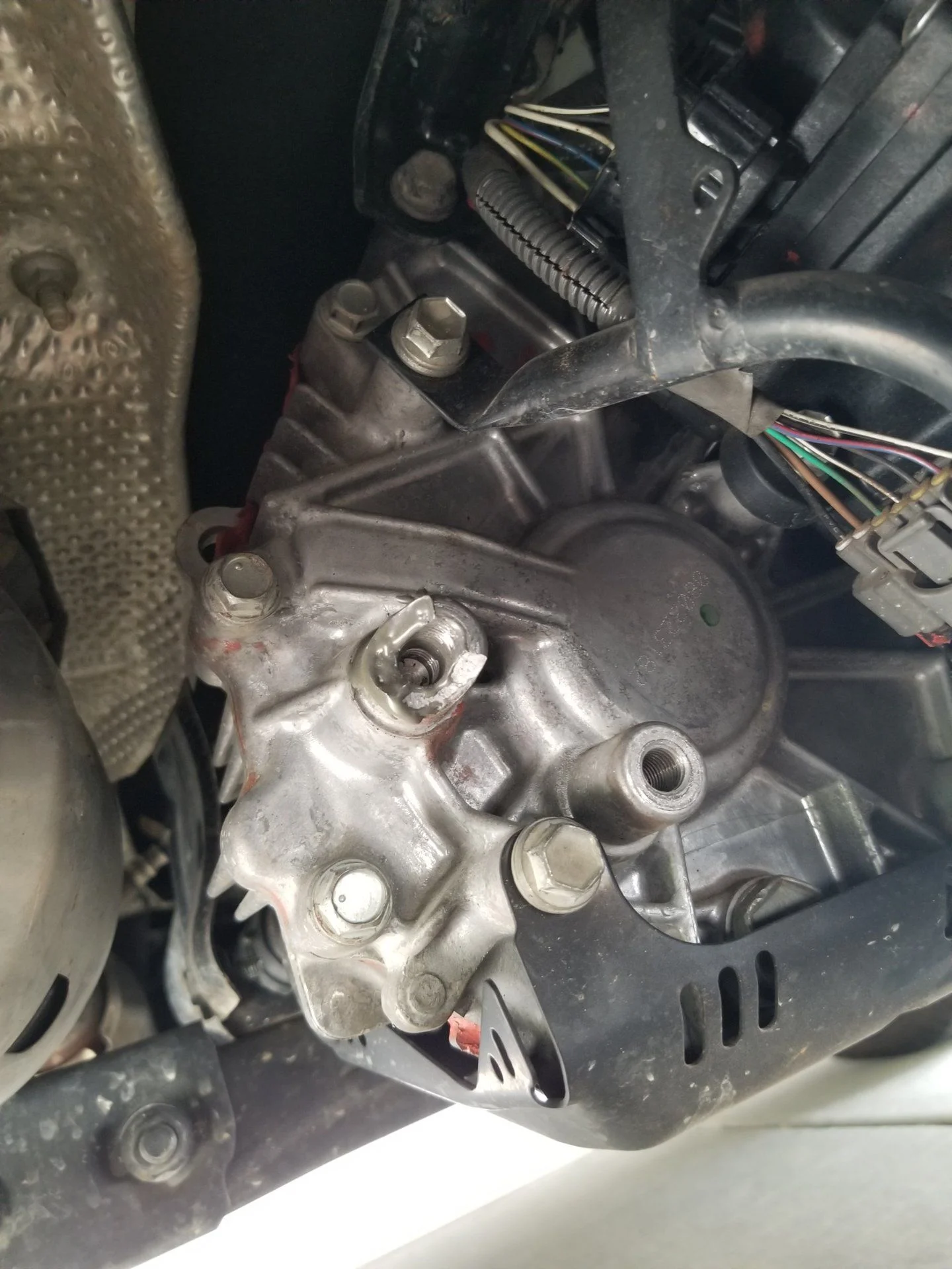

Edit: NEVERMIND found this thread: Warning light illuminates when center diff is locked. wherein I learned solid warning light is 100% normal/expected. Still, the case damage is a bit disconcerting, but I guess everything is fine. Still a mystery what the heck was done for $3000 so I'll leave the original post intact. Pics are cool.
Tried the switch yesterday sitting idle, in P, and I get the yellow exclamation mark, stays lit, I have not tried to drive at all because dry pavement. I also noticed on one of the invoices for the rear end "fender bender" a sublet from the body shop (they sent it out) to r&r the "4x4 accumulator". For . . . wait for it . . . $3000. Not a typo. The transfer case housing is damaged and for sure looks like someone has been in there.
1996737
hard to see but some red sealant showing between the case halves. Beyond that truck is pristine underneath, got to love southern garaged cars. Hoping this isn't a major repair, we will see . . .
View attachment 1996737View attachment 1996738

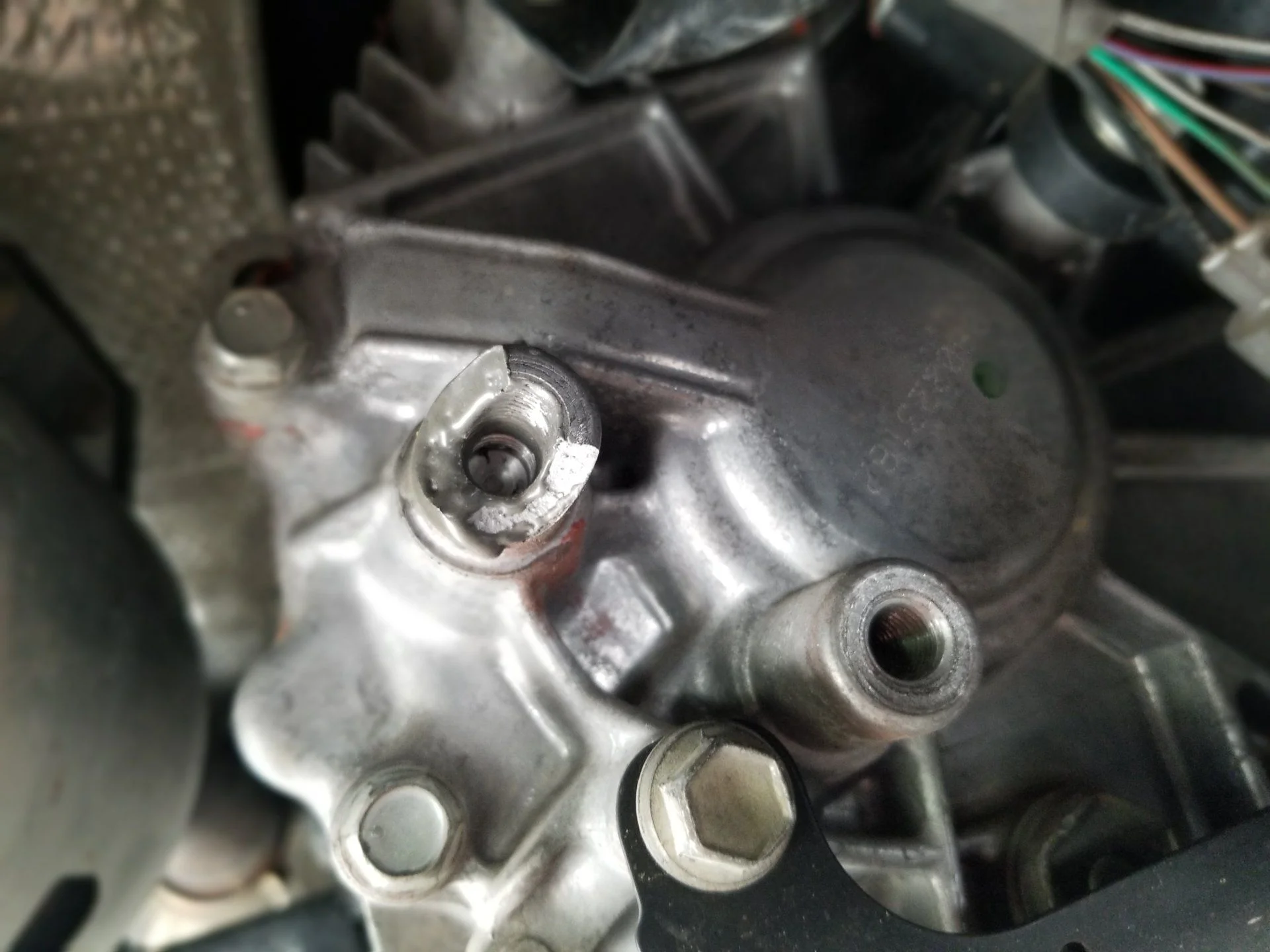

Was under my truck today and got a pic of a healthy transfer case. The broken boss is just for some kind of vibration damper. Not sure how it would have been damaged other than maybe driving the truck off a ledge or a car going under it or something. The good thing is that it shouldn’t impact the operation of the case at all.
As for the rtv.. Same color as my 2013. Yours looks a lot more haphazard in its application though.
I wouldn’t give up on your case just yet. Look on this board for CDL troubleshooting... I don’t have much experience with it.. but do recall some people with initial problems getting it all working without major repairs.
@bloc thanks very much for the reference pic. Now I'm really wondering how critical that dampener is, they put it on there for a reason. Crap, really going to bother me, have to address it, got the has to be done right curse. Will be calling this body shop that charged $3000 for the sublet repair Monday. Inexcusable hackery.
Personally I wouldn’t worry about it. In all likelihood just there to address some tiny frequency some NVH engineer found.
Pretty sure that vibration dampener bolts on with like 9lbs of torque, so they probably just overtightened it with a gun and broke the mount.
Yes, 9ft-lb in my FSM. Probably exactly what you describe.. M10 bolts usually go much higher than that so the mechanic likely messed it up going by "feel".
