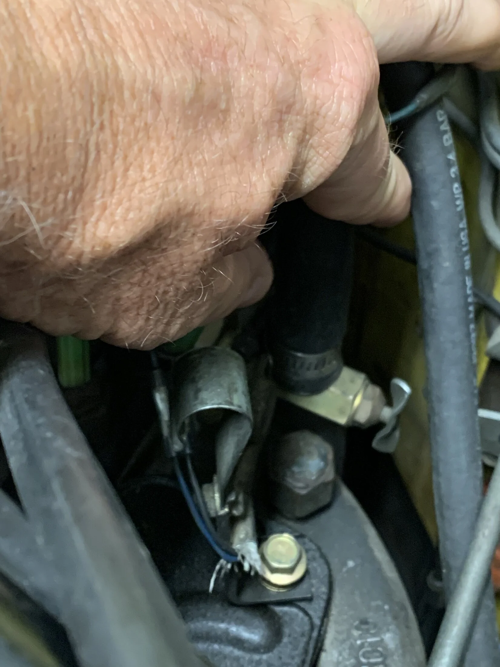

You should be able to disconnect the cable from the firewall valve and operate it by hand to see if it moves. The older cowl vents work great, but the later style fresh air vent that comes thru the top of the heater box, not so much.
Matt this is the riser valve I was talking about, I shut mine off about a month or so ago and will open it in the fall when it get cold again. Sits right there next to the carb linkage
Thanks Kelly, yep, I have one too. I am afraid to mess with it too much because it's "frail". It has the threaded stem but doesn't have the "butterfly" wing nut at the top.
I am looking at a couple ball valve options.
On mine the stem is really long. You could just grab the end with a small vice grip pliers and rotate it open/closed. I have one of those cable toyota valves I salvaged off the next door neighbors corolla he was scrapping. I like the idea of a ball valve.
Home Despot 1/2 or 3/4 Everbilt 3/4 in. SWT x 3/4 in. SWT Full Port Lead Free Brass Ball Valve 116-4-34-EB - The Home Depot - https://www.homedepot.com/p/Everbilt-3-4-in-SWT-x-3-4-in-SWT-Full-Port-Lead-Free-Brass-Ball-Valve-116-4-34-EB/205816135 Low temp silver solder your conversion fitting to the valve
Vintage TEQ carries the shut off version that Kelly referenced above. It’s a tad spendy so BP for sticker shock.
