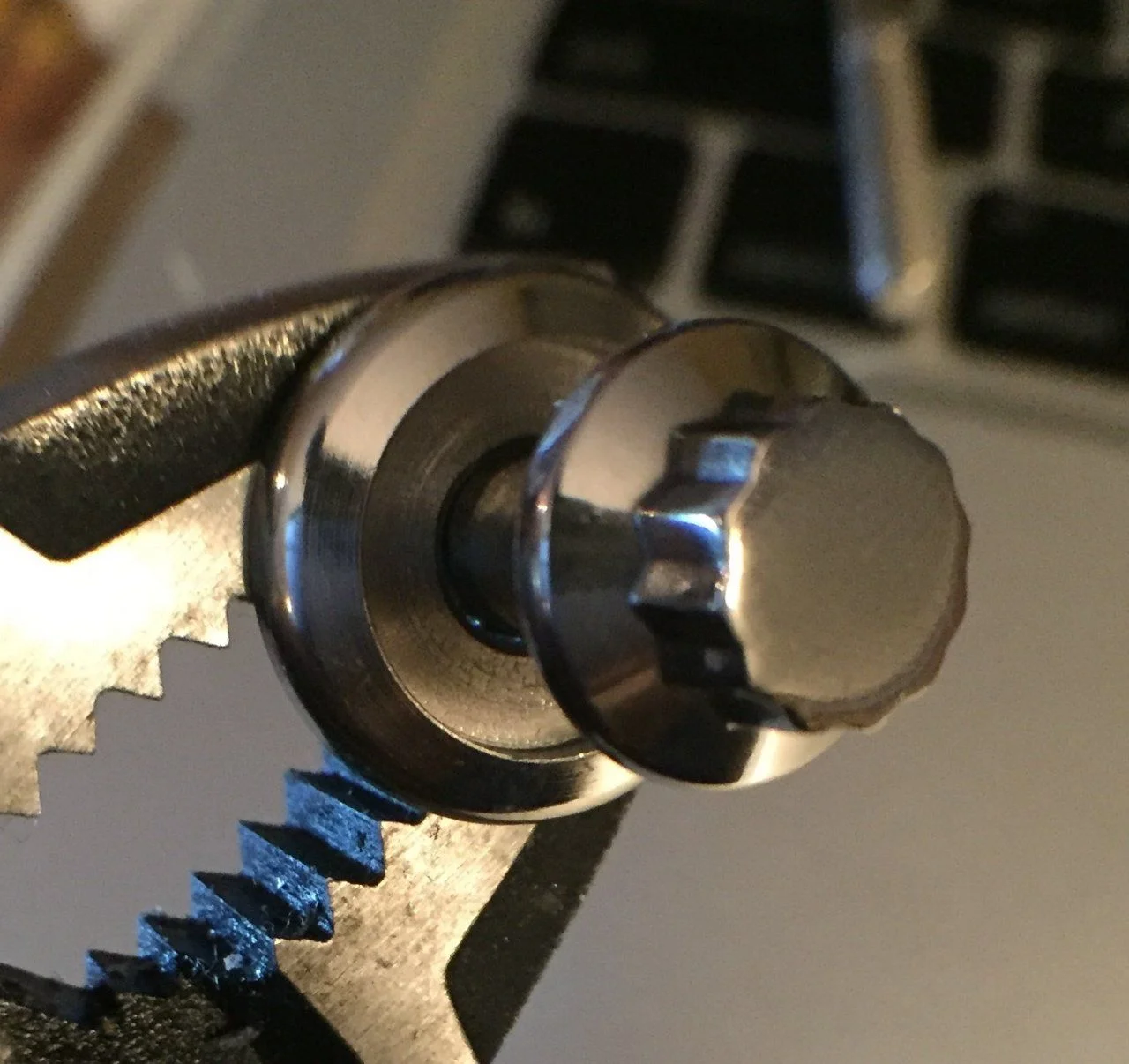

Porn Bolts,
12 Point hand polished stainless flange bolts and countersunk washers. Guess what I'm using them for
Flares - but stainless?
We have a winner! 12 point stainless steel polished flange bolts with countersunk washers for the pocket flares from Diamond Engineering out of FL
