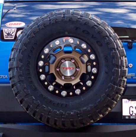

My two cents, for what it's worth, regarding bead lockers.
They're unnecessary for the platform, considering that a road worthy tire isn't capable of benefitting off road with pressures low enough for bead breaking.
I went the bead locker route on the FJC, primarily to stiffen the outer rim, protect the valve stem (which I have had dislodge numerous times) and to allow for trail repairs.
I regret. The only balance method that's proven effective are air soft pellets, therefore a simple tire repair is a mess. Mine are heavy (the OMF TRDs are 28lbs, if memory serves. Doable) and are a constant maintenance headache.
Regardless, if you're considering the faux locks, they do address the outer edge stiffening and stem protection. A well respected "buddy" has ran on an FJC out west, without issue.
The only issue I'd have with faux locks is the admission every time someone asks if they're real. Hahaha.
Thanks for the advise guys .... I do not need the headache of a true bead lock so would go for the faux and just tell a little white lie if anyone asked if they are real..... Hahaha.... I love the look . Will most likely powder coat the ring that comes with the wheels unless OMF will do a simple bolt on ring.... I fear they'll laugh me off the phone if I ask :)
Lou
Sent from my iPad using IH8MUD
Haha that last post was written from my phone driving to work, funny to read all the typo's. Anyways, I think it is a good idea going with a faux beadlock. Like I said a lot of places won't even mess with real bead locks so tire changes or repairs become a hassle. Like Delancy said, the way to balance a bead lock is with pellets, I used ceramic pellets on my 55 and they ballanced pretty well but again a pain for any kind of tire work.
I do like the look though looks great! What color are you powder coating?
Thanks for the advise guys .... I do not need the headache of a true bead lock so would go for the faux and just tell a little white lie if anyone asked if they are real..... Hahaha.... I love the look . Will most likely powder coat the ring the comes with the wheels unless OMF will do a simple bolt on ring.... I fear they'll laugh me off the phone if I ask :)
Lou
I'm the typo king so I understand .... Most likely black.... unless OMF offers a bolt on ring .... Than I'd duplicate this setup
The lip of the rim machines flat and the ring bolts to the wheel in similar fashion to a true bead locker, except it doesn't pinch the bead.
Machining the lip down was a concern of mine initially, but the ring itself adds strength, in theory, which was the primary reason for consideration, since the OEs were prone to bending off road.
I was headed this same direction on the FJC but wasn't capable of achieving the 4.0" BS needed without spacers on the front (added cost) plus the conversion by OMF isn't "cheap", and no local resources were deemed acceptable. long term cost (as if they matter, right?) the lighter wheel would be much more effective, considering fuel and wear.
If going faux and not off road, I'd balance conventionally. The reason I went with airsofts was the tires chunked in the rocks, therefore the drive home was miserable and had to rebalance after most trips out. Dynamic balancing compensates for, but if you're primary purpose is on road it's not worth the hassle of.
If you opt for dynamic balancing, don't buy into the online guides. You can't have too much, and when I replace the tires on mine, adding a total of 16-20ozs of airsofts in each wheel, as opposed to the 12ozs now.
For that matter, may add ten golf balls a wheel.

And lastly the only other concern I would have is double check that the TRD wheels are forged and not cast, some of them are and some of them aren't. If you are trading the stock forged wheels for cast TRD wheels it is kind of a downgrade in terms of quality....
