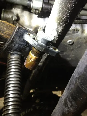

I finally got tired of smelling oil every time I got out of the Cruiser.... Last time it was on a lift I noticed oil leaking from the area of the rear main and finally brought it in to have it replaced. I placed a call to Onur for the part numbers of everything I needed. I ordered the Rear Main. input Seal, Dip Stick O Ring. Oil level Sensor seal , oil drain plug seal and a couple tubes of FIPG silicone gasket.
This is one time that the benefits of working for a dealership paid off.... employee rate is $45 an hour... There's one tech that does all the heavy work so I gave him my Cruiser and he buttoned it up... We did find that the crank position sensor was also leaking bad and that
Crank position Sensor seal cannot be ordered ..... there's no part number for it... Onur suggested putting a slightly small seal on top of the seal ....a little FIPG and torque it down good. We also sealed the oil pan and rear arch area ..... The cruiser is dry and tight

Onur... thanks again for the parts list and guidance... without it , I would have just ordered the rear seal... I can build just about anything but this job was way above my pay grade and I don't have a lift... Our normal hourly rate is over $100..it might be as high as $120 haven't checked lately..so this was a $600 and change job I was happy to pay for.
