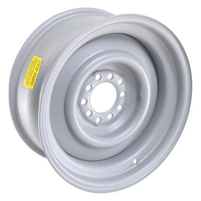

Wanted to add my wheels to the list here to show figment when flexed out a bit. 16x7 vintiques with 255/85's. Stock bump stops on my bj46.
Rear:
Still a ways to go on the bump stop but this is as far as I can get it without adding weight to the rear (1/2 ton springs)
So the rears could use about another 1/2" to keep from rubbing but I'm not sure if that would push them far enough out to hit the outer fender. In. My case a 3/4" or so addition to the bump stop is necessary.
The fronts just squeak by at full bump. The bolt in the pic is one of the lower bib bolts:
So far I have not actually heard any rubbing and I've pushed it over some rough stuff. This isn't so rough but....

No! And to fit them you'll have to modify the cap to get it to sit flush- grind off the entire lip. Then you'll have to find a way to hold it onto the wheel..
Here you can see the diameter of the cap lip interference with the bump surface of the wheel.
Thread resurrection!! I have been eyeing these wheels for a 91 hzj75 troopy. They seem to be the only option with this look in a 16x7 that may not need spacers.....fingers crossed. I believe my troopy has the same backspace requirements as you guys' 40 and 60 series (3.5" but for some reason these fit okay with 4" BS? o_O).
Wanted to check and see if anyone has mounted these to a similar 70 series to mine? If not, I will take the plunge soon and worst case scenario only need a 1/2" spacer which is better than the 1.25" spacer required for the other toyota steel wheels from tacoma/tundra/4runner etc...
edit: just to be clear I am talking about the vintiques from summit racing 16x7 6x5.5 bolt pattern with 4" BS that seem to have become the topic of this thread. I will be mounting them to 255/85's

Thanks PNWScooby!! Good luck with your wheels. I love mine. I have 255/85's mounted on mine and have had no issues whatsoever. I am not using any spacers, giving it a slightly narrower stance, and have plenty of TRE clearance.

No issues so far running stock braking components
