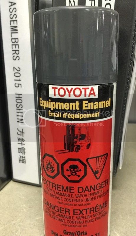

After a couple thousand miles mine are still great. Painted them dark grey today.
