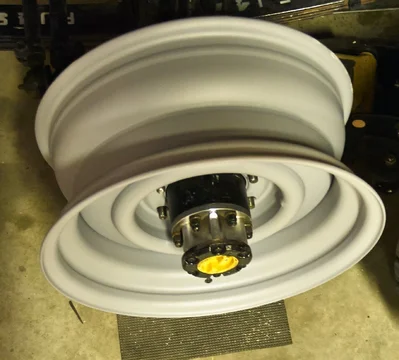

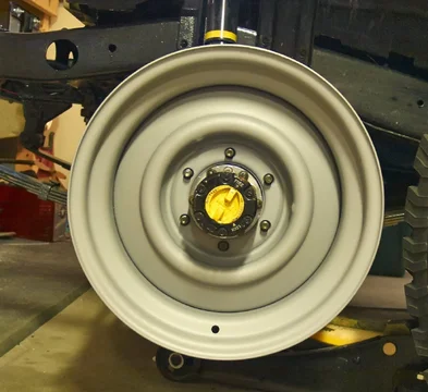

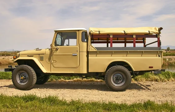

Well today the wheels were mated with the tires. Photos show the end look. The gray color seems to be as close as possible to OEM. In the photos they appear blue gray, but it is a steel gray. Gray is a neutral color so this blue is most common with gray in photos just as that beige paint on my rig.
Paint that was used was Rust-Oleum Painters Touch gloss gray paint. Three coats baked with heat lamps.
Will dig up some standard 16mm lug nuts from Rock Auto and this journey will then be complete.
The wheels have no issues with any part of the brake, steering or frame systems as that was my most concerns.
As the pictures show as far as I am concerned that the old toss out steelies looks much better on a LC that spokes. Again that’s just my opinion.
I guess that’s it. For you guys that see this I believe the Summit wheels are good for this application but some may want to have customs which is just as good but the wait is the problem there. I would suggest powder coat as long as you have the time and get a good firm quote. It seems $45 is the going price. The wheels come from Summit primed so you may want to strip them before taking down for powder as you may be able to save a few bucks. Be it a FJ40-45-60-61, the 16x7 is the best wheel platform for sizing different tires on your rig. 15x6, 7 are just okay but limited.
