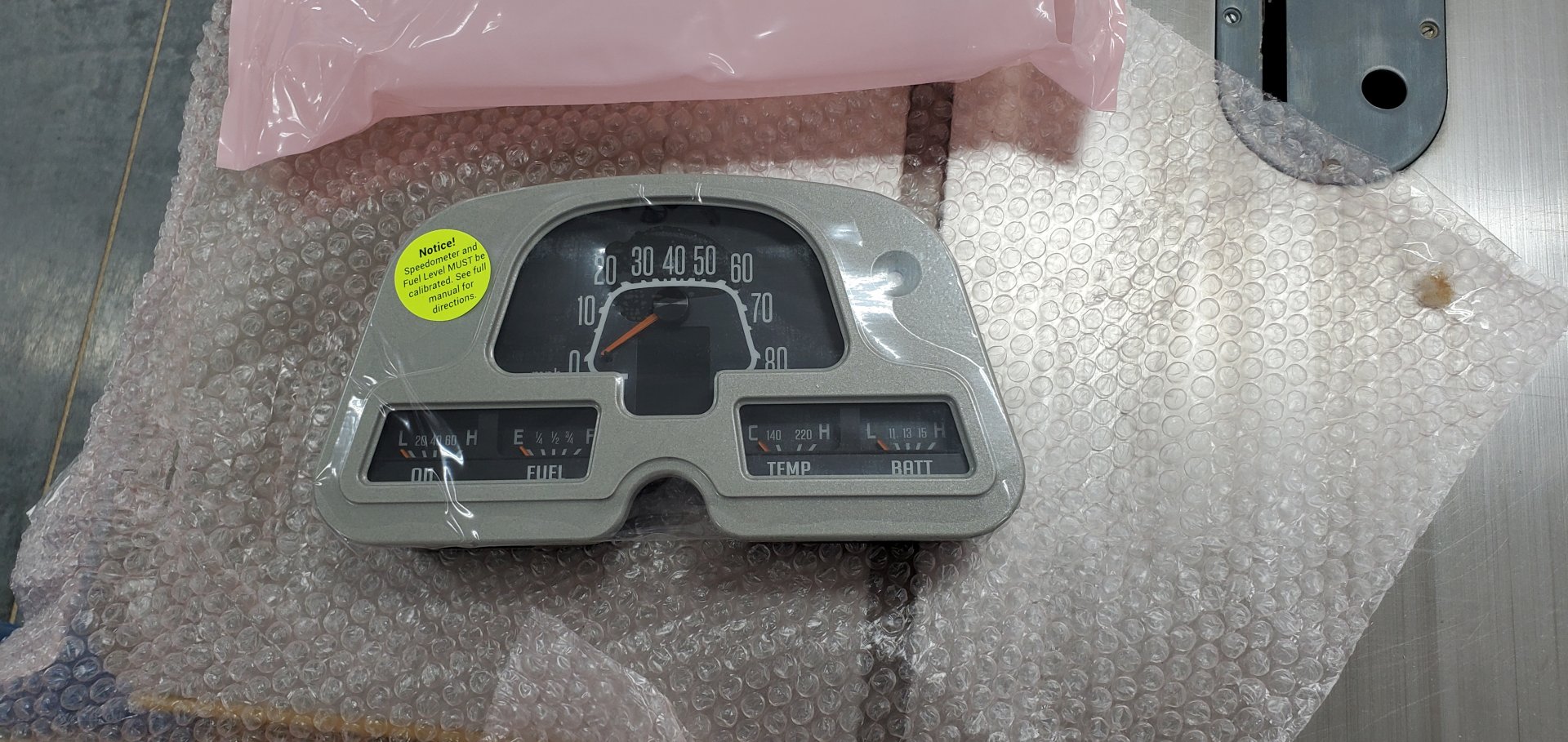

Showed up today. I am pretty excited to get these in.
Nice! Extremely envious of your new instrument cluster. Can you provide us with specifics. Is is a Dakota; from where did you order it; price; particularly interested in the install, sensors, calibration and how difficult it will be to get it all dialed in.
Thank you.
Thank you.
It is from Dakota Digital. I ordered it directly from them. I shoot in a precision rifle league with .22's, NRL22. I was at a match in western Minnesota and was chatting with a guy who's kid was in the same group I was shooting with, and found out he worked for Dakota Digital. I really don't want to talk about price. I got a good deal, and probably based entirely on the circumstance of being in the right place at the right time. Getting the custom speed/tachometer layout was easy, just an option. The programming to get the TEQ logo was no big deal as well, I think I just sent him a .tiff file for that. I was ready to send a vector file I'd been working on to cut on the cnc though as well.
I'm working on installing it today, and probably tomorrow. I laid on the couch and pissed away half the day curled up with my own lazy Vizsla watching Discovery Channel this morning. I won't get it done today....
Brandon from Classic Cruisers grew up in Minnesota, he's headed towards his parent's place, and I'm meeting him at the interstate to grab a new roof cap, and a refurbished steering wheel from him later today.
After this post I'm headed to Napa to get some wire to see if I can come up with a clever way to get get signal from the factory barrel plug on the back of the cluster, to the new brain box for things like high beam, turn signals, fuel level, etcetera. I don't think getting things dialed in is going to be that tough? I'm hoping a bunch of that can be tweaked with the app on my phone. The rest of the sensors look pretty straight forward.
I drove it to my work this morning so I pulled the original gauges out, flipped through the manual a bit, mounted the switch, and came up with a plan for mounting the brain box. I put the speed sensor in the transfer case and got that cable routed into the cab, but that's about it so far.

I got so lucky with this rig. It was exactly the correct 40 for me. Needs work, but not a wreck, and the problems/improvements can be nibbled away at. Having the correct transmission and transfer case for a Cummins R2.8 swap is a huge money saver for me.
Sweet deal! Will you be mounting the brain box in the glove compartment? Ours is a 1970, so we don't have the barrel plug. I'm wondering if that is going to be a problem or if we can simply label everything and run new wire to over to the brain. Does the speed sensor replace the current spedo cable?
I think there is room to mount the box on top of the clutch pedal mount. There is a big flat spot there that I think will work well. I was planning on mounting it with heavy duty Velcro. We'll see. I'd rather do all of the terminal connections not in some weird/awkward little hole.
