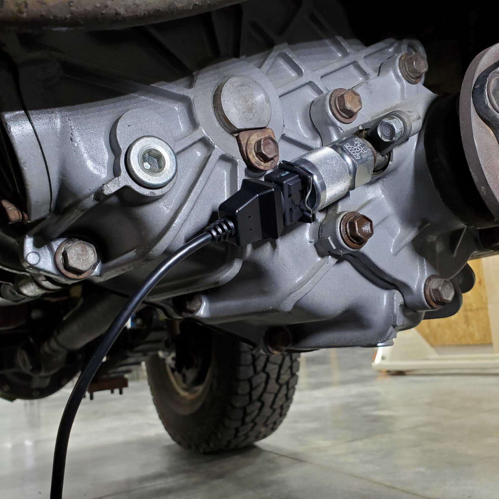

The first sender I installed was the speedometer unit. That was pretty simple. Basically take out the cable, thread in the sensor. There is a little brass unit that comes with the kit. I slid that into the transfer case first, then the sender into it. Hand tight, that's it. It comes with an extension. I don't see a need for it in this application, and did not use it. The cable that plugs into the sensor, I zip tied to the crossmember in two places, then strapped it in to the original spots on the frame, then along the firewall. I think I secured it in a few other places with zip ties as well.

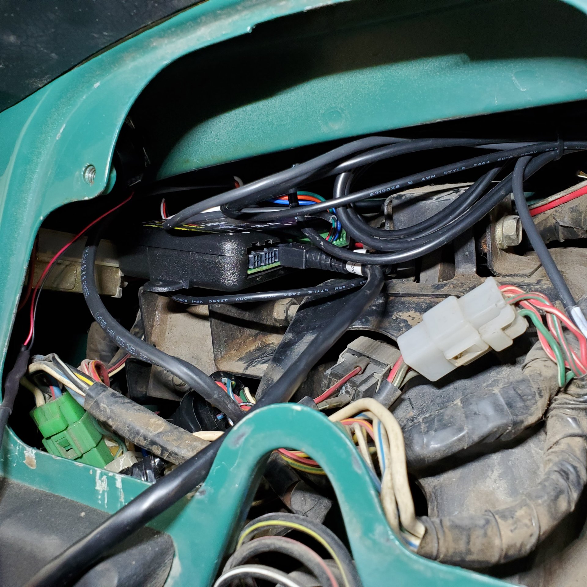

I mounted the box on a piece of industrial velcro. Also the compass. The clutch pedal mount seemed like a good spot. You can see it in the upper left. It's basically the only clean thing in there....
It'll have to come out again. I think velcro is the right solution here.
There's a chubby white wire with a blue chaser towards the bottom of the opening. That's for the ammeter that you won't be using anymore. I used a short machine screw and a nut to fasten those together, then wrapped up with a mile of 3M Super 33+ tape.

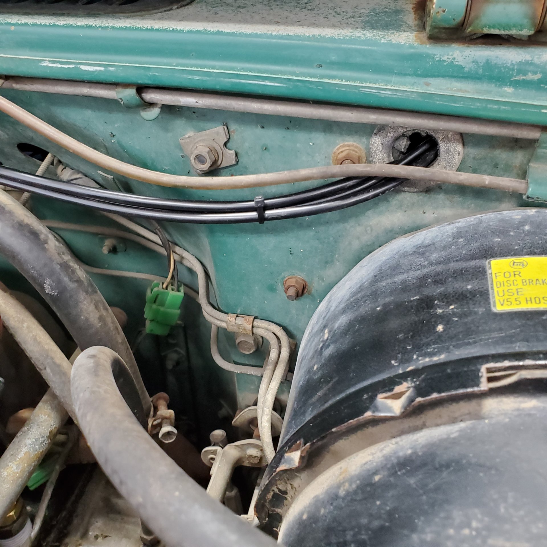

Here you can see the three sensor wires coming out of the firewall on the left side of the vehicle.
The wire here is for the water temp sensor. I didn't like the idea of it making a tight bend, so I made a gentle loop to change directions, then ziptied the whole mess to the bracket that once held the rotationg speedometer cable. Does anyone know how many rpm that cable turns going 60mph? It can't be much, but it had me curious.

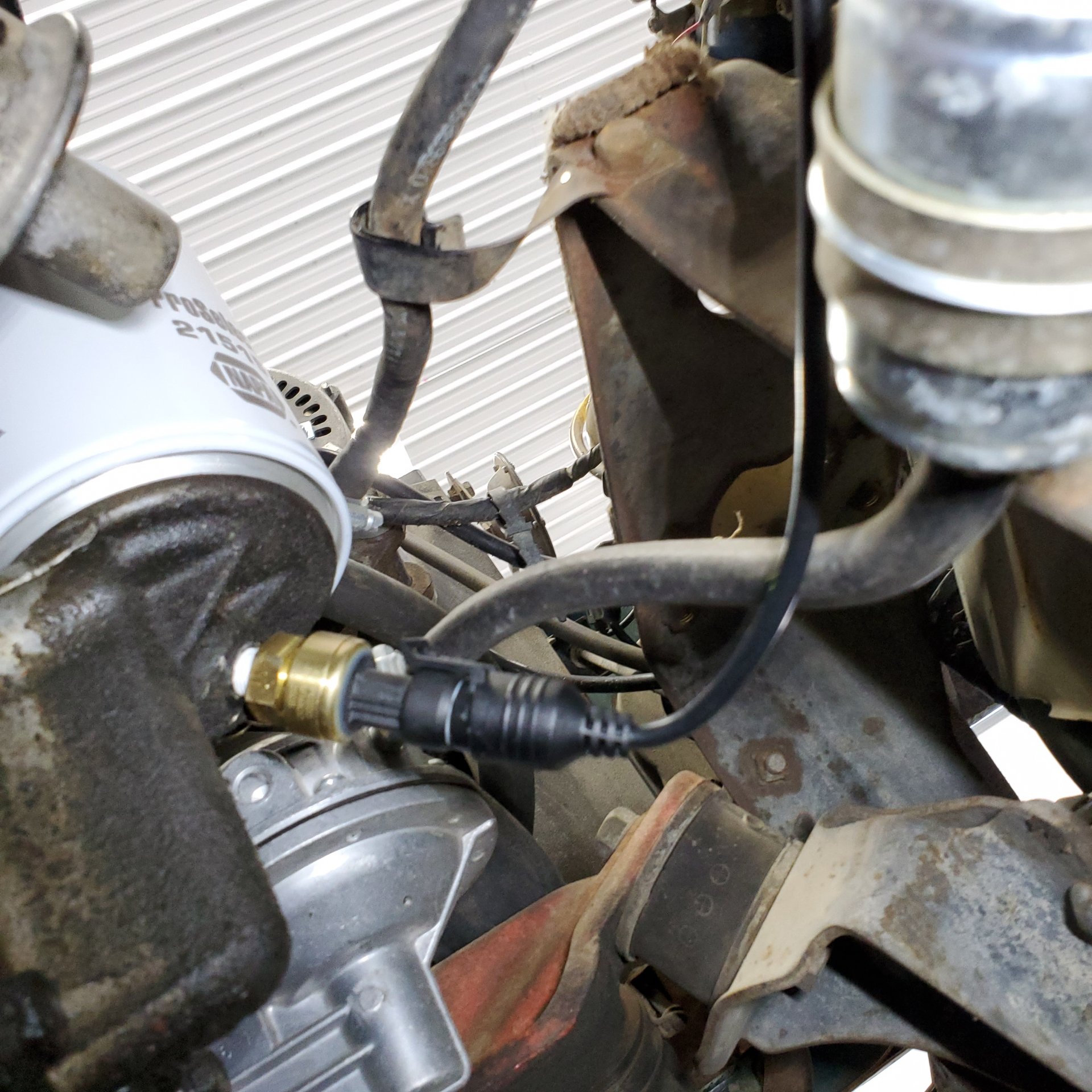

Next up. Oil pressure sender. Once again, super simple. Route the cable in a smart path, and secure it. The old sender spun off easily enough. The new one had notches in the lands for a wrench, and I thought that meant left hand threads, but apparently its just pipe thread. Sending a tap through mine might've been a good idea. I cleaned up the thread goop as best I could with a pick, but it was a little snotty to get started, and didn't go in super smooth either. I used teflon tape here as well.
Top side. I pulled the battery, battery tray, and the muck deflector from underneath the battery. Maybe not neccessary? I wasn't in the mode or mood for hassle, and it's just a few fasteners to get everything out.
I like to write the mileage on oil filters with a paint marker. I should do the date too. My brother does that.
Bottom side. Simple.
This is exactly what I did with mine. Perfect spot. It’s out of the way and removable with Velcro.

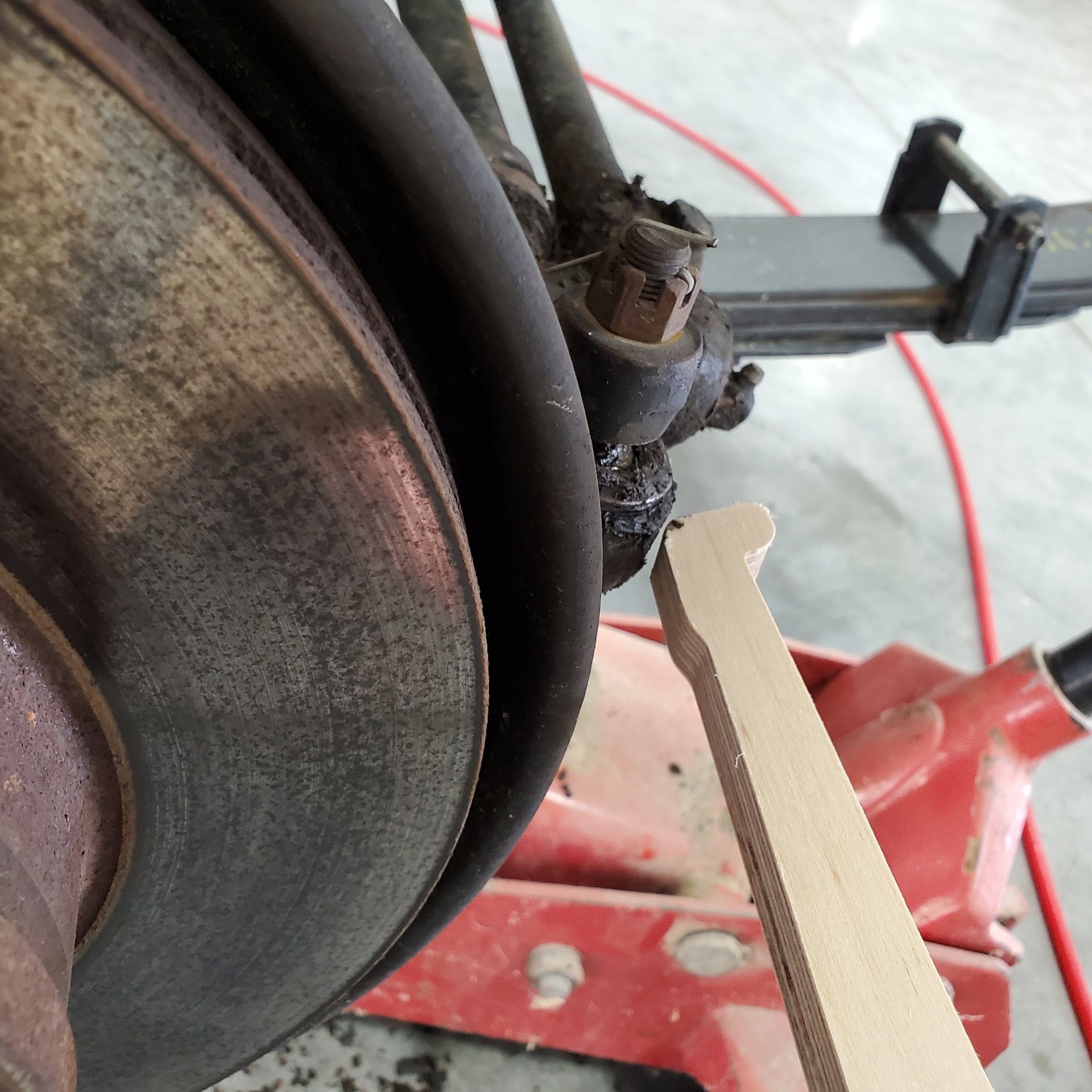

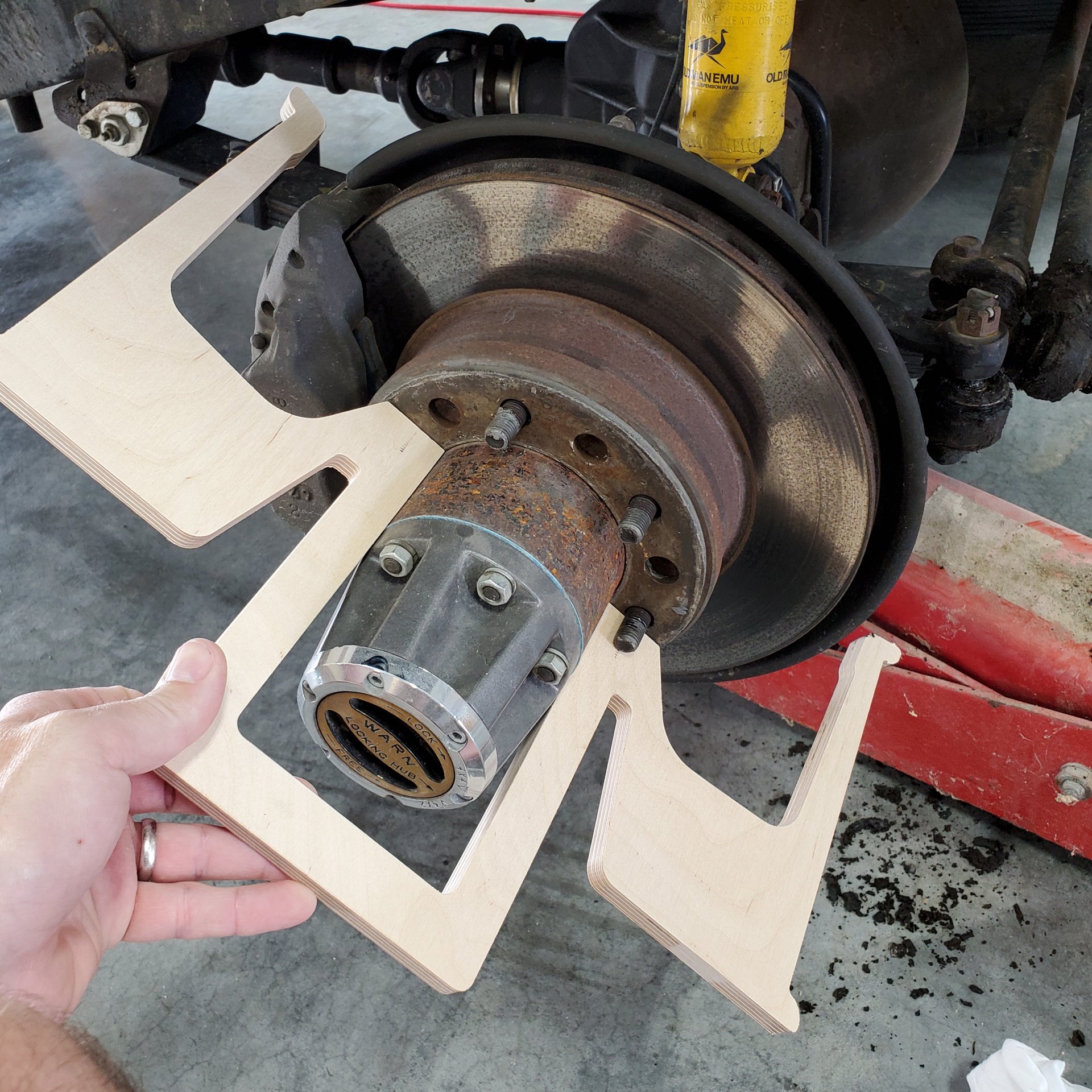

Looks like the Method 704 in a 16x8 will not work. A 17x8 likely will, but I'm not sure I'm thrilled with that wheel size. Might seem kinda big for this vehicle.
I made my cross section template incorrectly the first time. Wrong dimensions, and I didn't leave a space for the hub, so there's no way I could've centered it and gotten it flat against the studs.
I pushed it flat against the studs with one in either side of the template so I knew it was clocked correctly. Not hyper accurate, but accurate enough to give it a go/no go call. You can see here, I've already got a ¼" spacer in the front. I'm not sure why, I didn't put them on.
And it's no go. Sad face. Depending on how you hold the template, it either hits, or it's just too close. How much flexure is in a wheel or this assembly? How much clearance would be required?
If I go with a 17" wheel, I might be able to ditch those spacers. I'm neutral on this style spacer, as it's not a second set of studs, but it's still moving the force further out on the stud with essentially zero material supporting it for that ¼". Not that this rig is going to get wheeled hard or anything, but wheels never fall off in the garage. If it's going to fail, it'll probably send me cartwheeling through the ditch and into a packed daycare center playground, and I'll be known for years as the daycare tragedy.
If you properly torque your lug nuts, the studs should never see a shear force. The clamping force from the lug nuts is intended to create enough friction between the rotor face and wheel mounting surface such that the only thing the wheel studs are doing is providing the clamping force. So, your comment about moving the force out further on the stud with essentially zero material supporting it is not really a valid concern unless you don't like to torque your lug nuts :hillbilly: If you like the 16" methods and a small spacer is required to make them work, a small spacer wouldn't bother me if it were my truck.
I've always been kinda anti spacer. I'm going to email Method and see if there is any custom options, or if they are worth the money. If the cost is exorbitant, I'm not interested, and I'd just go with the Corsa Dakar wheel.
I'd probably narrow up the wheel to a 7" and change the backspacing to get the clearance I want. I'm kinda doubting it is an affordable option, but you never know.
Or, I should just get over 17" wheels. It'll probably look fine. It's not like I'm going to 22's or something.

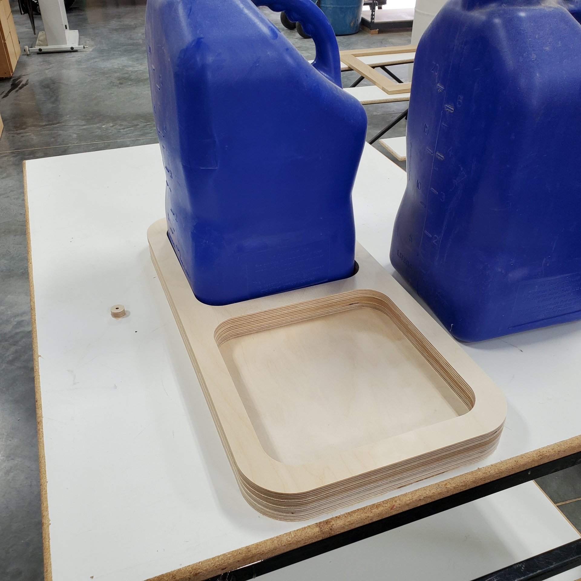

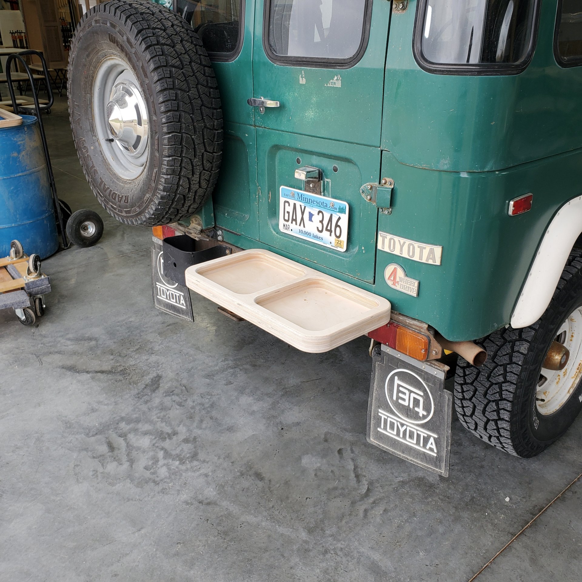

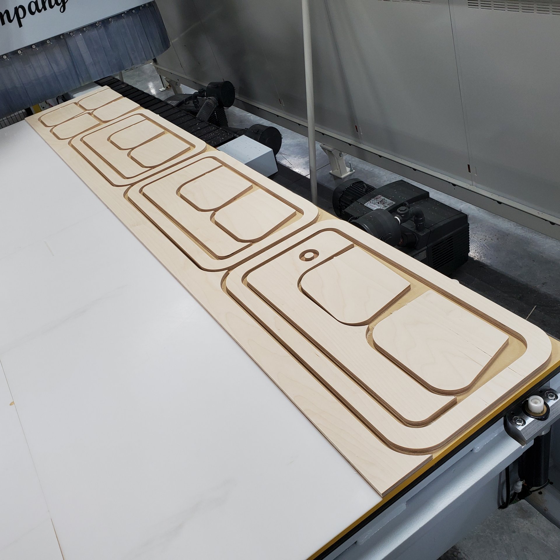

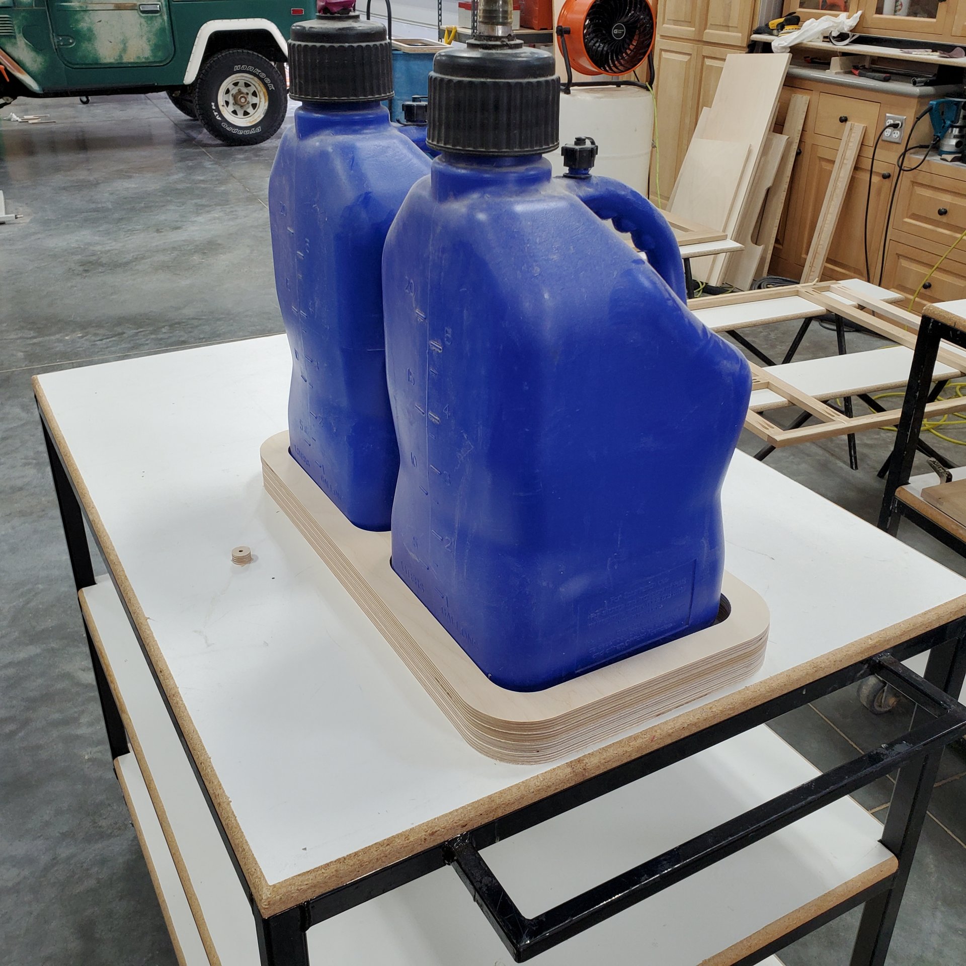

I went full retard today. I'm going out to western Minnesota for a match, and there's some barren areas. Being that I've got the dumb plastic fuel tank, and only 12 gallons of capacity, I was going to make some sort of rack to hold some cans out of 2x4's, then mount the cans somehow. Then I realized I've got pile of Baltic Birch plywood drops that are basically useless, and a cnc....
I basically made a plug to go in the hole of the bumperette. I stacked up enough ply to make it 4" thick. I had to grind on it a bit to get it in, and loosen up the bumperette. Once in place, and the bumper tightened back down, it's not going anywhere. I made a plug to go where the bumper tit goes, and put a screw through that just as a backup, but I don't think it's necessary at all.
I stood on it, and the bumperette does most of the flexing, so it should be good enough for a 275 mile road trip with 65#'s of fuel hanging off of it.

I don't think so on the cracking. There's a lot of very high grade plywood there that is all glued together. I've been wrong before. Lots of times.
It's a short term solution until I get a bumper made with a swing out rack.
