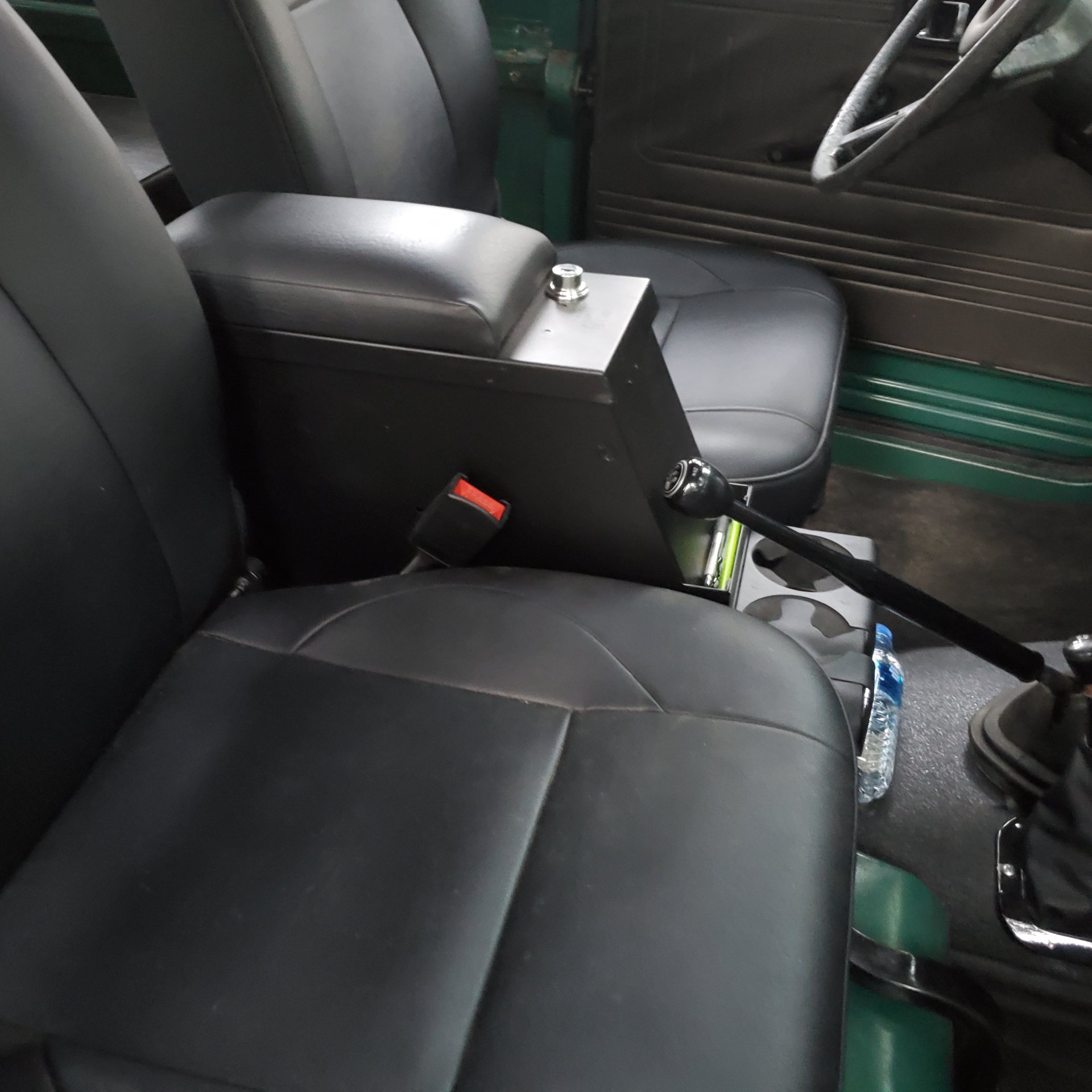

My console finally done did shown up.

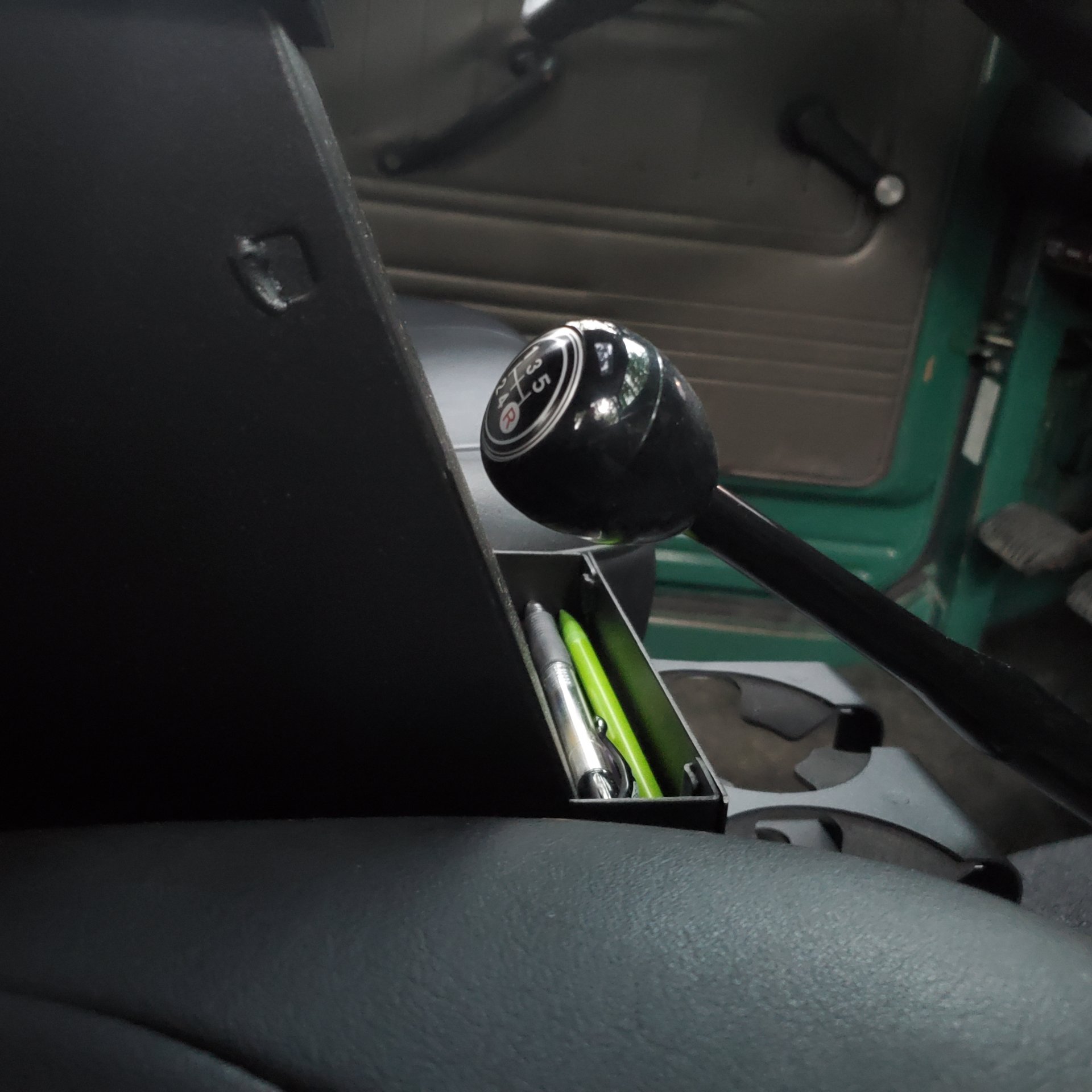

Not real impressed. Paint is mediocre. No freaking way would it fit with the 5spd without either moving it back, or bending the shifter.
I moved it back about 3", it's enough to shift, but it's real tight getting into reverse. I'm planning on pulling the rear heater anyways this winter, and that's what is holding up pushing it further back. Another inch or two would be adequate I think.
I've got the rear heater unbolted, and just kinda sitting there for the time being.
I'm assuming I can just loop the hose for the rear heater back into the firewall and be fine until I get the vintage air installed?
Reverse is annoyingly tight.
It will be nice having reasonably lockable storage. Breaking into a 40 is only slightly more difficult than using the key. (Assuming the key is already in your hand, and not in your pocket. Then it's a toss up.)
I had that console but removed due to the shifter being too close to it as you mentioned. Nice looking cruiser.
