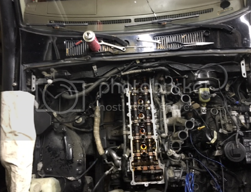

The half moon holes are there to provide clearance for the boring process used during manufacturing. The machine tool that cuts the precision bearing surfaces for the camshafts use the half moon area for access.

Finished cleaning up the valve cover late this afternoon. I ended up using a couple cans of brake fluid and a can of throttle body cleaner and a brush and pick. I feel confident everything is nice and clean. Then I scrubbed with dawn soap and hot water After that, I scrubbed down with some MEK and sanded down the valve cover, wire wheeled in the hard to reach areas, blew the dust off and did another MEK treatment. let it get good and dry, MEK'd it again, and blew it off with the air.
I used VHT engine enamel primer, 2 coats, and 3 coats VHT engine enamel GM Satin Black. turned out good but I wished I would have taken a little extra care to sand down better. Oh well, just a valve cover, not a work of art. I am going to get some brush on red for the toyota lettering tomorrow, add my 1fz-fe sticker, and throw on a few coats of clear.
Before
Cleaned with Flitz, first sanding, and MEK'd
Primer
After Paint
I was at AutoZone and the only thermal wrap I could find for the harness was this stuff. Hopefully it will do the trick.
Followed up by lathering on the FIPG on the half moons and tapping ever so gently back into place.
I installed the VC in place and despite the problems with I had with the spray paint, I am happy with how it looks installed.

Next, I started unbolting the upper intake plenum. I am no stranger to this job as I have completed it before. This round things went much smoother. The studs and bolts arranged in order. I forgot there where 8 total fasteners, which is why there are two #1's and two #6's. I took pictures of my extention setup. #6 and #6 inside are the only two that really "need" to access from under the truck. There is just enough wiggle room next to the steering column for #6 nut and stud. For the #6 inside bolt you can run your extension setup right next to the starter to reach. I used one of those wobble extensions near my socket and rotating ratchet that allow just enough wobble to get the bolts/nut studs off. These are all 12 mm socket heads. View attachment 1192503View attachment 1192505View attachment 1192506View attachment 1192507
This shows my extension set attached to #6 inside bolt, running near the starter and blockView attachment 1192508
