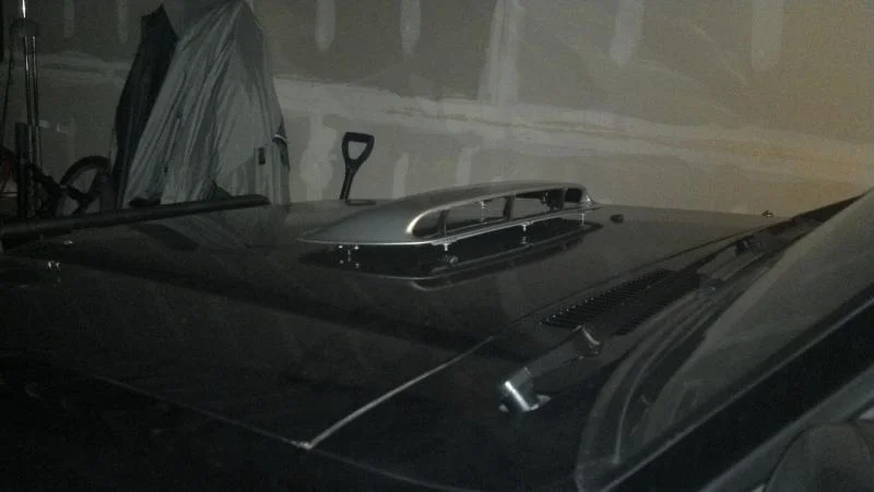

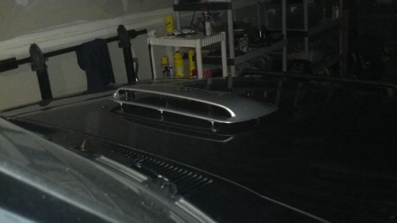

A couple more. I had been considering this wrx scoop along with an intercooler for the 97, but I think I might be better off with an air to water I/C so I don't know if ill end up using it.
Nicholas,
Did you end up installing the Wrx Scoop?? I got my hands on one from a 02-03 Wrx. I have to get my hood repainted so I was considering venting the hood at the same time.
Thanks
Stu
