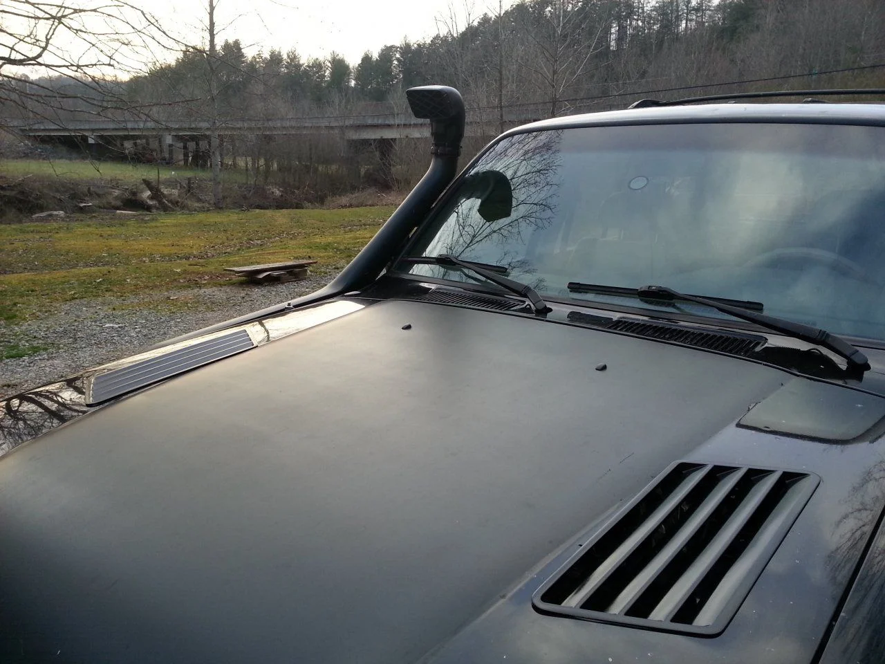

My Newly-Vented Hood (20 photos!)

Lookin good. Don't worry about the fuse box, doesn't it have a cover on it anyway? Mine is good. Make sure to prime and paint the bare metal if you haven't already. Anyway, it's one of the best mods I've done beside the 12" pusher fan to cool the AC in drivethru's.
Best to you, :beer:
Steve
Agreed. I've never had an issue with water intrusion with my vents. And yes, the pusher fan keepsmy S/C cool in the drivethrough too! :cheers:
Nice writeup by the way...

The hood vents look great, my 80 is still off the road at the moment,, this is one of my planned mods to compliment the leccy fans when fitted. Great write up, thanks for taking the time to do it.
regards
Dave

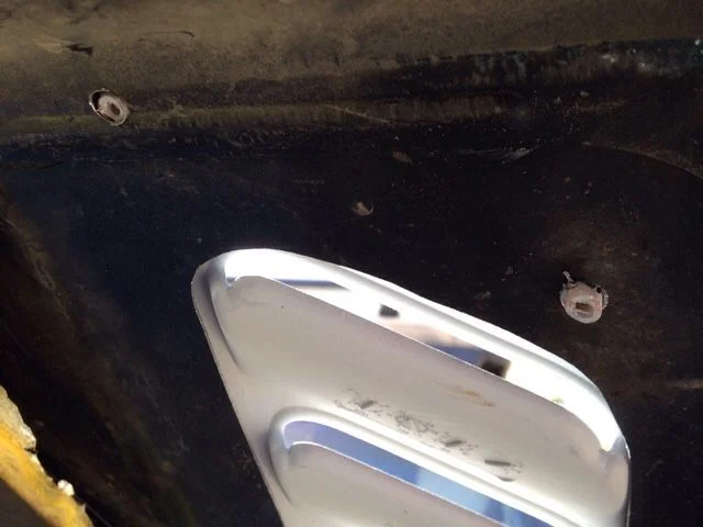

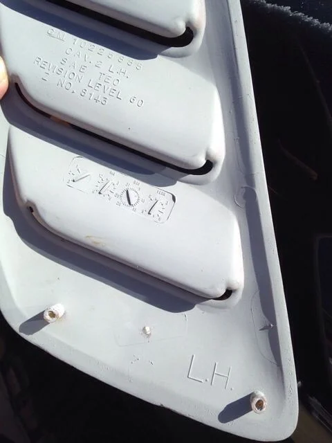

i clipped off the center post since it's not threaded. Did anyone else?
And will open up the bottom of this hole so I can use the hose / grommet idea with washers.
Is double sided tape strong enough without screwing thru the hood at all?
