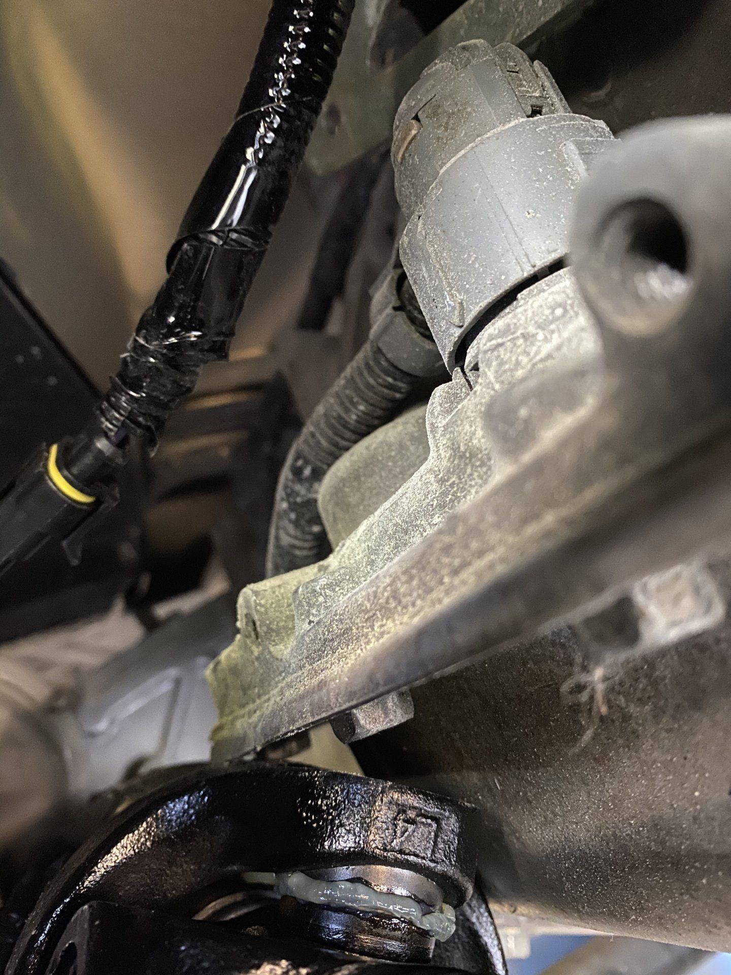

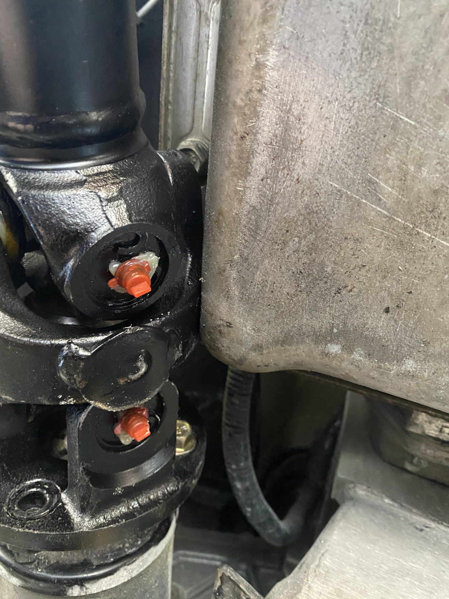

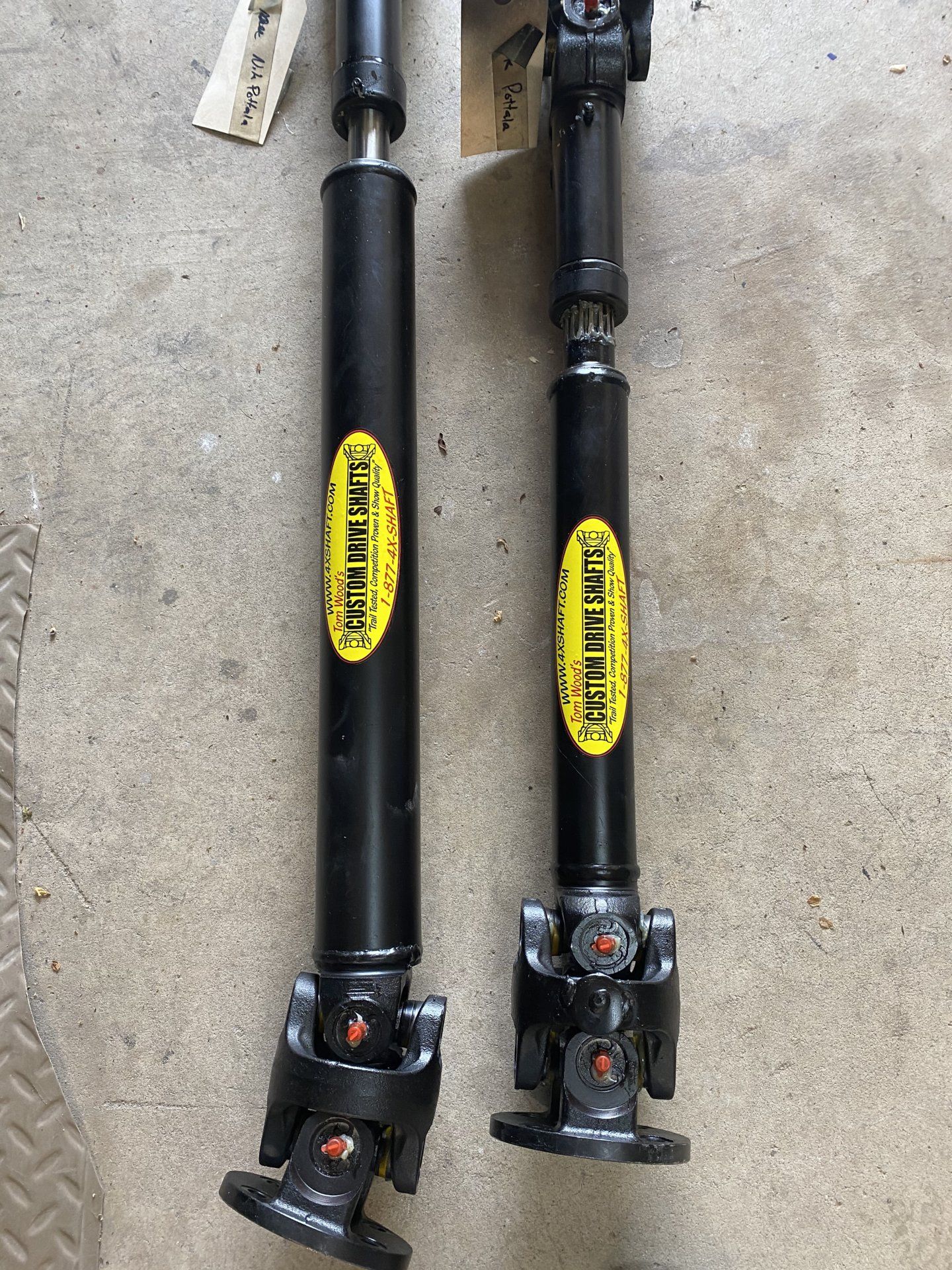

Drive shafts Arrived!
Unfortunately the front wont work. CV joint portion is too large in diameter. Even if I notch my transmission pan like @Megadoomer, I'd have to leave the rear two bolts out and then I think it would still rub if it would turn at all.
Im wondering if there's a CV which will use 1210 joints vs 1310 joints and still bolt to the Toyota transfer case
Dang. I looked back to see what you were using. Is it an LS with 4L60 and a Toyota t-case? I might have faired better because I have an Np205. I think the drive shaft comes out further to the passenger side or lower.
I didn't dig into CV choices so I have no idea what would work.
If your angles are good why do you need a CV?
When I did the cut and turn on the front axles I planned for a CV, so the angles aren't good. Ill look to see if the wedges have will get me there and then I'll have new custom drive shaft with no home. I hate wasting $400.
Unless the angles are way out or you plan to run full time 4X4 I would just build a shaft without a CV and see if you can sell that one to recoup some of your cost.
With all the builds going on right now someone might get lucky and need a shaft that length.
Yep. Waiting to hear back from Tom Woods on options. I have a shaft I scabbed together to roll in an out of the garage so I can cut it down if needed and lament about the money spent.
just flip it for the time being and check clearances. I agree if your angle isn't crazy run a normal shaft.

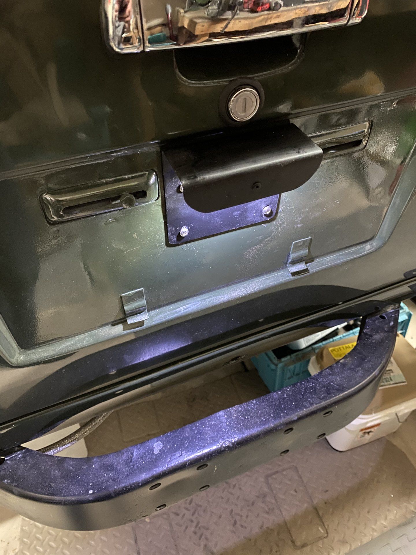

Meanwhile about all I managed to get done was creating a mount for the LED license plate light.
I had a call from Tom Woods about my CV drive shaft that I'm not sure will work. Great people to work with. They offered to machine down the H-joint and rebalance the drive shaft if thats what it takes. We also discussed a smaller CV with 1210 universal joints and a Ford Bronco bolt pattern 2.5 x 2.5. They recommended sending my T-case flange with the drive shaft and they'll drill my flange and make any necessary hub spacer. I need to crawl around and see which direction to go.

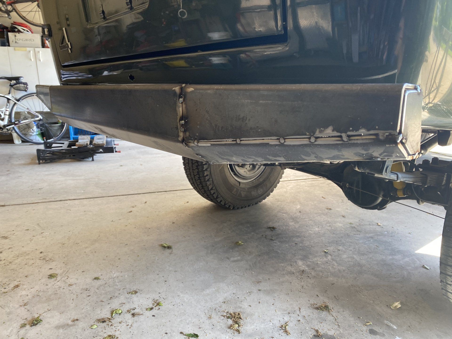

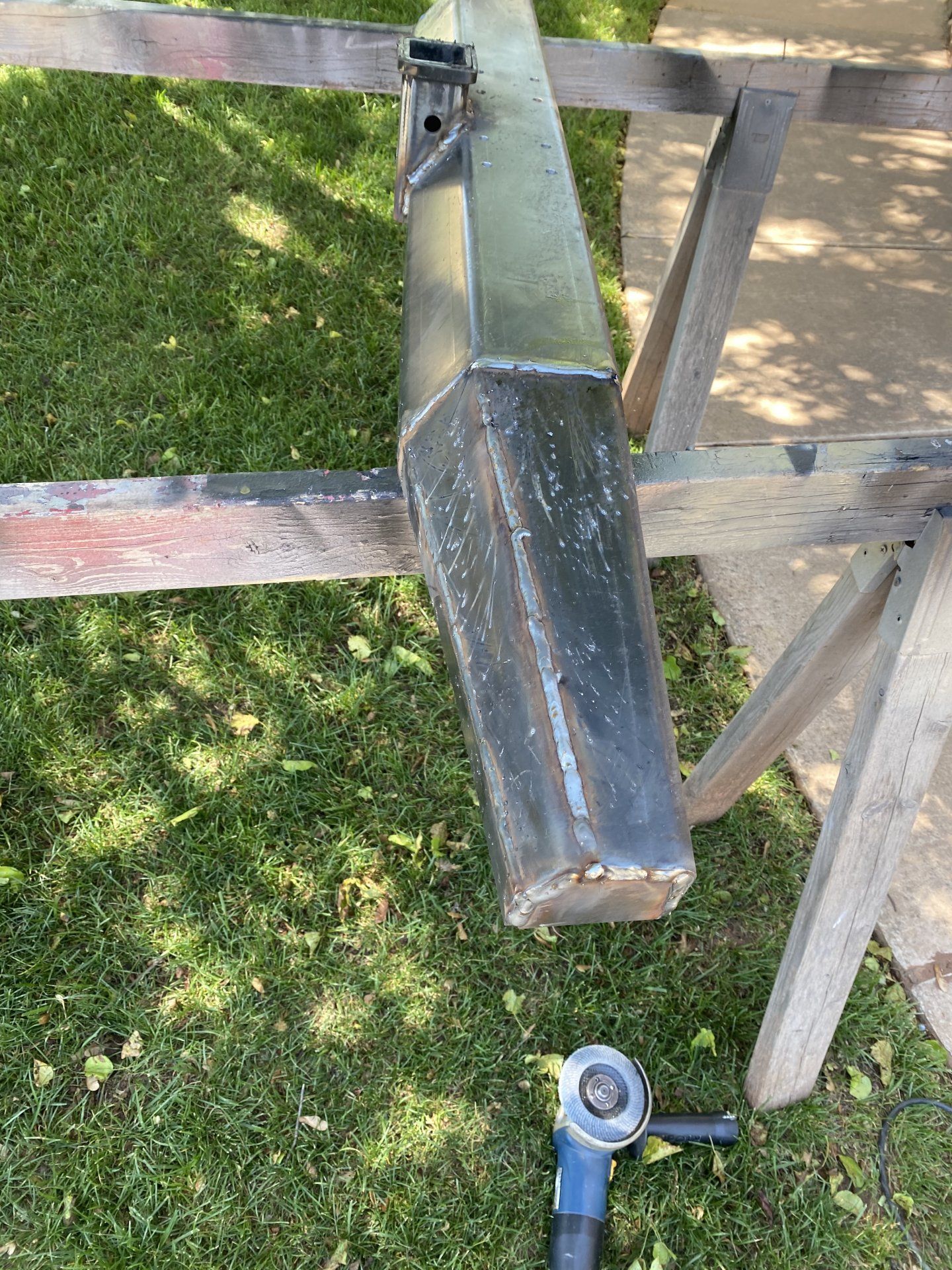

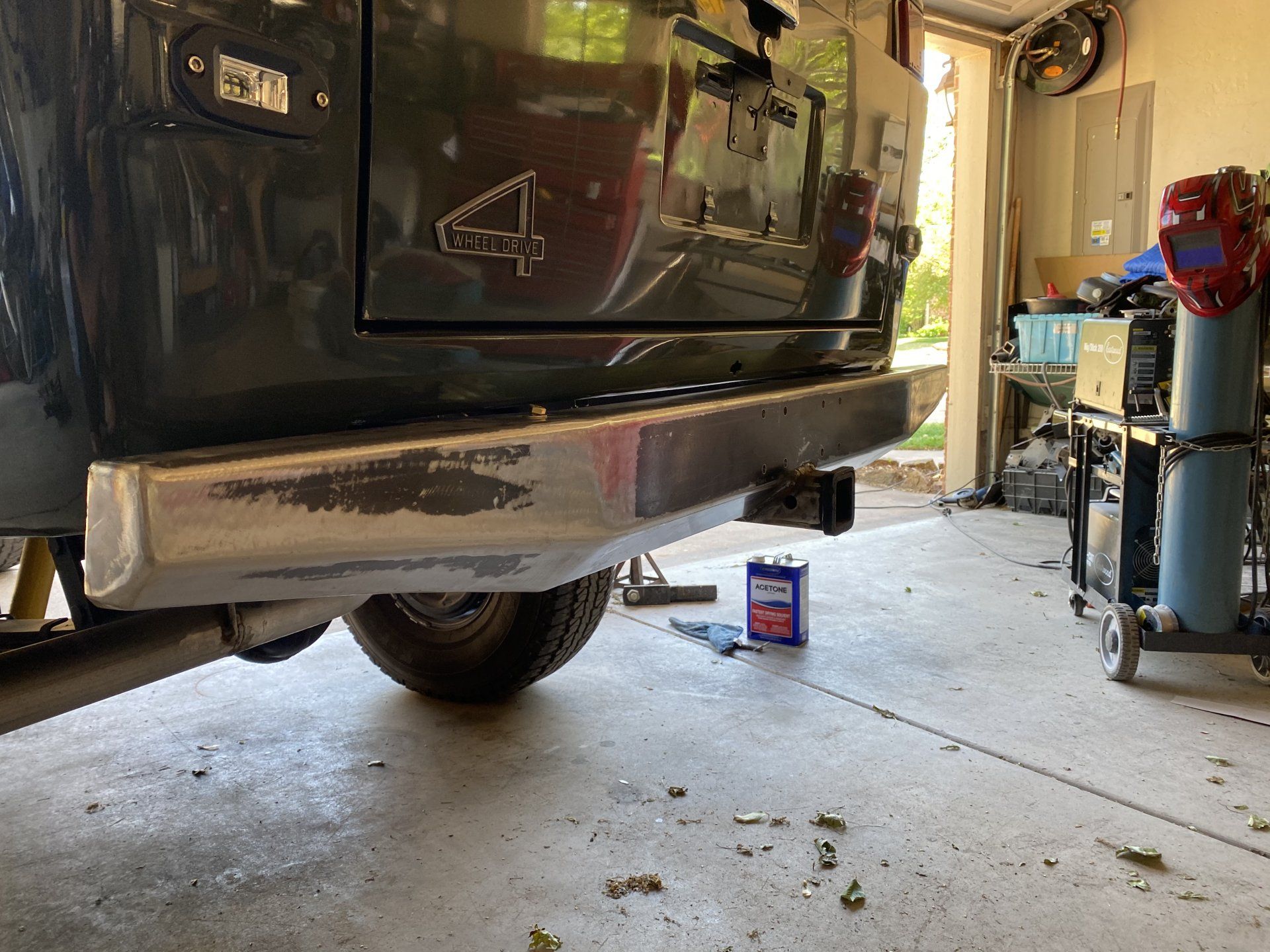

Today was rear bumper day. All ended well but I had some rework because I didn't measure twice before cutting. 🤓
