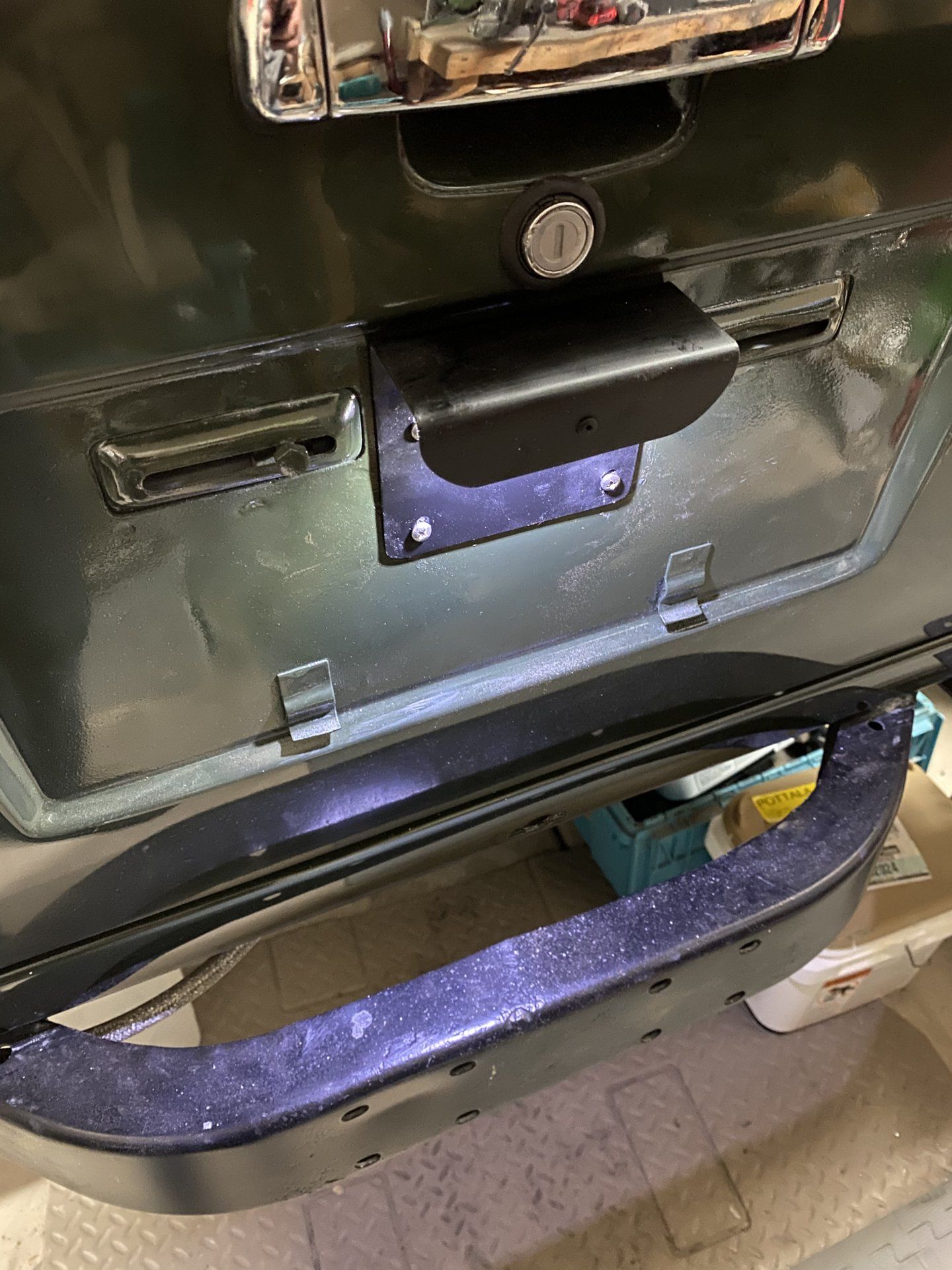

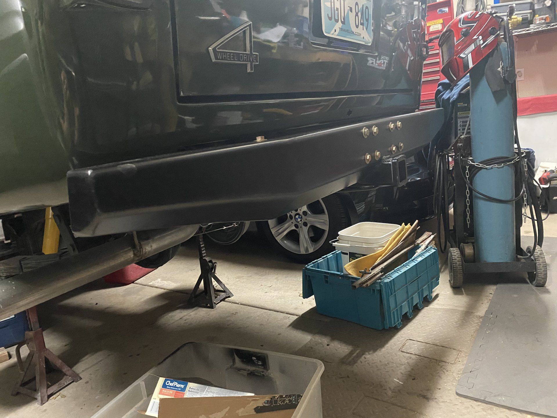

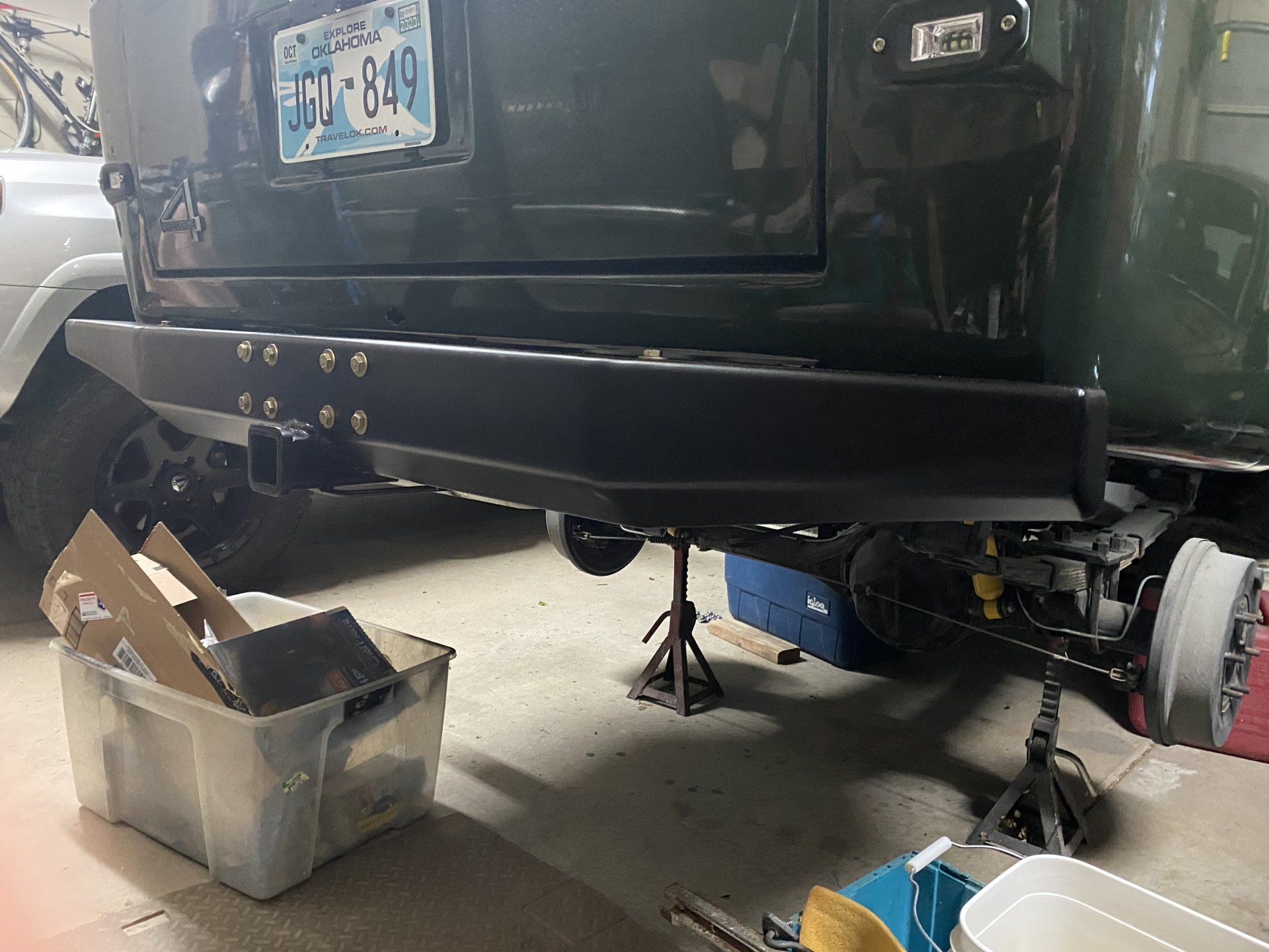

Meanwhile about all I managed to get done was creating a mount for the LED license plate light.
What year tailgate is that? It doesn't look like when they put the lights to the sides of the license plate, or when they put the light underneath....
1970; original light was at the bottom. Glass from a 1969.

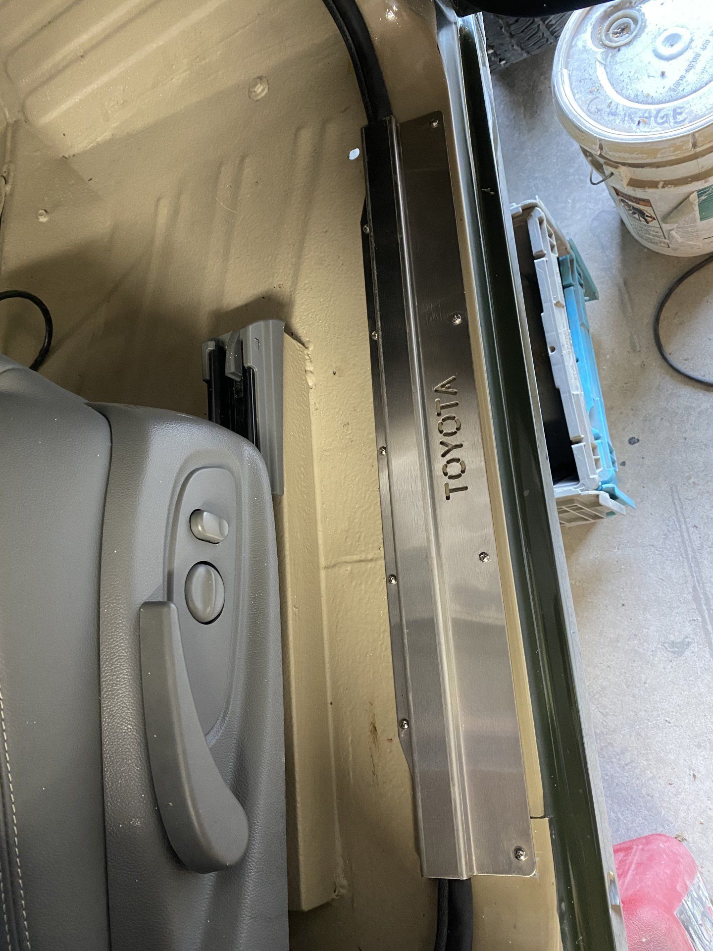

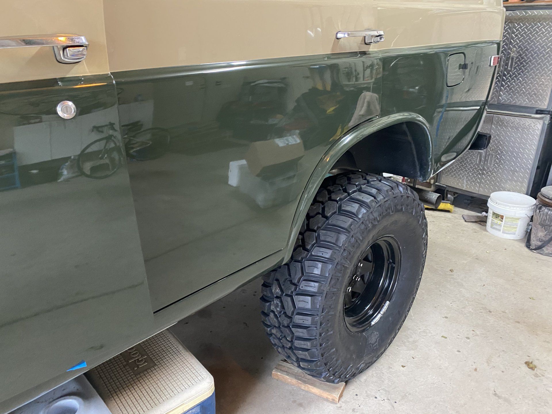

Nine years after I bought these things, I finally install them. I also got it tagged on Friday so once I find a helper to install the windshield, I'm ready to get it out for a spin. ( after I buy it some new shoes )
Wow. Those scuff guards are killer!! I need all four. Where can I get them? I checked with BobM and he isn’t making them anymore.
Yeah I'm usually a day late and a dollar short. I had the foresight to buy scuff panels, a brass window gear, used OEM mirrors and a Slocruisers entire weatherstrip kit way before I needed them. I'm glad I did.
I have an original scuff plate set...one front and one rear...that looks like they were run over by a tractor. I suppose I could try to save them but then I still need another set. Well and I still need to get the rubber for the doors too.
Allegedly he’s a bit moody lately but maybe if we’re nice enough we could convince him to quit chasing kids off his lawn and get back in the shop…..
Yup. Heard he doesn’t even like pigs any more and doesn’t care if the rest of us can’t fix our rigs. Ha!

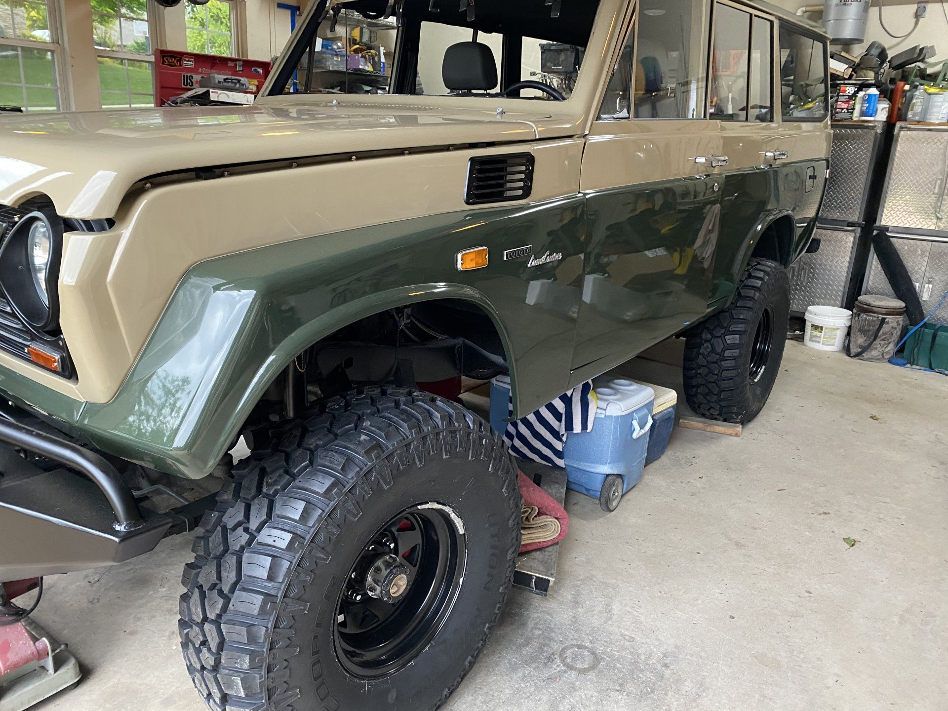

She has new shoes. Now all I need is to install the windshield. That requires a helper since my wife and daughter called it quits after the cargo windows.
Yeah, I wanted to get it out where pictures would look better but haven't done it yet. I just took a few mediocre pictures.
If I can get the windshield installed, I plan on a sexy pig-porn photo shoot.
