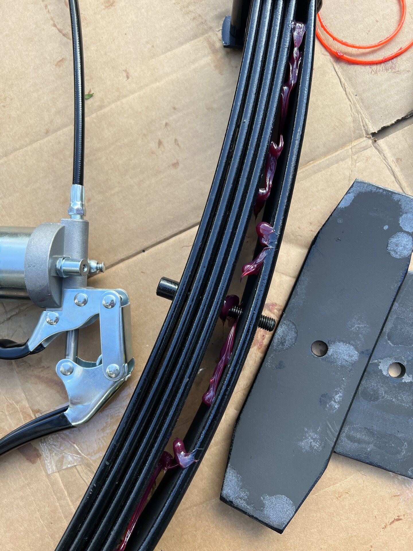

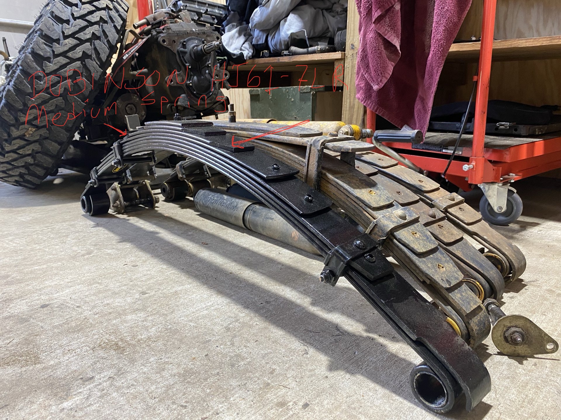

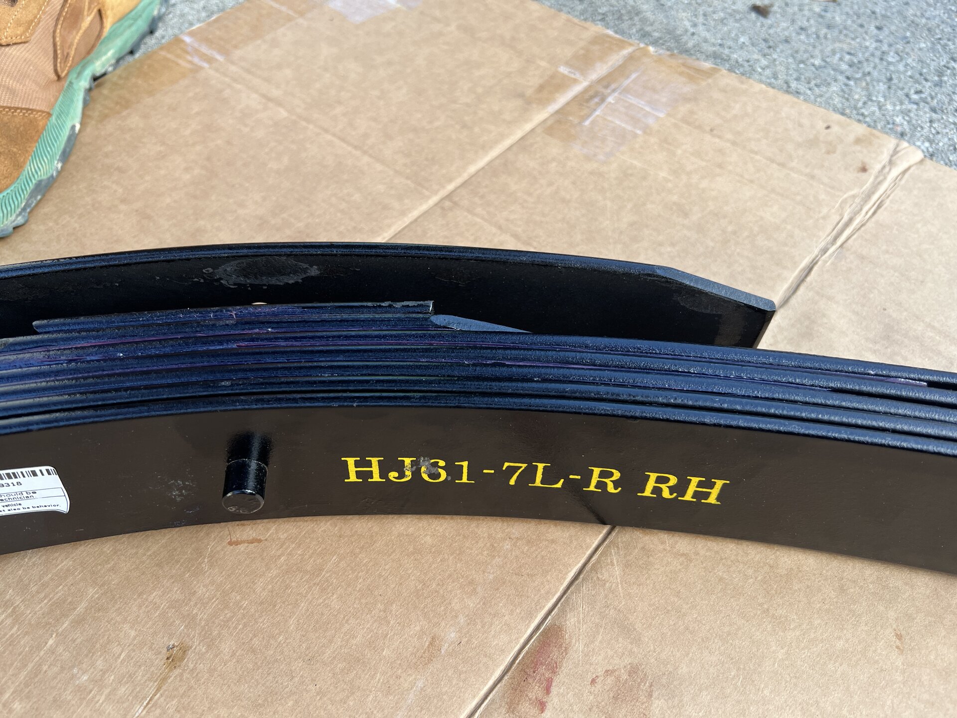

Started on my Dobinson lift instal yesterday.
I got the rear springs & yellow "comfort" shocks installed.

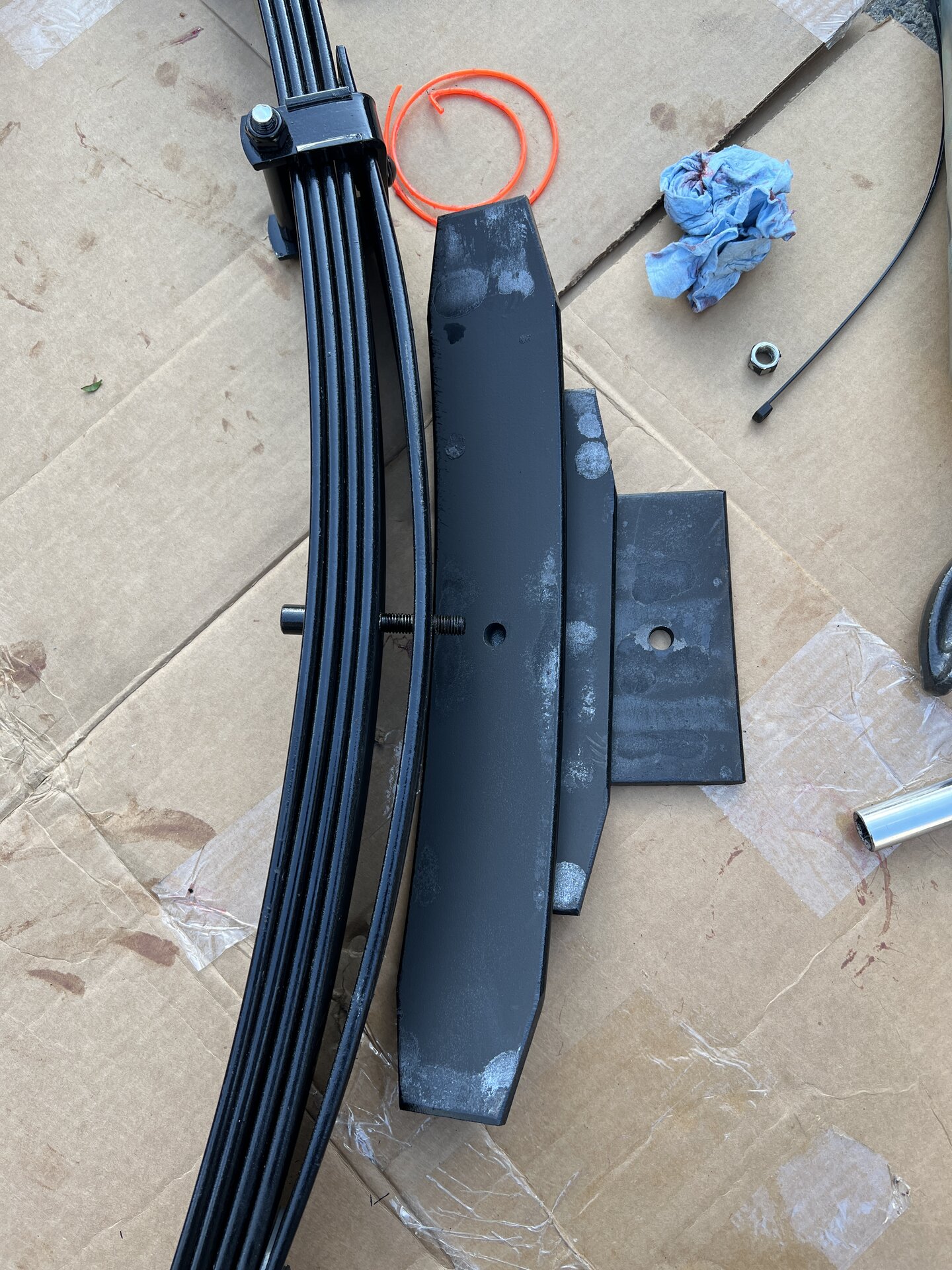

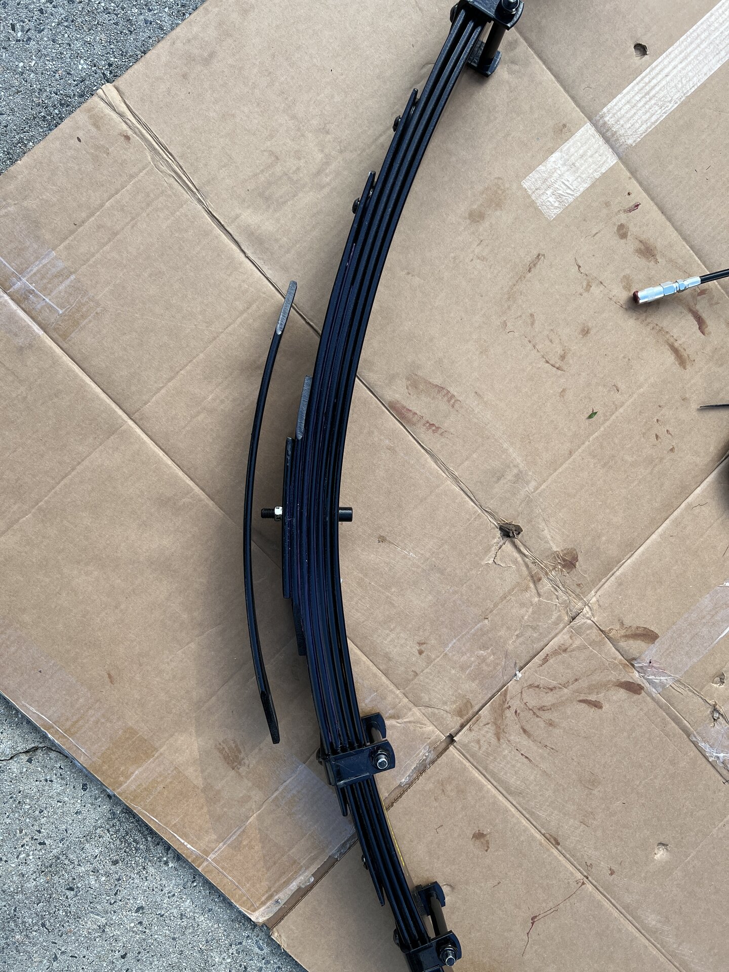

I ended up removing a leaf as others have done. (Pic borrowed from mud, @wrndog I think)
I removed the 3rd one in the stack, I.e. the 3rd shortest. It is the first one that doesn't have the retainer.
I put some red & tacky lithium grease in between the leafs too. Hopefully that will help keep them quiet for awhile.
Note that a zip tie works way better than weed eater line to distribute the grease in between the leafs
I removed the 3rd one in the stack, I.e. the 3rd shortest. It is the first one that doesn't have the retainer.View attachment 3606044View attachment 3606043View attachment 3606046View attachment 3606045
Never been able to figure out if greasing in between leaf springs is good or bad. On one hand, it'll keep them quiet, keep them from binding, keep water out, etc. On the other hand grease is a dust and dirt magnet.
What say the keepers of such wisdom here on Mud?
For what it's worth most of it squeezed out when compressed.

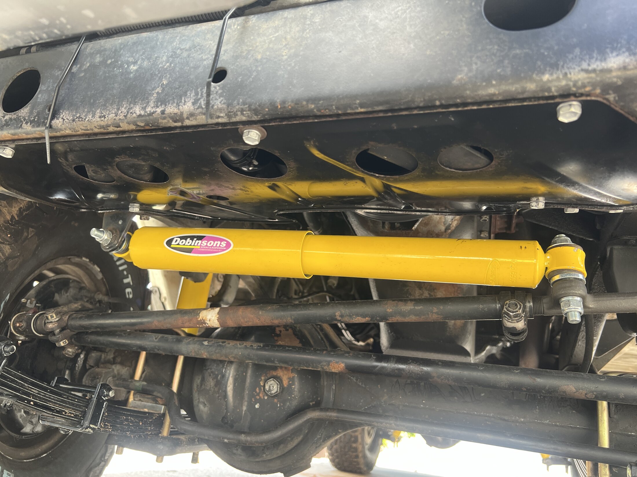

Here is a shot of the Dobinson 2" lift installed, purchased from @crikeymike. It rides great
I also added 4 degree caster shims & rear spring pin spacers from @cruiseroutfit

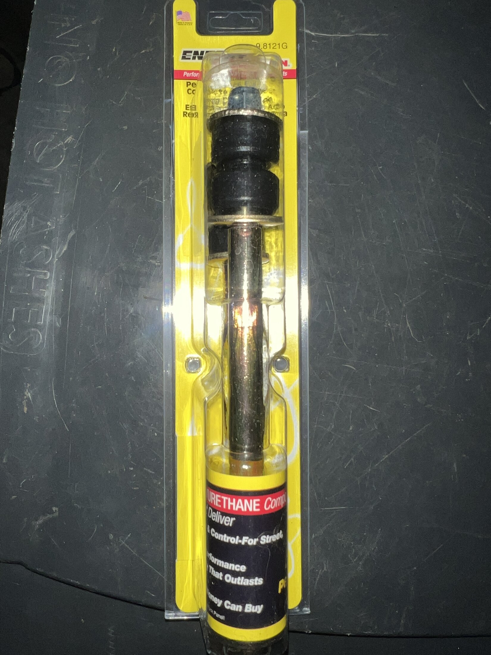

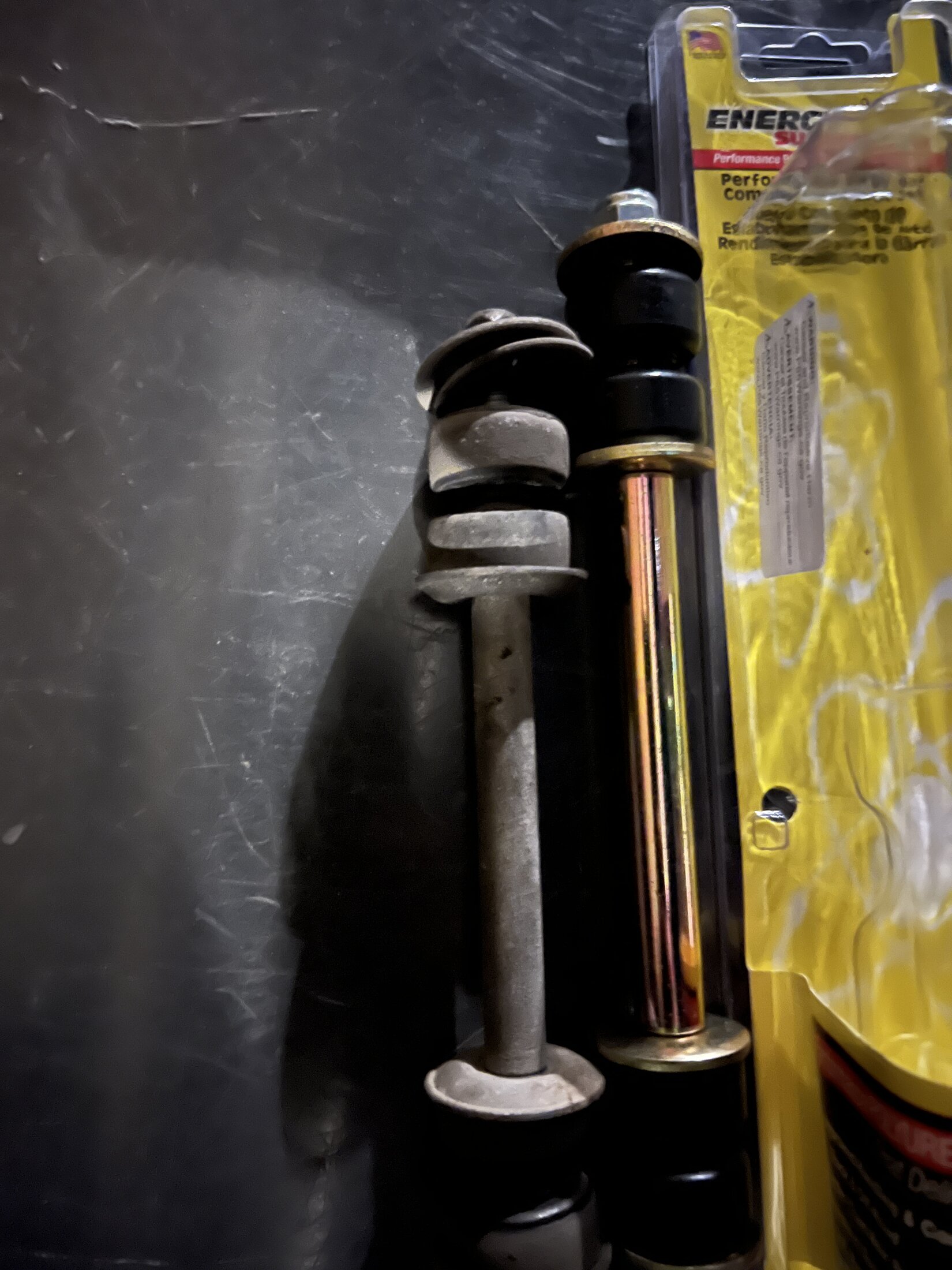

Extended sway bar links from the local auto parts store

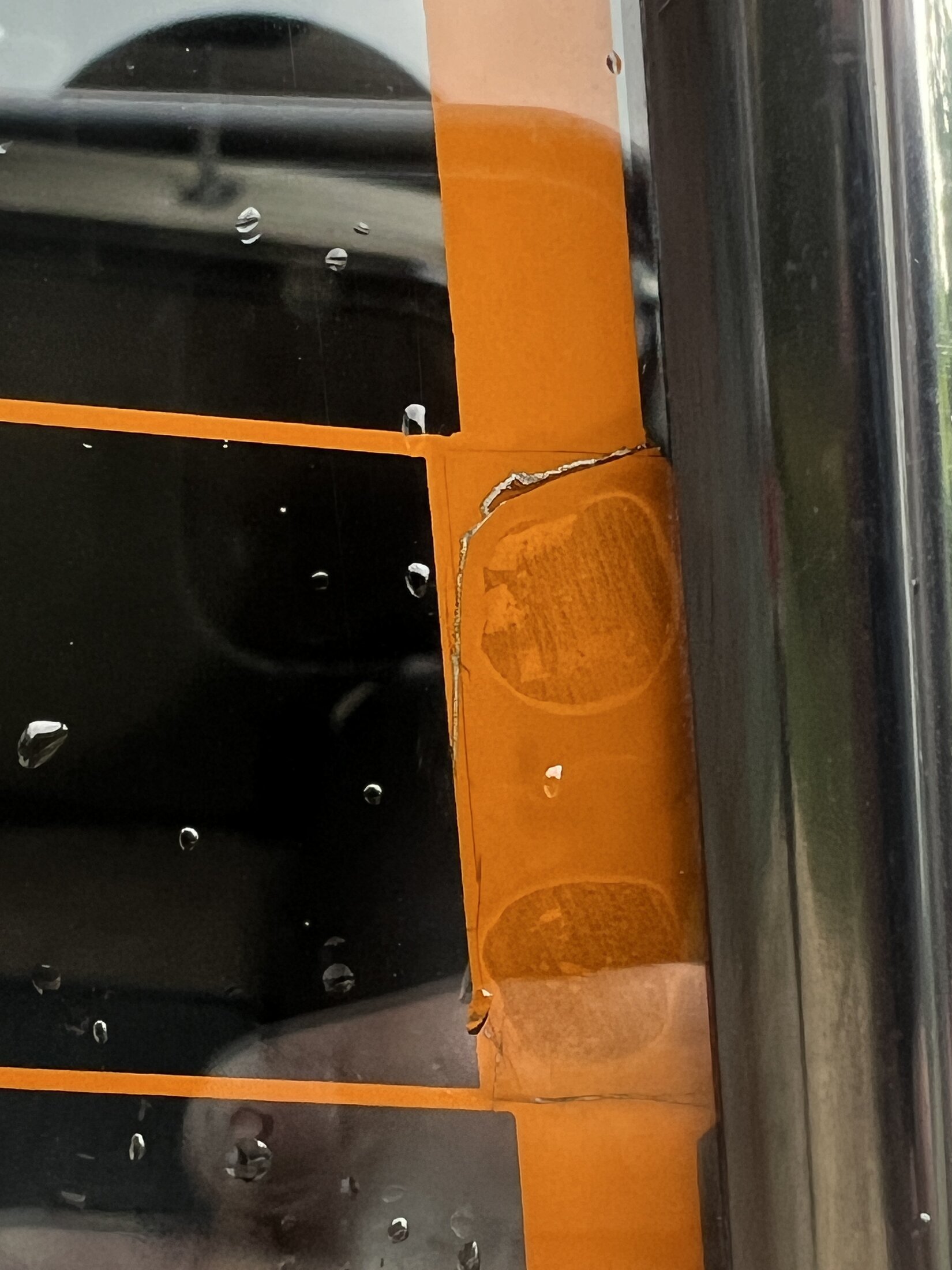

Noticed a break in the defroster tab ground tab on the passenger side.
Wondering if this can be soldered back together with a low voltage solder gun or bridged with a small wire
Has anyone tried this type of repair?

Noticed a break in the defroster tab ground tab on the passenger side. View attachment 3624355View attachment 3624363
Gently sand the surface of the strip on either side of the break, put some blue masking tape around it to protect the glass, then fill it in with conductive paint pen. I successfully repaired several broken tracks on my defroster that way.
Thanks for the tip. Is there any particular brand that you've found success with? Should I reinforce the paint with wire?
I think the one I used was from MG Chemical
