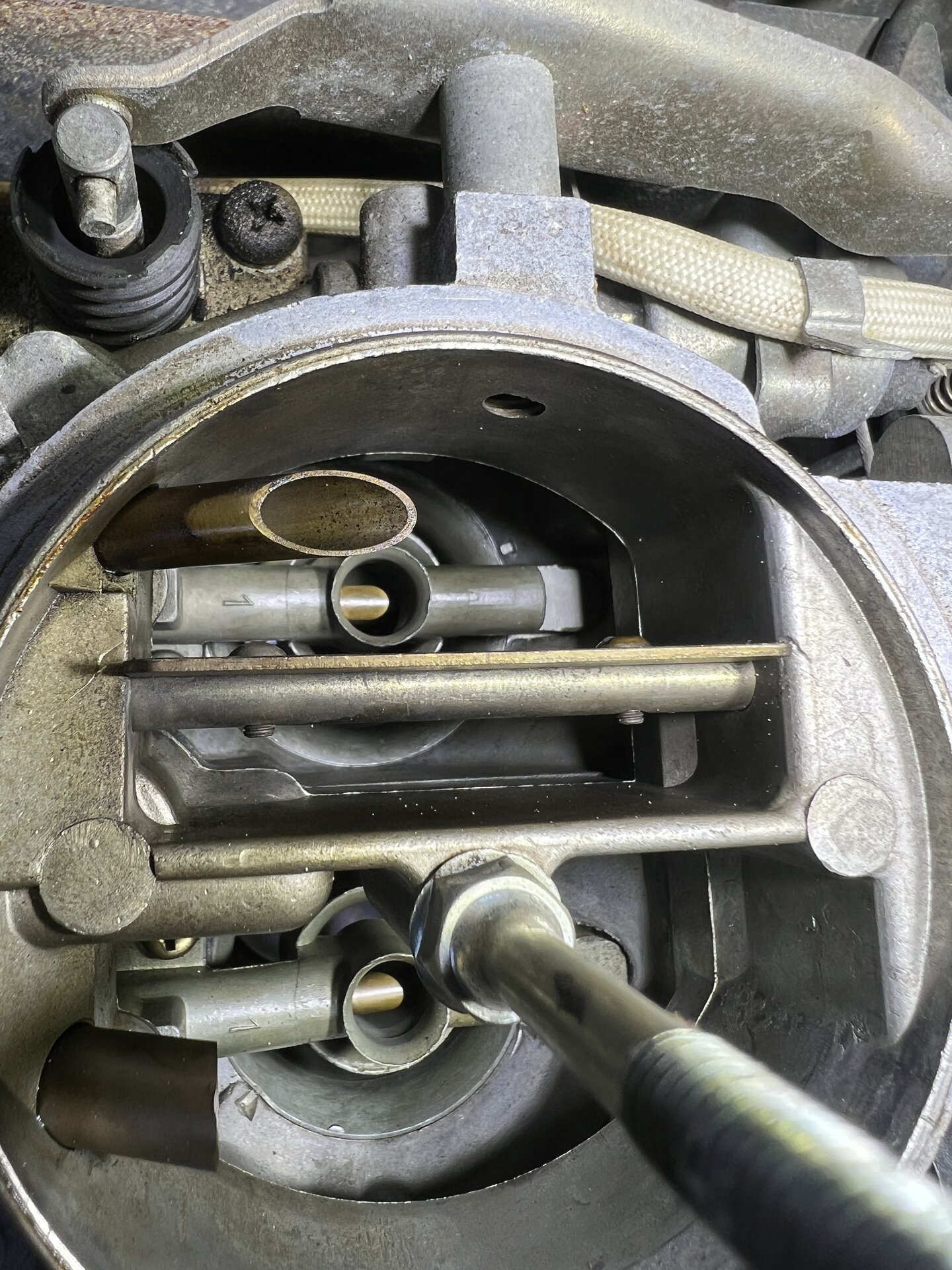

I pulled the plugs again after about 100 miles they were sooty but not oily. I guess my valve seals are still in good shape. Here are pics of #1 & #2 (3 thru 6 looked the same).

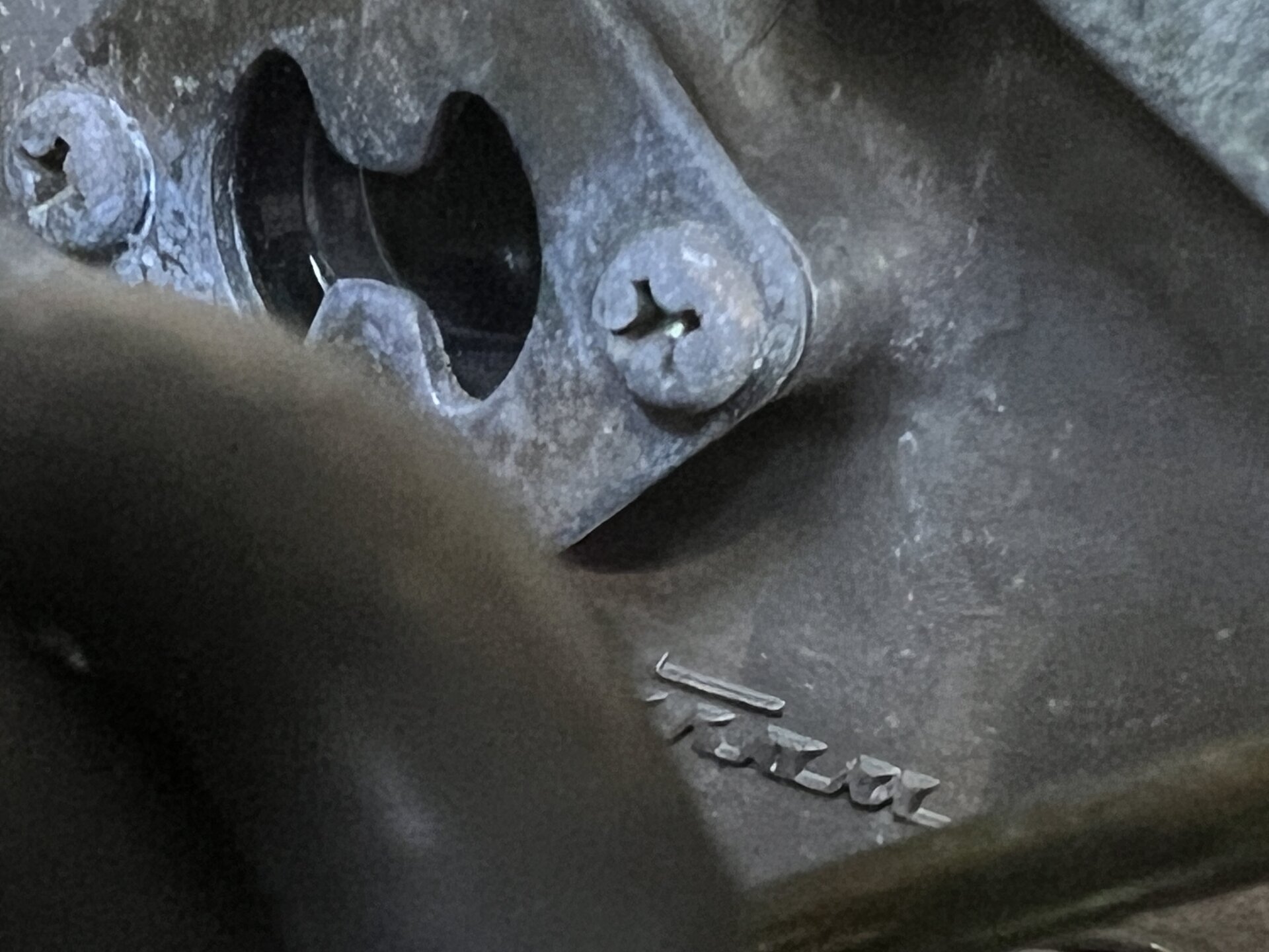

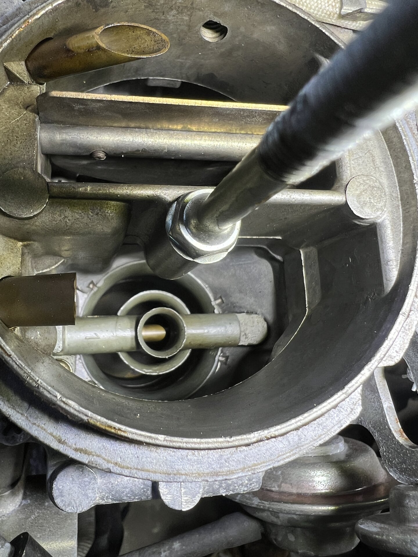

The dieseling was in part due to the idle control solenoid on the carb.
The old o-ring disintegrated when removed. So I ordered new rings and gaskets.
Installed a new crush gasket too.
I have a spare 60 carb that I robbed the idle solenoid from and also added an aftermarket solenoid to the bag. Now I have a trail spare kit for the glove box.

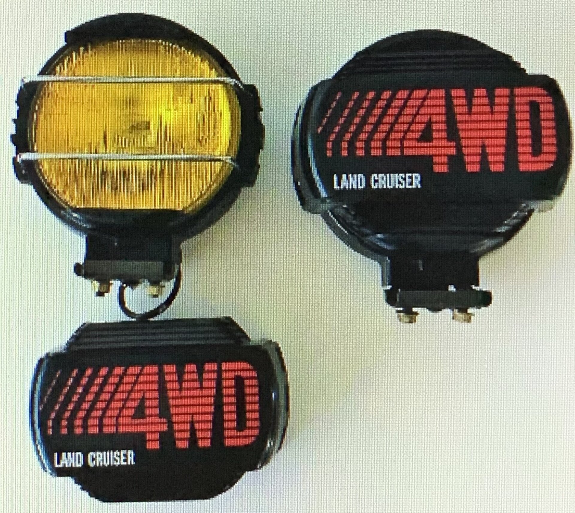

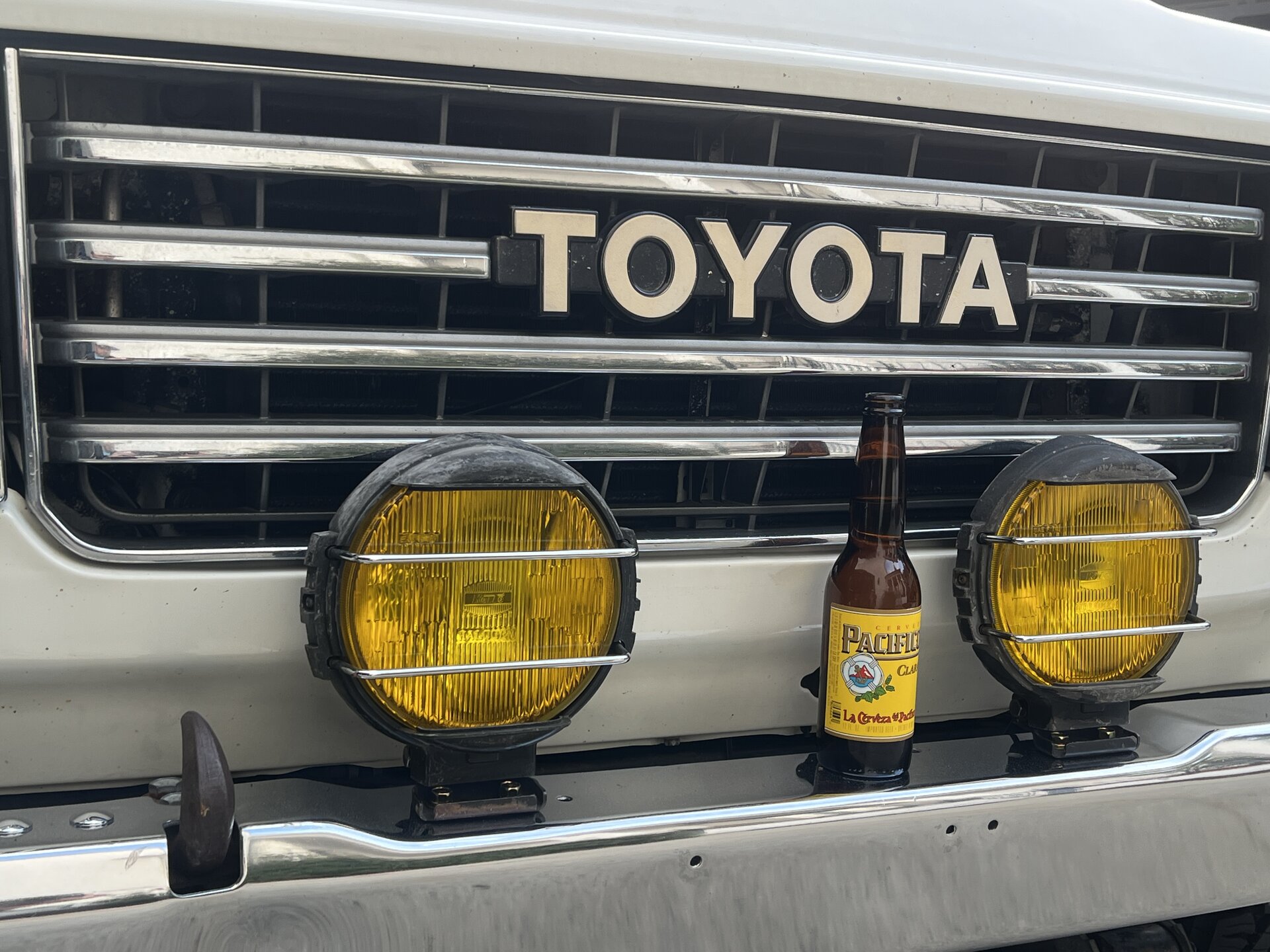

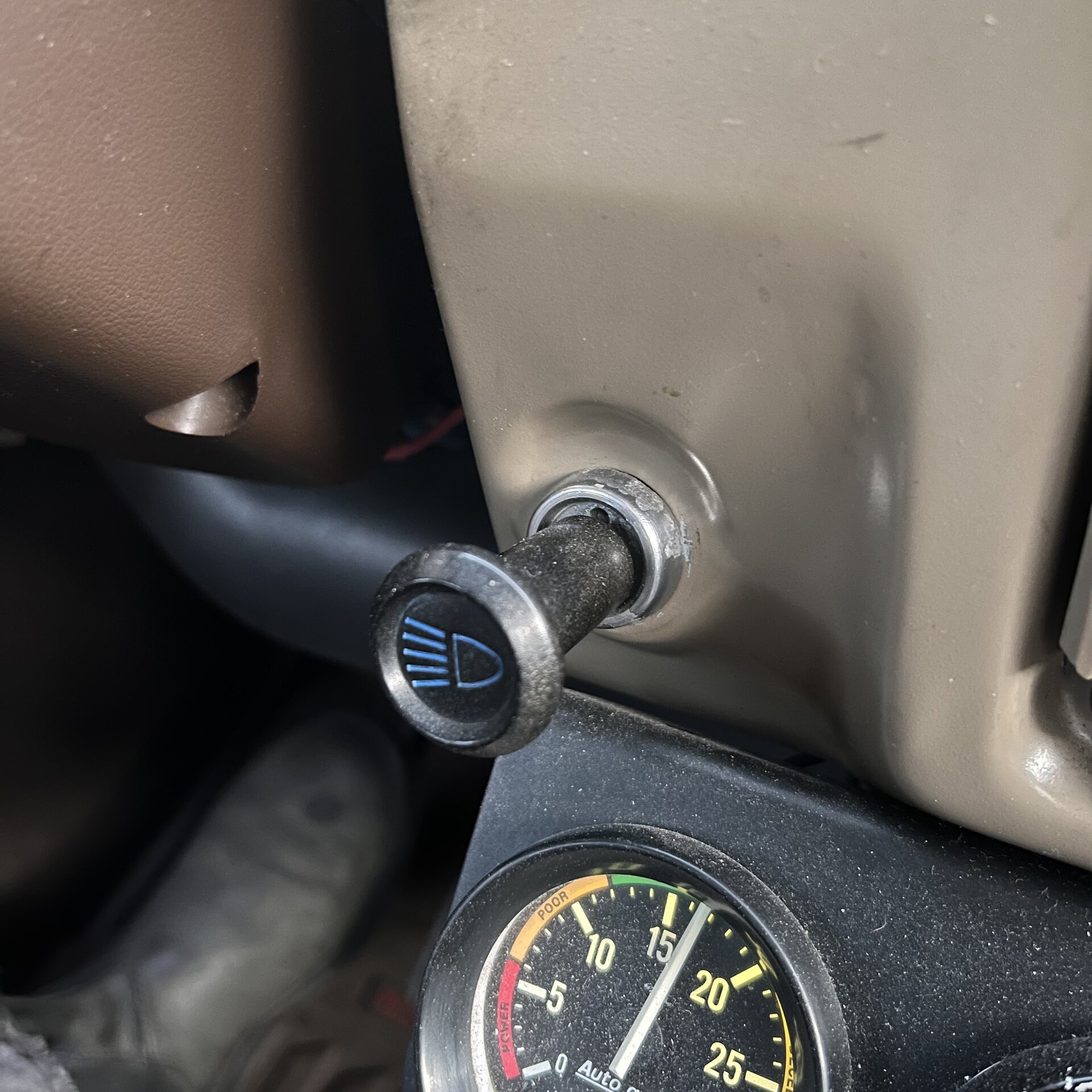

Added some 70 series fog lights from @Cruiser Cult and wired them up with a spare PIAA 510 kit that I had laying around.
Currently using the PIAA switch until I can repurpose my spare rear defrost switch.
Currently using the PIAA switch until I can repurpose my spare rear defrost switch.View attachment 3603222
Those look so good!!
Thank you for the support! :cheers:
