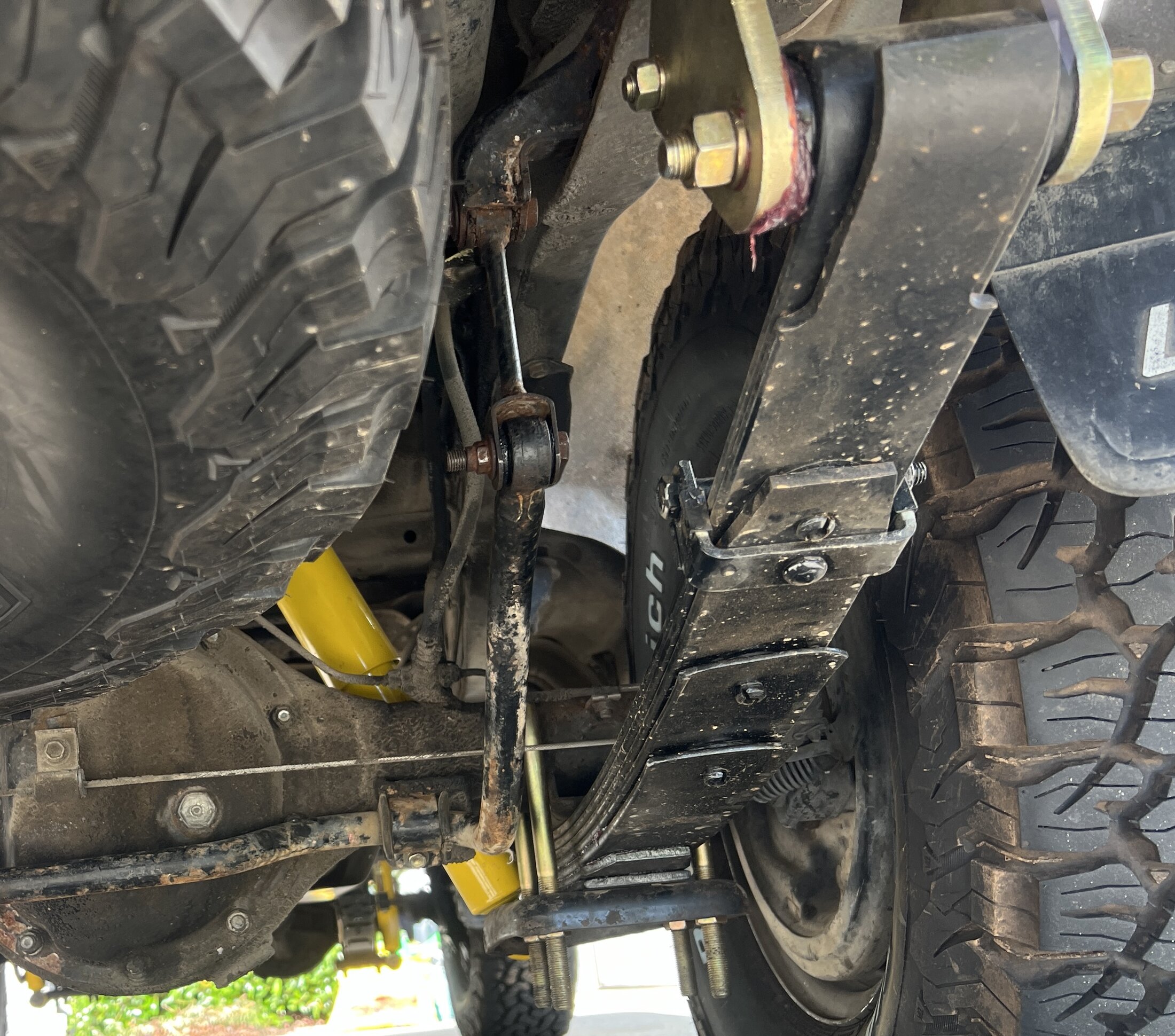

I bolted up an FJ62 rear sway bar.
The bosses were already on the axle housing with M8x1.25 captive nuts, as were the 8mm holes in the frame.
Just added new hardware.

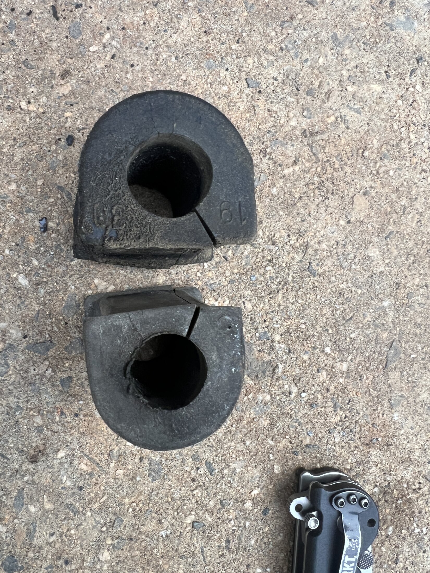

The sway bar end bushings were toast but I reused my old rear sway bar bushings from my 80 series (same size bushings) as they were in better shape. Not new but they will do for awhile.
I'm not sure if the used sway bar which I got from a local part out had extended sway bar links or not but it bolted right up with the Dobinson 2" lift with one spring leaf removed.
There's a noticeable difference driving curvy roads with the rear sway bar installed. Glad I put it on for road driving.

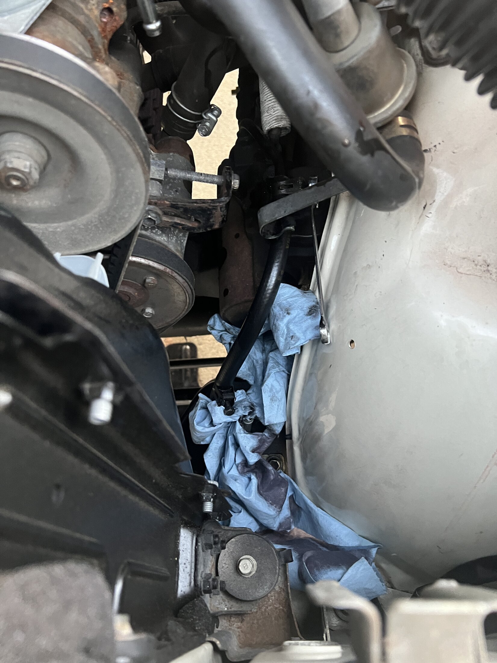

Dodged the bullet on a leaky steering box.
Turned out to be the soft lines that weren't so soft anymore.
Replaced with Napa 3/8".
Clean up took 3x longer than replacing the hoses
