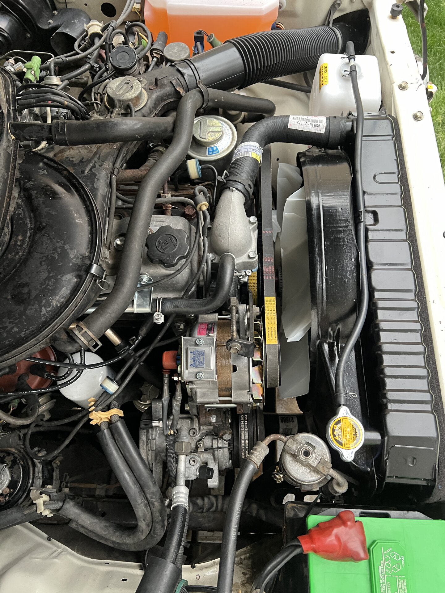

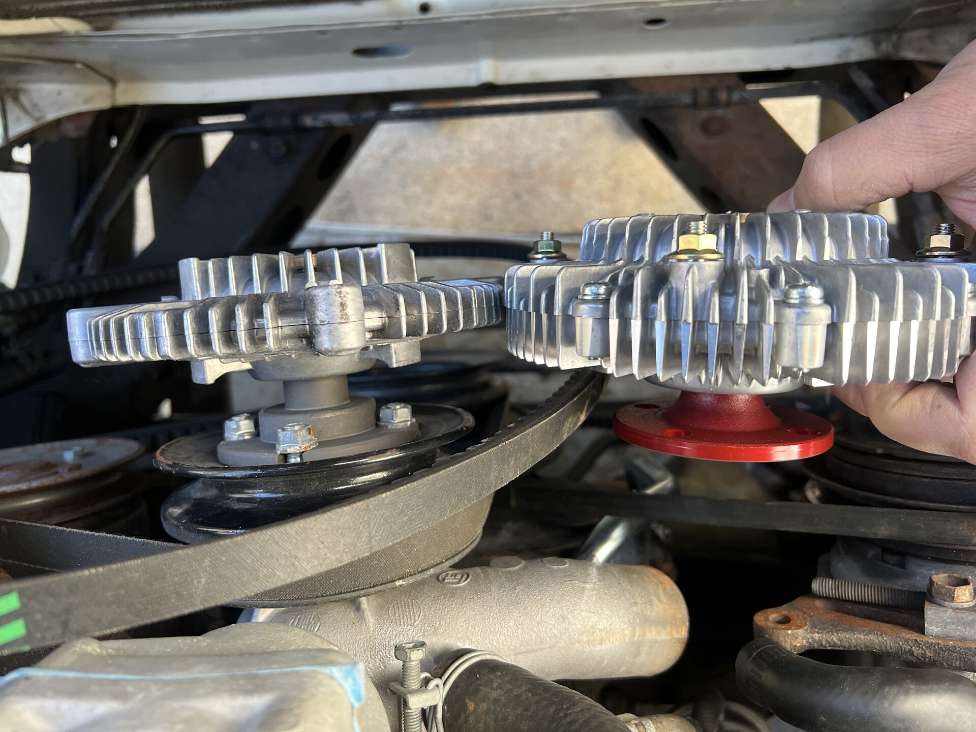

I got a new red hub fan clutch for it too. It is considerably larger than what was in there before.
Thanks! I'm hoping to bring it or the 40.Sam, you're doing great work here. Your attention to detail is second to none! Will we see this beauty at Carolina Relic Run next month?

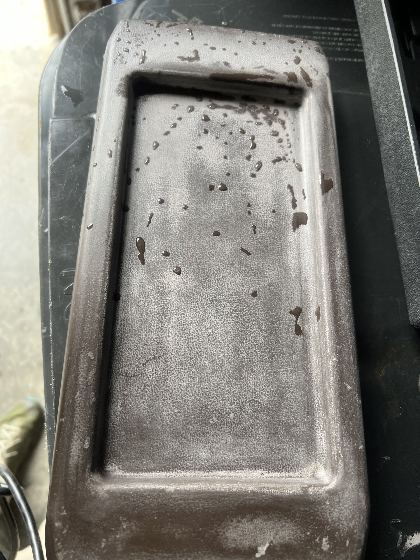

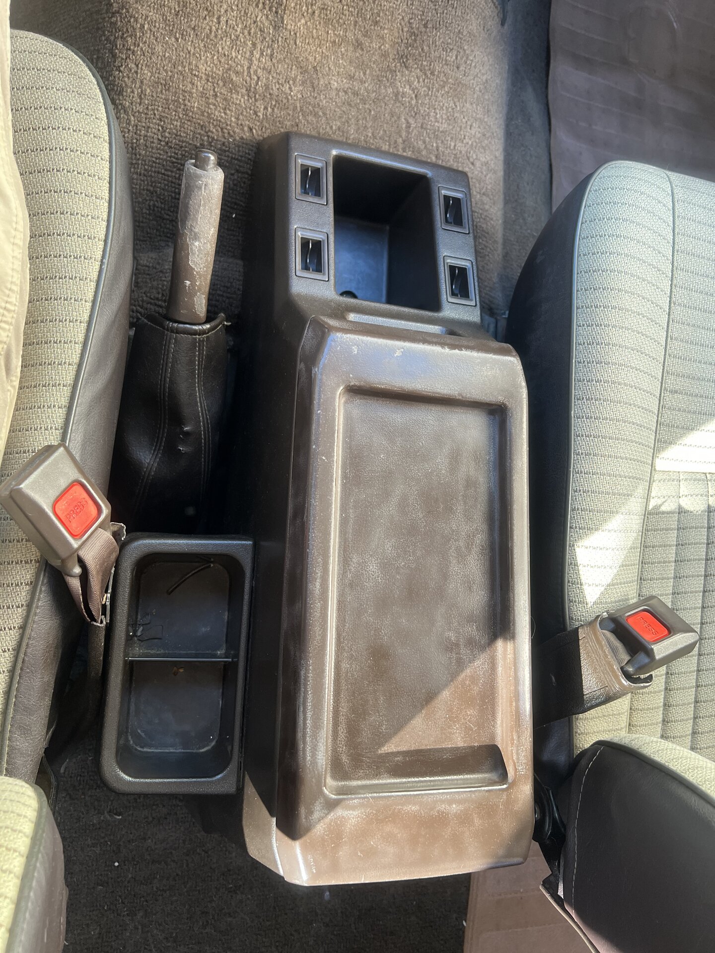

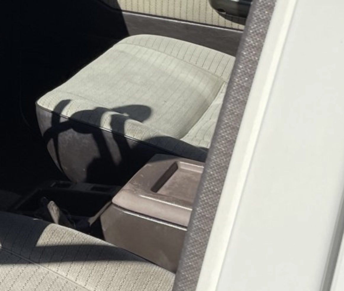

old post... but if you paint this with SEM colorcoat it will look pretty much new. Ive used it on entire dashes on a few IS300s. Im talking about the entire dash and center console sections and they have lasted years and years. My Grey interior 60 is painted in it as well. I think most people are using cordovan brown for the brown interiorsThe console lid was pretty sunfaded and deteriorated.
So I sanded it, then used a heat gun to pull out some color. Afterward I used some plastic polish on it.
Looks a bit better.
That being said, does anyone have a spare lid they want to sell?
View attachment 3288063View attachment 3288062View attachment 3288064
Thanks for the tip.old post... but if you paint this with SEM colorcoat it will look pretty much new. Ive used it on entire dashes on a few IS300s. Im talking about the entire dash and center console sections and they have lasted years and years. My Grey interior 60 is painted in it as well. I think most people are using cordovan brown for the brown interiors
I'll have to look into that. ThanksI've been curious how a Cerakote wipe would work on a high-wear interior plastic like that. Works amazing on exterior textured black plastic.

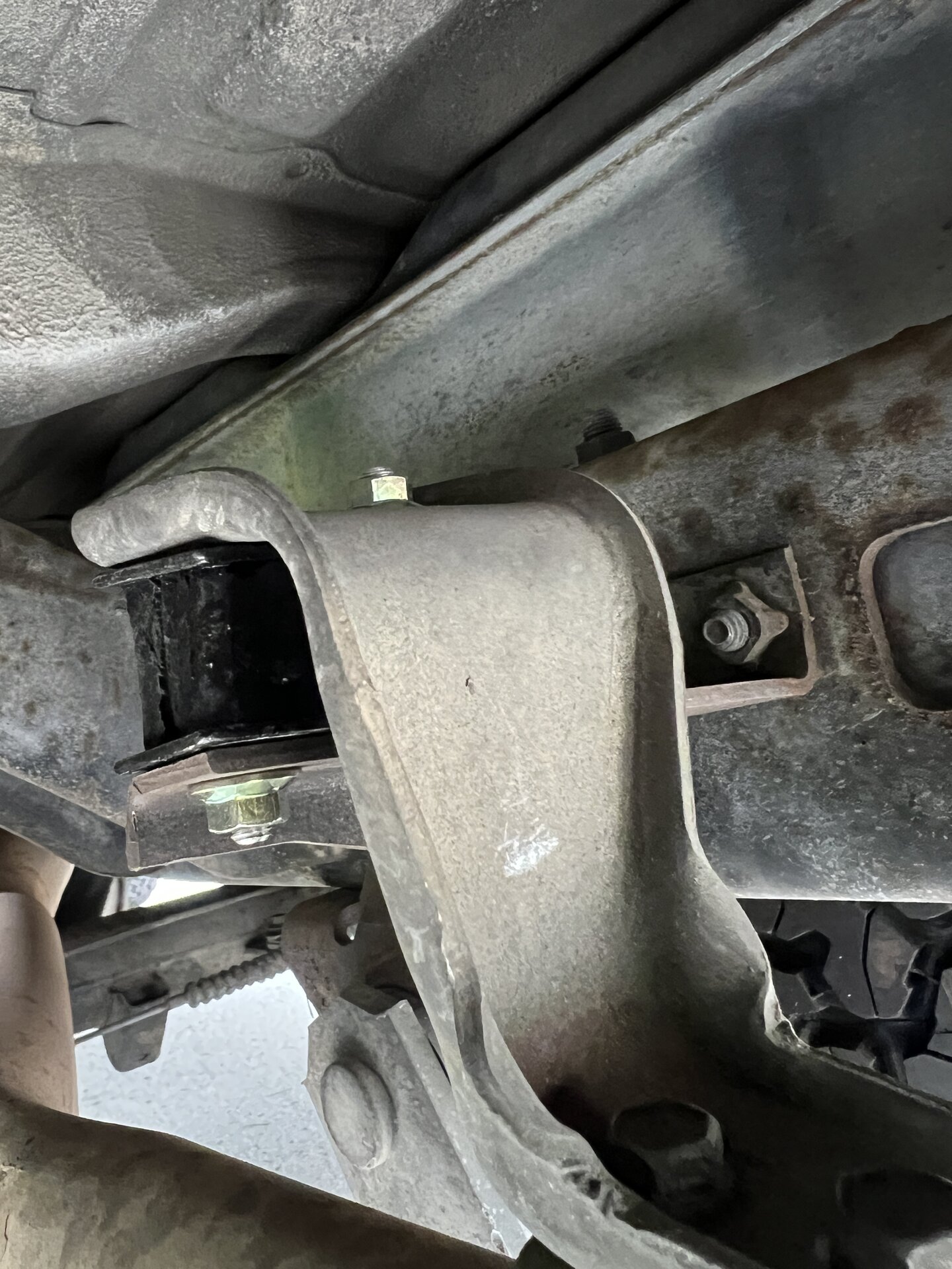

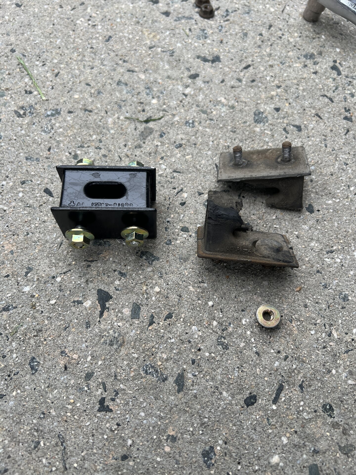

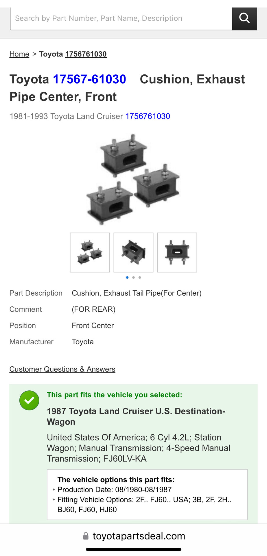

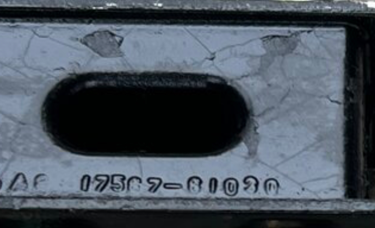

Had a rattling exhaust so I replaced the broken rear isolator this morning and adjusted the hood stops. No more rattle or vibrating hood.

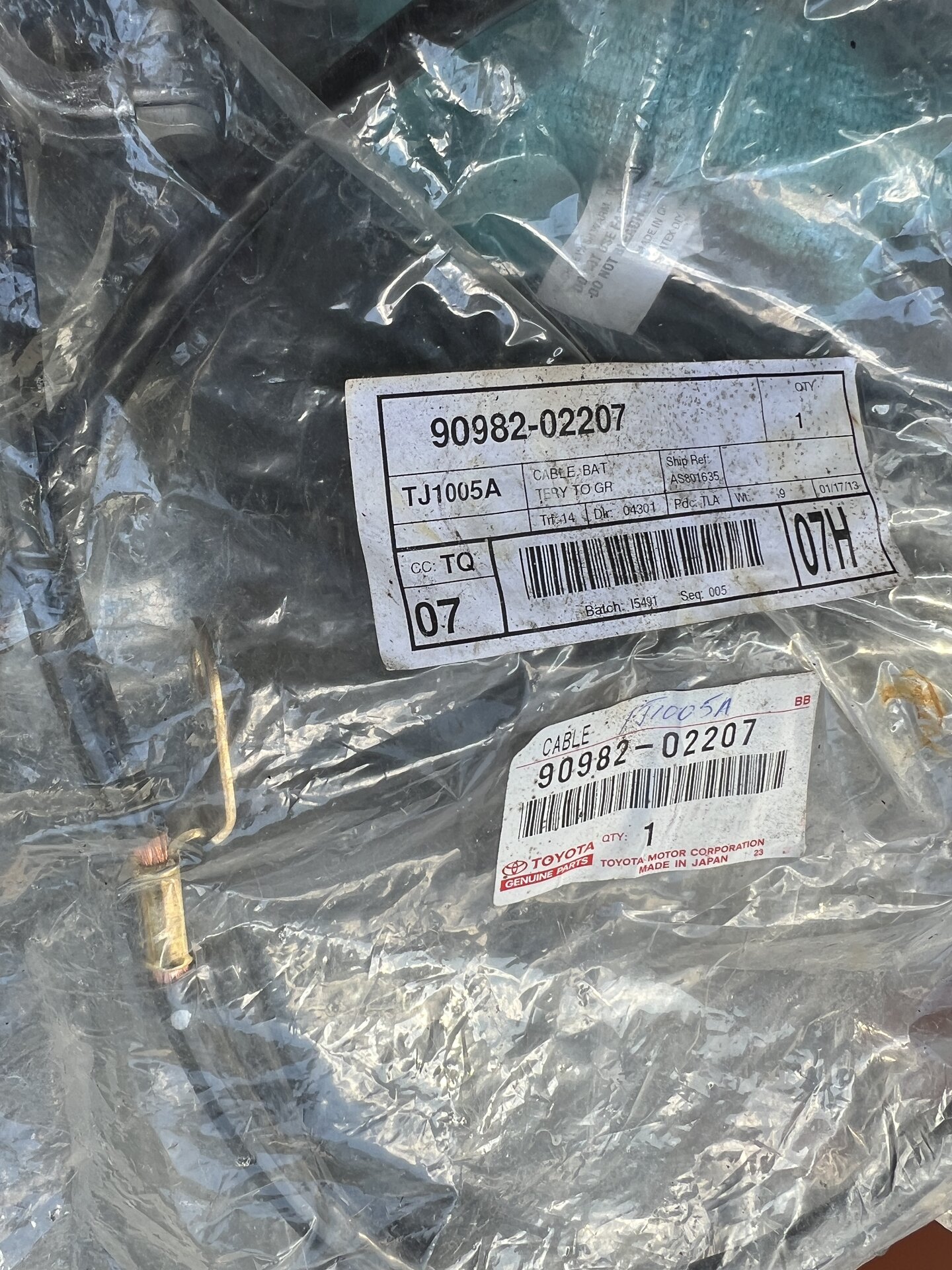

Thanks.Amazing luck, I just recently shredded the bolts on my front hangar taking it off. Thanks for the part #!
Love the build, ill be following.
Do you happen to have the PN for this? I had it somewhere written down and can’t find it. Gonna replace mine as well. ThanksHad a rattling exhaust so I replaced the broken rear isolator this morning and adjusted the hood stops. No more rattle or vibrating hood.
View attachment 3588419View attachment 3588420
Thanks!It's in the pic in post #74View attachment 3588481View attachment 3588483
It obviously works for the rear mount too
