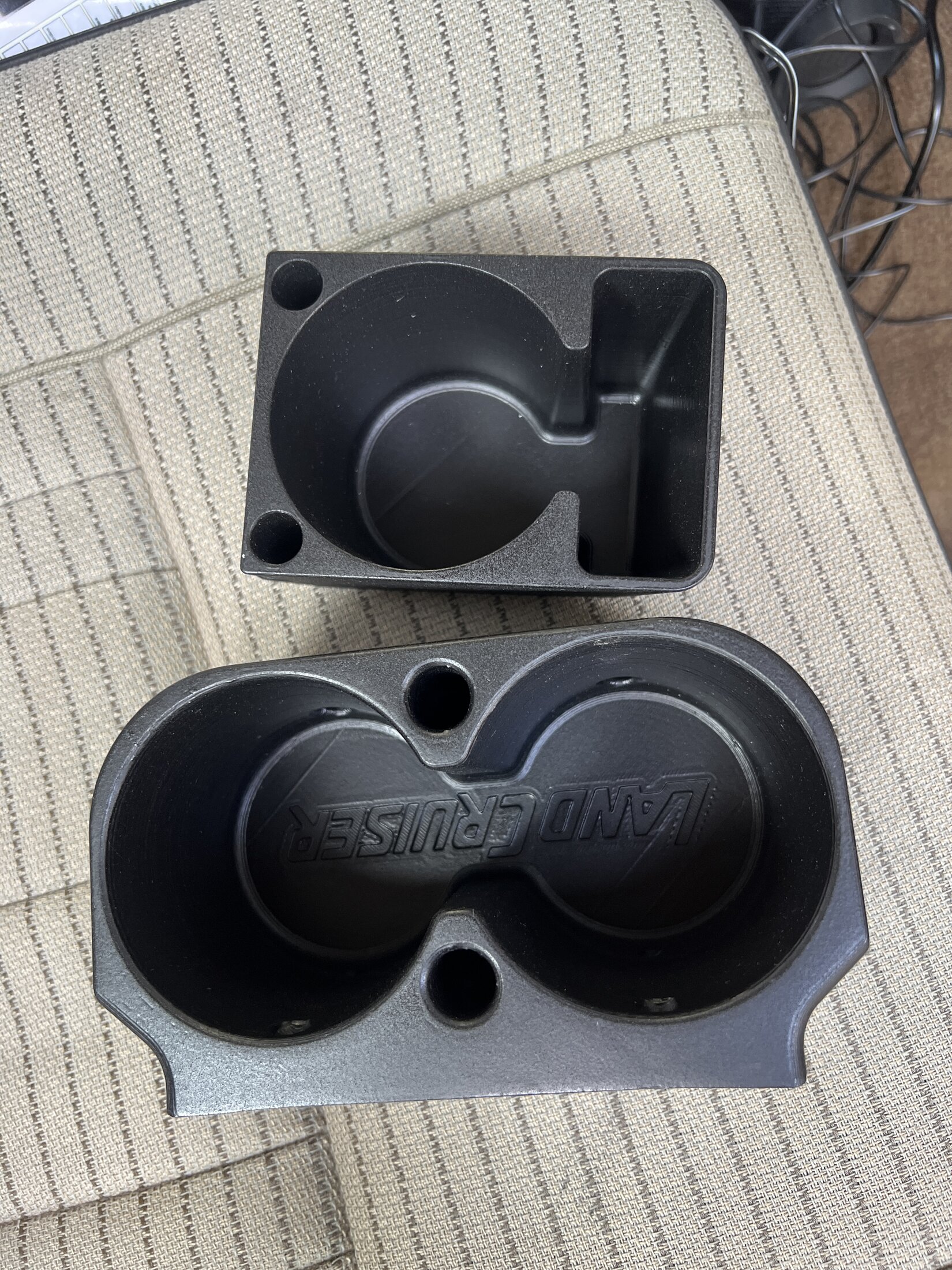

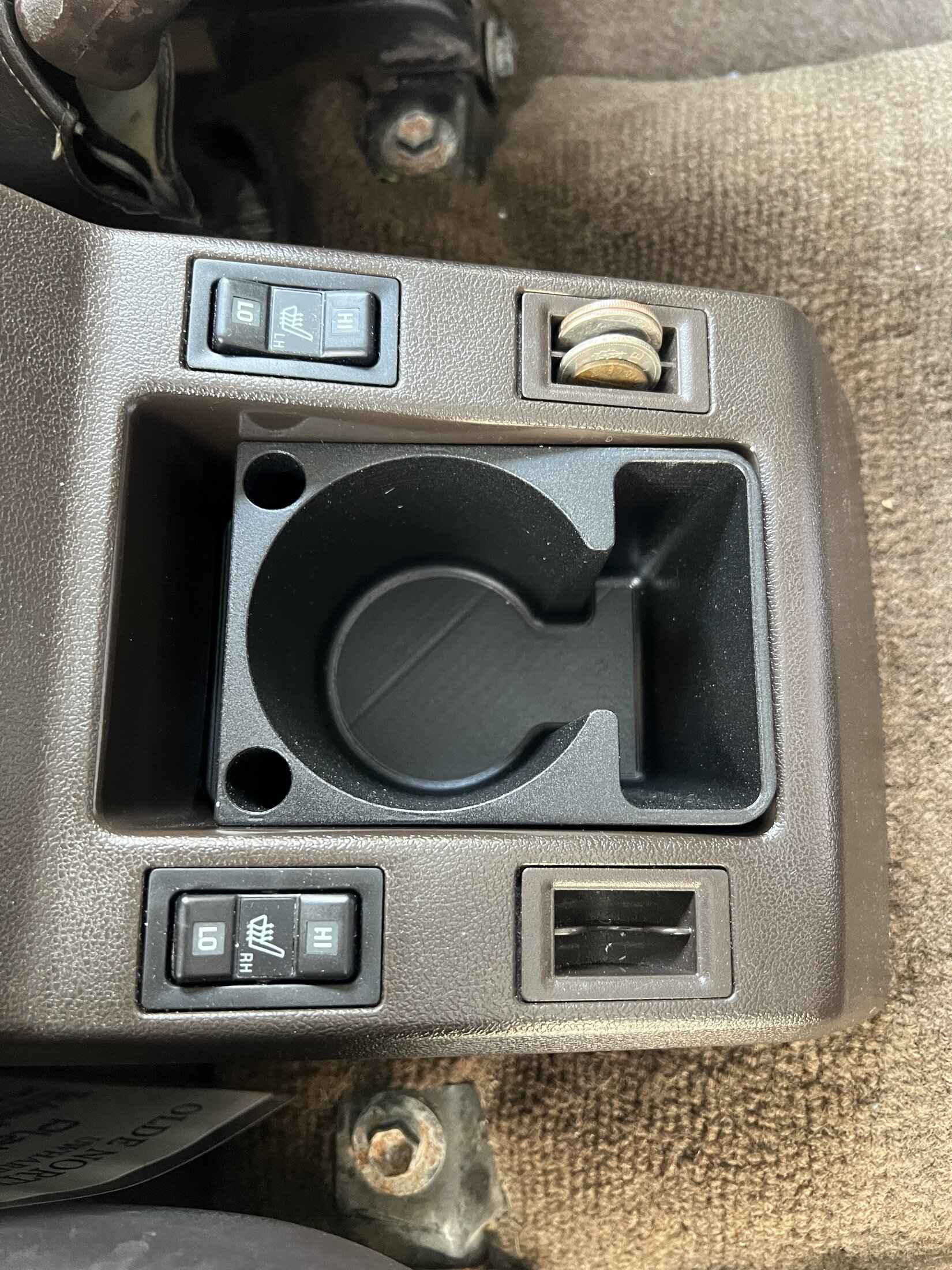

I have these at the house too. They’re super high quality. Doing a little cleaning/restoration of the console while it’s all out and before I put these in. Great fit and extremely high quality.
Yeah, they are nice. I have a nice grey console lid that will get sprayed cordovan brown with these.
I think they'll look really good and add a lot of functionality for a daily driver

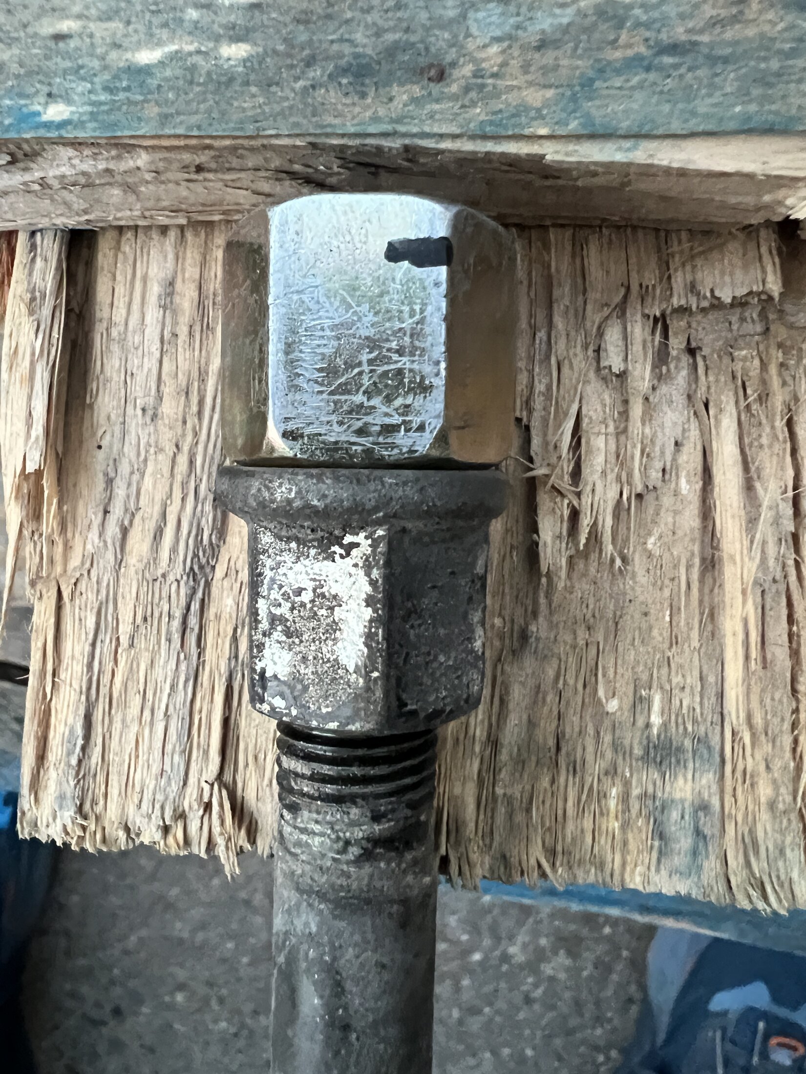

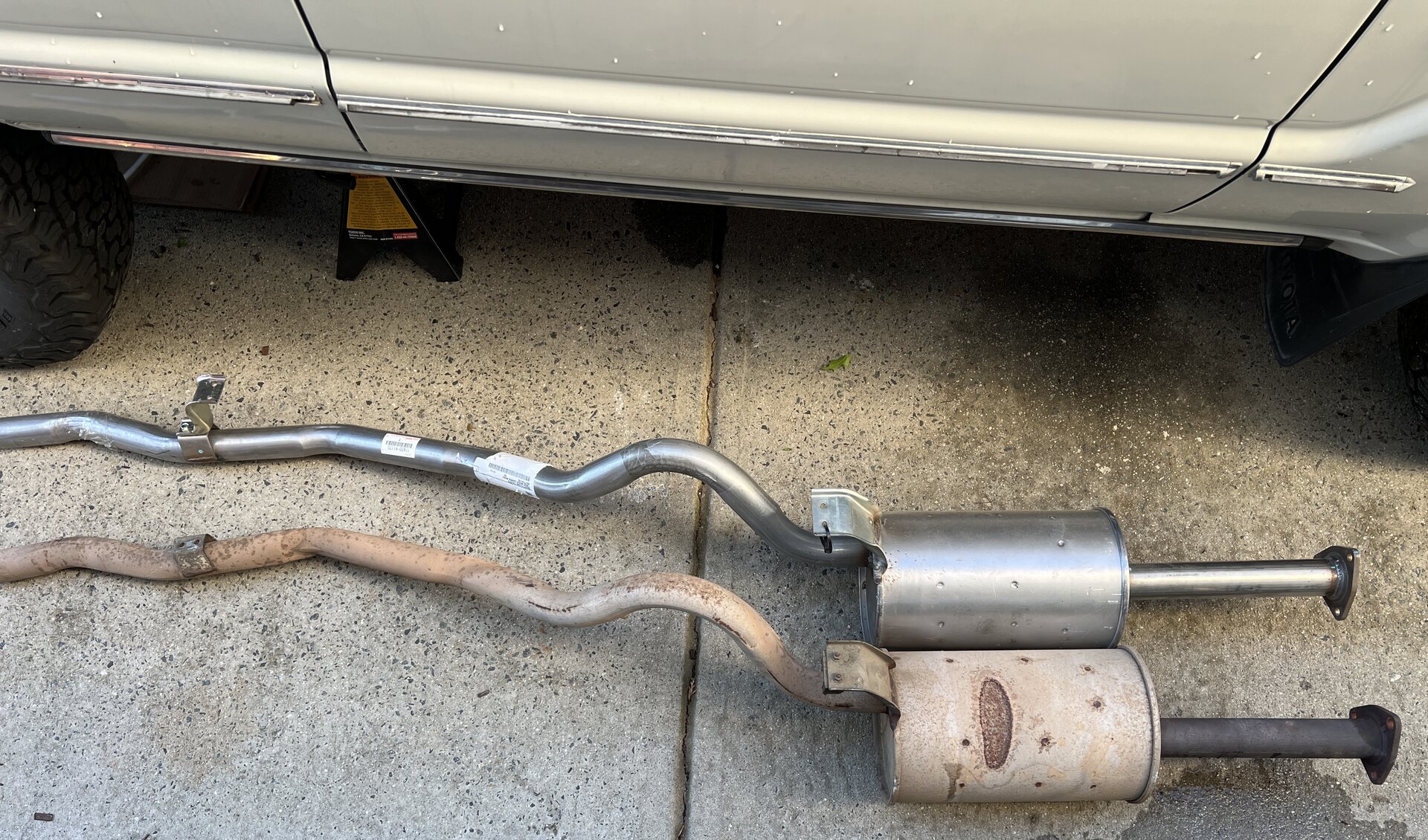

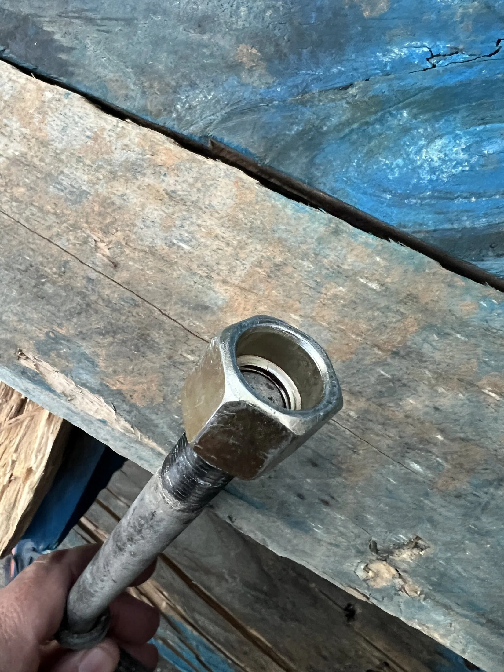

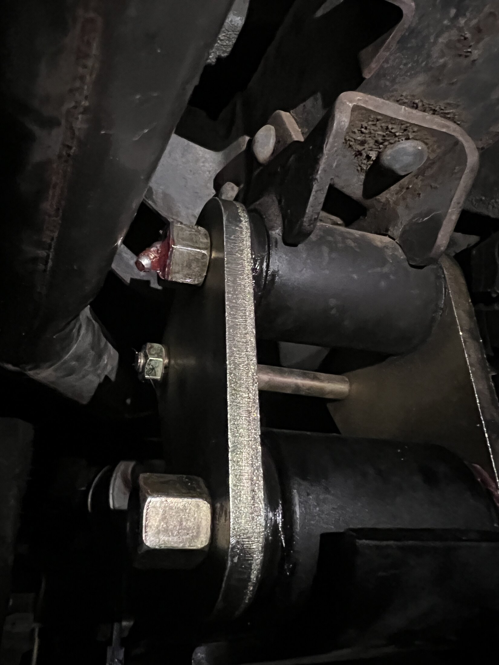

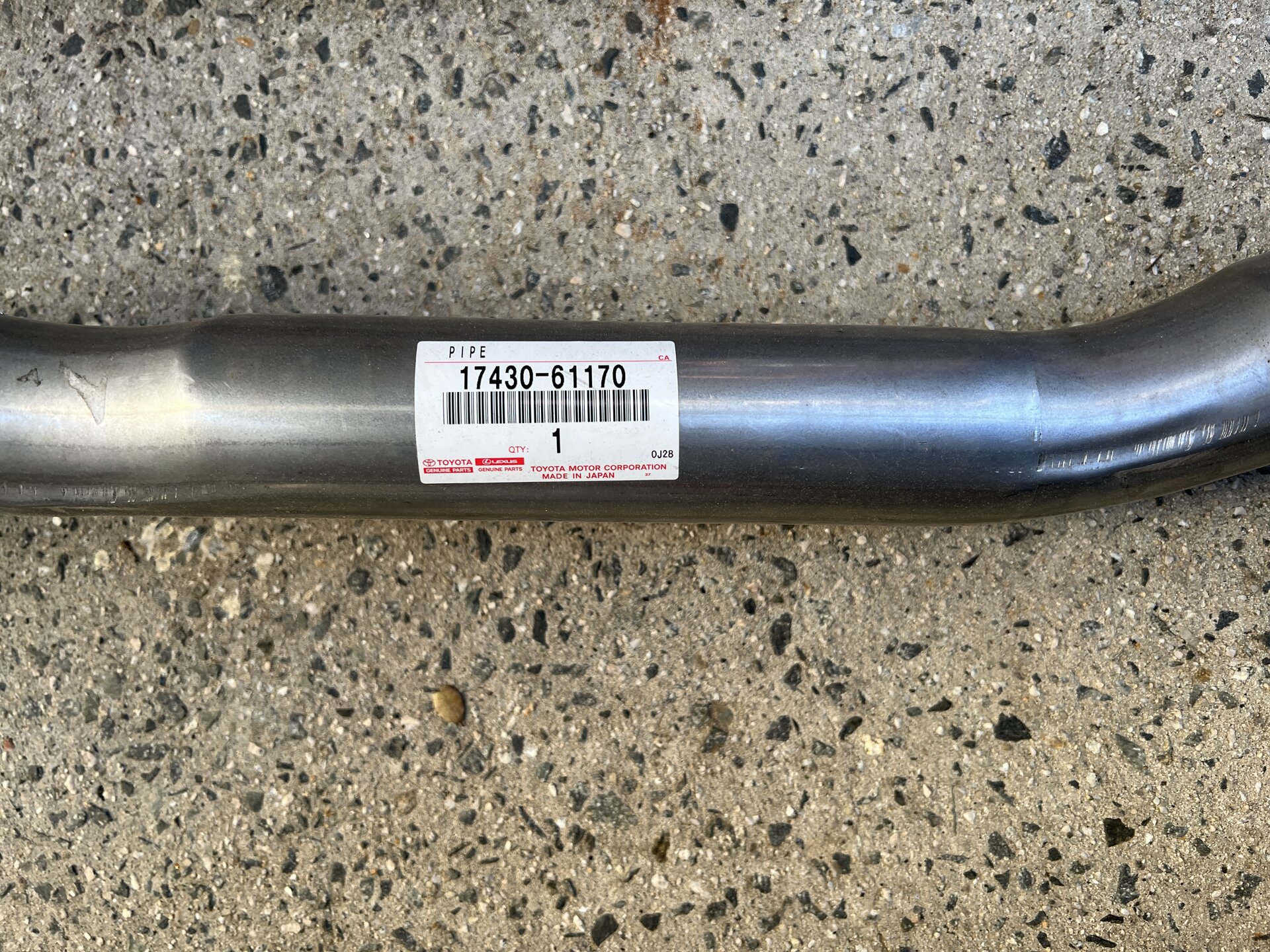

I also encountered that the stock exhaust would not clear the spring shackle for removal so it had to be removed.
I may reverse it and test it out if greasing that upper zero becomes an issue.
Luckily I had a new stock exhaust, hardware, isolators and gasket on hand to put in.
My old one had a couple holes and needed replacing.
View attachment 3606062View attachment 3606063View attachment 3606064View attachment 3606065

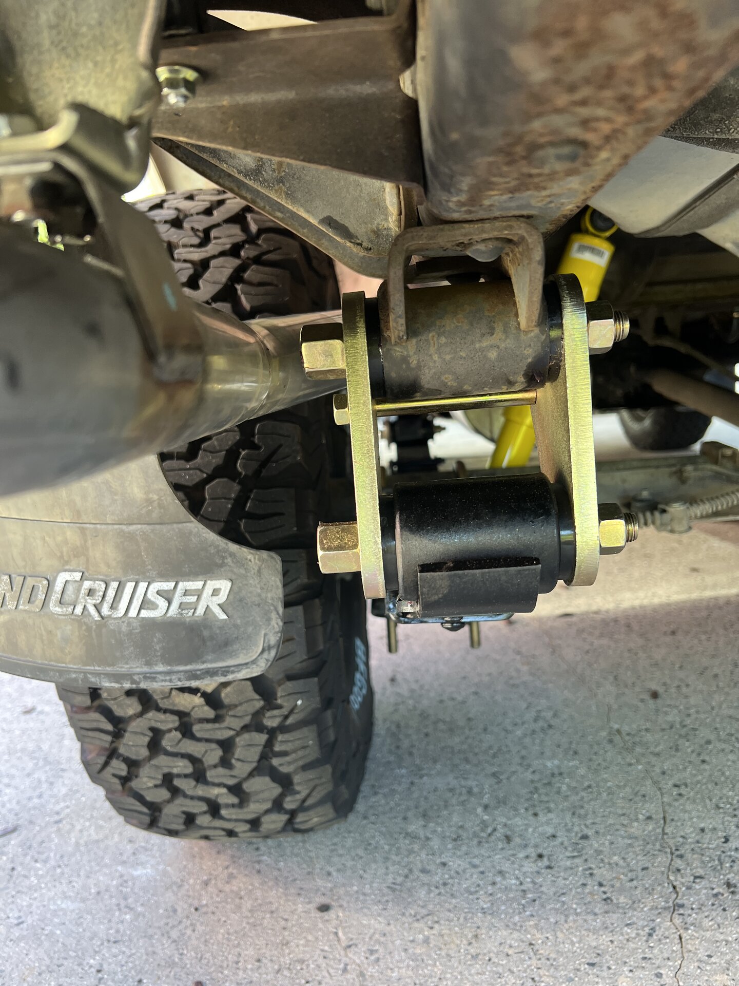

So reversing the bolt wasn't an option unless I wanted to remove my new exhaust. Not really practical either whenever I needed to re-torque the suspension hardware.
I ended up grinding down the Dobinson nut that provides protection for the zerk. I got a 45 degree M8 x 1.0 thread pitch zerk fitting at Ace Hardware.
I had to remove the two new exhaust bushings and move the exhaust out of the way to have enough room to do this but now I can easily grease that zerk and torque the shackle pin hardware.

I didn't have "nice new exhaust", so just cut off the exhaust and will have the pipe welded back on. Nice work!
Sadly not many will ever have a nice new Toyota exhaust on their 60 as that part went NLA soon after I got mine.
By the time I put it on they were long gone.

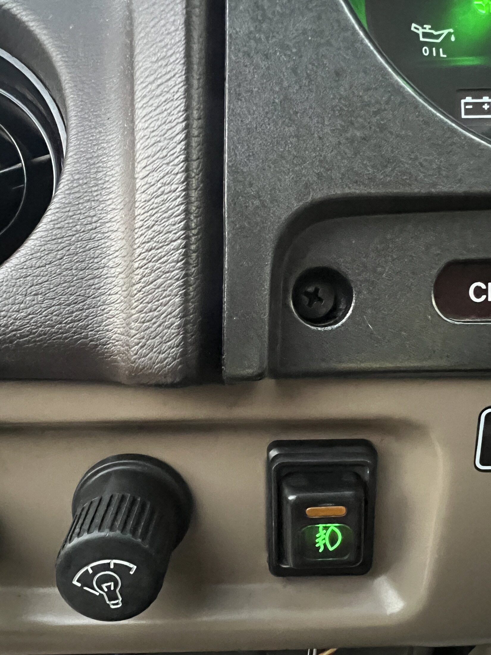

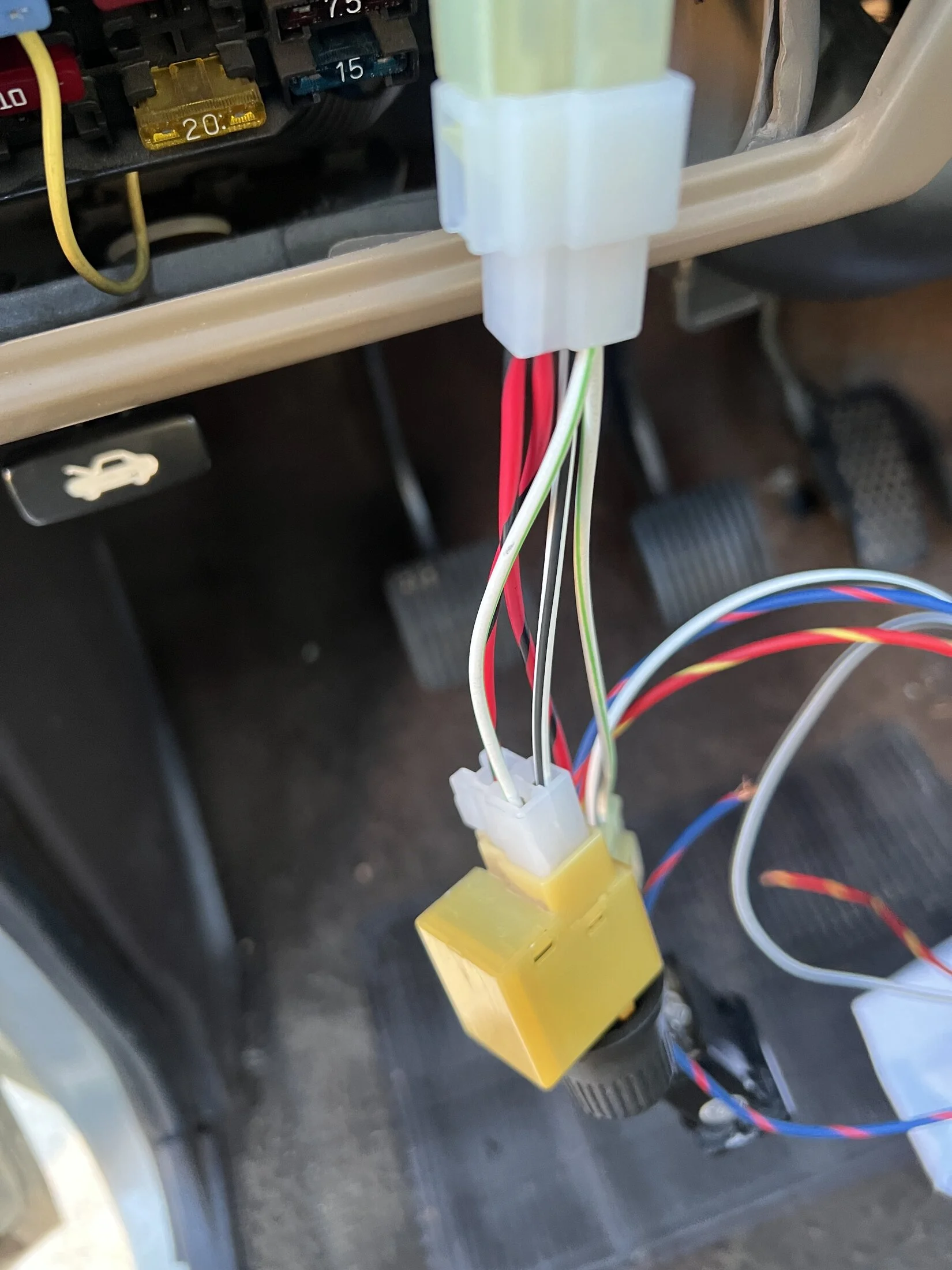

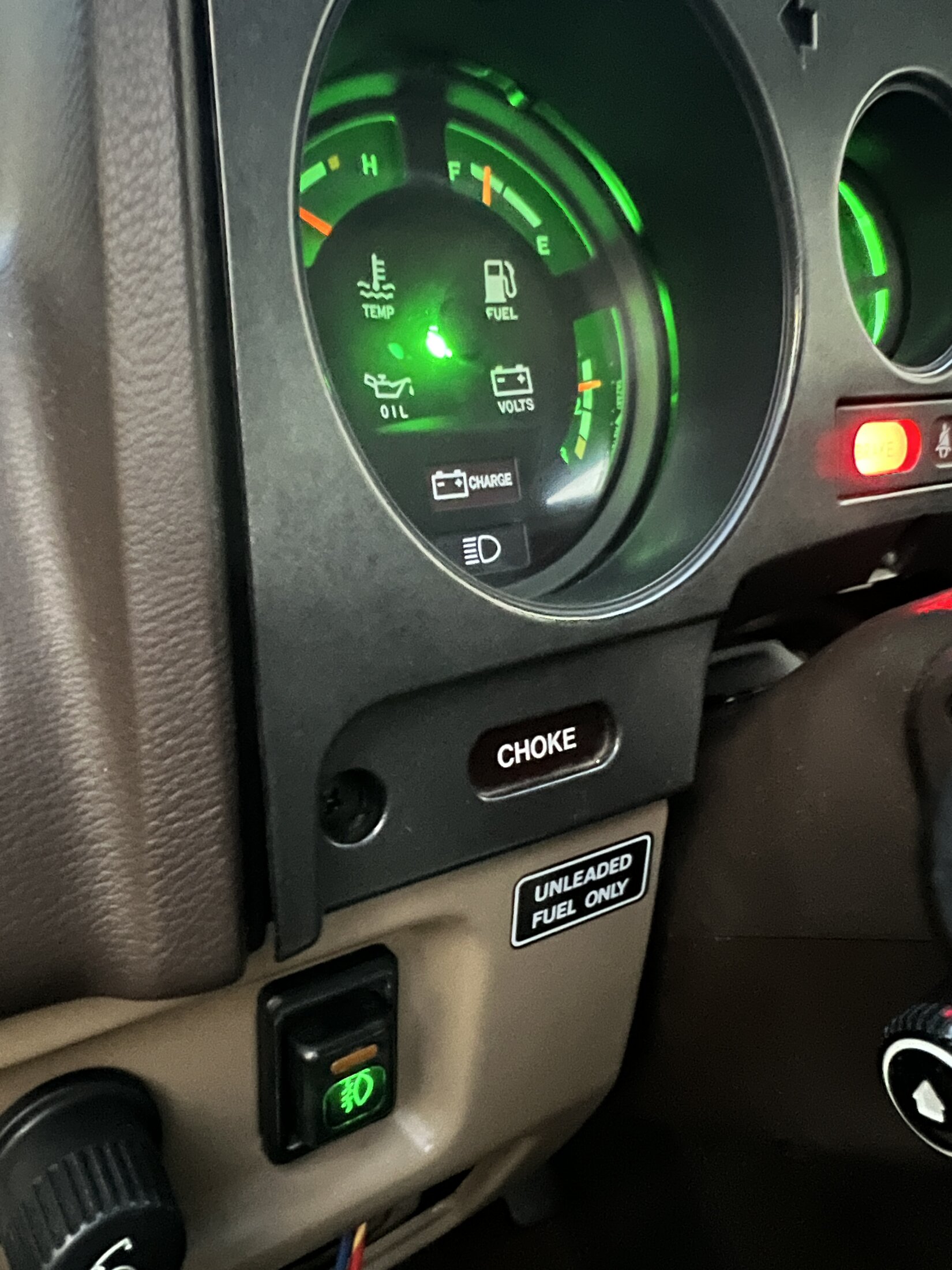

Made a pass through jumper harness to pull feed the illumination circuit to a repurposed defrost switch. I used high quality connectors from @Coolerman
I got the switch a couple of years ago from @ToyotaMatt but never got around to installing it until now.
Oh the alignment pin on the switch needed to be filed down since there is not a corresponding notch on the dash.
What it do?
Maybe I missed it.
What it do?
Maybe I missed it.
It taps into the illumination circuit for the dash lights. It pulls off the dimmer dial switch and feed + & - for the newly added fog light switch

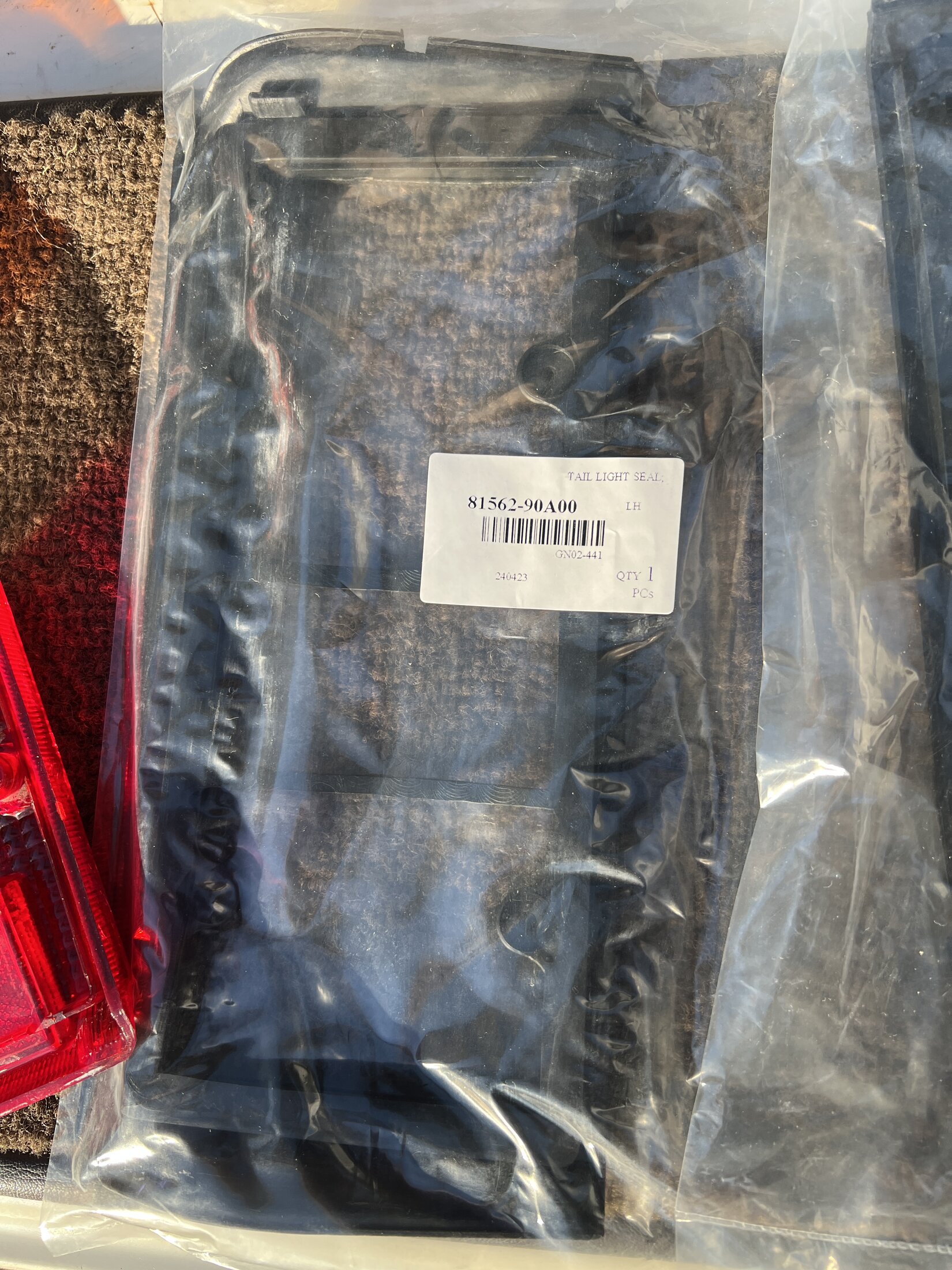

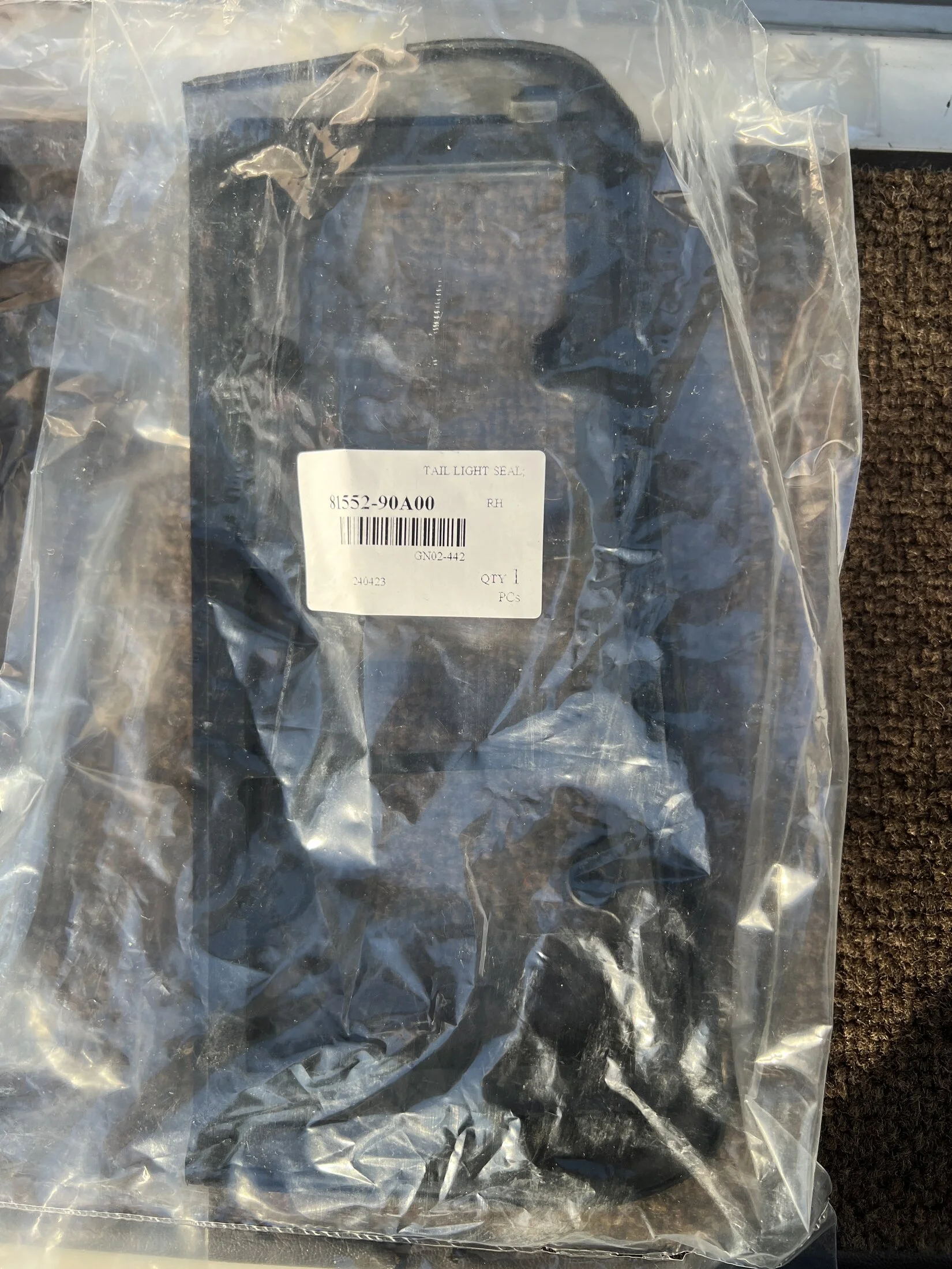

So I ordered a second set of tail light seals from @cityracer and these were mislabeled too.
Good thing I ordered the pair, I only needed the right as I misplaced the previously purchased right side seal/gasket.
Beware if you need a Left seal order a Right and vice versa.
Good thing I ordered the pair, I only needed the right as I misplaced it.
Beware if you need a Left seal order a Right and vice versa. View attachment 3854589View attachment 3854591
Have you reached out to him about this?
In my experience he’s pretty spot on with making things right.
No need. It's not a big deal. If you buy a pair you get a pair. The bags are just mislabeled to the opposite side.

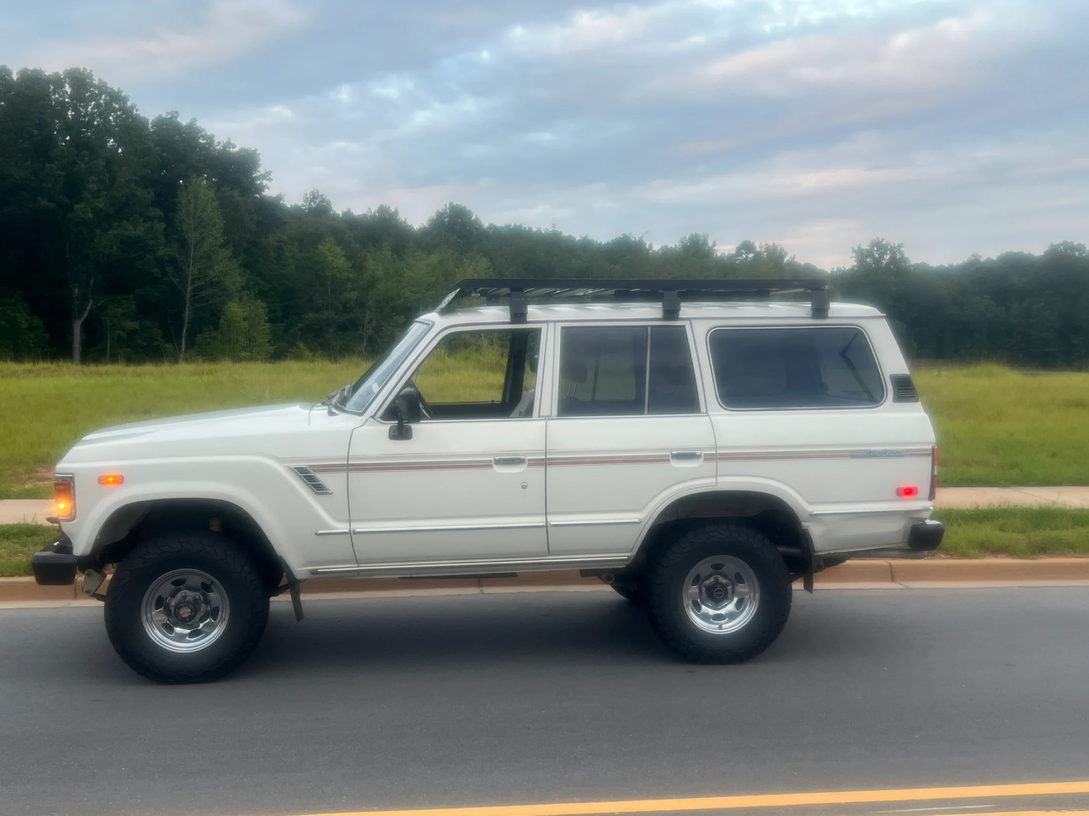

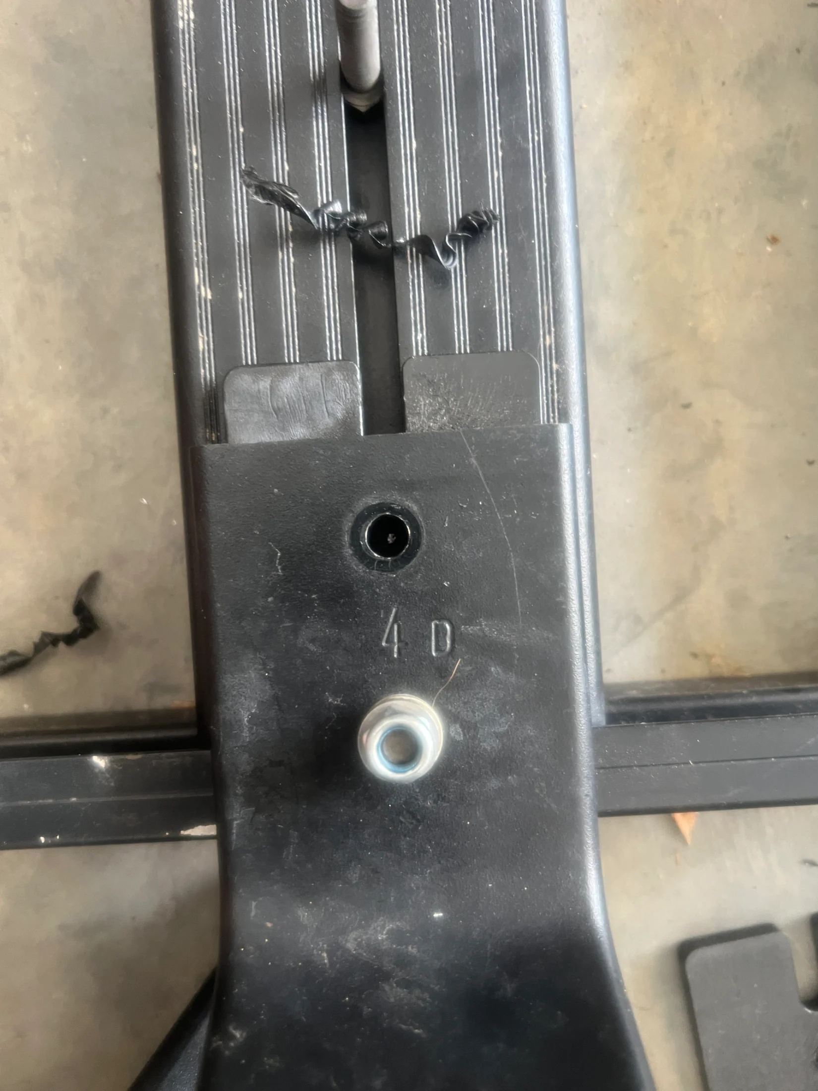

Put on my 100 series FrontRunner roof rack on the 60.
I used some FrontRunner 80 series gutter mounts.
The rack tray is a bit shorter and narrower than the purpose built 60 series rack.
It needed some FrontRunner 6mm spacers between the crossbars and top of the gutter mount arms.

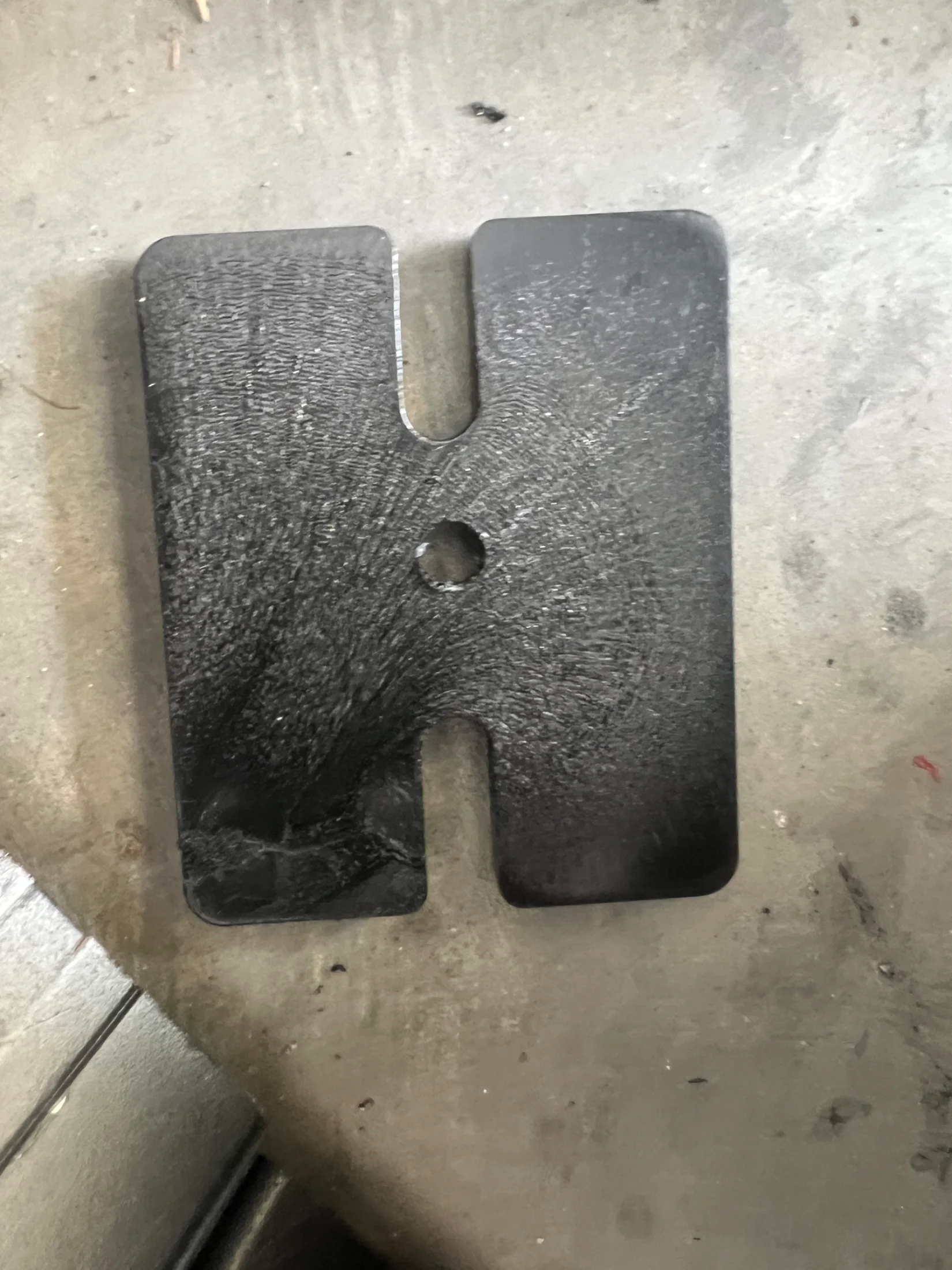

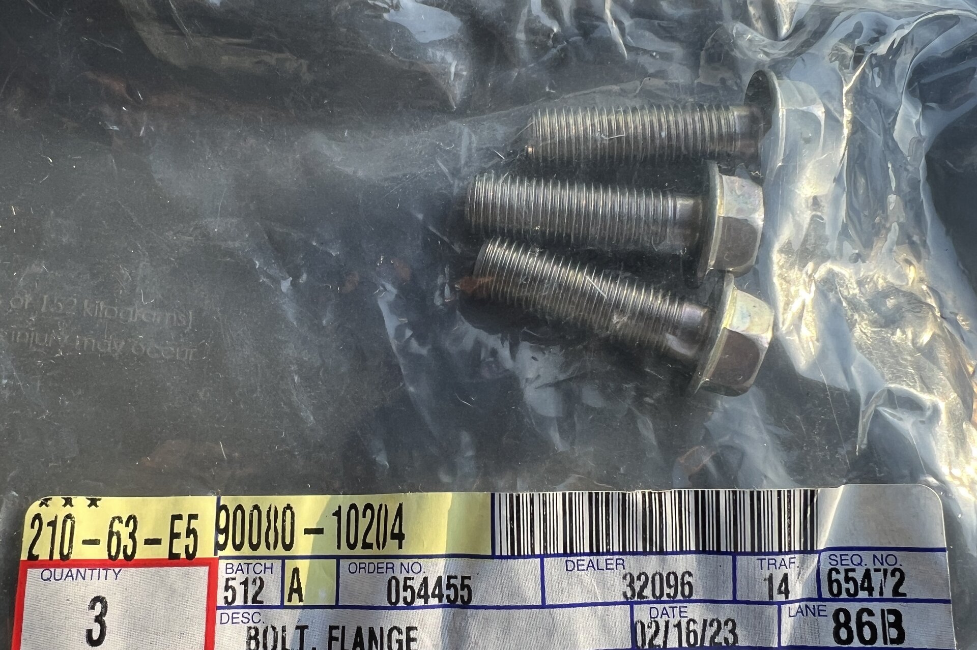

Contrary to the WKOR instructions requiring a qty. of 12 spacers, on my '87 60 I needed 17, 1/2" spacers and M8x1.25x30mm bolts to move all of the brake & fuel lines off the inner passenger frame rail.
I found some Hillman brand spacers from HomeDepot sized
5/16" I.D. x 5/8" 0.D. x 1/2" Long & some 30mm flanged bolts.
Here's the the new Hillman spacer/bolts vs. the WKOR spacers in zinc.
