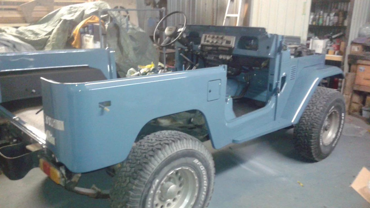

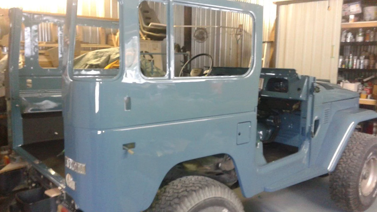

my "new" 1984 bj42 Miss dirty blue

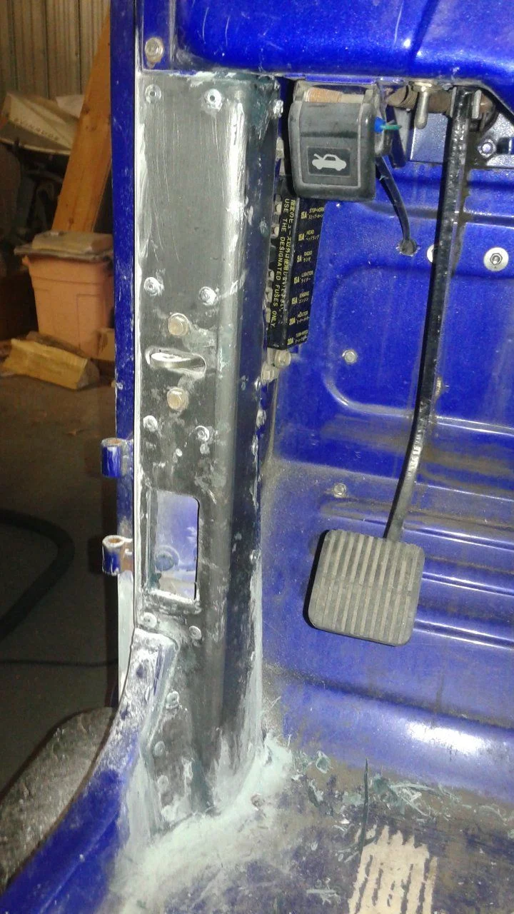

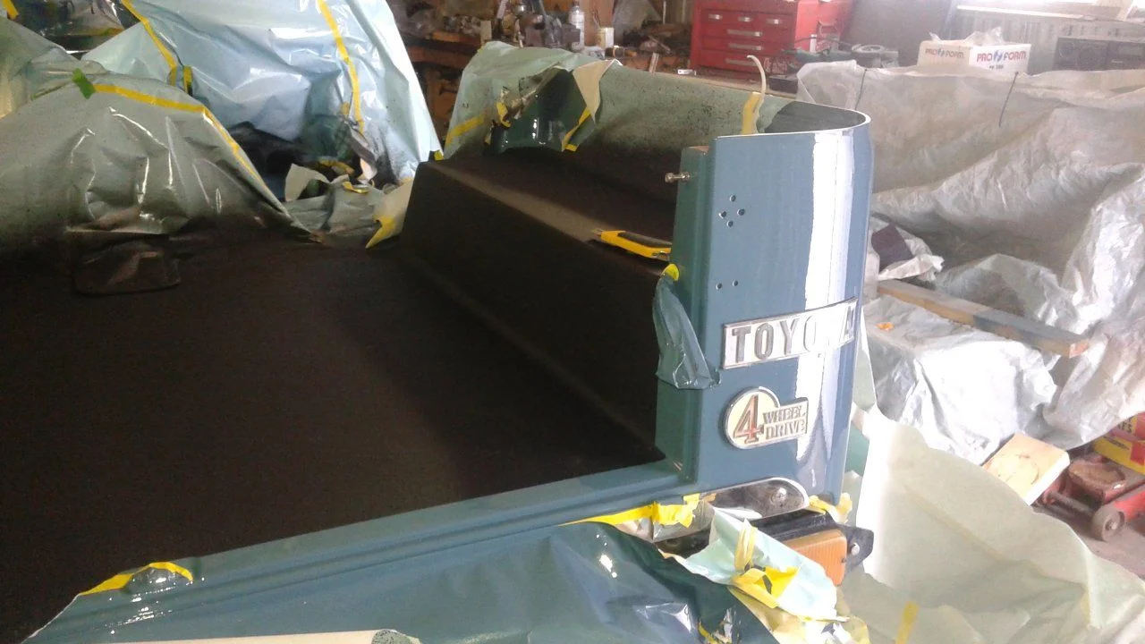

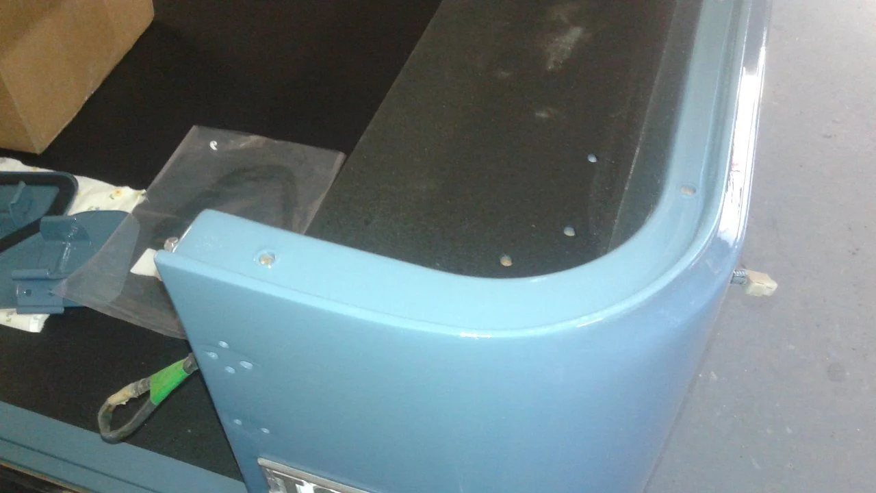

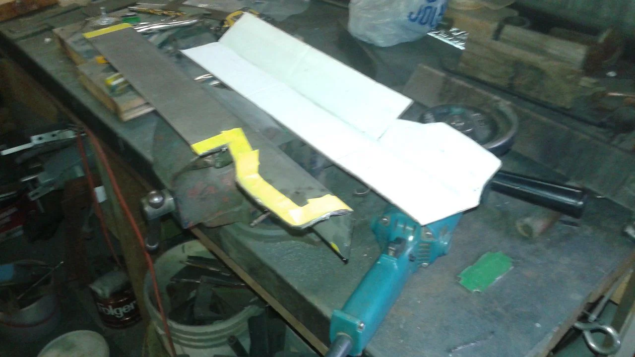

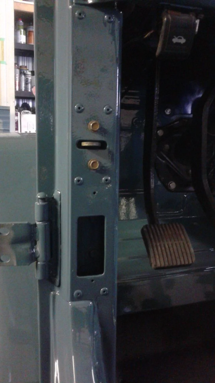

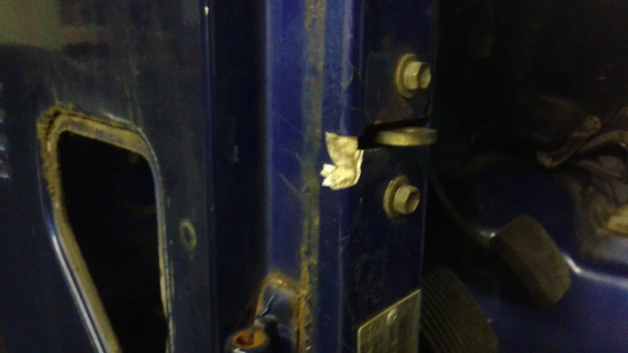

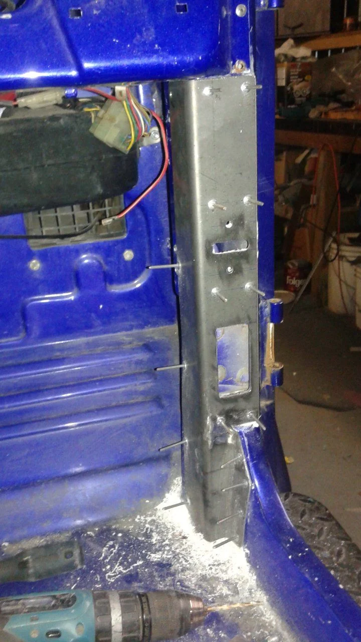

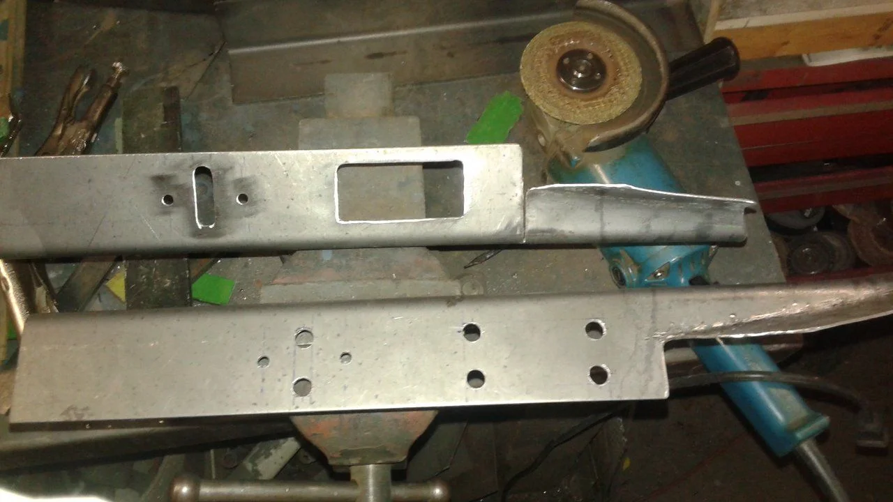

the A pillar on the gozzard tub is not strong enough and it flex and crack when the door get fully open, so i build some metal reinforcement , glued on with fiberglass puty and pop rivets

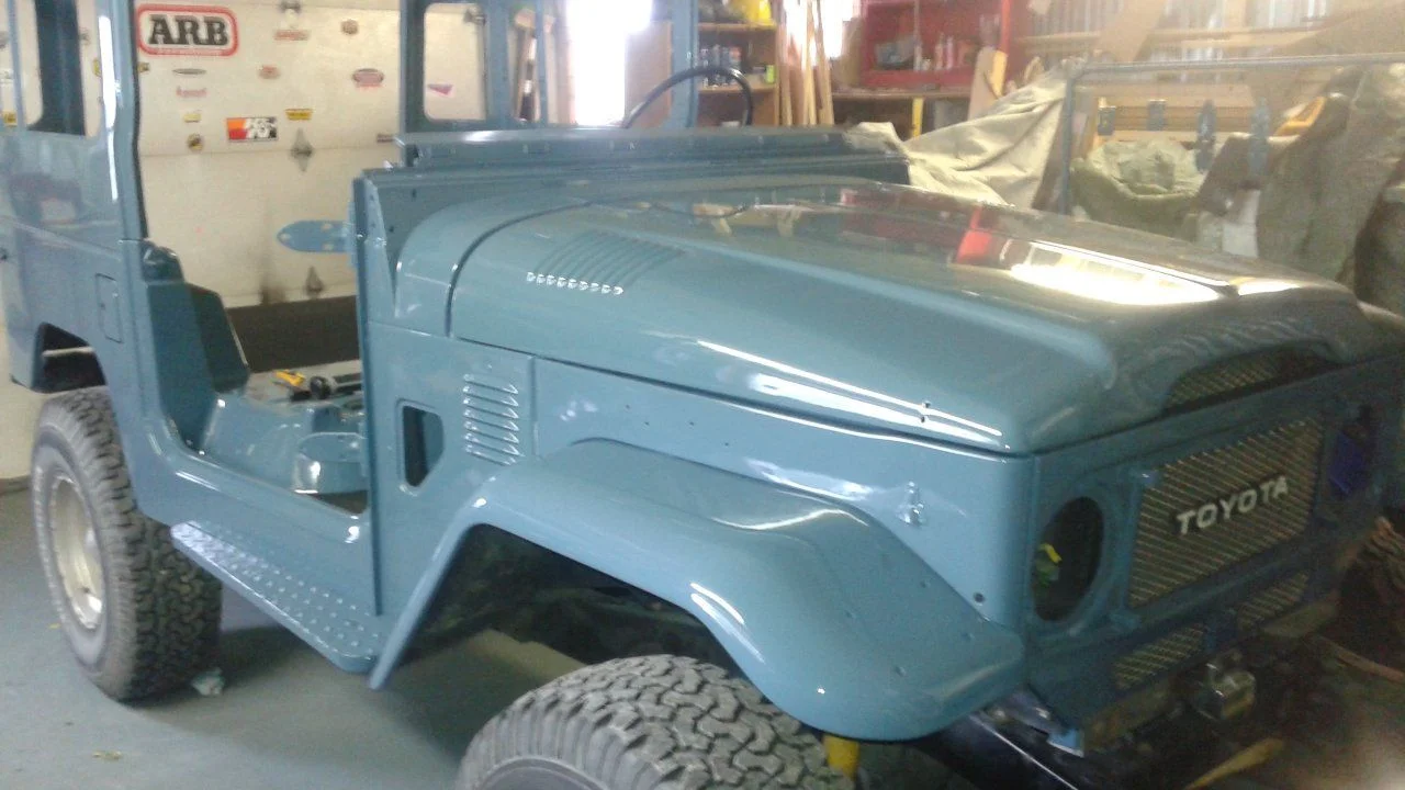

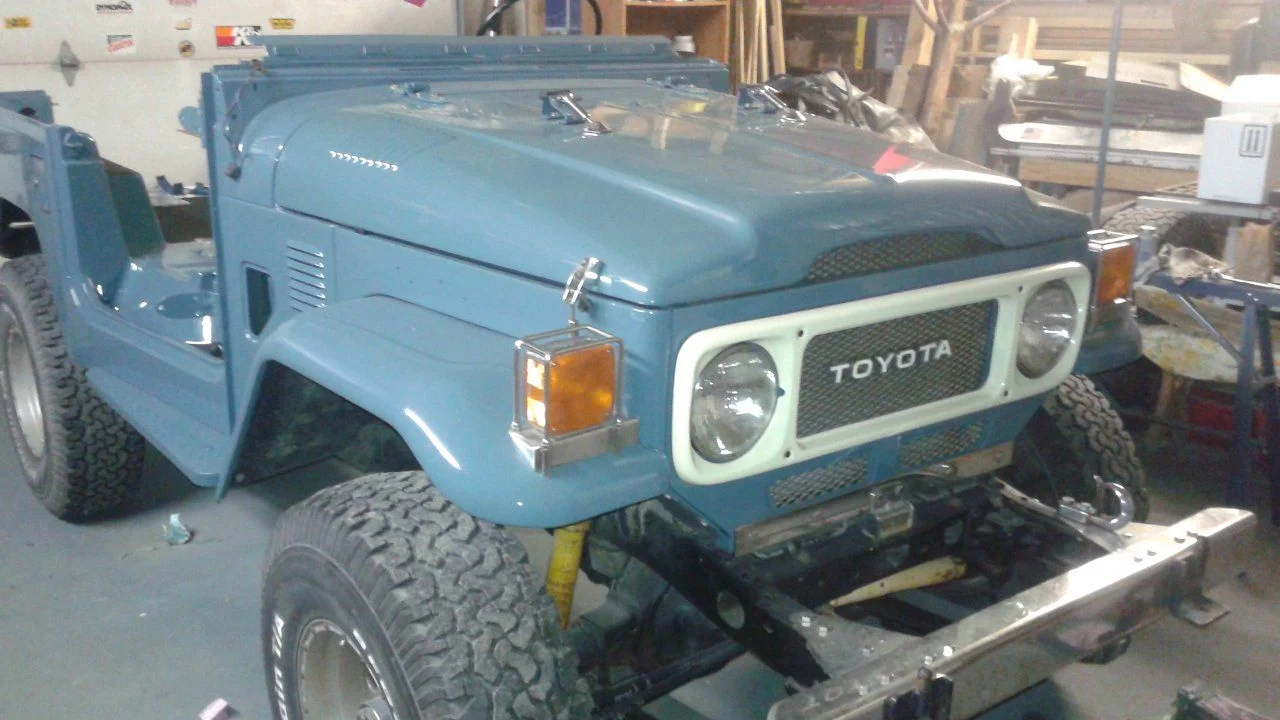

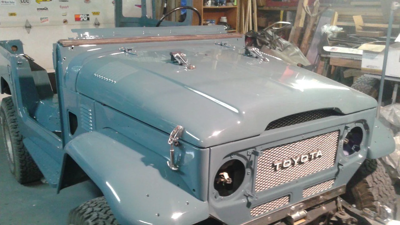

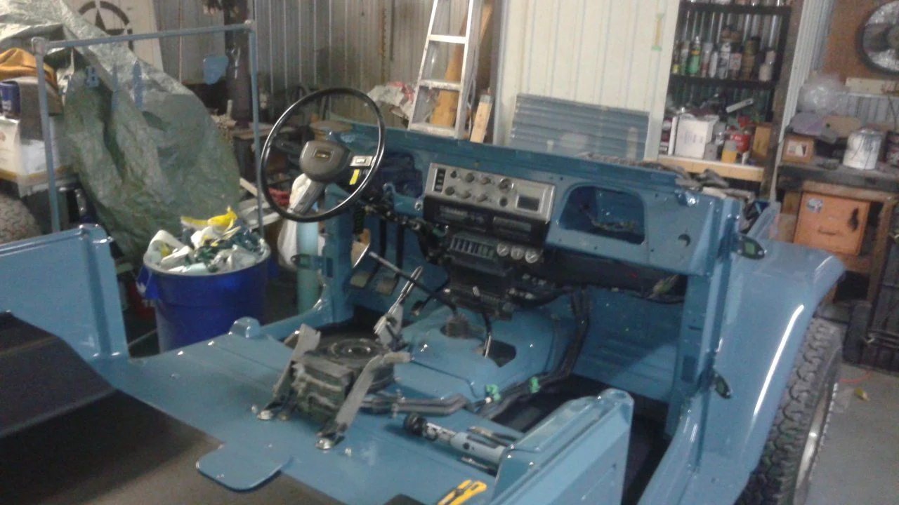

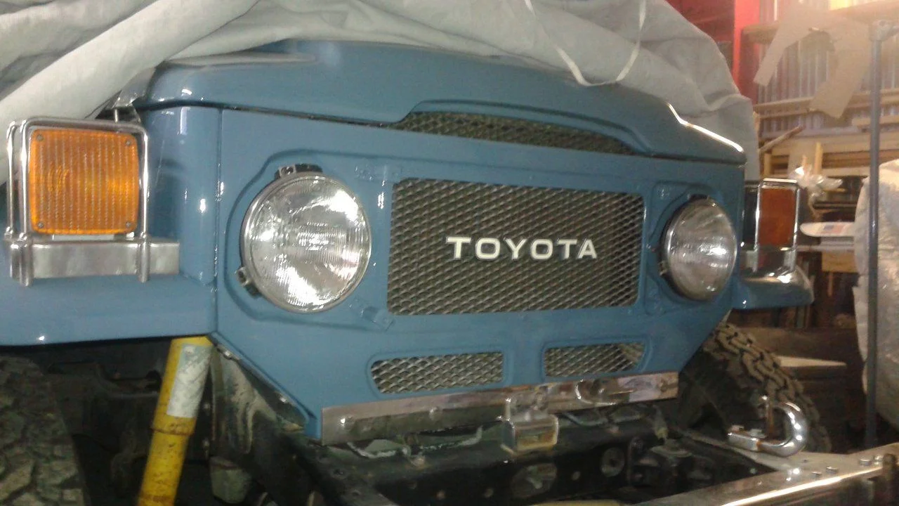

i'm a little desappointed about a small no match of the paint (you can see the difference between hood and fender) , the first gallon was all use on the top , hood and doors
then i got another gallon for the tub and fenders , anyway i will live with it , and after all it will get scatch and dusty :hillbilly:

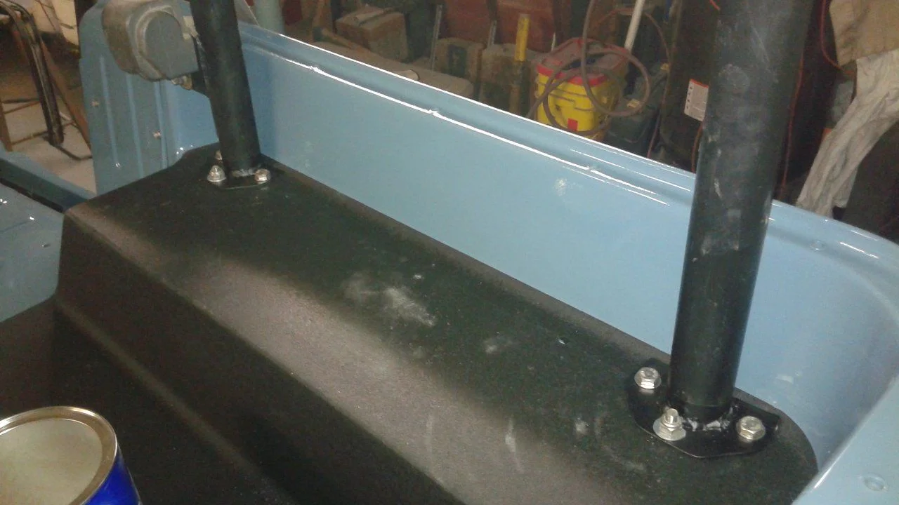

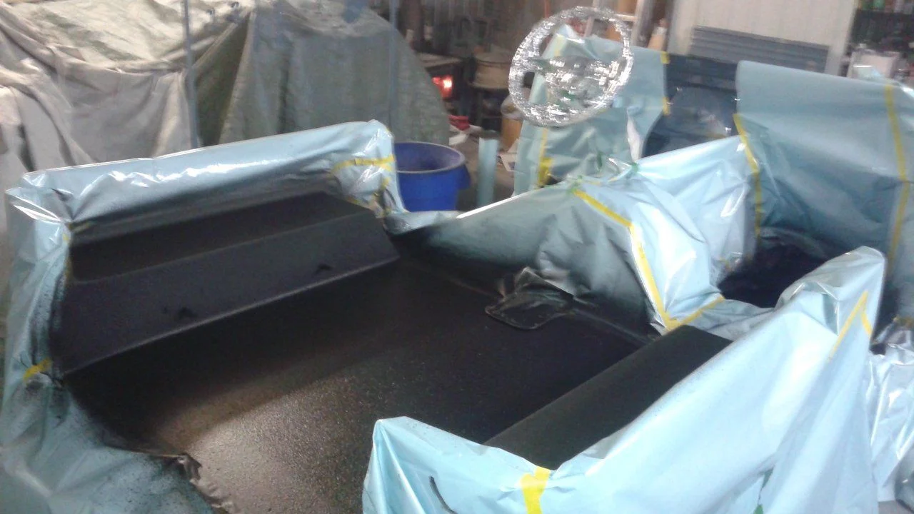

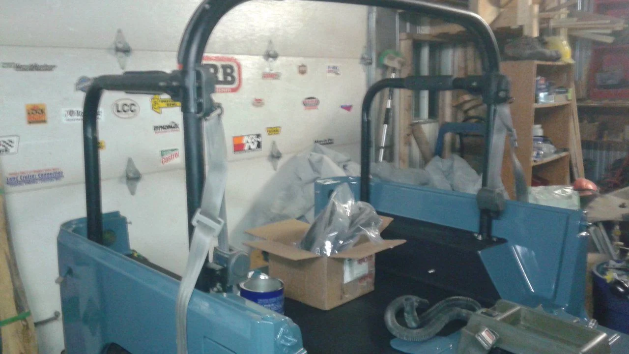

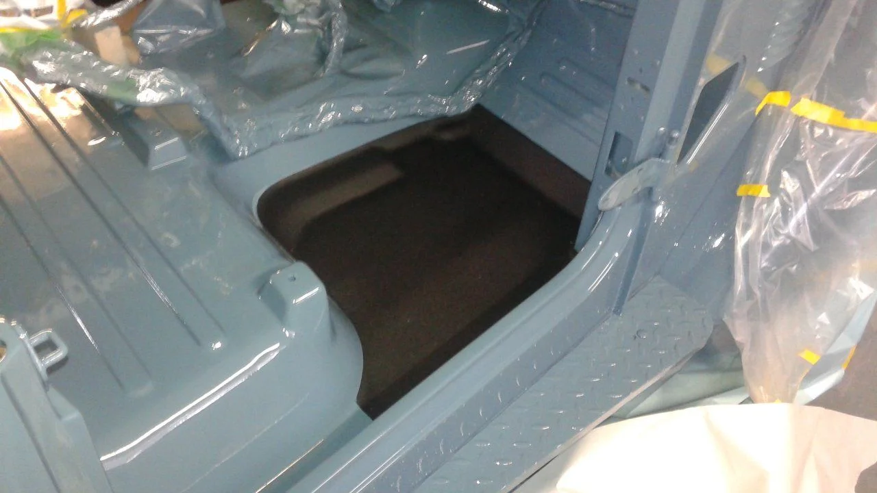

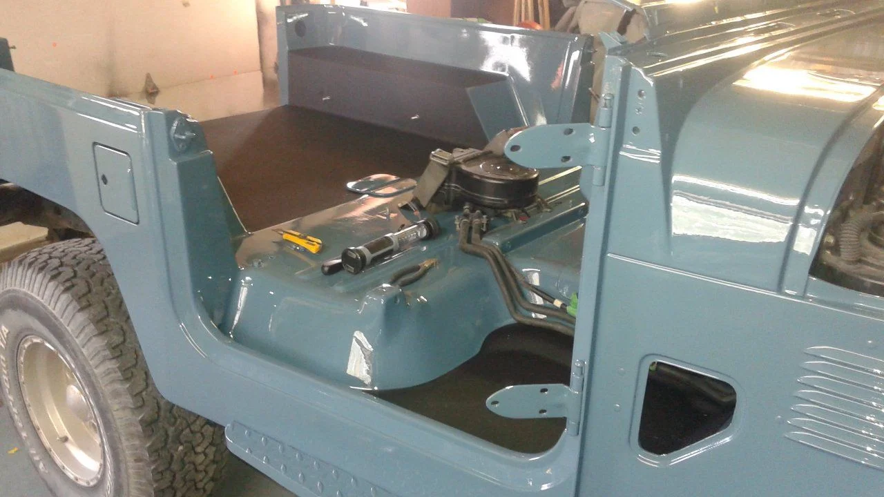

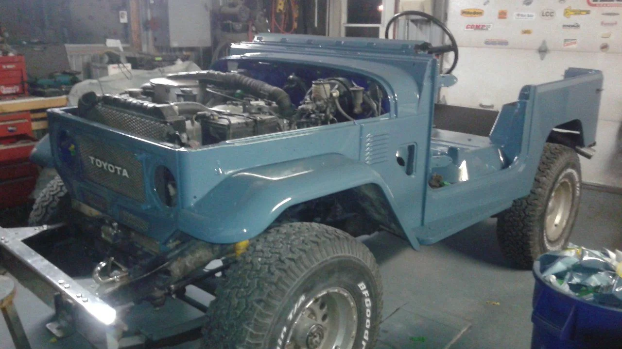

Wow looks great. How do u bolt the hard top sides to the fiberglass? How durable is that bedliner compared to linex? I like how u only did the floor and not the sides. Nice detail.
the hardtop is held in place with rivet nut on the fiberglass side
for the liner , i'm sure linex is a ticker and superior product , i use the bed armor because i have a new quart on the shelf for 4 years , it was hard to mix all the solid that rest in the bottom of the can and some rubber particule are bigger than normal,
but i'm on a tight budget and just use my old stuff
