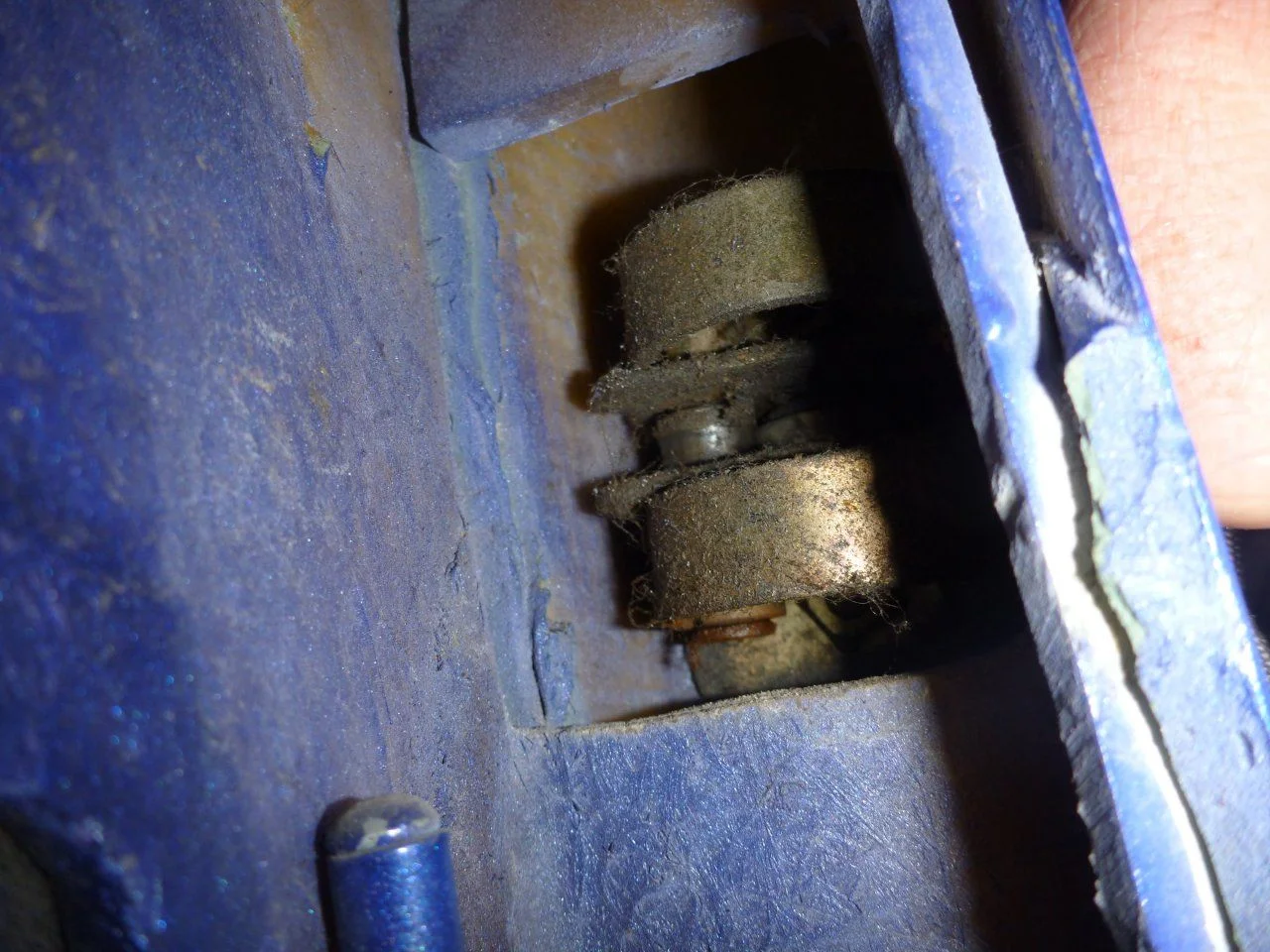

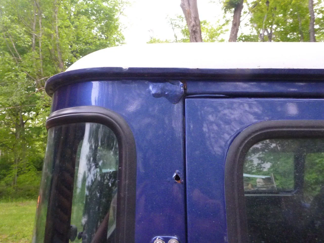

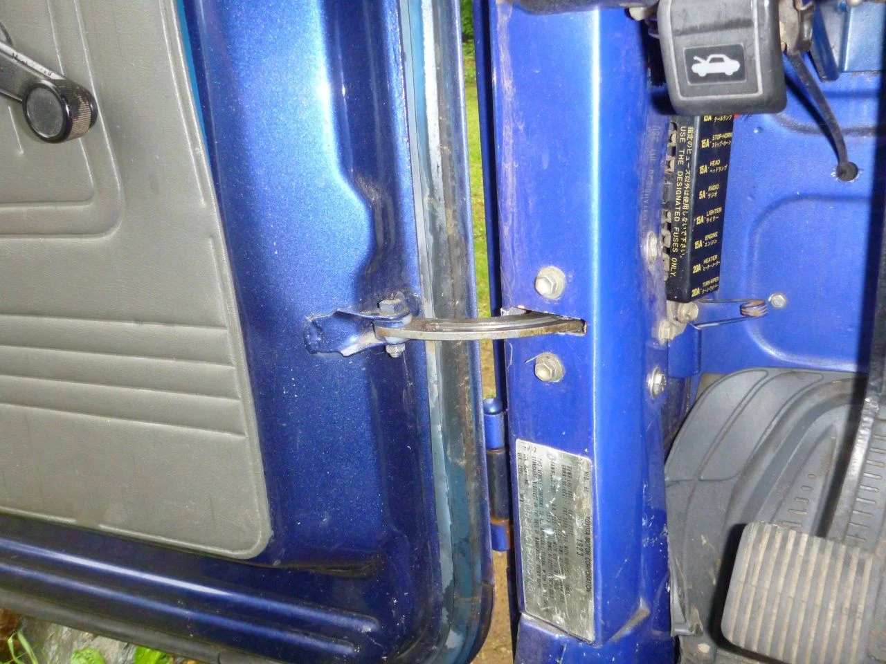

Here are the pics you asked ,nothing visible ,probably some metal insert ,my 77 is doorless so i never install the stop.
Drill the hole the right size to tap some thread ,if its just glass and no insert then you need nuts and washer and extra flexible fingers
i think the pilar need some additional support maybe an angle iron from the floor to under the dash.
Beautiful 42! I also have a Gozzard tub on my BJ42 that I am in the process of restoring. I would love to see a picture of how the front door stops were installed. Can you take a picture up close of the front and back of the door stop. Specifically how it is mounted from the rear of the door frame?

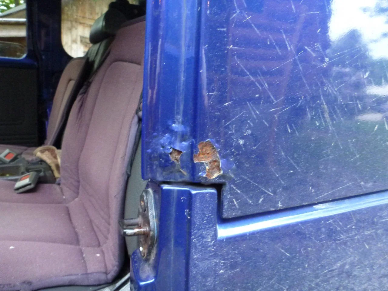

5-rust repair and painting

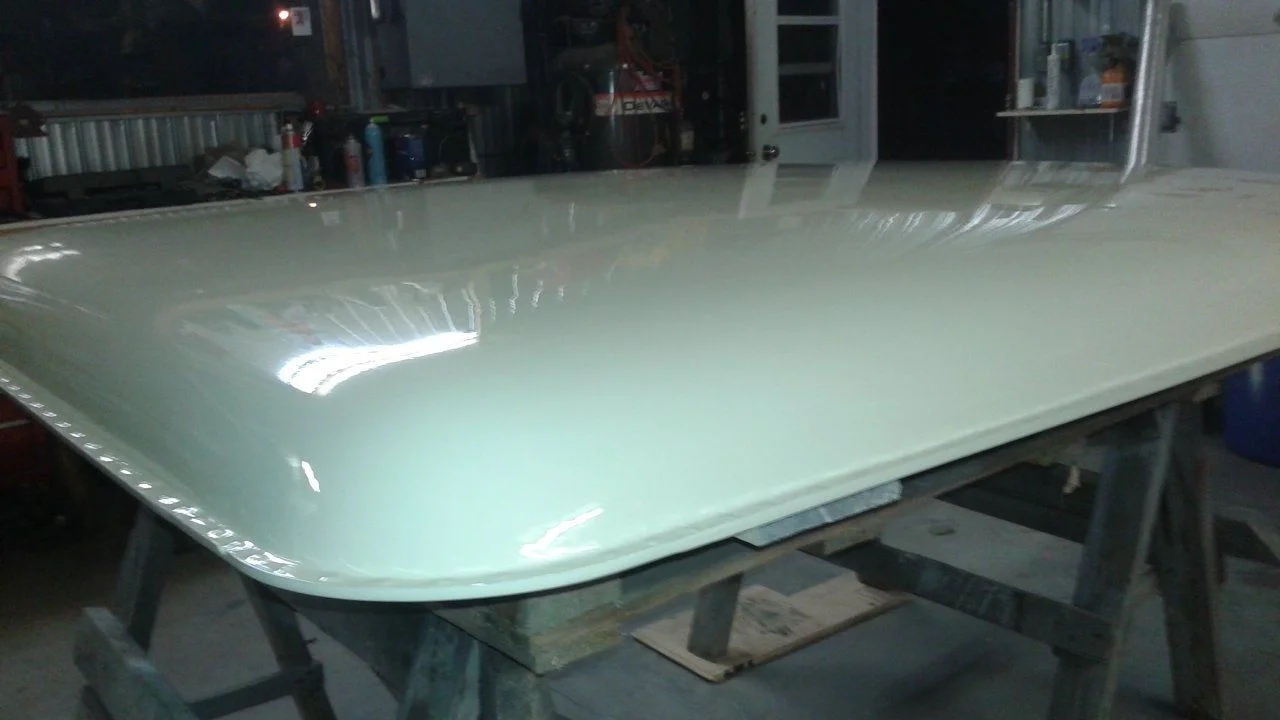

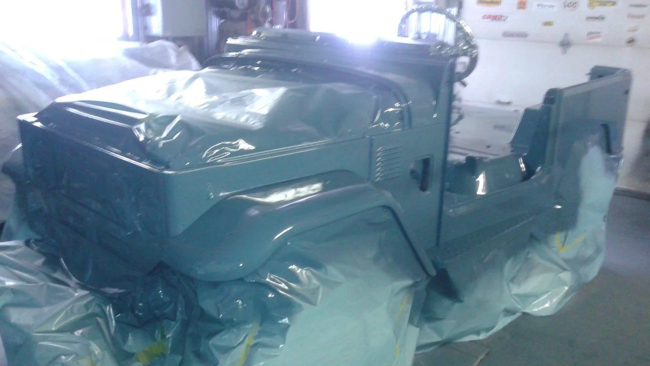

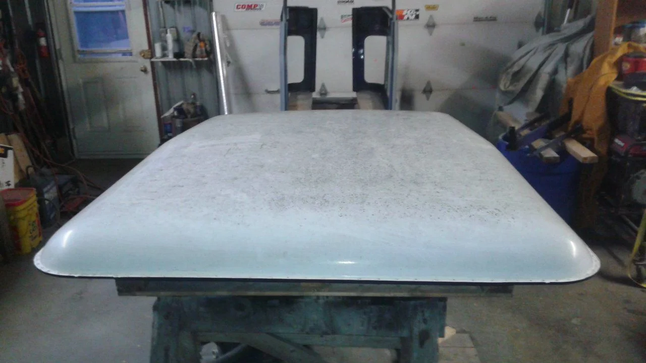

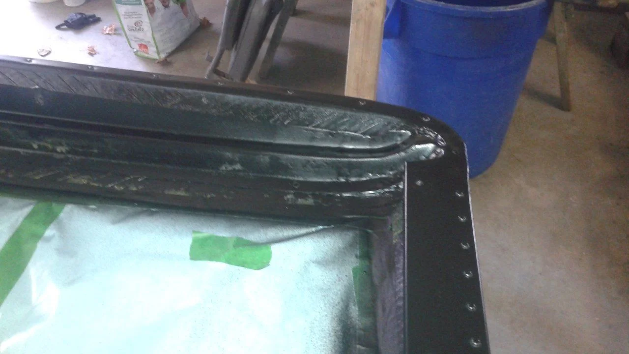

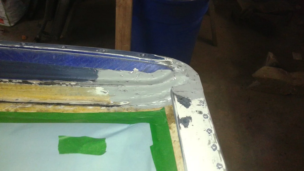

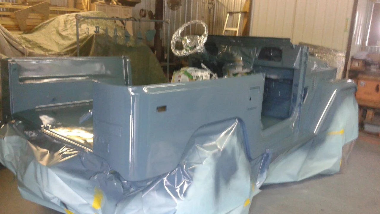

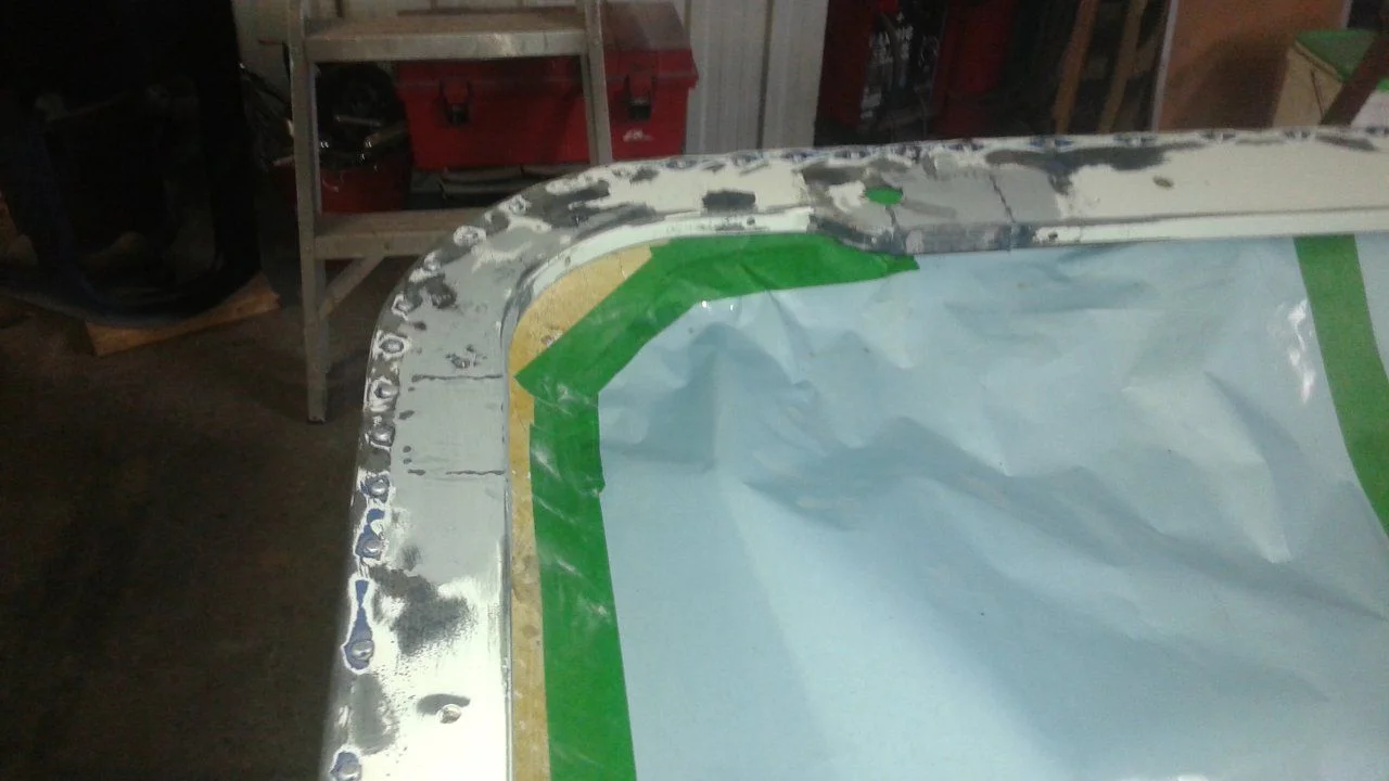

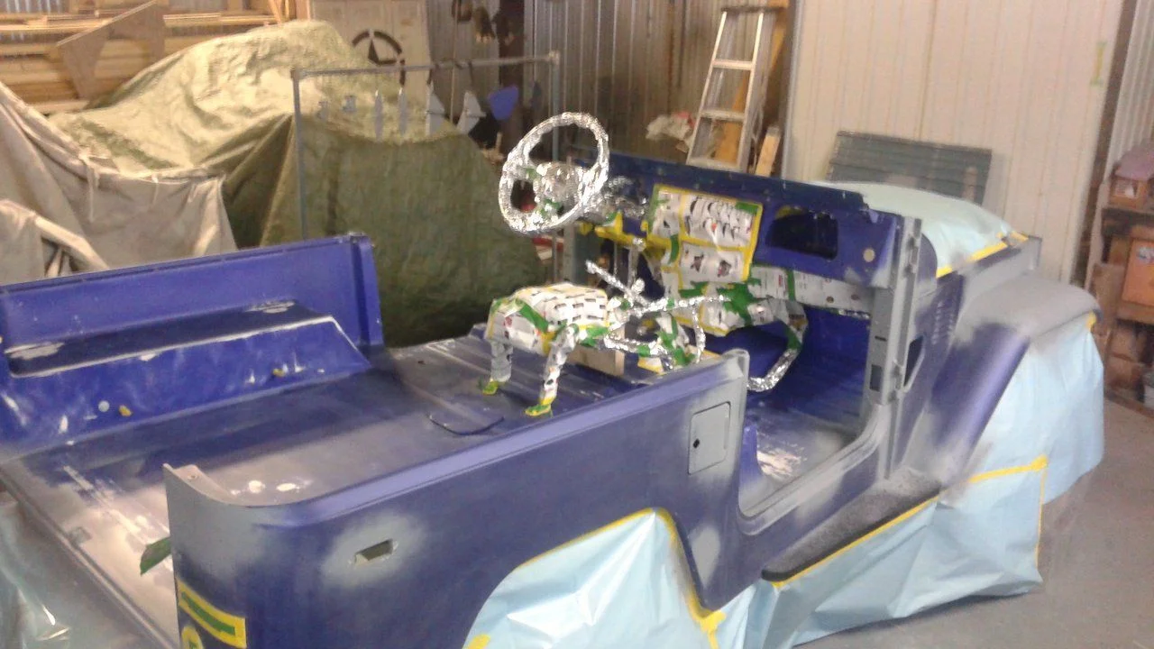

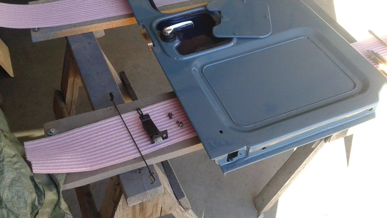

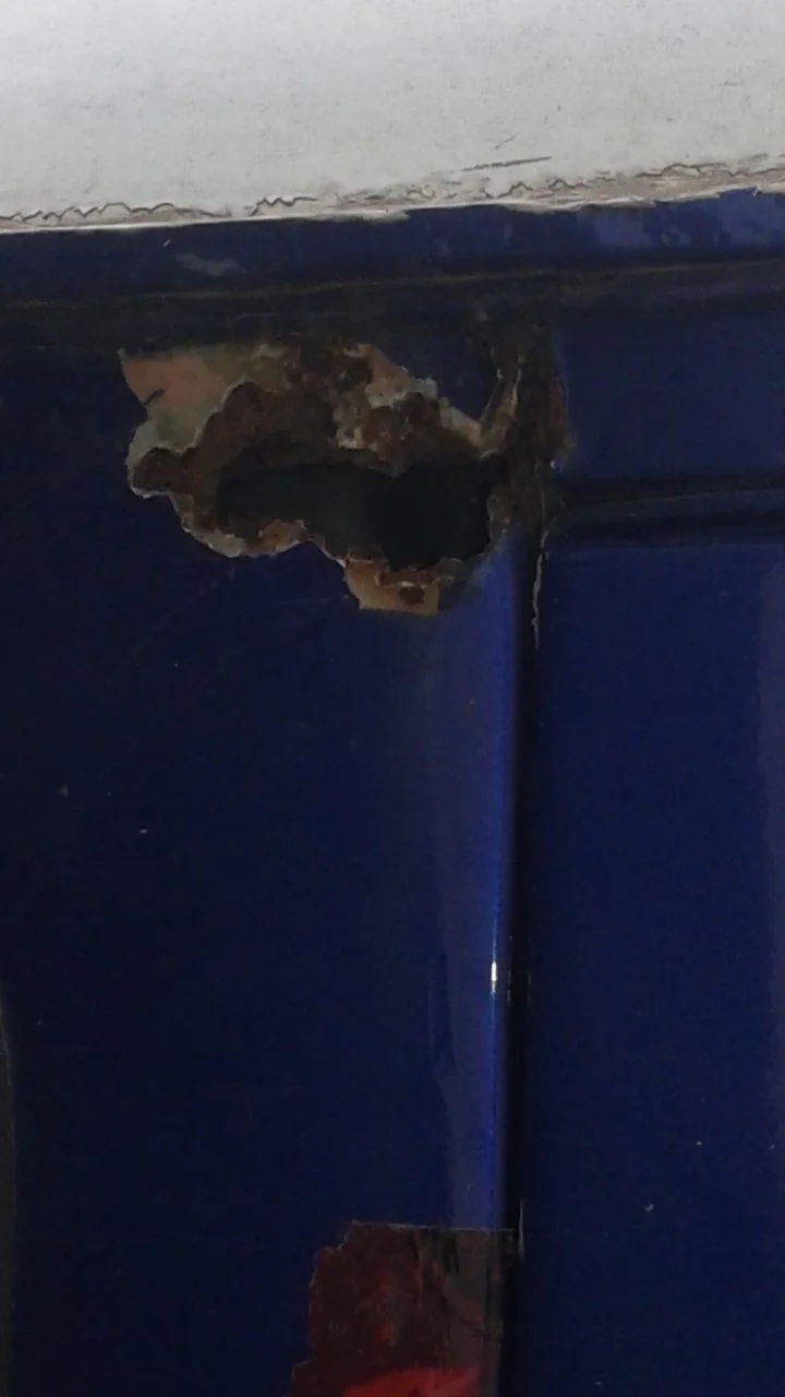

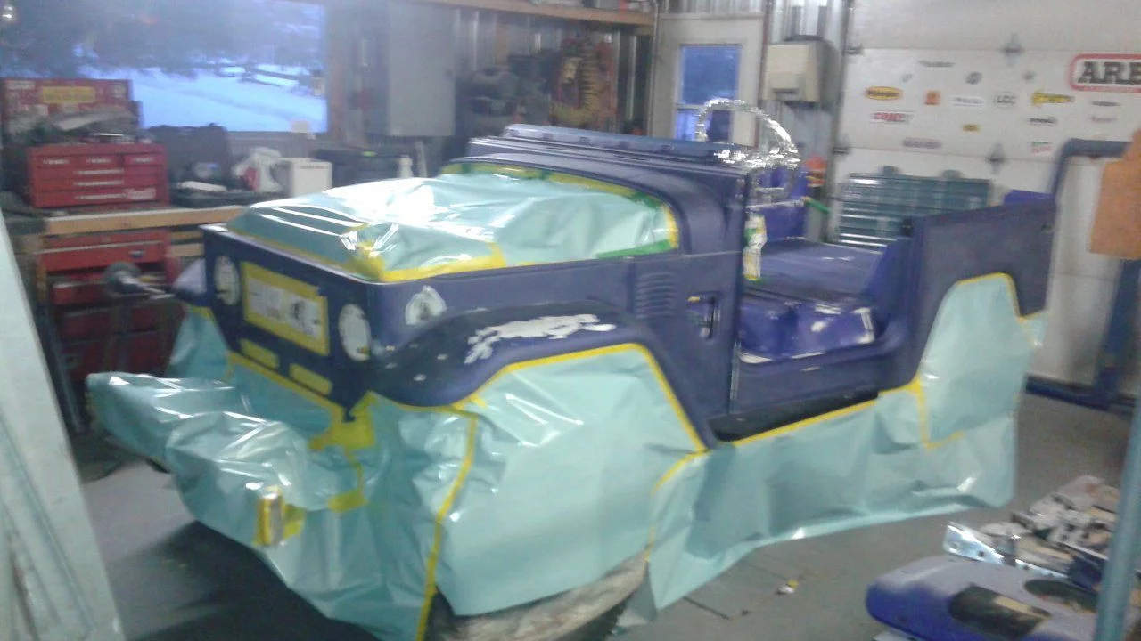

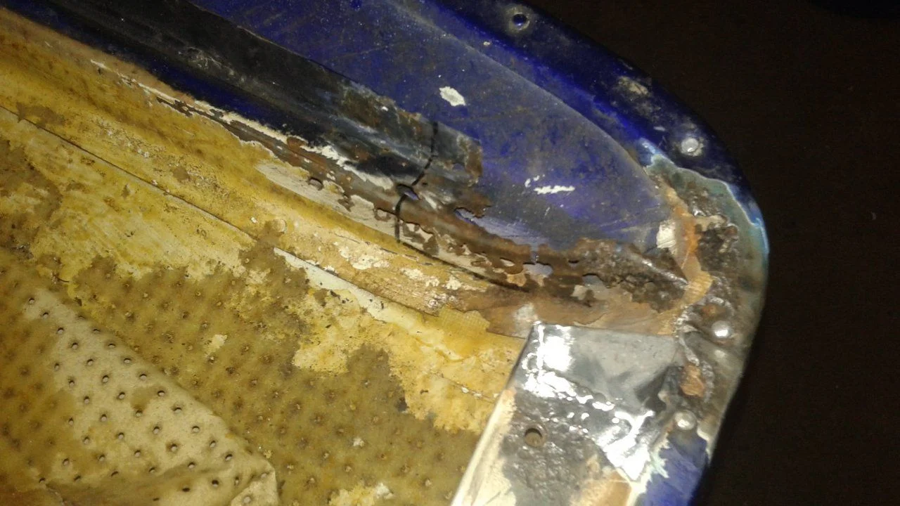

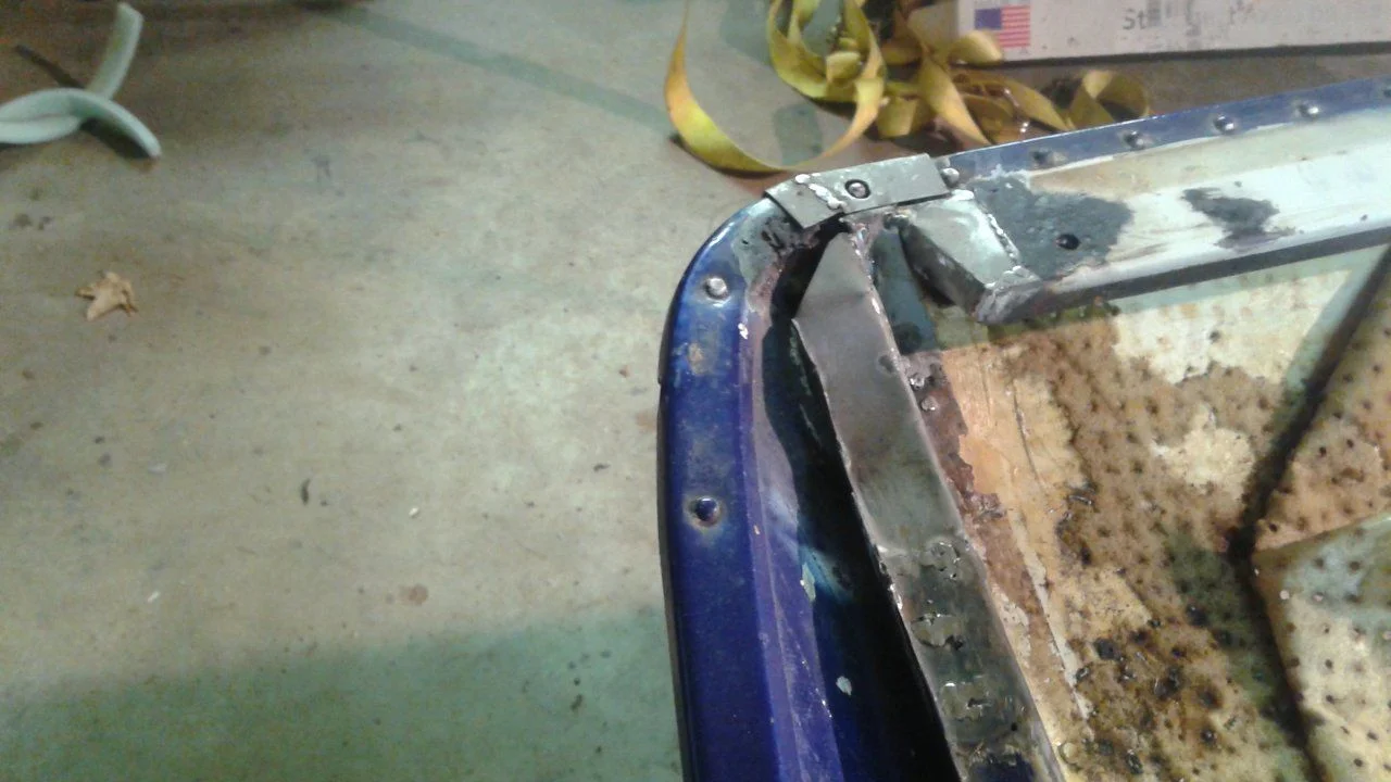

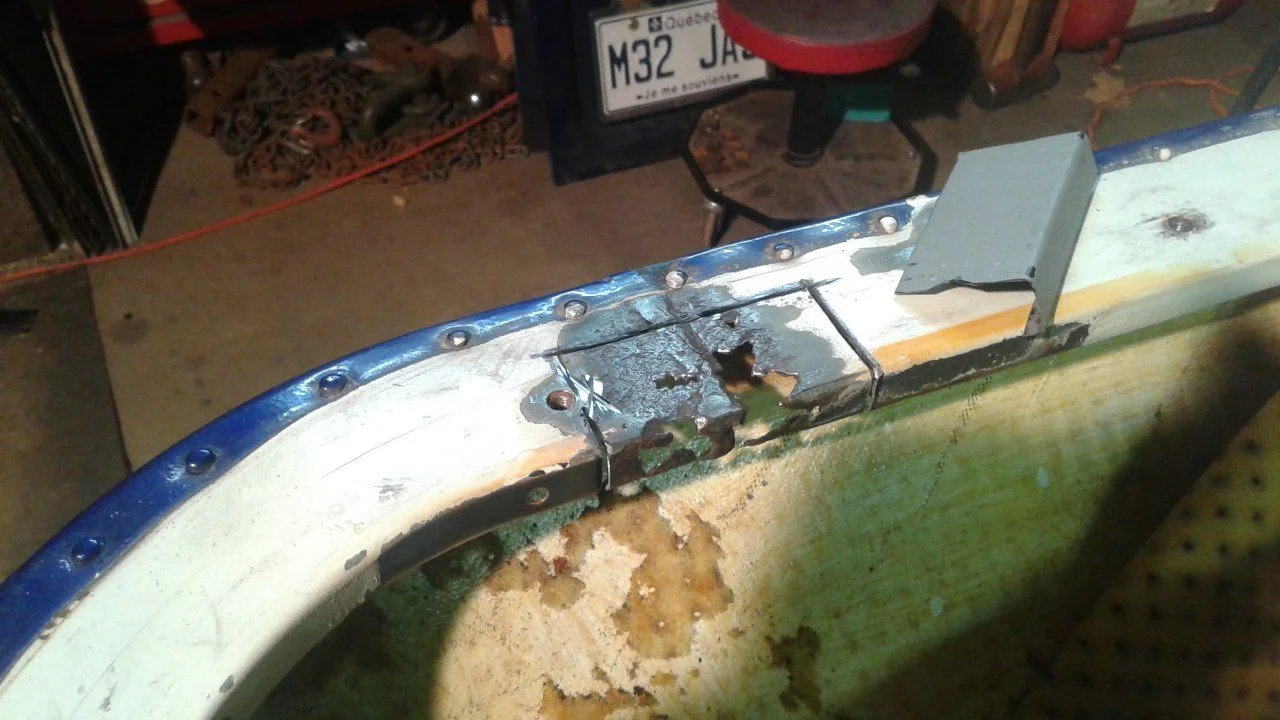

i just finish the rust repair and color change , it was suppose to be a quick job :rofl: , i start the process in the first week of october and today i just finish the paint on the tub , so i will put it back together in the next weeks
i have a lots of pics of the work i have done to show you in the next few days

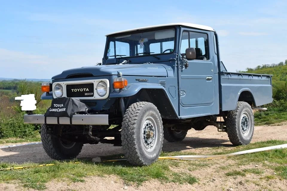

the color i want is cadet blue but my paint store can not find the mix recipe, so i look for something close
i like the RAF blue and arles blue from land rover , also like the dodge ram ceramic blue , but it end up with a ppg universal code , it is kind of a dirty blue :cool:
you can see in the pics below , cadet blue , raf blue , ceramic blue and a teaser of my color

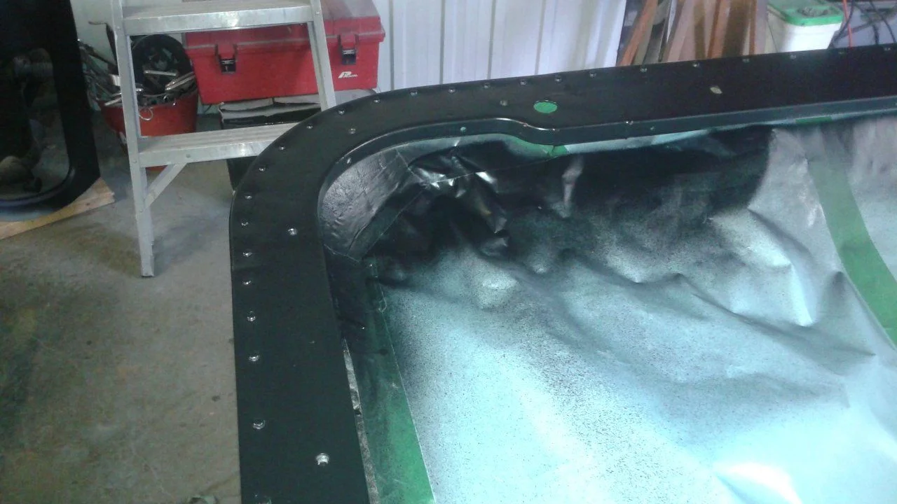

it is not a frame off , no time for that , more a refresh and color change but i still end up with a lots of parts in boxes
i chose to use ppg single stage (essential delfleet industrial paint) , it is thick and it resist oil ,fuel and hard is to scratch
sorry for the crappy pic

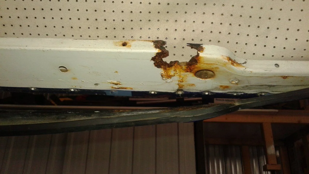

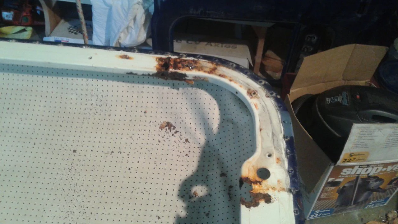

Great color choice! I've always liked that subdued blue.:beer: You,re going to go:eek: when you tear into that rear header.
