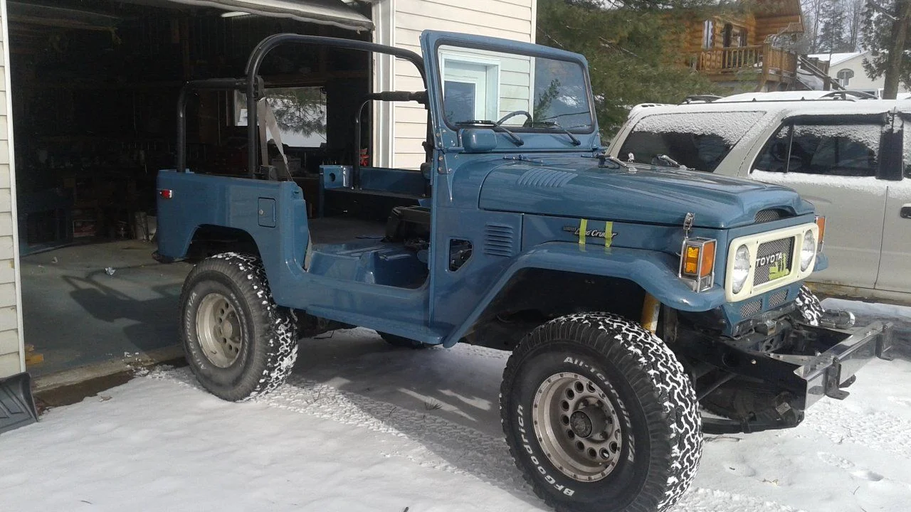

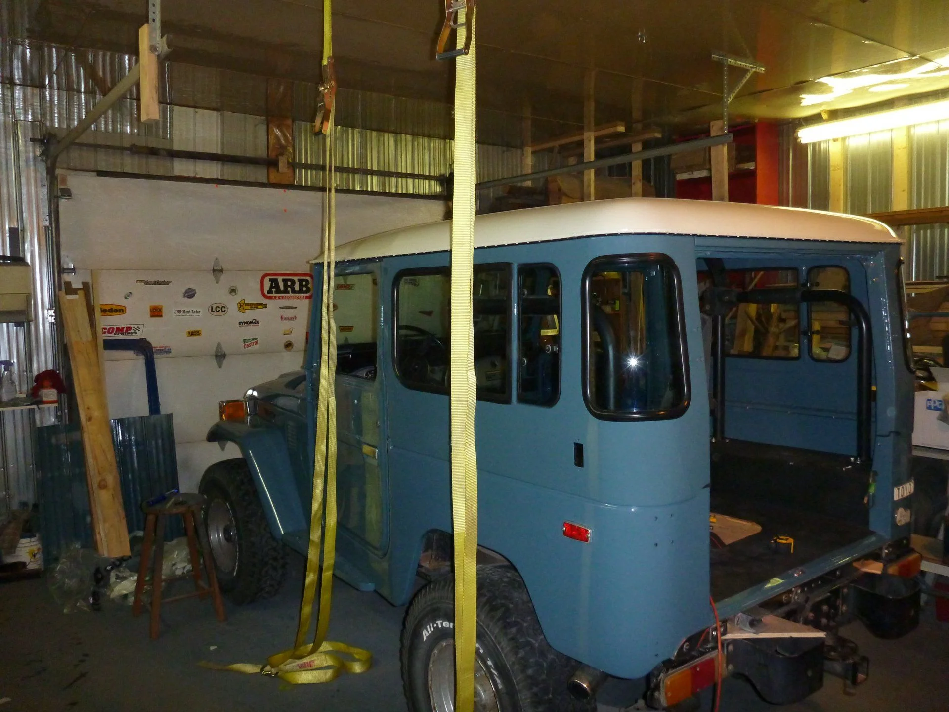

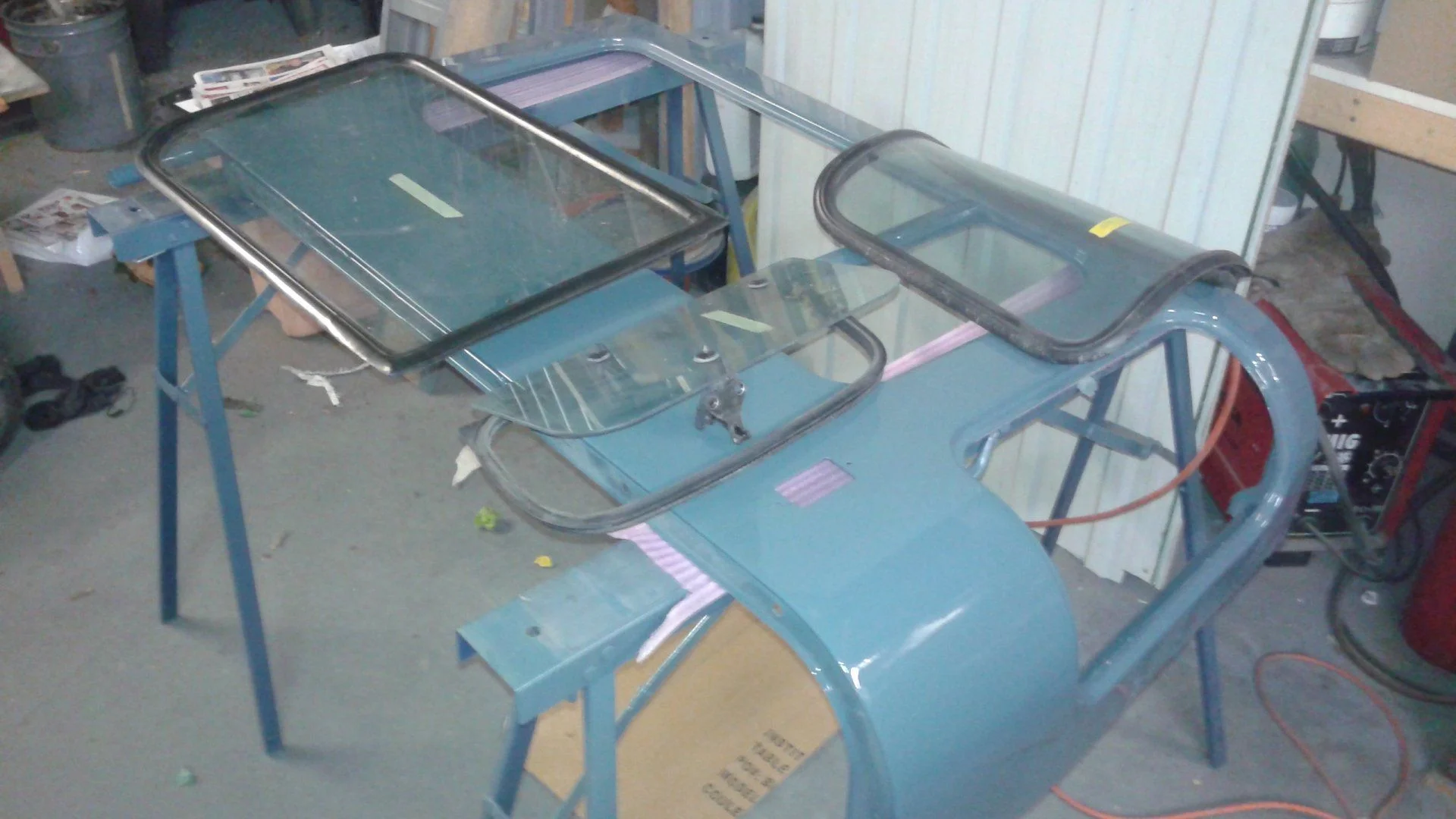

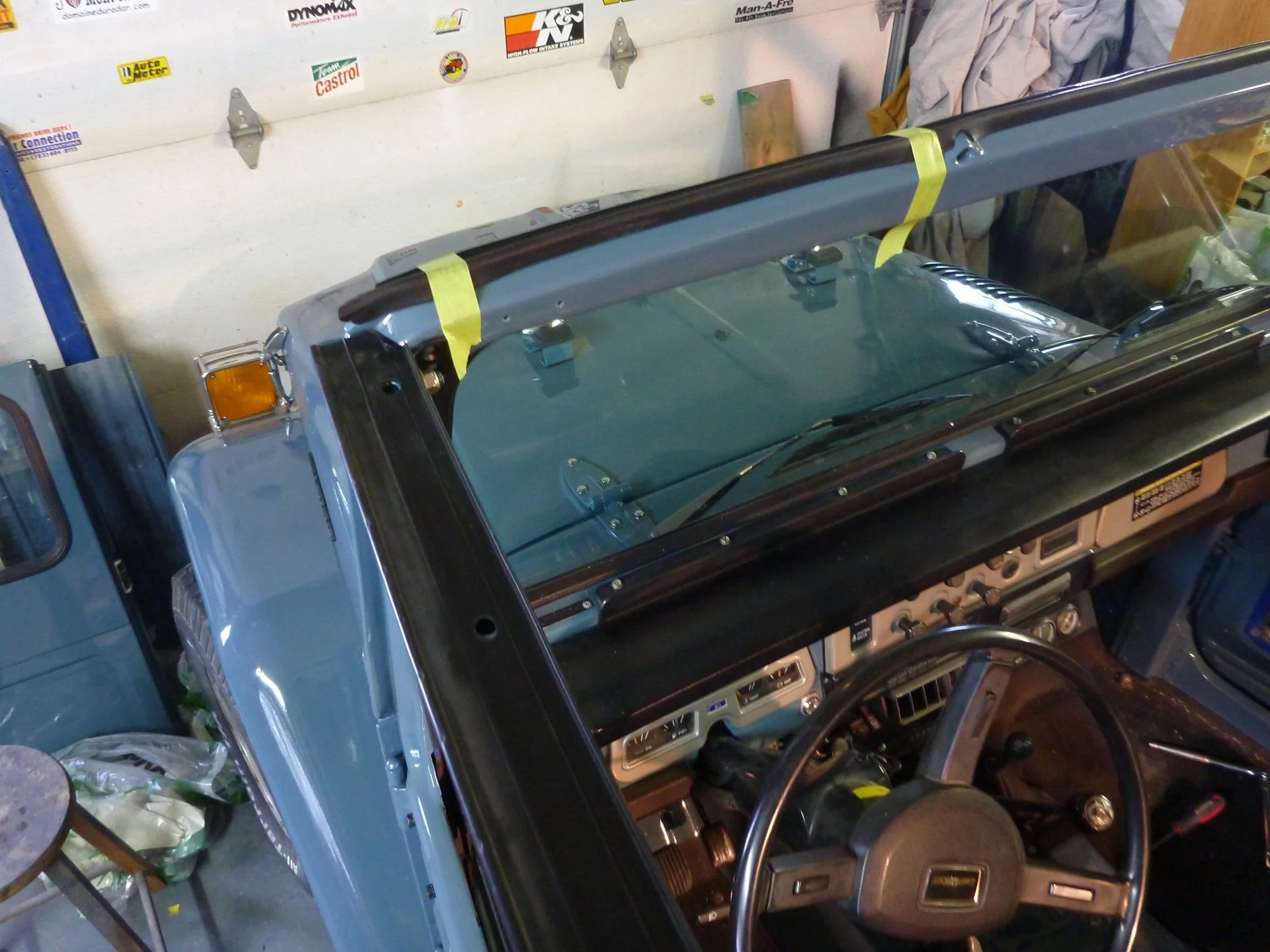

my "new" 1984 bj42 Miss dirty blue

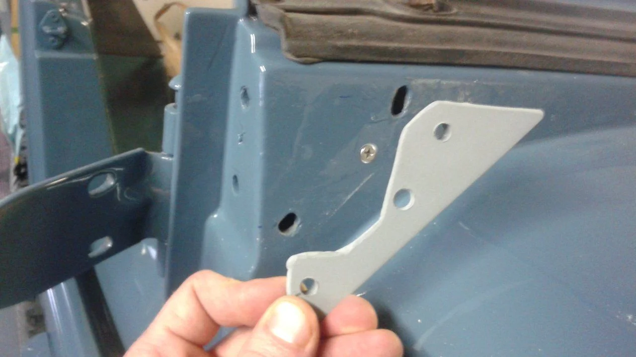

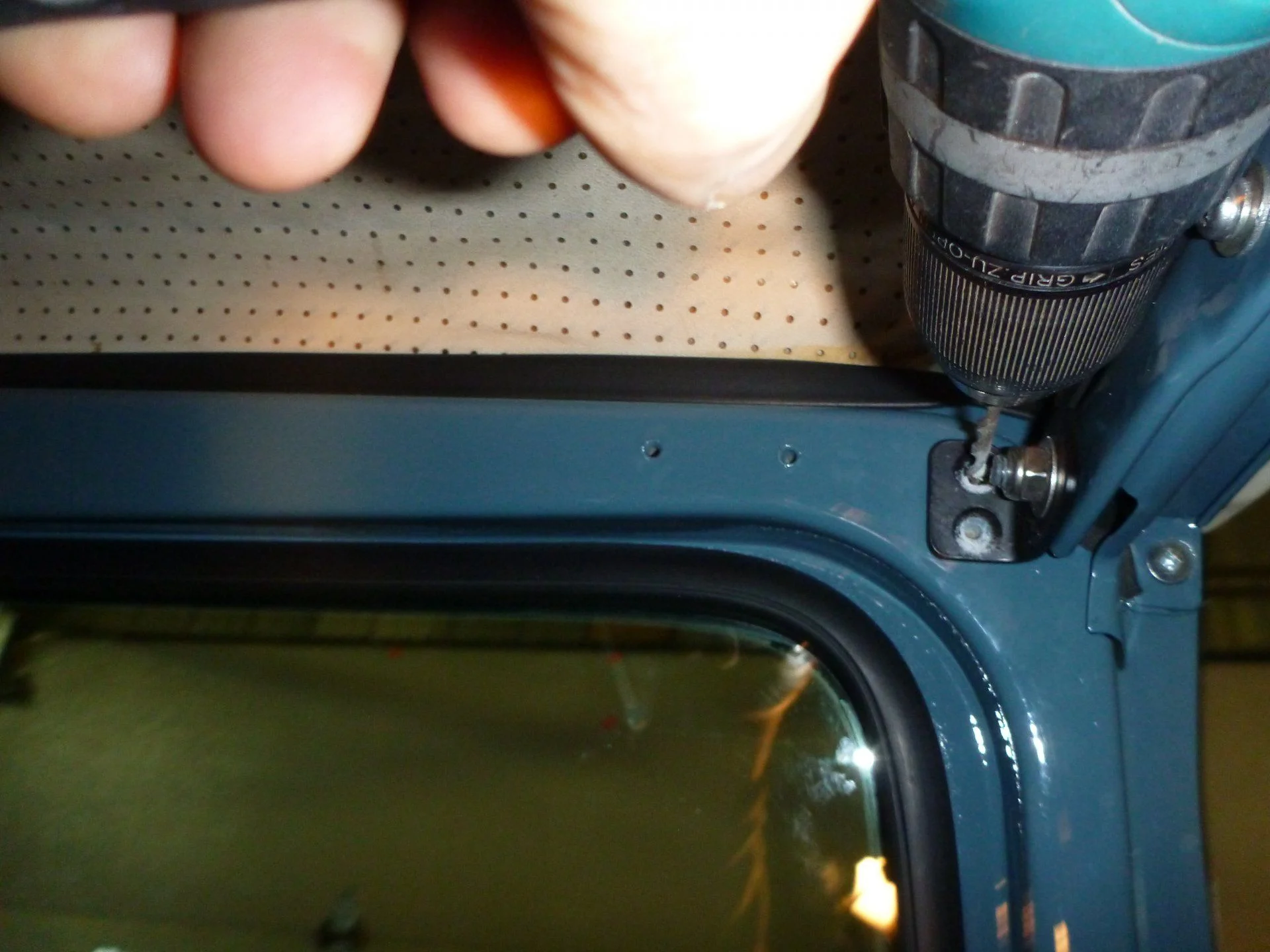

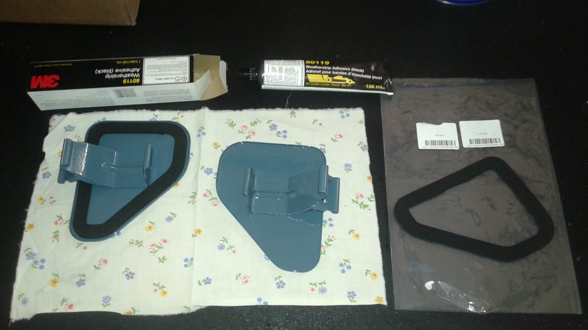

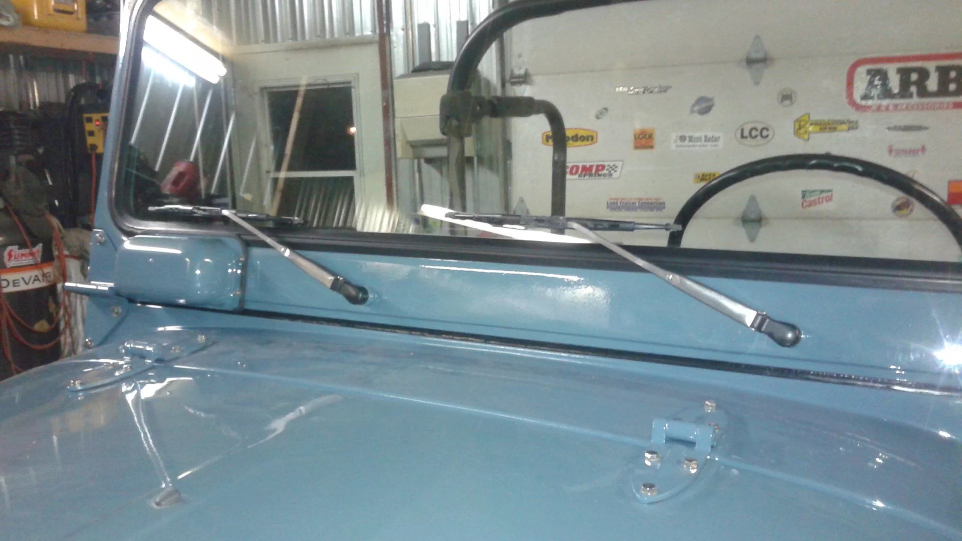

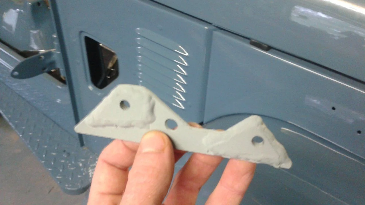

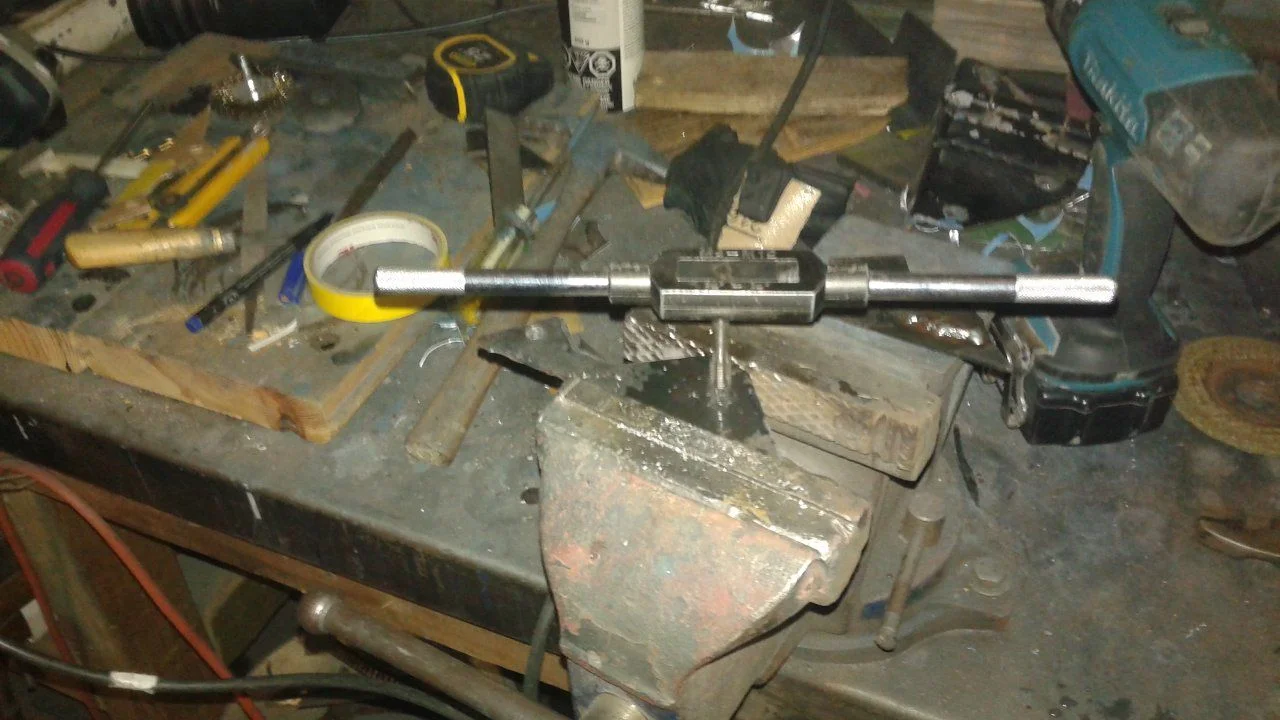

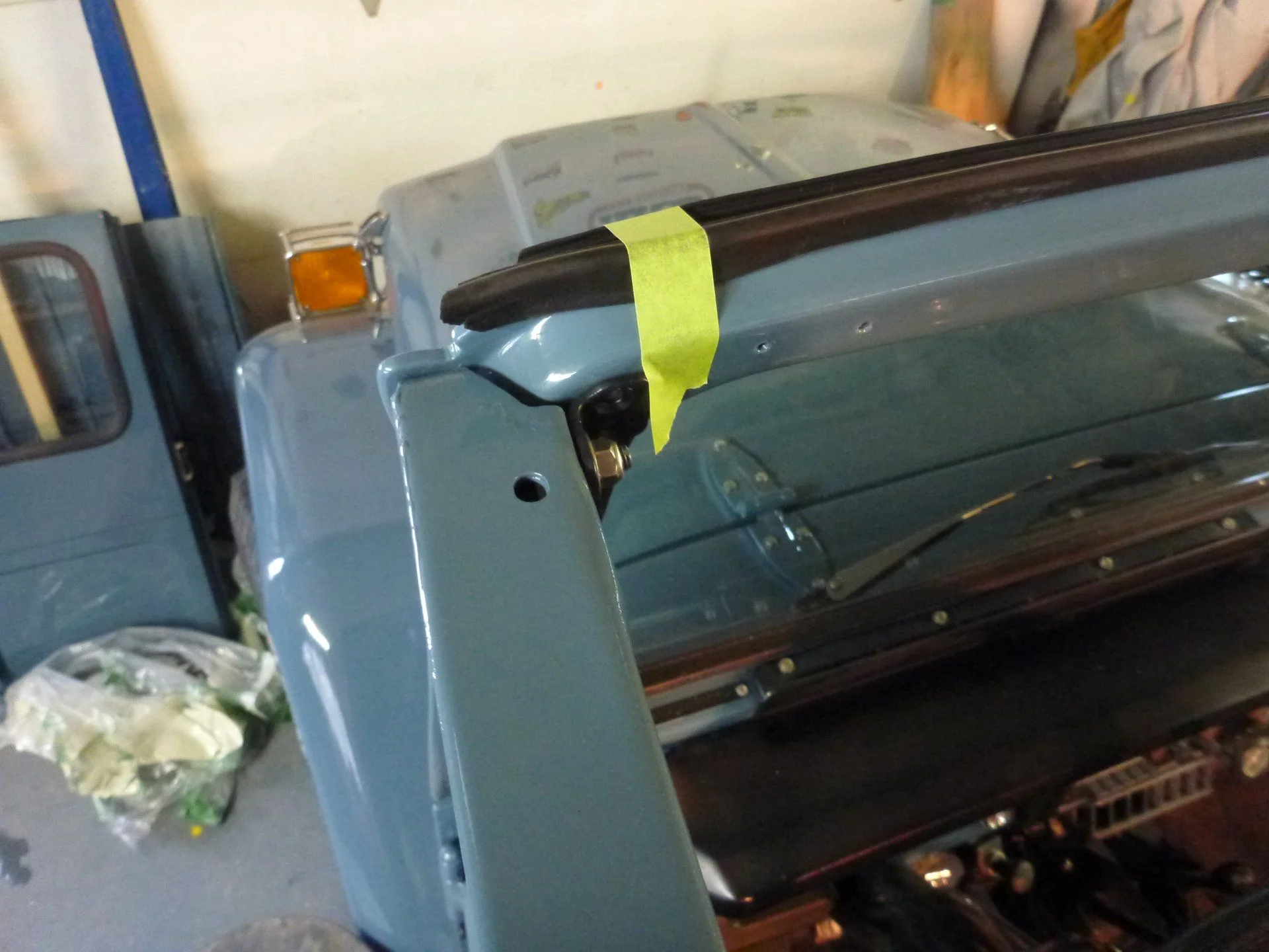

windshield hinges was a pain to bolt in the cowl , so i buit a plate with threaded holes , held in place with a small bolt in the bigger center hole , so the plate is floating like factory

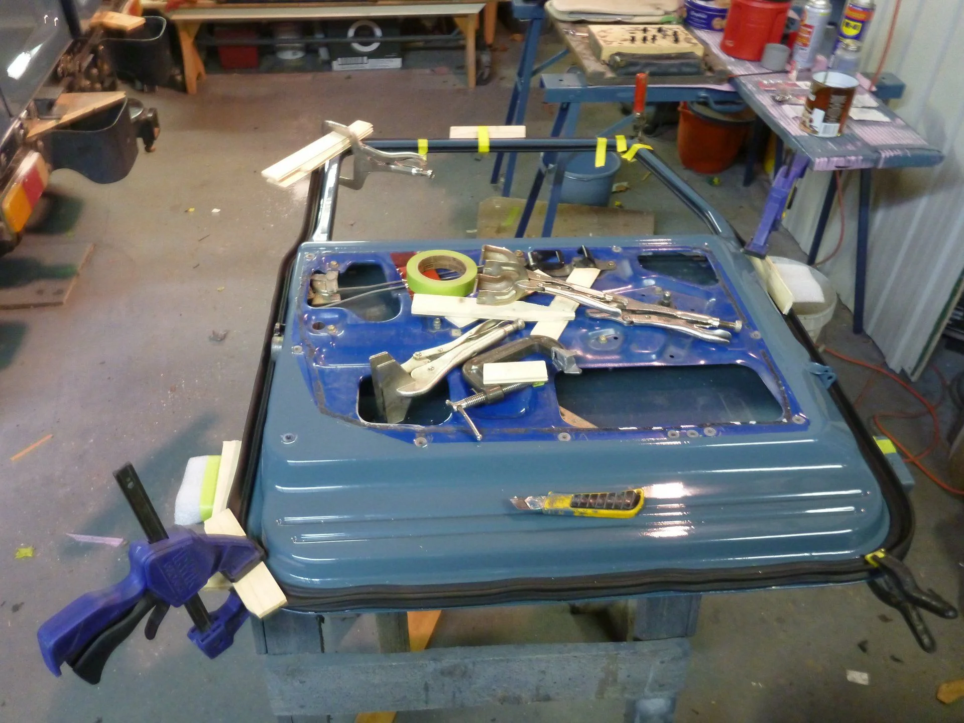

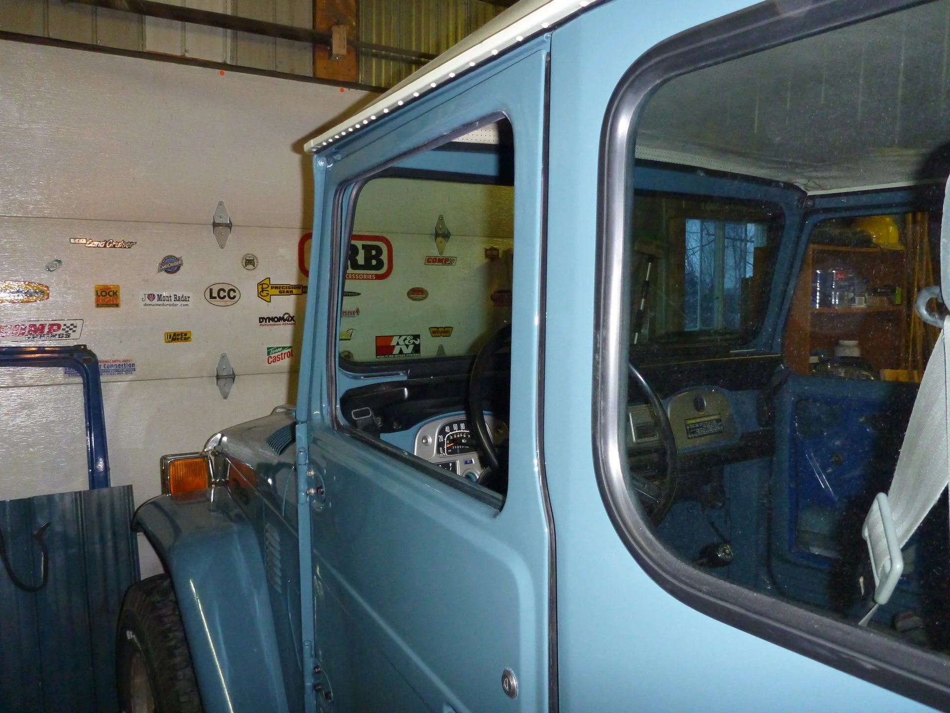

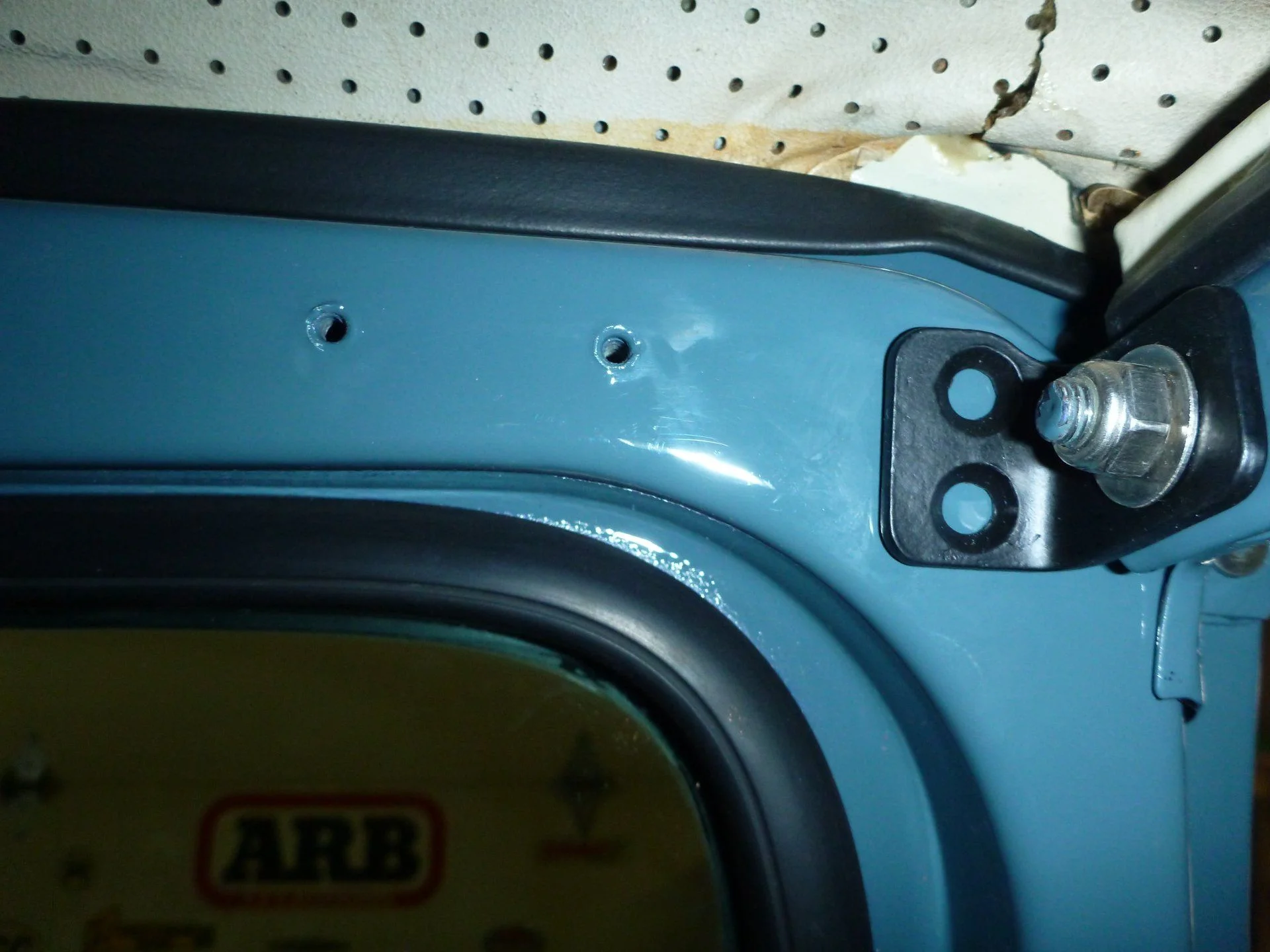

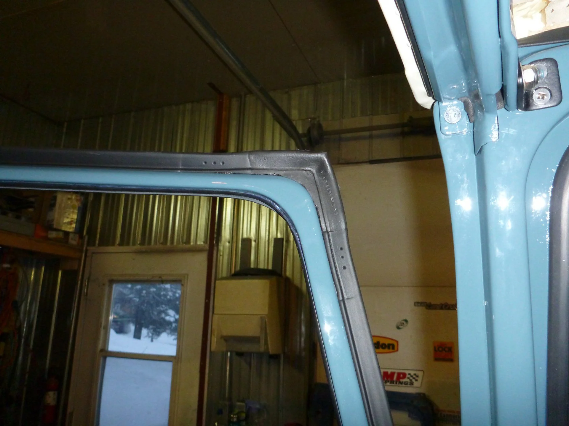

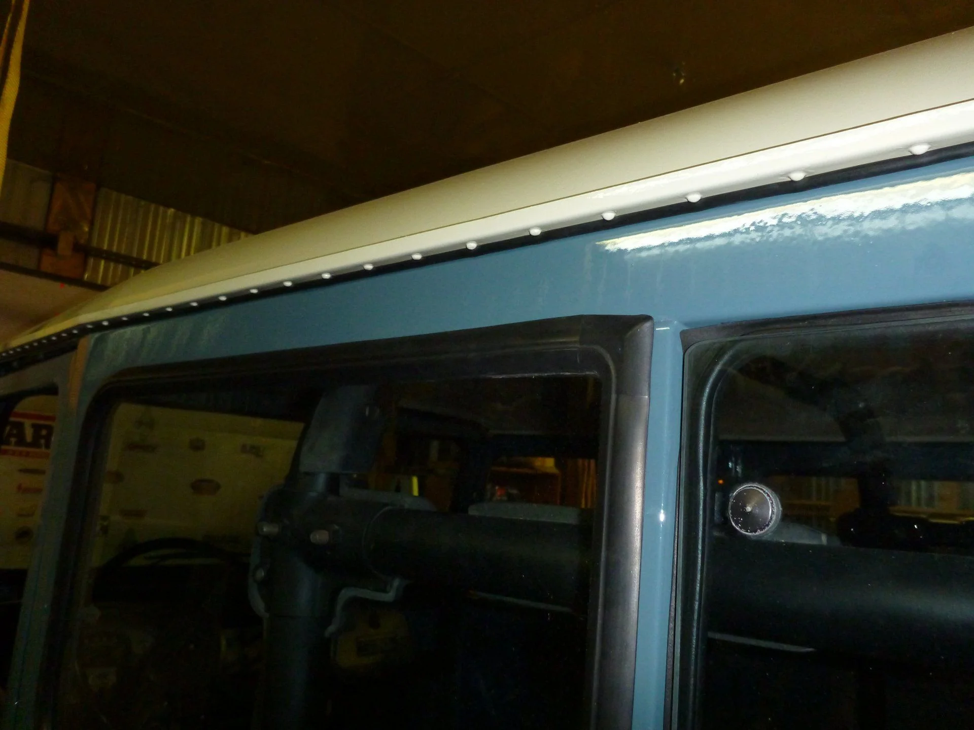

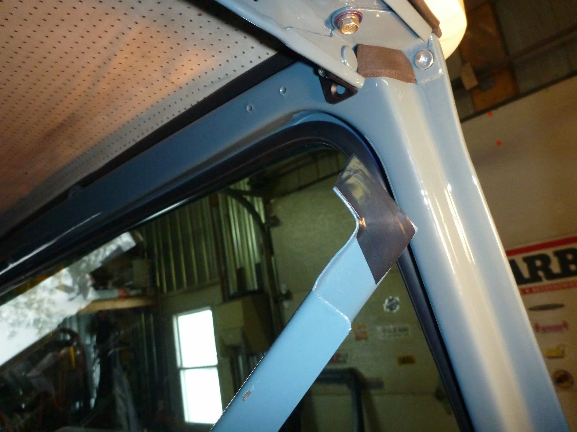

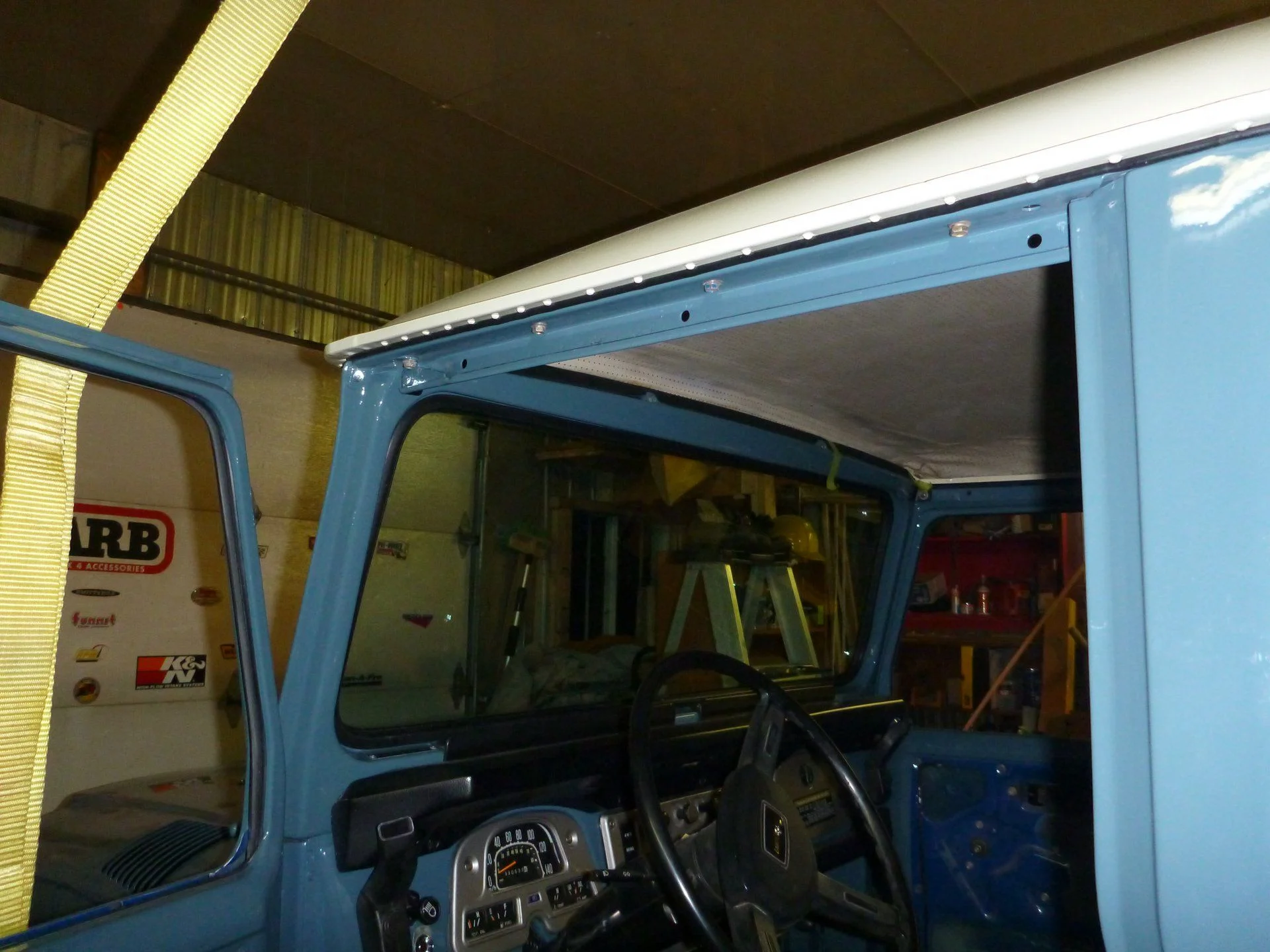

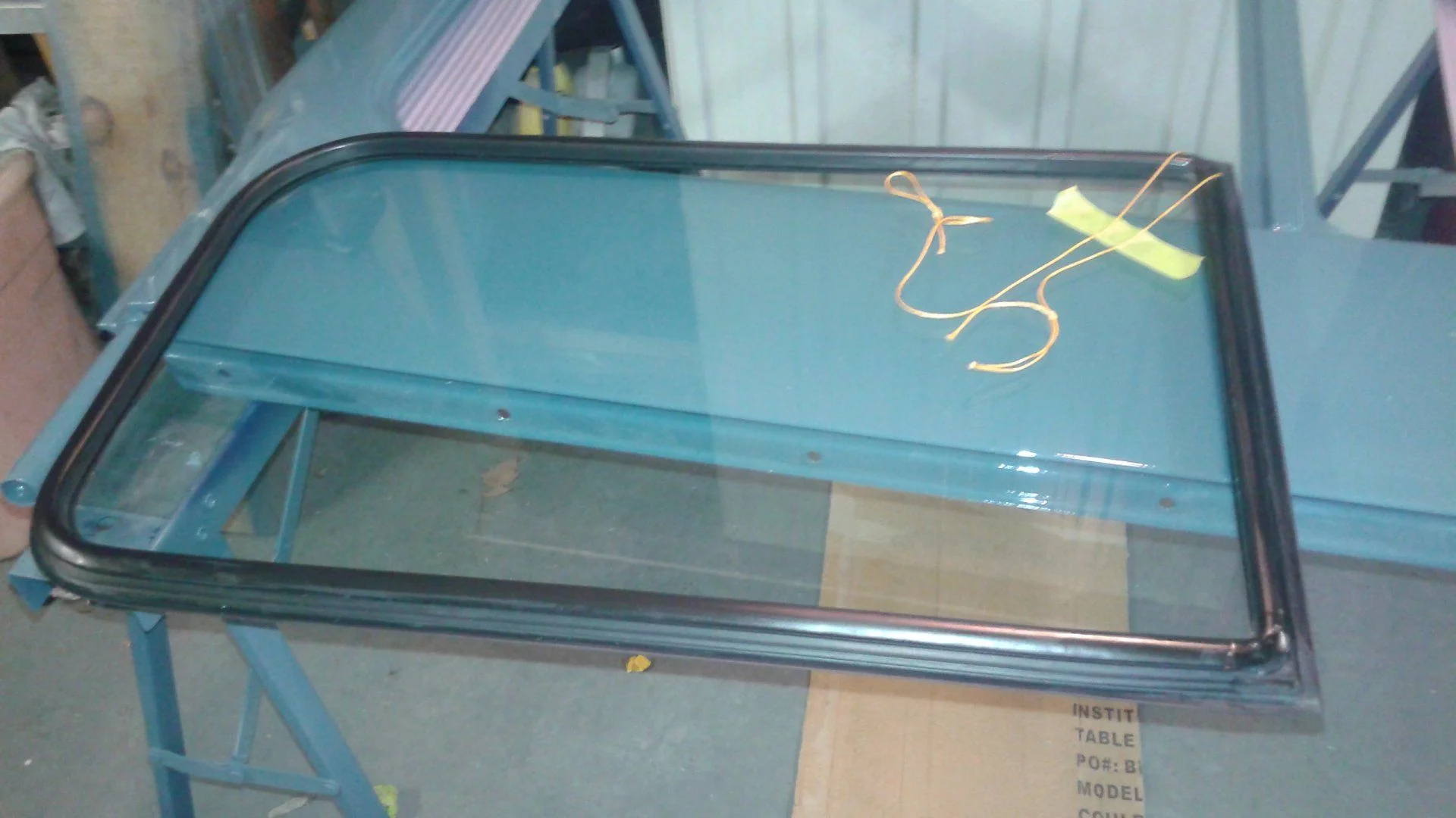

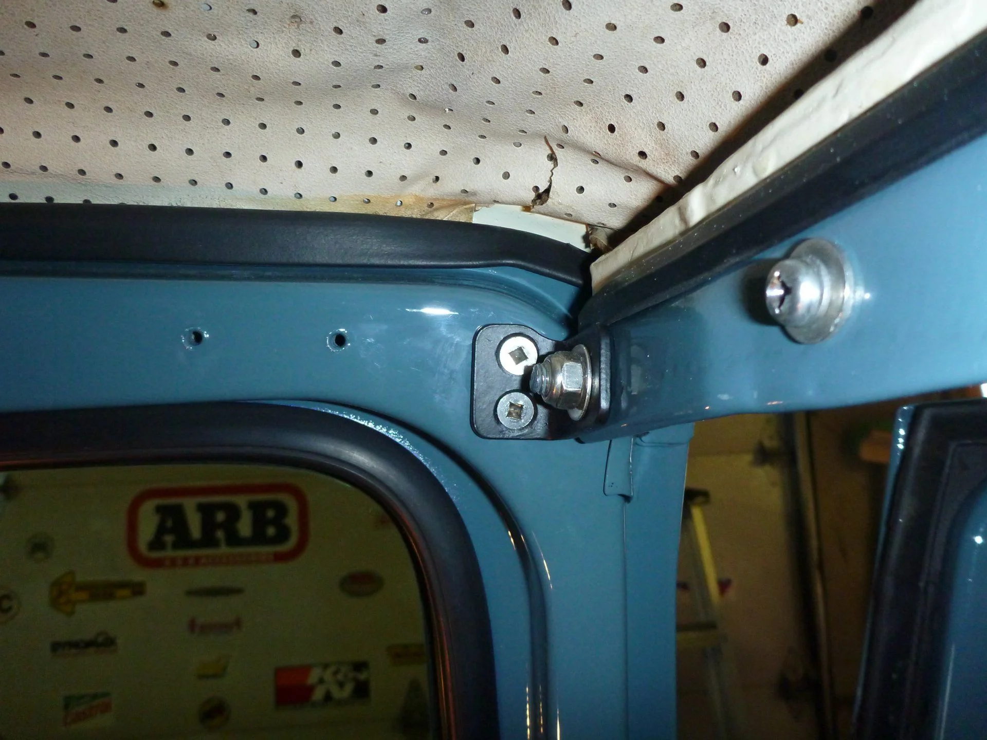

i got the front doors weaterstrip from cruiser corps , last november sale , at 70$usd for the pair, it end up at 200$can after shipping and border fee and taxes , everybody say to go with oem but at 220$usd for a pair it mean more than 500$can :eek: .
i'm happy they fit good , the door is hard to close, but after striker ajustement it help and time will help too
