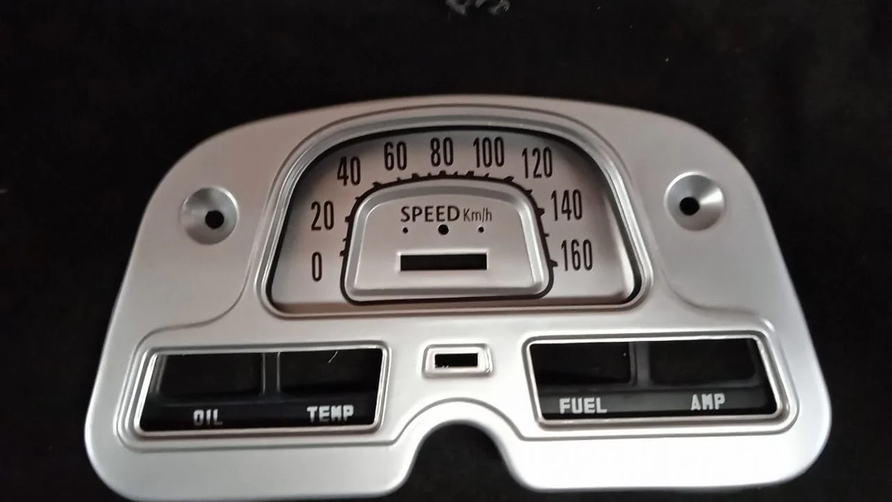

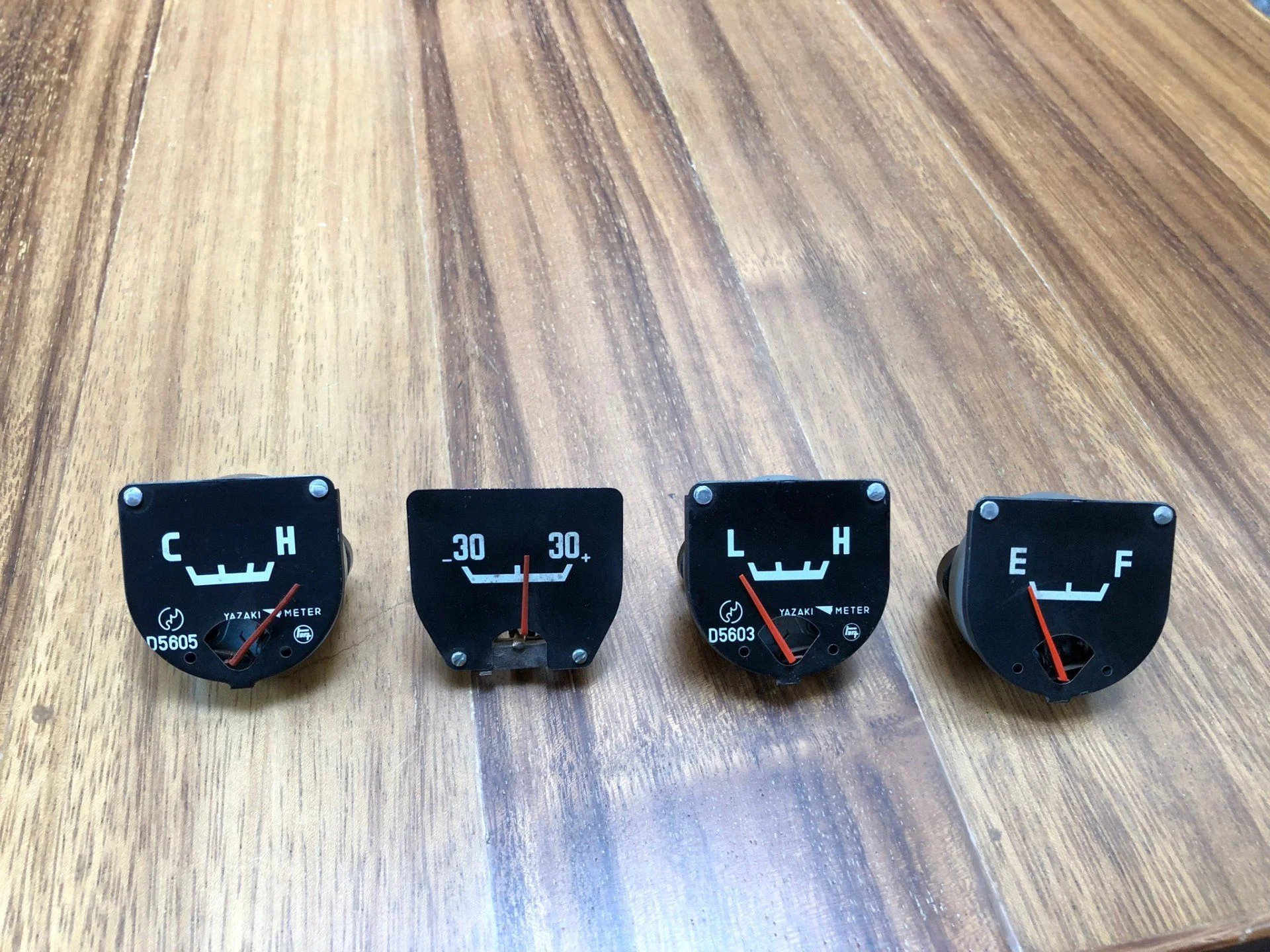

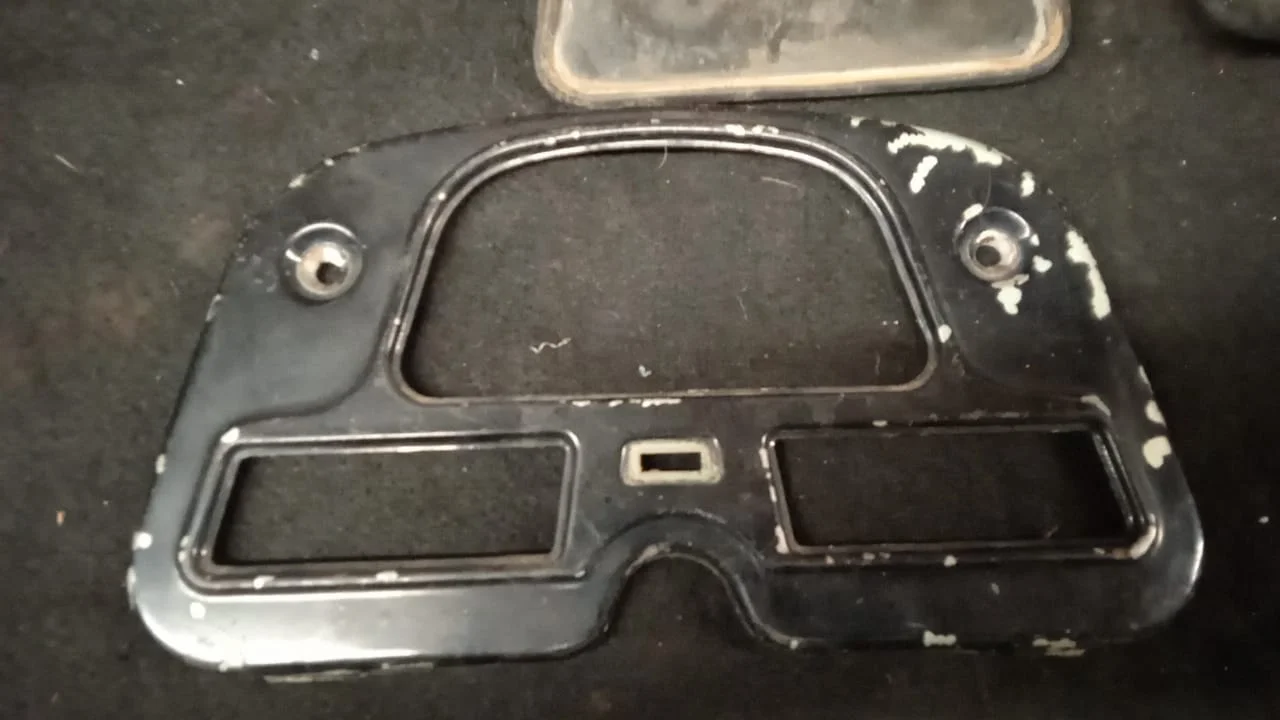

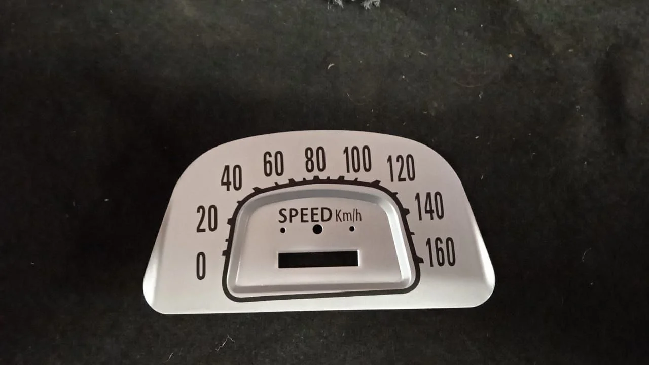

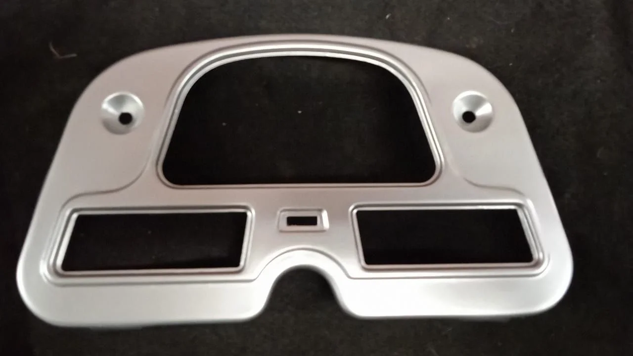

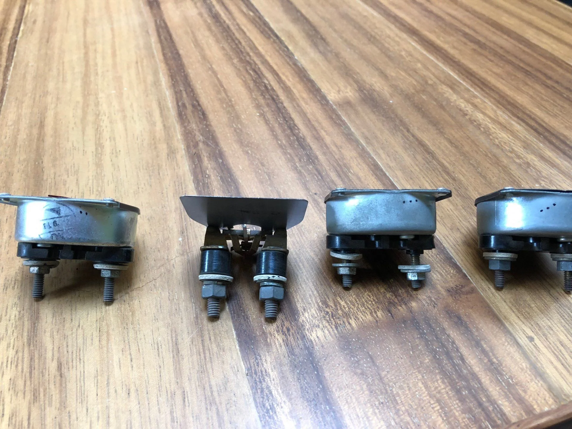

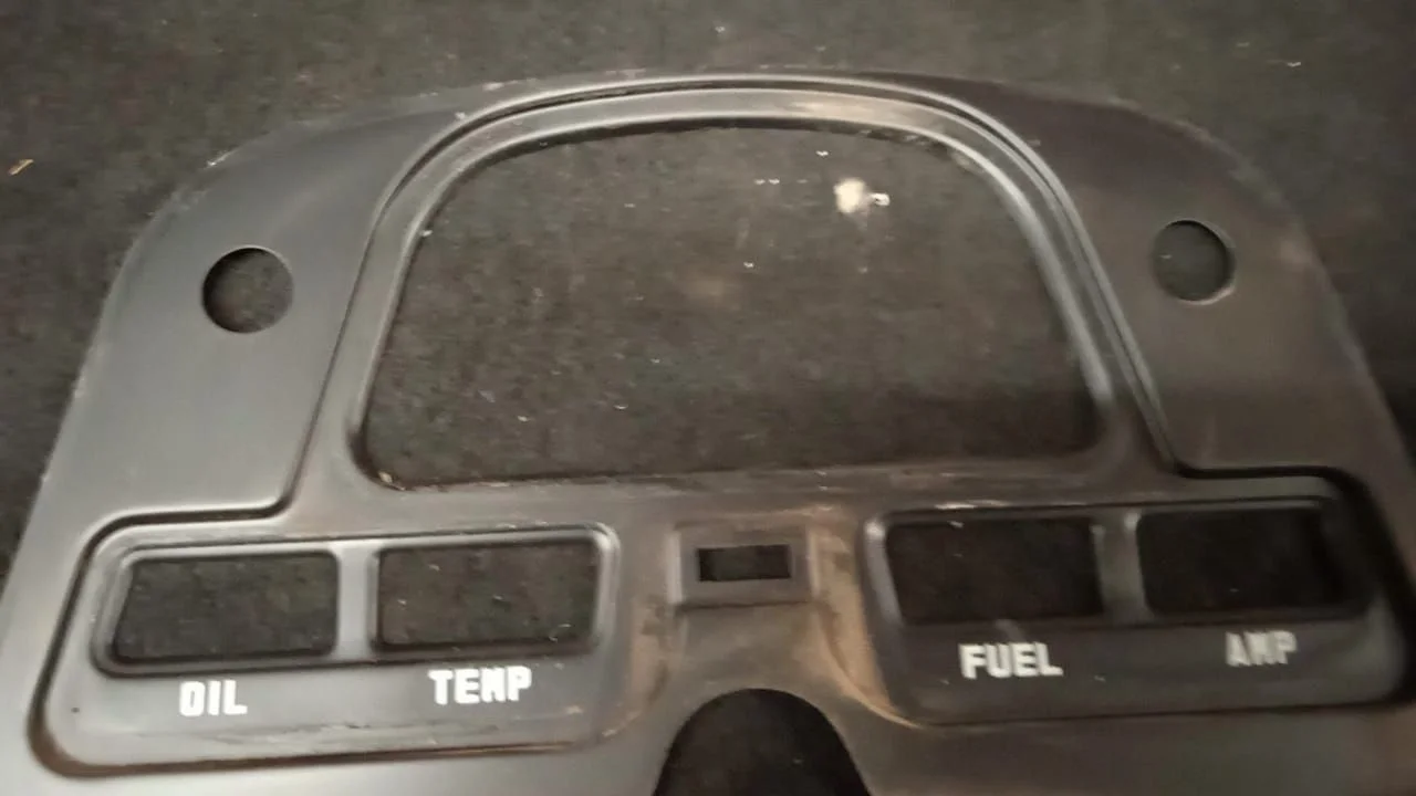

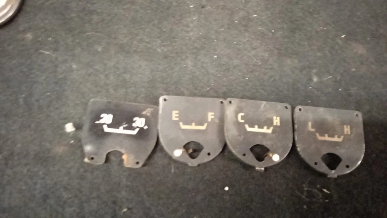

So, cluster time!

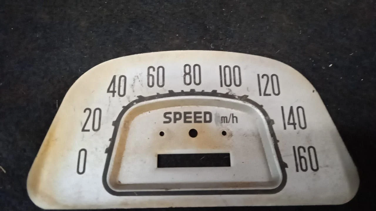

Gauges didn't work, had been replaced and everything was in pretty bad shape.
So I went to one of the mechanical elders of Mexico City, Señor Raúl. He went thoroughly through all circuits and everything was fried. Of course the floater was gone too.
Mexican spec = km/h, PO scratched the "k" off because he though mph looked cooler, even if the reading wasn't accurate at all.

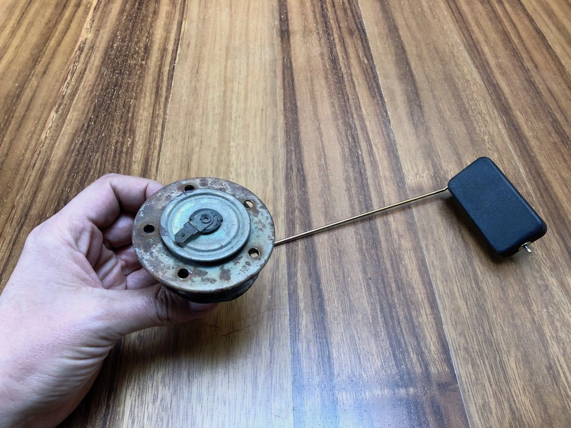

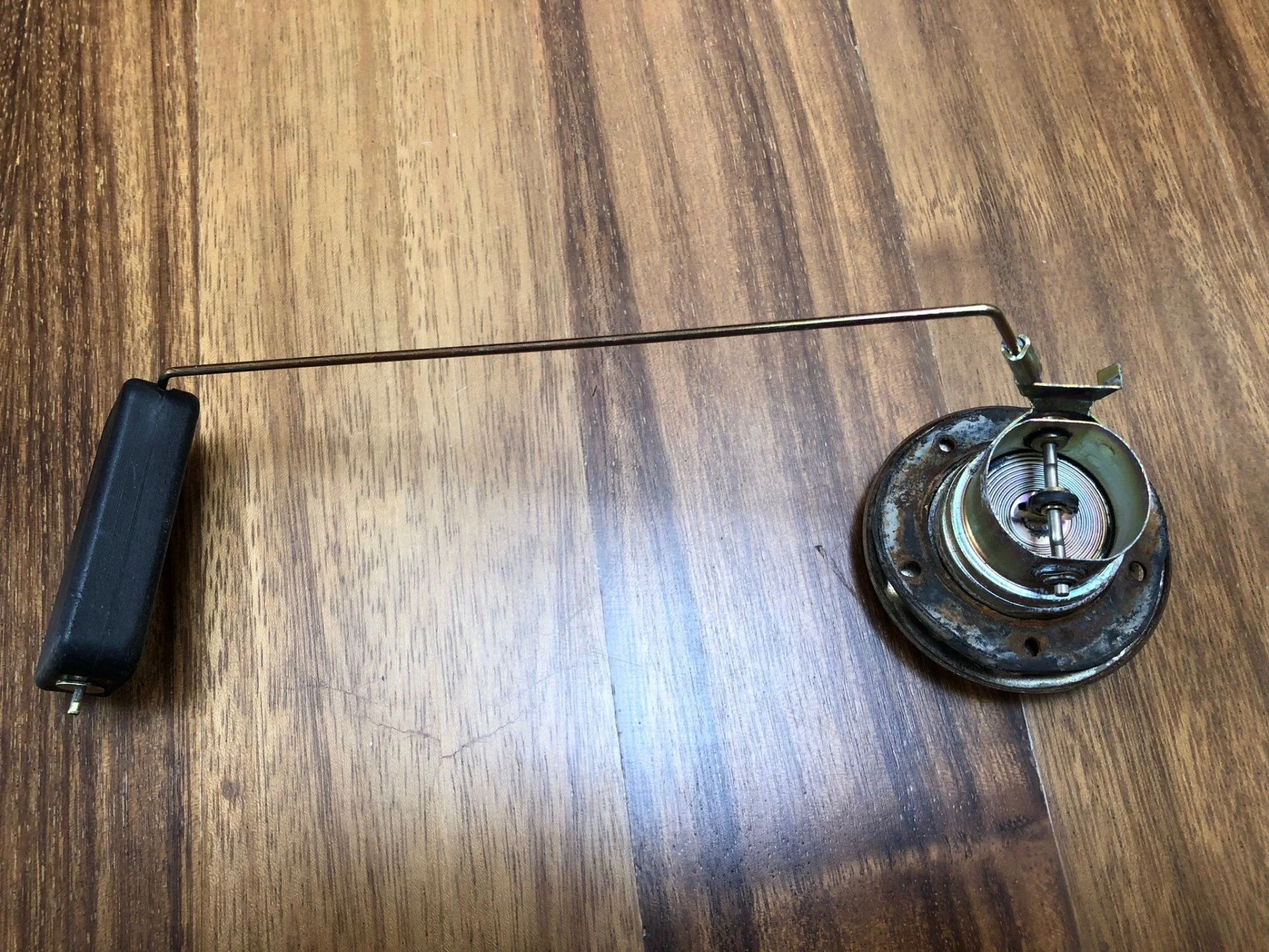

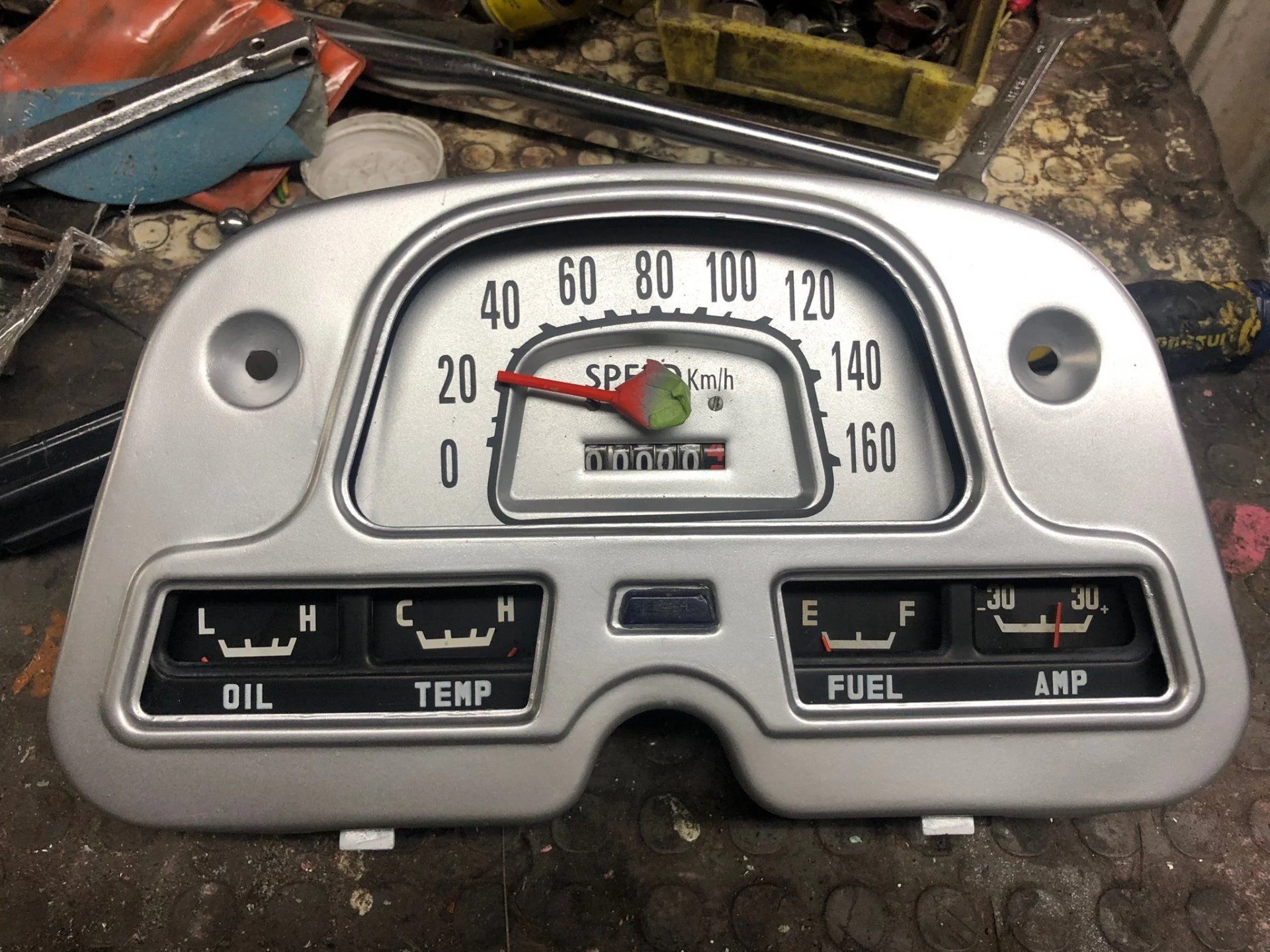

Here's the floater, pretty cool looking and...it works! Everything works! I finally get a break.
This whole endeavour set me back $250, and I got to keep the original cluster frame and most of it remains OEM. Back circuits will have to be adapted as will the light sockets, etc...
That, unfortunately, will not be OEM but will be craft made with the wisdom of a man who clearly knows his circuits.
Here's one proud man with his work. Rightfully so.

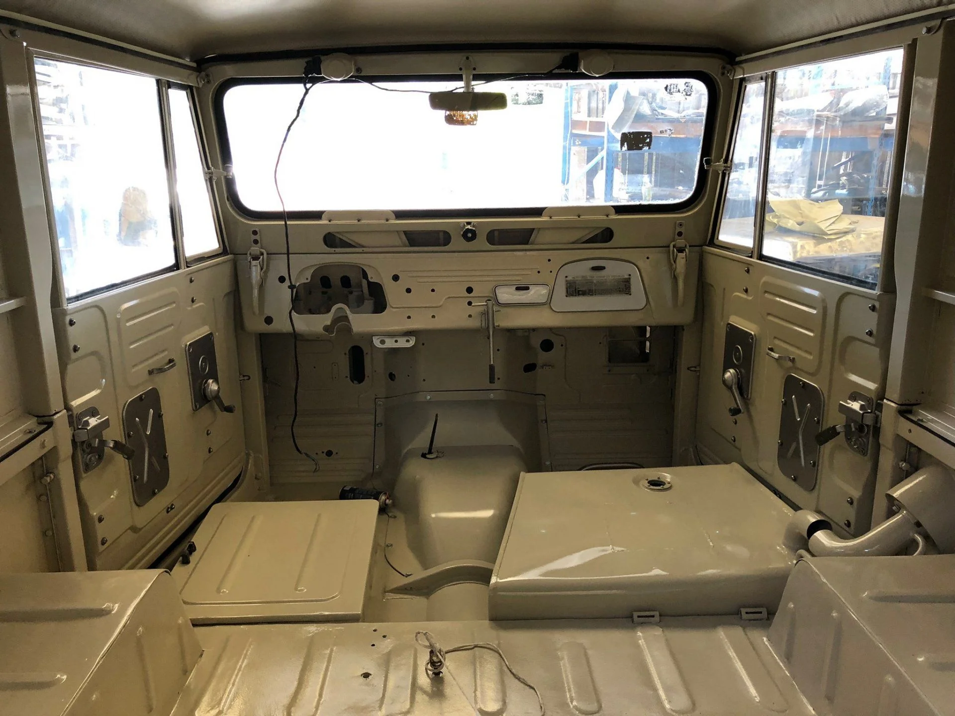

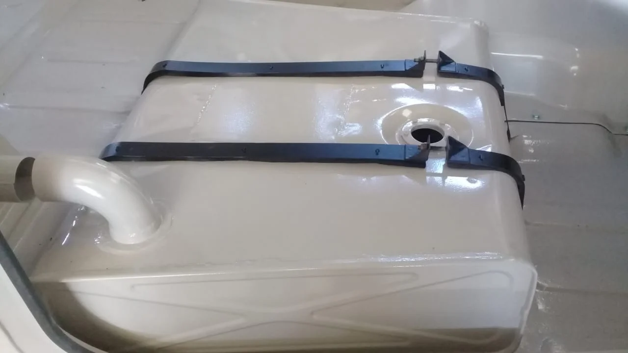

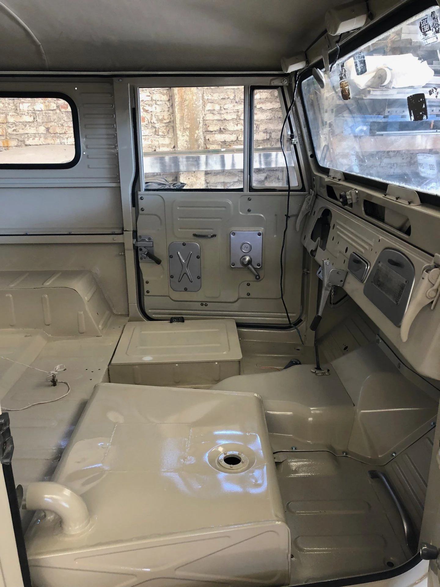

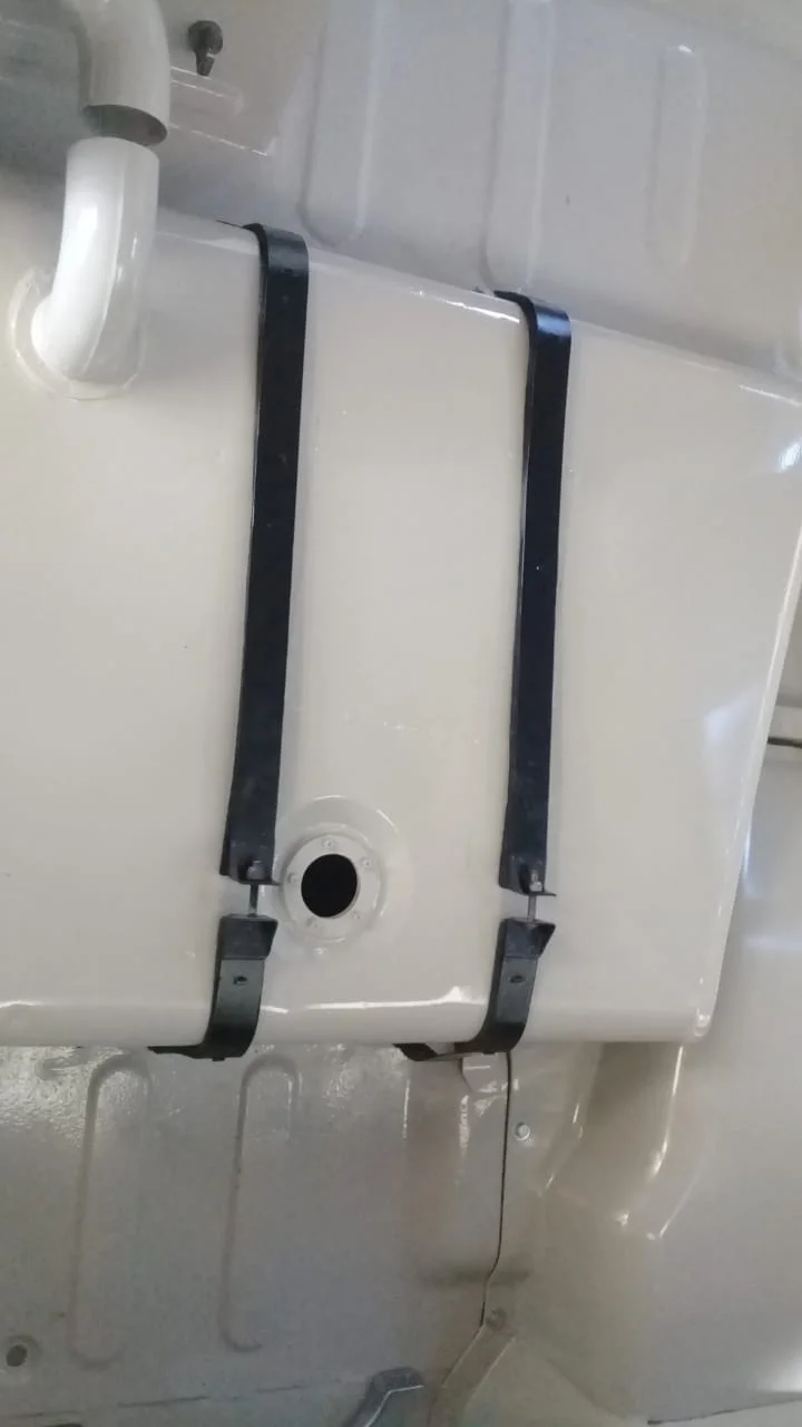

Not sure if you have the gas tank under the seat. If so, please make sure you put a decent gasket on that fuel sender. I could not get rid of the gas smell in the cab until I replaced the gasket.

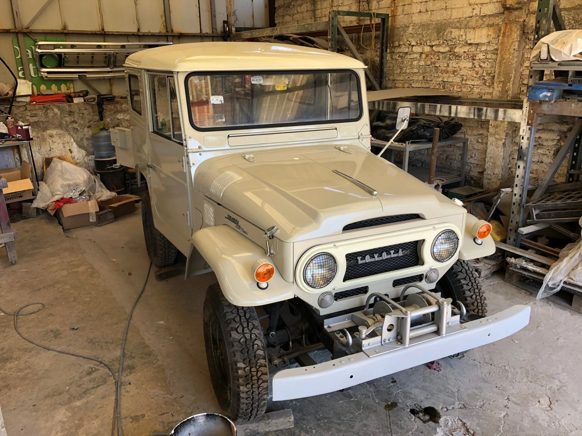

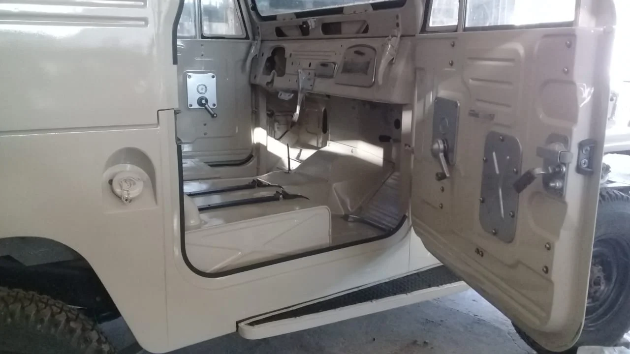

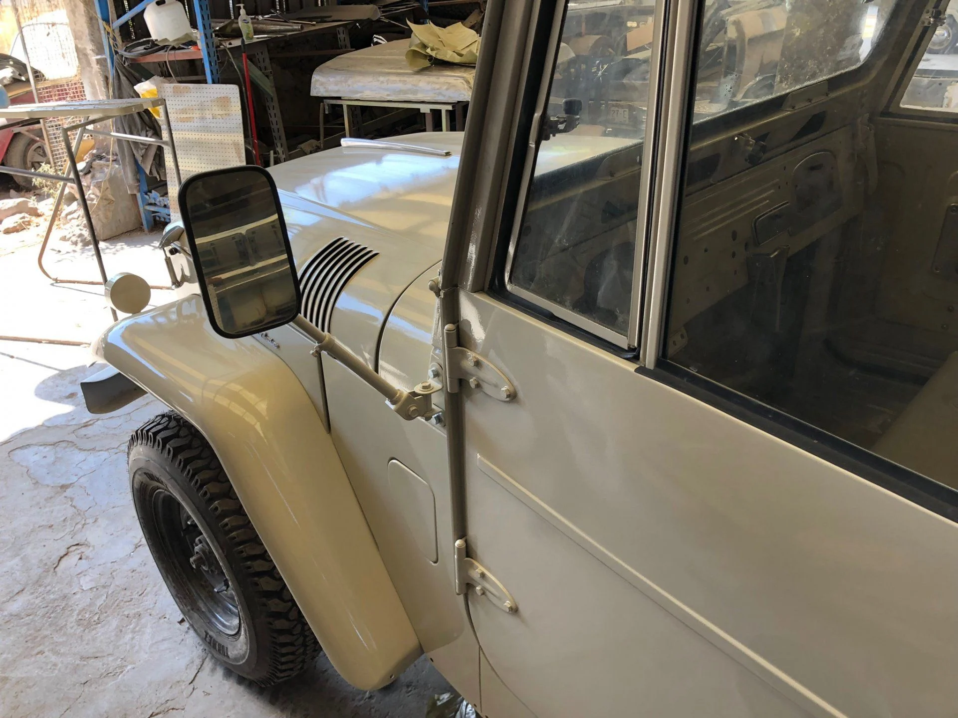

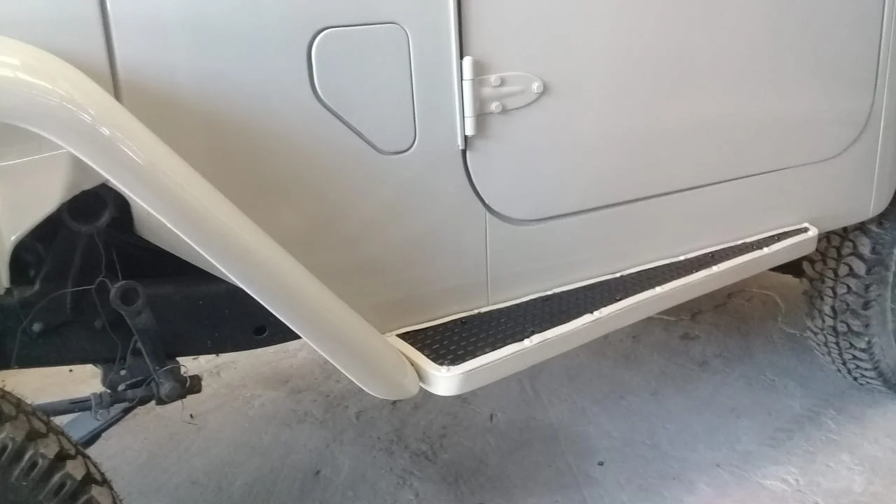

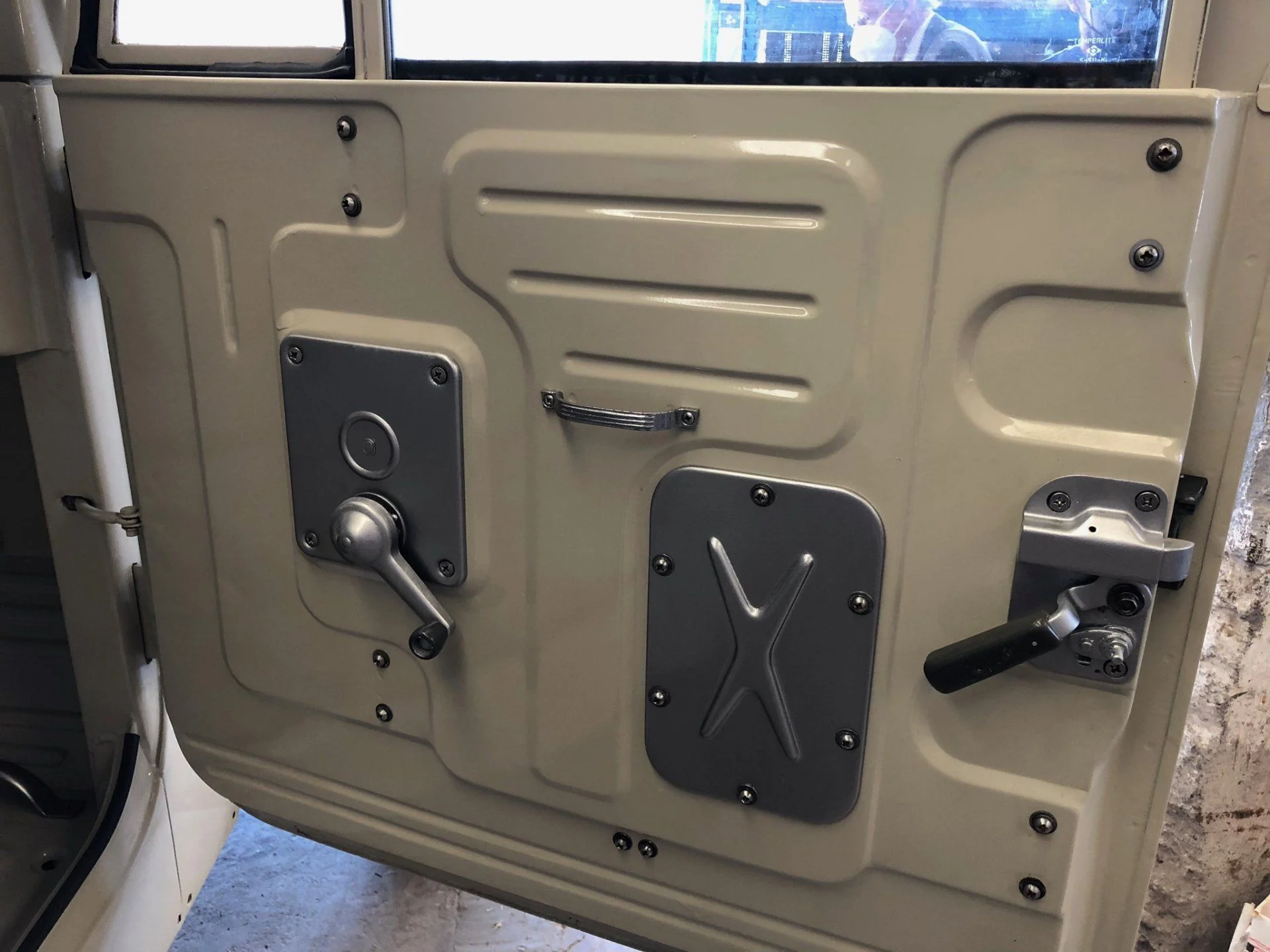

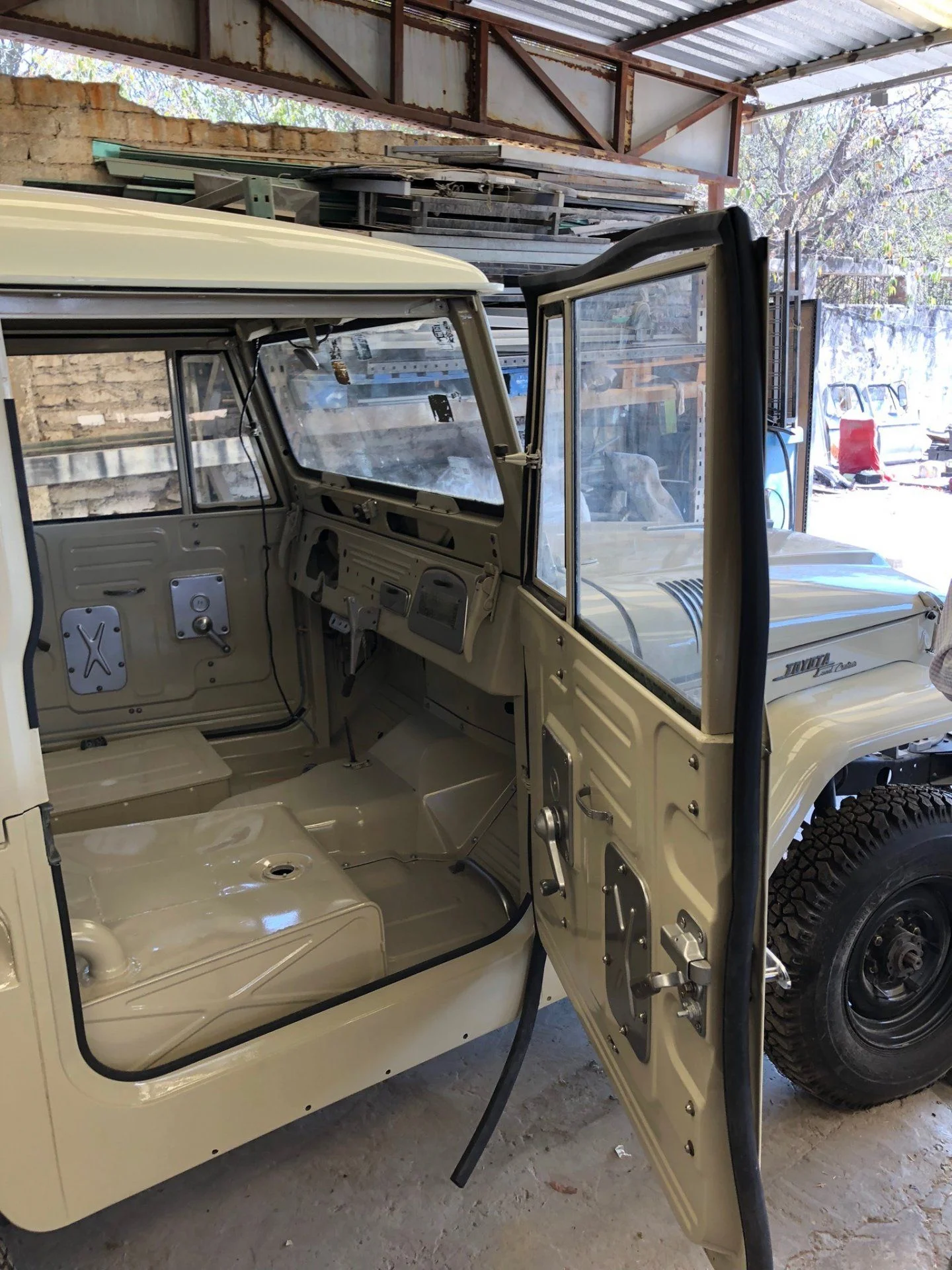

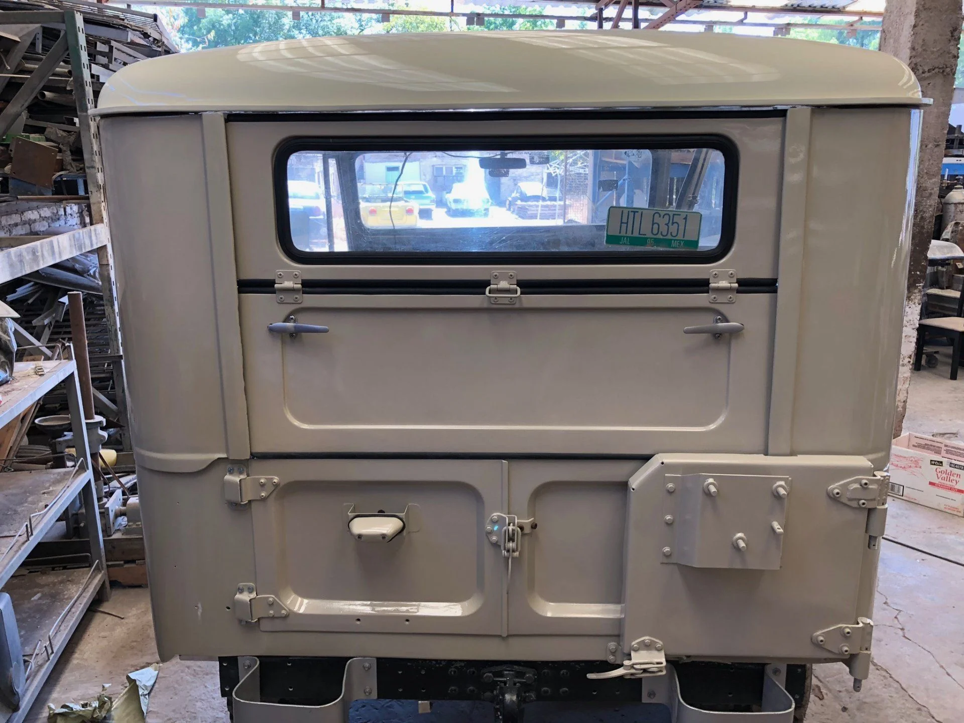

Accessories: painted and installed. Am I dreaming?

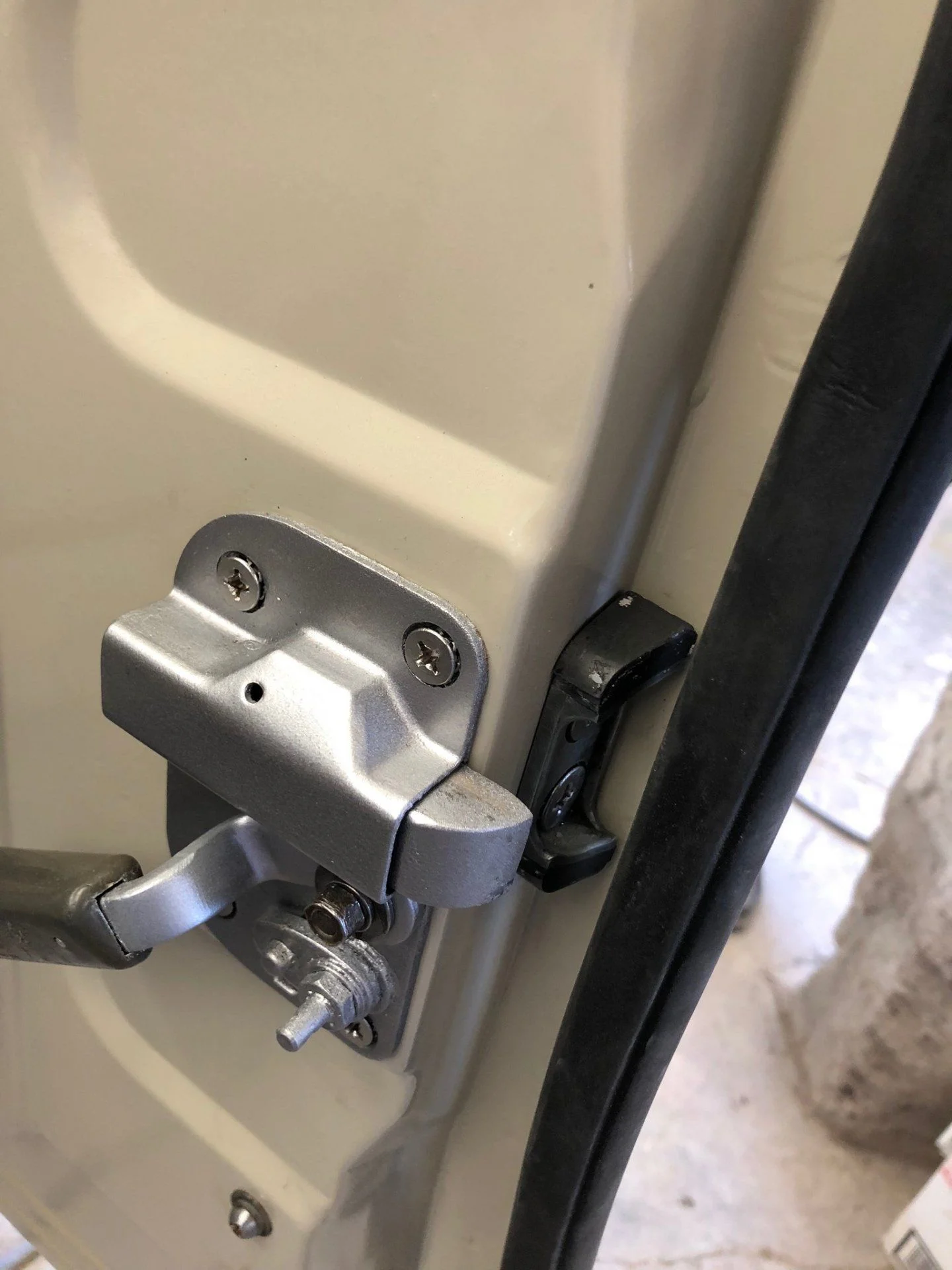

I realize there are some mistakes:
- First, the obvious one: Bugcatcher rubber isn't the right one, will have to do untill I am able to order the correct ones.
- One door handle paddle is broken.
- Rear license plate light should be metallic colored. It's the original one!
Any others I probably missed?
Now the door rubber seems to be an issue. I know OEM is the best way to go but ordering it will take 4 weeks to get here and I'll make do with the ones from SOR I have.
Will cut out the top bit and glue onto the beam connecting hardtop to windshield...

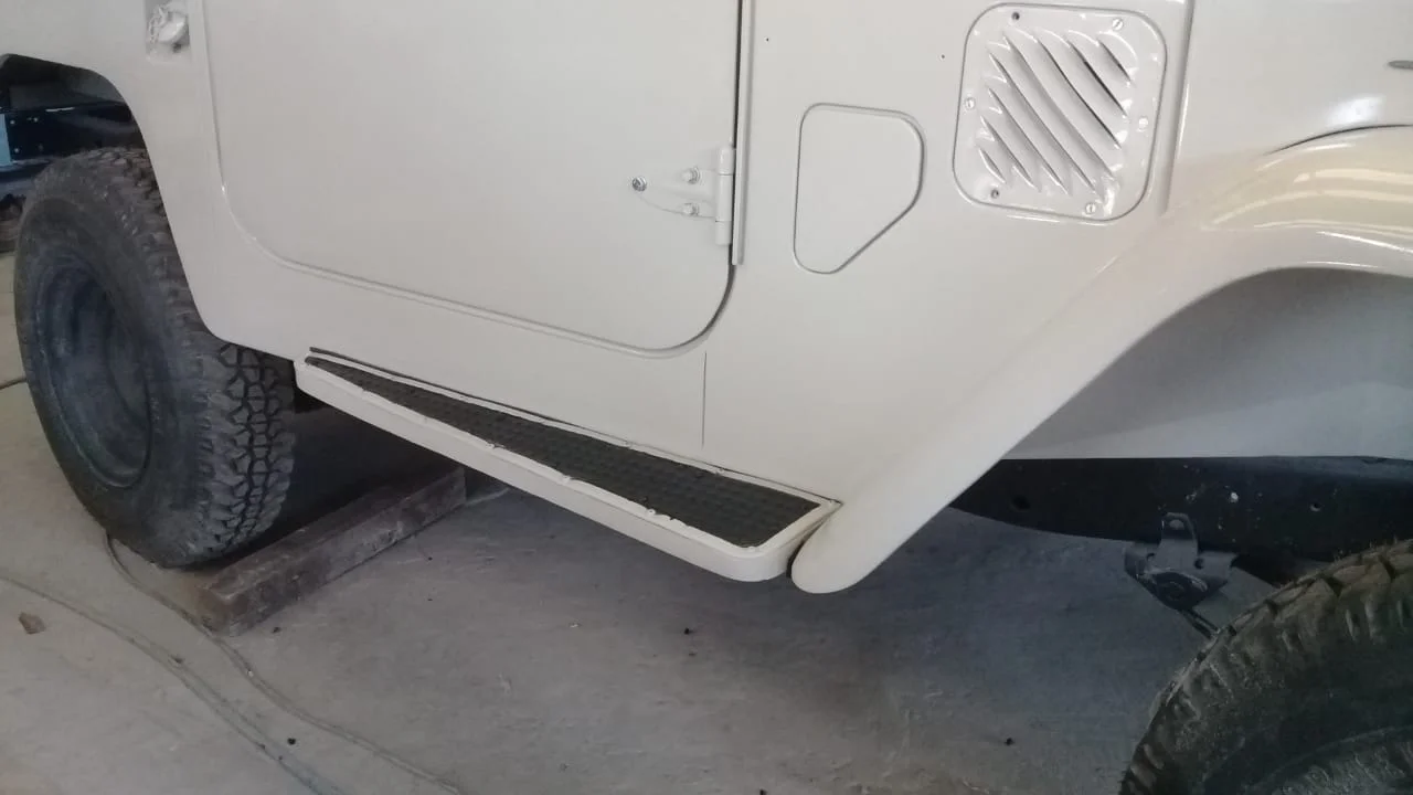

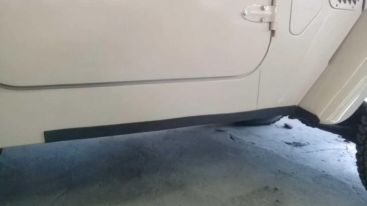

This is a pic after the side steps and tank straps were installed...
I KNOW the gas tan isn't the right one, I have the one @ToyotaMatt sells. Will add it at the very end along with the emblems and reflectors.

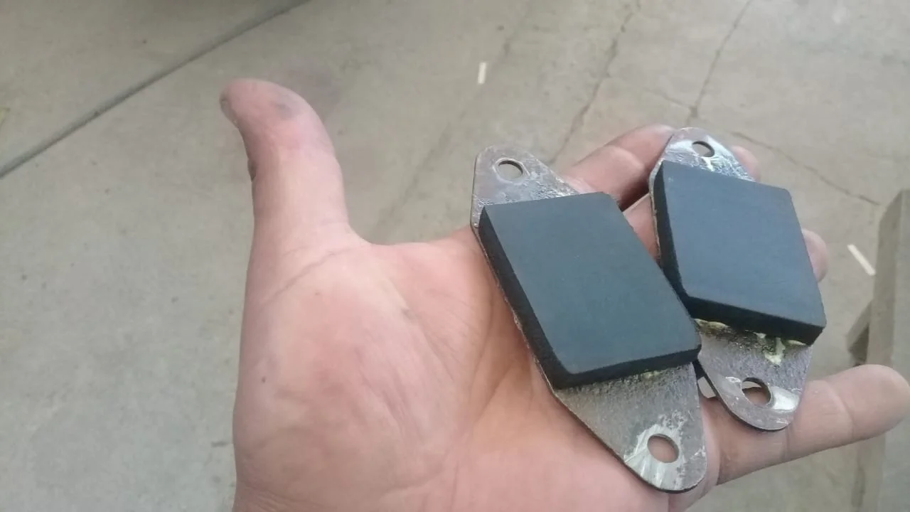

Oh, and rear rubber stops for spare carrier were, well, re rubbered!

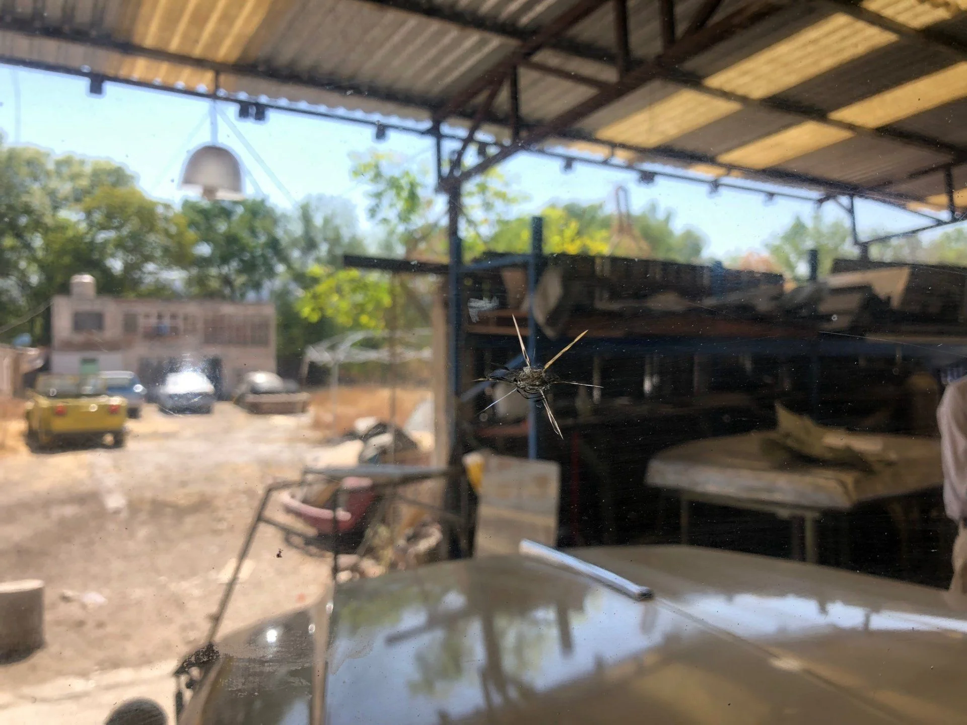

Final pic for today, the windshield is the original one and has this rock chip crack, it hasn't gone through, does anyone have a suggestion for repairing?

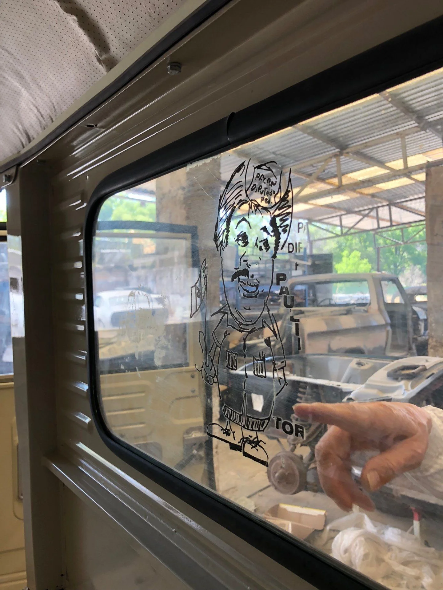

Oh, and P.O. ran for local representative, used the car as his campaign car, I love the cartoonish sticker but it will have to go... @HelloKitty65, notice how the rear side-window weatherstrip joins at the top.
