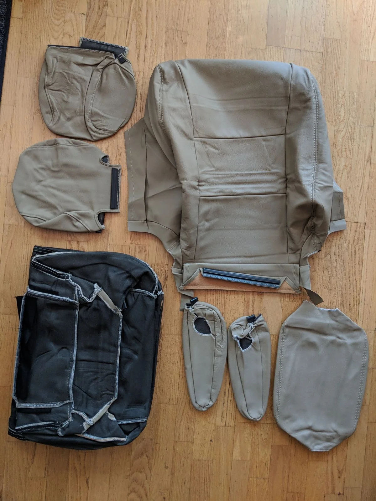

I just received my order last week and I was surprised to see that it had the center console cover included with it. It's in the bottom right of the pic.

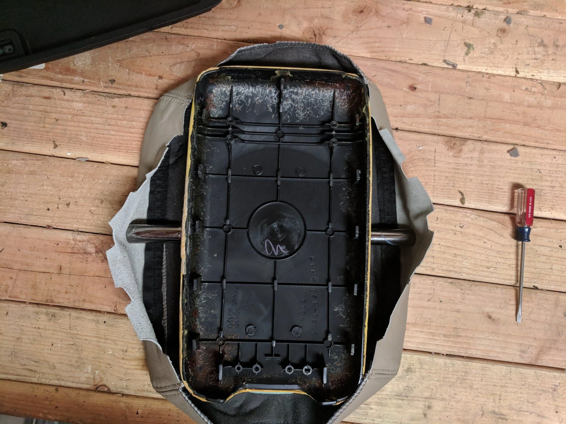

Just finished both seats. Went 5/10 smoothly.
Anyways, after removing the console lid cover I realized that the piece they sent me for this is about 6" too wide. It is about the right length though. If I put it on as is, the sticking will be in a funny spot.
Anyone else have this issue or did they send me the wrong console piece?

I had same issue. I believe they made the cover they are sending for the non-US Cruisers that come with the center fridge and no armrests. Those come with a different, wider console lid.
I ordered bulk material from Lseat, about $18 worth. Took it to my local upholstery shop and they made a perfect cover for $90. Someone else on Facebook took the oversize cover to the upholstery shop and they took it apart and re-did it to fit.
Lseat offered to make a new pattern if I sent my console lid to them, but I did not think that would have been a very smart idea on my part. Maybe it would have been OK, but was not willing to risk it.
