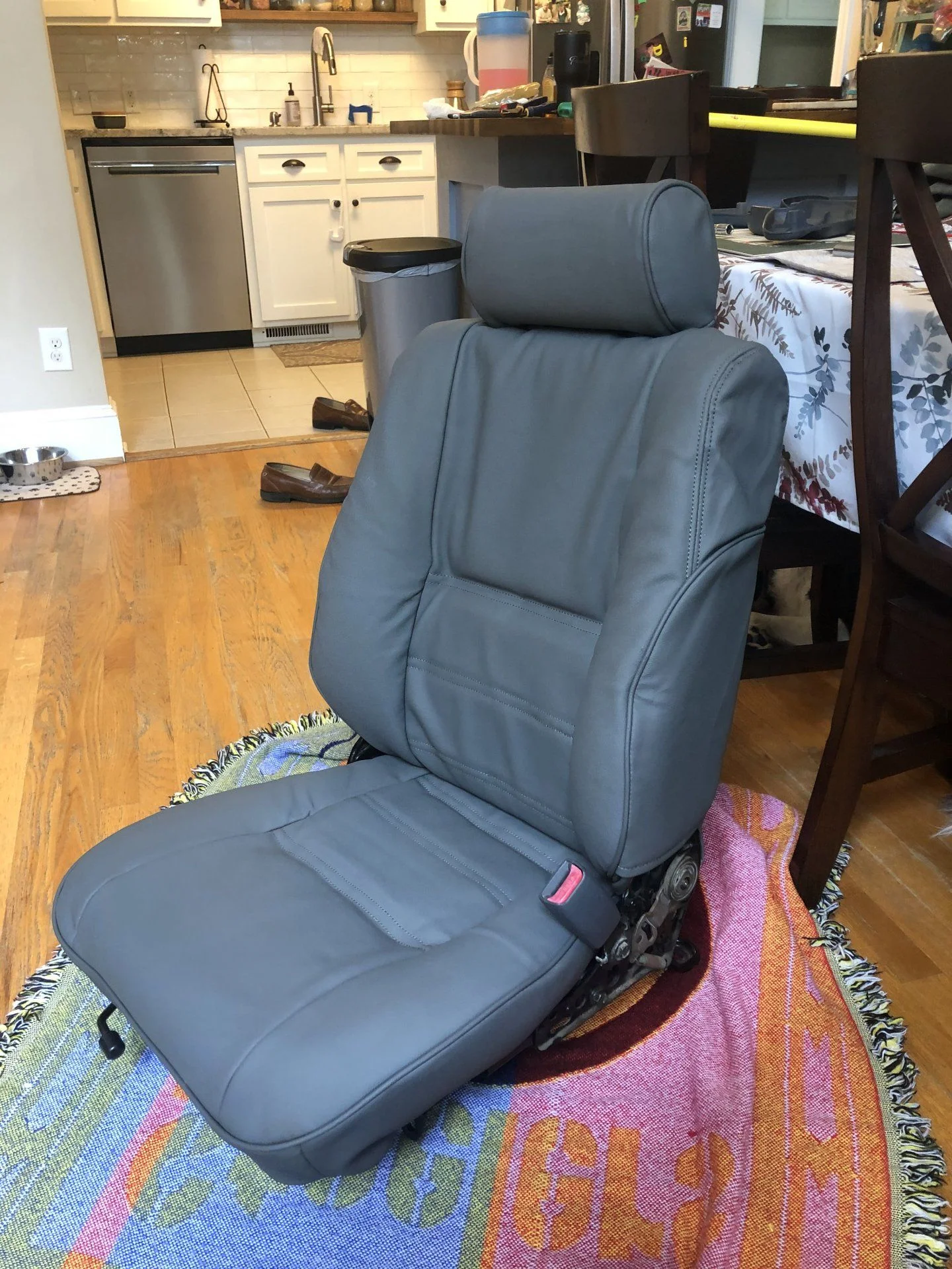

94 with manual seats. Selected the manual seat option. Bottom fots well, there is a lot of extra material to the top. Not super happy but for $350 its fine. Ive had land cruiser hheaven in my 100 and Katzkin in my Tacoma. These fit worst of the three but are also the cheapest. Go figure
I used lseats and the shipping was definitely quite a while. Added extra foamand turned out great! Much nicer than the tired old seats. Very happy with the results so far. Time will tell how they hold up!
I did not have to add any stitching or fittings. It was perfectly shaped and had all the plastic pieces to stretch it out correctly onto the seat. Was very reassuring when everything when back together just as how it came apart. Very diy friendly if you want to take the time!
I'm not sure why the fit is so bad with those, I've never seen them be that loose. Did your foam shrink or something? Maybe you missed some hog rings?

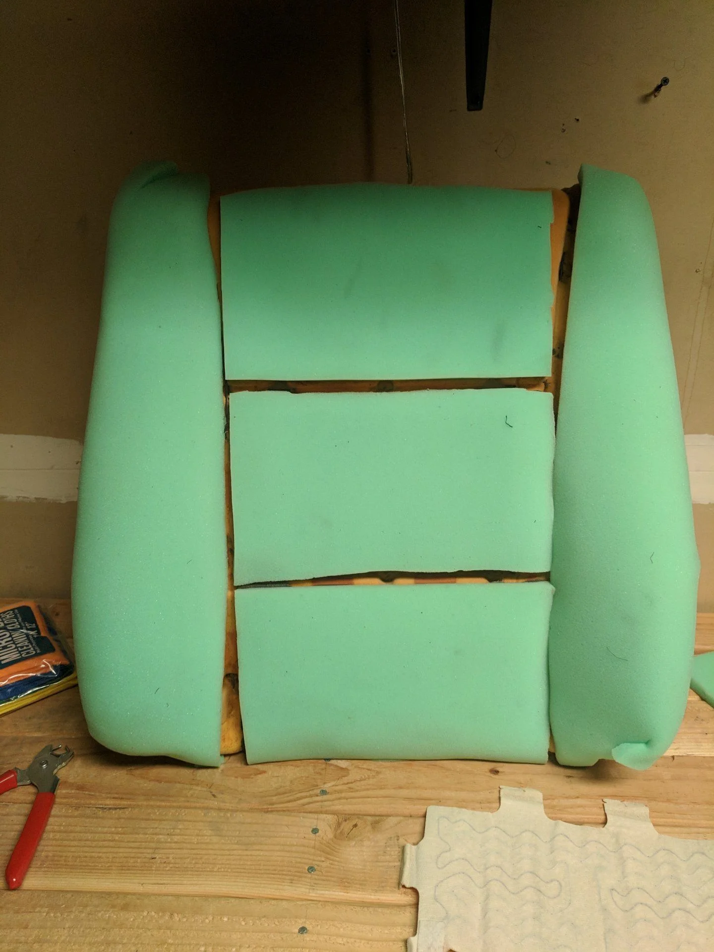

You could tighten them up by removing them, laying down 1/2 foam on all surfaces, and then reinstalling. Not only do you gain cushion, but they would fit better.
Roughly like this.... Just used spray adhesive to keep the foam in place while installing the leather.
Im sure the foam is worn, but not by that much. Adding foam is the plan at this point

For my install it made the seats so plump that the leather was crazy hard to install with an extremely tight fit. I would weary of adding foam, I did try to fill one tiny dent BUT if it’s not perfect and there are any seam (spacing as there can be no gaps and it must be shaved and contoured) lumbar issues, you will have to do it again. You will know about the seams and feel them.

i did not steam and ended up not adding foam. Ive had some success with wetting it and leaving it in the sun like @loganbrew suggested. Overall its much better that that i gad so im just gonna live with it
