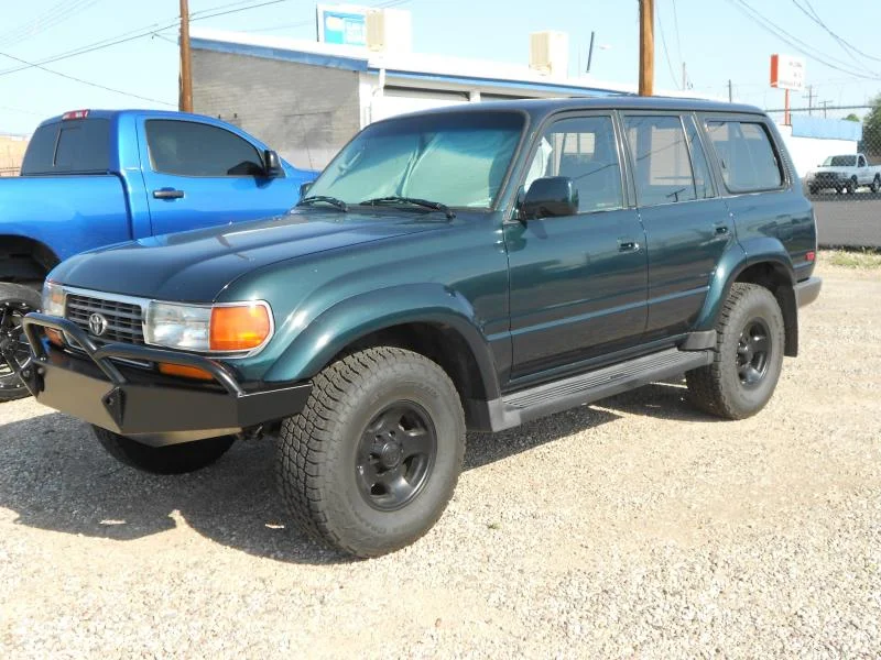

Coolstream, really like your rig and suspension set up. What size tires you runnin and which bumber is that?
Thanks
Thanks!
Tires are 285/75-16 Nitto Terrra Grapplers, the bumper is a custom one from Tommy Gun Fabrication in Phoenix. Build thread here.
