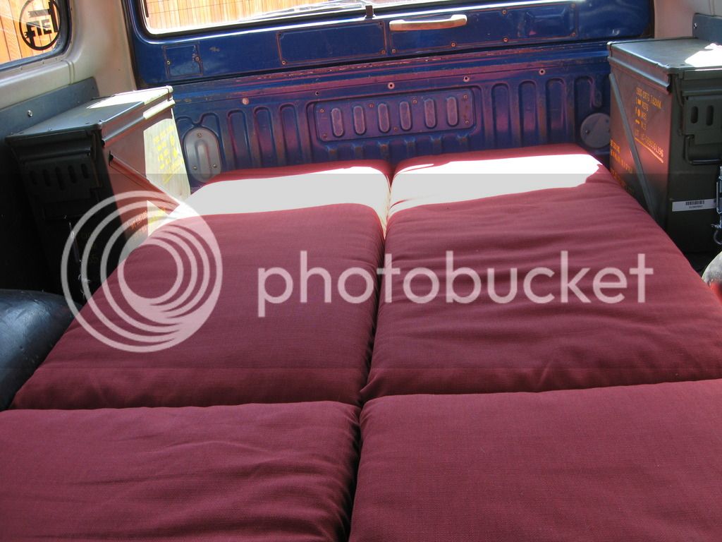

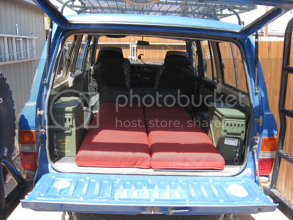

We are in the process of setting up the FJ60 for sleeping. Sometimes a tent is just too much trouble.
Platforms and drawers are popular but this is going to be basic. Partly because I want to be able to sit up. Both of us are tall and neither of us are as flexible as we used to be. Having plenty of room is important.
Have strung 1/16 wire rope down both sides A to D pillar for privacy curtains. The copilot should have the curtains made in a few days.
The two cushions fit the cargo bay perfectly. When the back seat is removed will need to fill the gap somehow. Maybe one of those 10 gal footwell water tanks.
The cushions are from Home Depot. They are Hampton Bay brand and are meant for chaise lounges.
The two ammo cans hold tools and recovery gear and will serve as nightstands.
Future plans may include a cargo net "attic" to store the cushions when on the move and whatever other changes we decide are needed after a shakedown cruise.
The cushions in place:

Remove the rear seat bottom. Then you have 6' from hatch to front seat back.
That is definitely on the list - thanks. I'm 6'4" and could use the length.

Where did you get those ammo cans? They fit nicely and are exactly what I'm looking for.
I bought them on ebay. They can be found at most gun shows and surplus stores.
Specifically they are M548 ammo boxes. These are the big ones with internal dimensions of 17-1/4" L x 7-1/2" W x 14" DP and are used for 40mm, 20mm, and 7.62 ammo. Lined the inside with cardboard to reduce rattles.
Yep-this makes a huge difference. If you slide the fronts forward, you'll have plenty of length to sleep inside.
I got rid of the rear seats all together an built a platform. I'm 6'2" and have at least another 2-4 inches available.
But sleeping inside is the best, and takes the stress out of weather and other problems.
But I have to ask, where are you going to keep the fridge?
I will remove the seat bottom but probably keep the back intact. I do need the rear seat from time to time.
As to a fridge.....I'm a Neanderthal and still using a cooler.
@NookShneer used a pretty slick removable pin system to quickly take out/install the rear bench. I think he made a thread on it.
