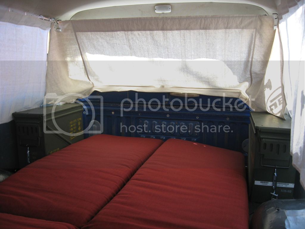

We've been using an air mattress in the back but I'm not digging it. I was leaning toward a futon but the home Depot cushions look interesting...
For what its worth, the main advantage to these is that two almost exactly fit between the wheel wells. Have not slept in it yet. Will probably throw in a couple of self inflating sleeping pads as well.

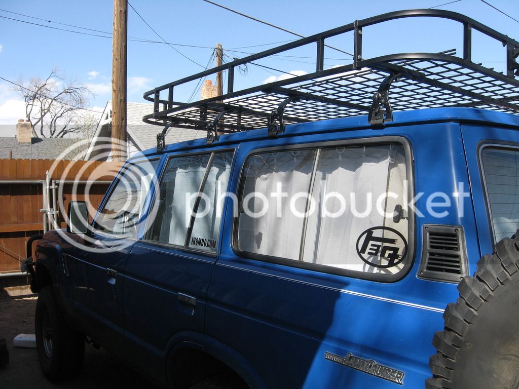

The copilot finished the privacy curtains.

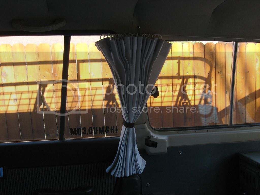

This setup is simple and basic - no insulation, no black-out feature. She used canvas painters drop cloths for the fabric - cheap and good stuff. Mounted "rope loops" to the roof in the four corners. Then strung 1/16" wire rope front to back, tensioned with turnbuckles. The front and rear curtains are on bungee cords strung between the corner rope loops.
She used curtain rings with a loop for the suspension wire and a clip which attaches to the fabric. Also sewed in some snaps to close up the corners where the different pieces meet.
The side curtains bunch up small and will be stowed at the 'C' pillar when not in use. She will make sleeves to cover the side curtains when stowed - this so they do not pick and hold trail dust.
Also removed the rear seat back. Looks like that space will hold at least three Scepter water cans.
Not perfect but we are both pleased with the result.
Removed the rear seat bottom. Used a Dremel with a cutoff wheel to remove the hinge pin rivet head. That adds a lot of room. The bonus is three Scepter war can fit right in the gap.
