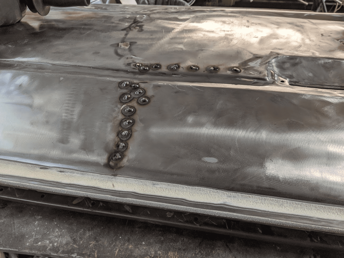

1. Weld the studs onto the panel inside of the dents. Imagine how the dent was made, and make pathways with the studs, so that you can pull the dent out in the order that it was made, from the shallow bit to the deep bit. At least I think this is what you're supposed to do.
2. Once you're done pulling, cut the studs off and save them if you'd like.
3. Sand smooth.

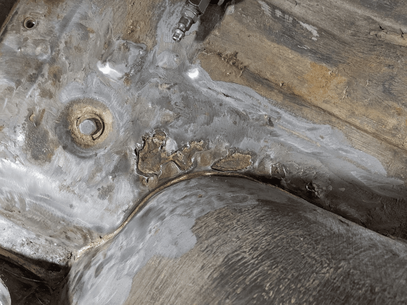

After that was done as best as it could be, I started wire wheeling, and found......you guessed it.............more rot! Fun fun. Elected the surface fix, because pulling this section apart would mean removing the door skin, then figuring out how to separate the internal frame sections. Not worth it. Treated with Ospho and weld.

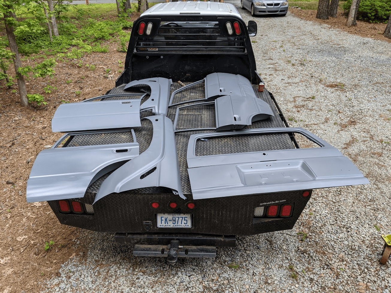

With that fender complete, all of the doors and all of the fenders were now finished. Felt damn good to get to this point.
Since we're now in the humid months, bare metal doesn't last long before it starts rusting. The doors/fenders I did a few weeks ago had significant surface rust on the skins, and the recently completed doors were developing surface rust in a day or so. Pushed to surface condition all of the panels and shoot them in epoxy primer this past Tuesday.
I've learned two things:
1. Primer shows the remaining dents *so well*
2. I love shooting paint with an HVLP gun. So damn easy, and it forces me to do the prep work I so often neglect before throwing paint.
PS rear door showcased most recently in post 3841. Looks rough in this pic, but I'm confident the end product will be good.
Same door different angle:
DS front. This one had the most work in it, despite being the only door I bought as a replacement :lol:
DS rear:
Fenders look pretty good, considering what they were before. Not too worried about the dents here, as they're probably going to get smashed again anyway. I'll most likely do a bit more hammer and dolly work on them before bondo.
I'm super proud of how the tailgate came out. If you recall, this panel had the bottom 3" entirely reconstructed, inside and out.
Shaved tailgate:
PS front door. Again, looks pretty rough in this angle (and it is) but it'll turn out nice with a *little* bondo. My goal is not to make it look factory straight, because that'll never happen, just to make it look presentable.
All together now!

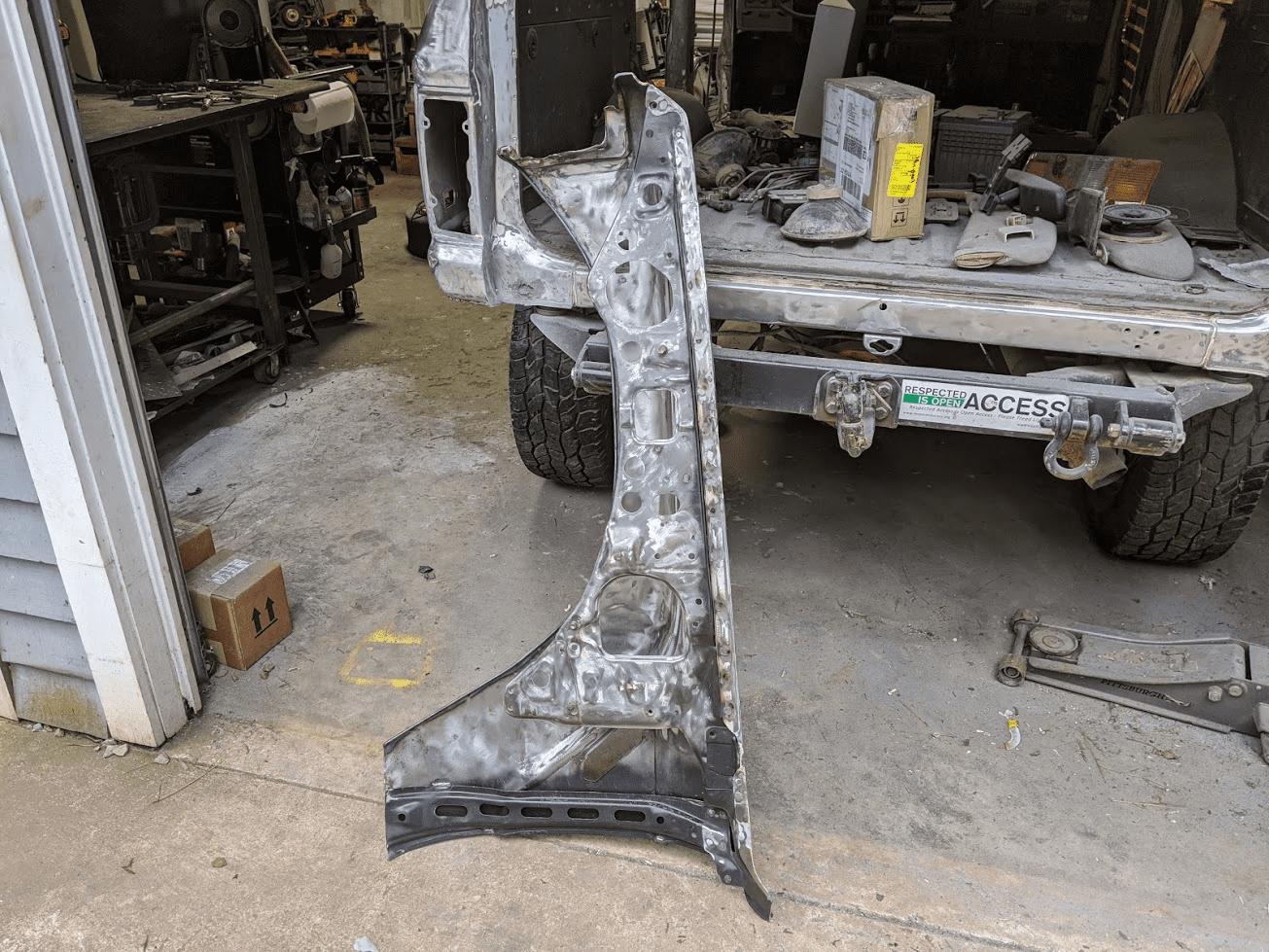

Now that these guys are done, it's full steam ahead for the body shell. Have a bunch of stripping and rust repair to get done, including capping the rockers I chopped off 8 years ago.

Just the mig welder. The kit from Eastwood has a nozzle that clamps onto the mig nozzle, but I find it easier to hold the studs with a gloved hand and tack the bottom.

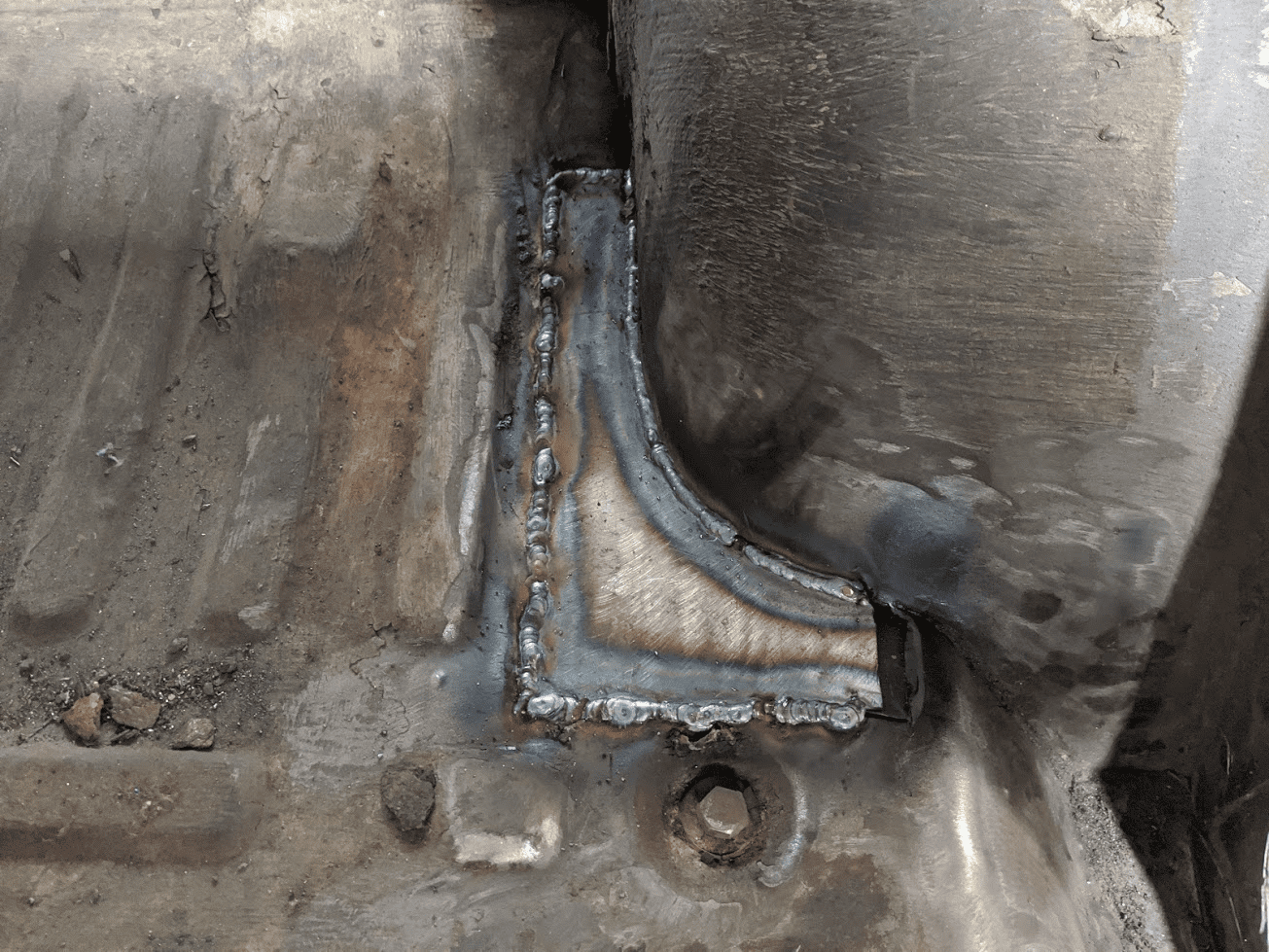

Working on getting the driver's side squared away, so that I can prime it before moving onto the passenger side. The body shell is starting to rust quickly now that we're in the humid months.
Rear body mount:

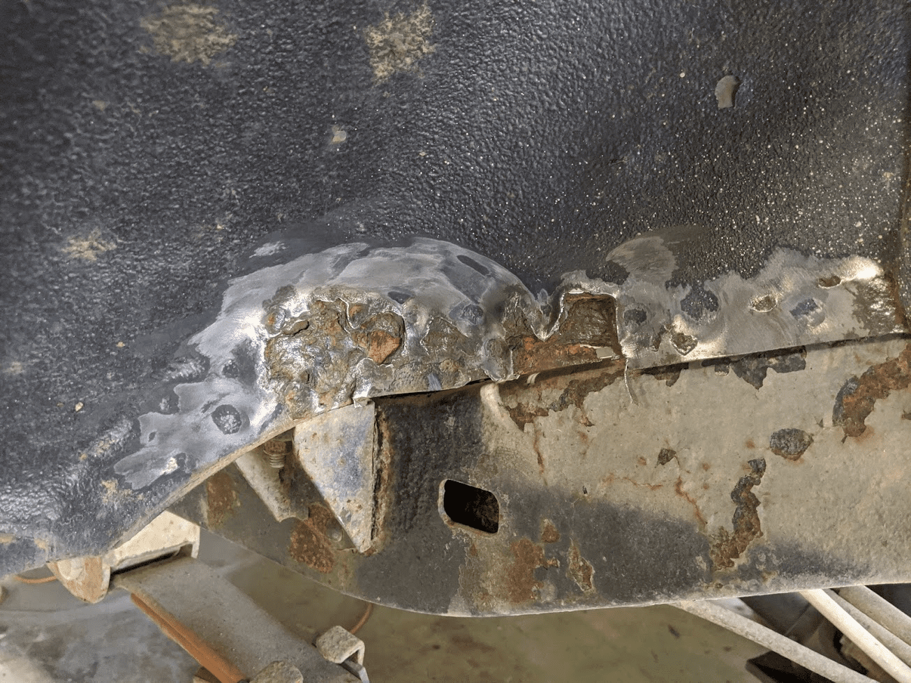

Finally, little spot on the rear quarter that's developed since the chop a number of years ago.
