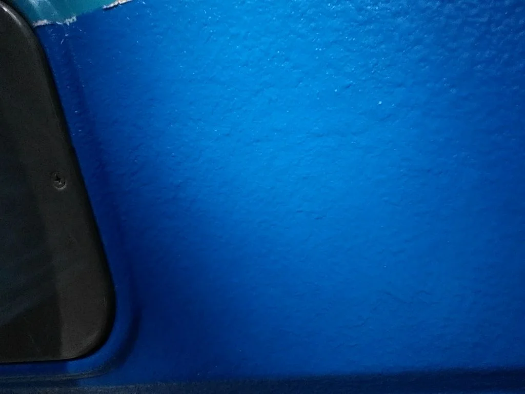

My 79 I just did and I should have went with tarheel blue. I guess I'm going to have to paint it the same color now. I roll it and didn't go over it at the end like they said to do it is smoother . Also when it didn't cover I would use a regular roll then use there roll .

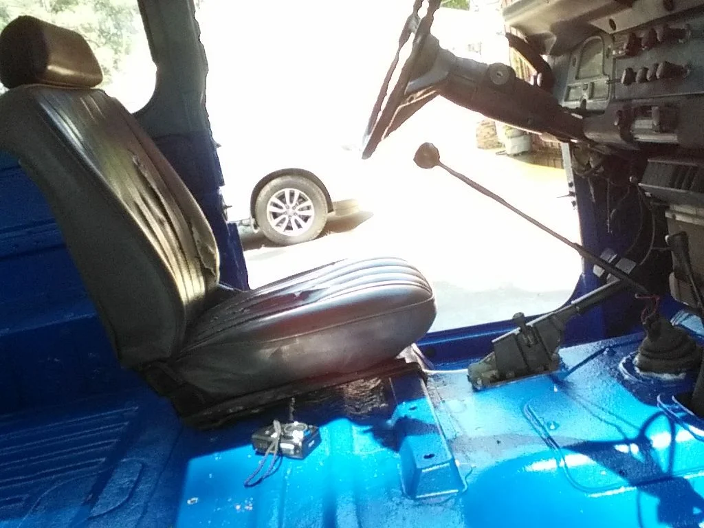

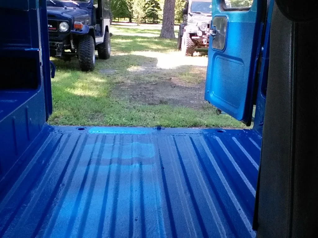

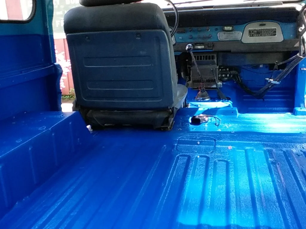

Here's how our ute turned out in Monstaliner. Still need to modify the bed and then paint it

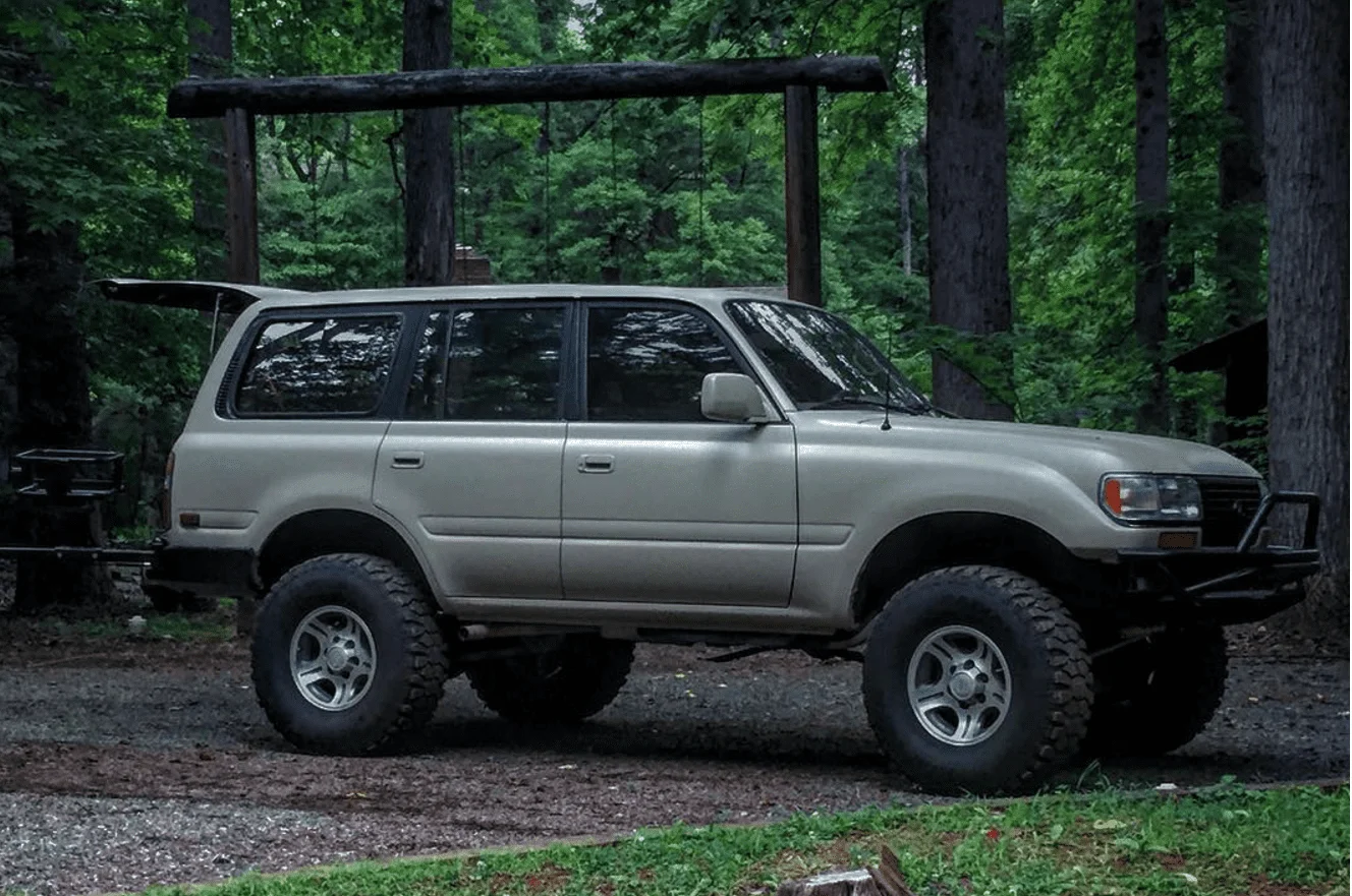

Dude I love the Cement Gray color, I was chewing on that for mine too...
Thanks, long project of rust repair and I was really looking for a finish that accomplished a few things:
1. I did not want to spray. I do not have a good workspace to do that and after brush / rolling everything I feel like it is better sealed than when I had sprayed parts.
2. I wanted a finish that at best could be hosed off. I painted it "nice" 15 years ago and never waxed or really washed it, it's a tool and I use it.
3. I did not want it to look too rough. In hindsight I wish I had experimented more but it is tough with the pot life. I did the roof with the monstaliner rollers so it has more texture and then moved to the small foam rollers for the rest. The larger areas like the hood would be easier with a smooth foam 9" roller.View attachment 1454221 View attachment 1454222 View attachment 1454223 View attachment 1454224

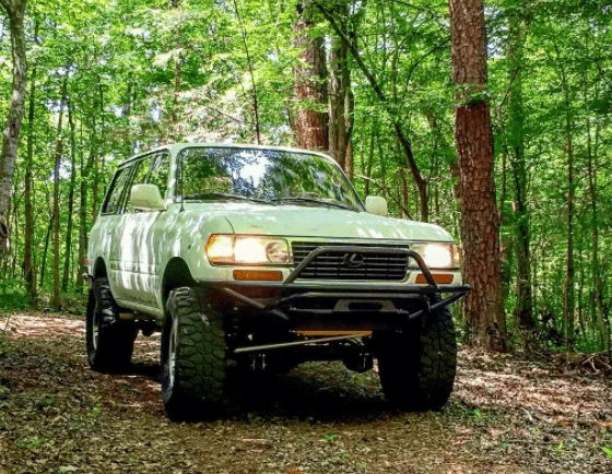

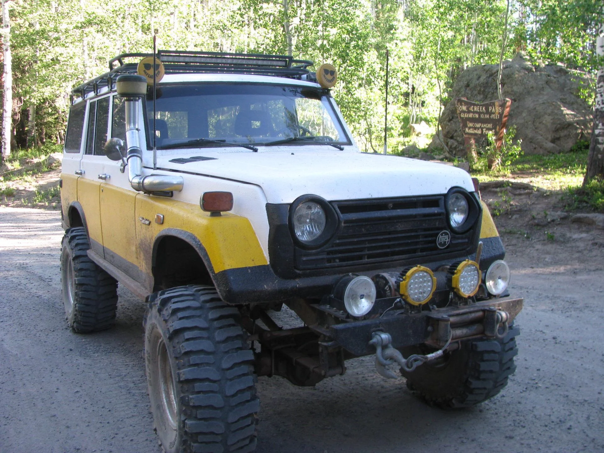

I also rolled ML on my FJ55 also. It is white, black, and "Don't Yell at Me". Very pleased with the results. If I can say the worst thing about it that would be that the attention this truck gets now.
I ordered a ML color chip in white. It's really bright, especially when held up against my white '00 LC.
I plan on MLining the rockers and rear bumper cover.
