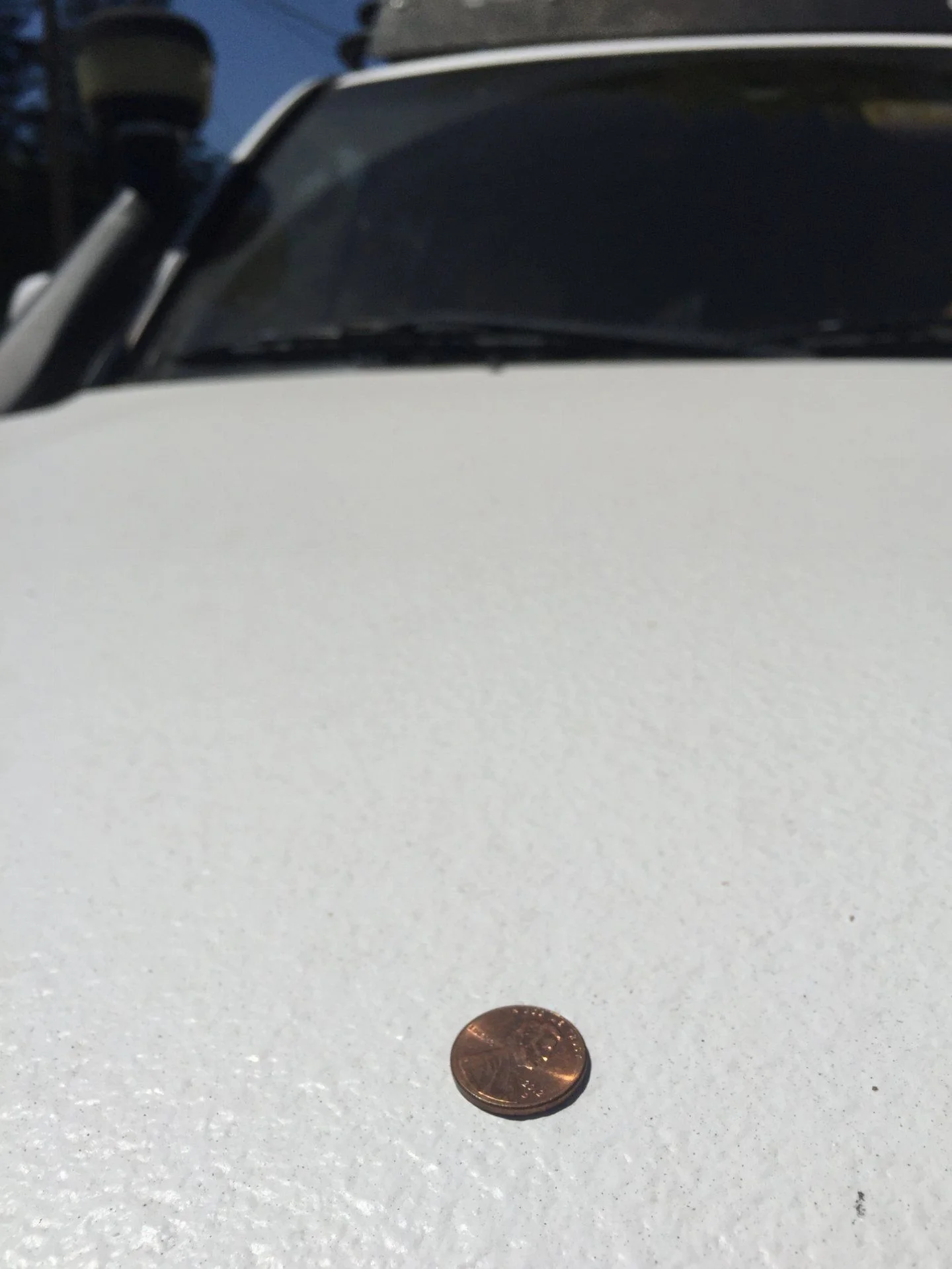

Hi do you have any more pictures of your monstaliner up close. The texture you achieved is very intriguing. You mentioned that you sprayed with the nicer gun at 70-75psi. Did you also reduce it with MEK or anything. I am hoping to gain some clarity on how you were able to achieve the texture you wanted.
Thanks!

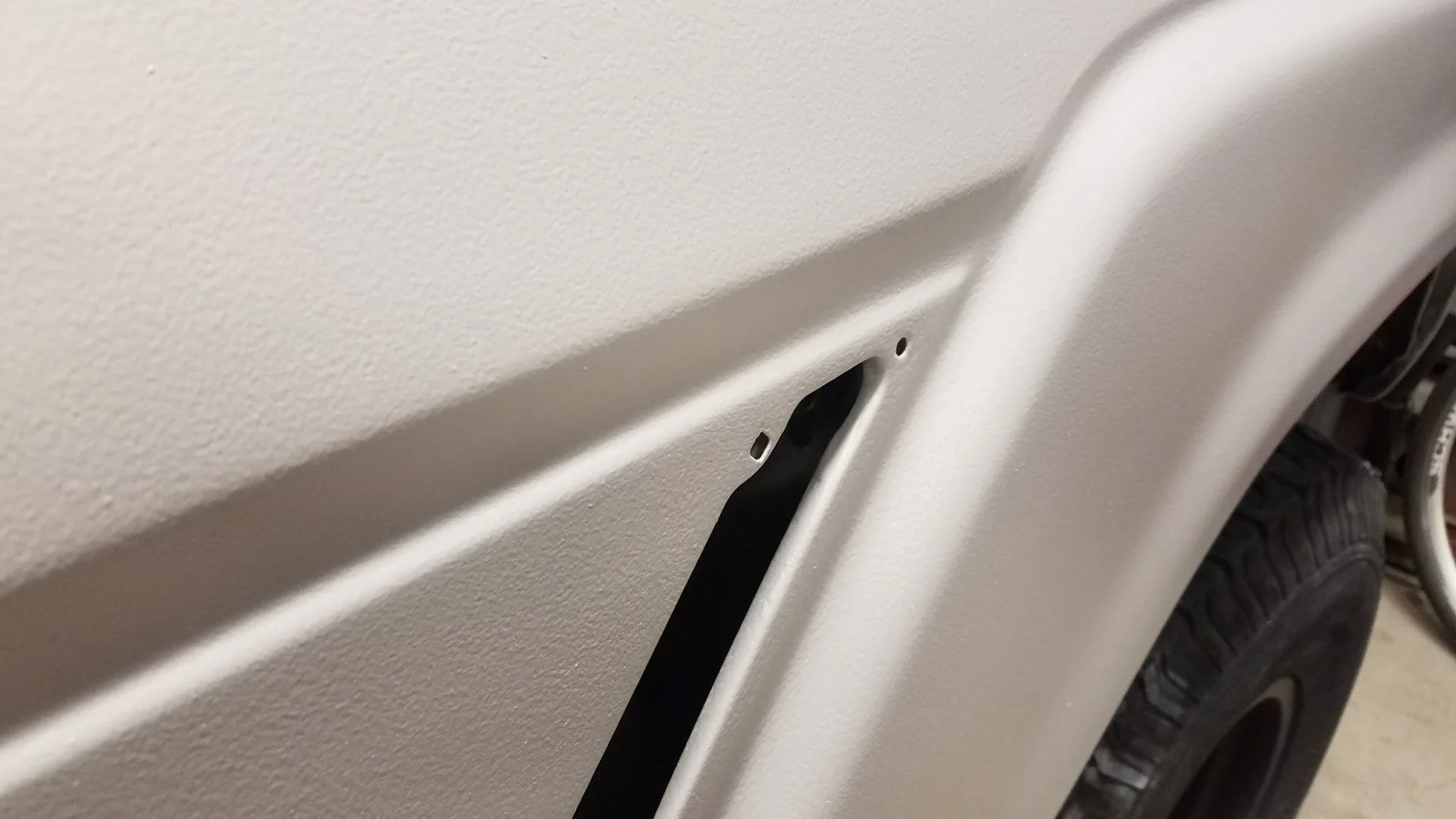

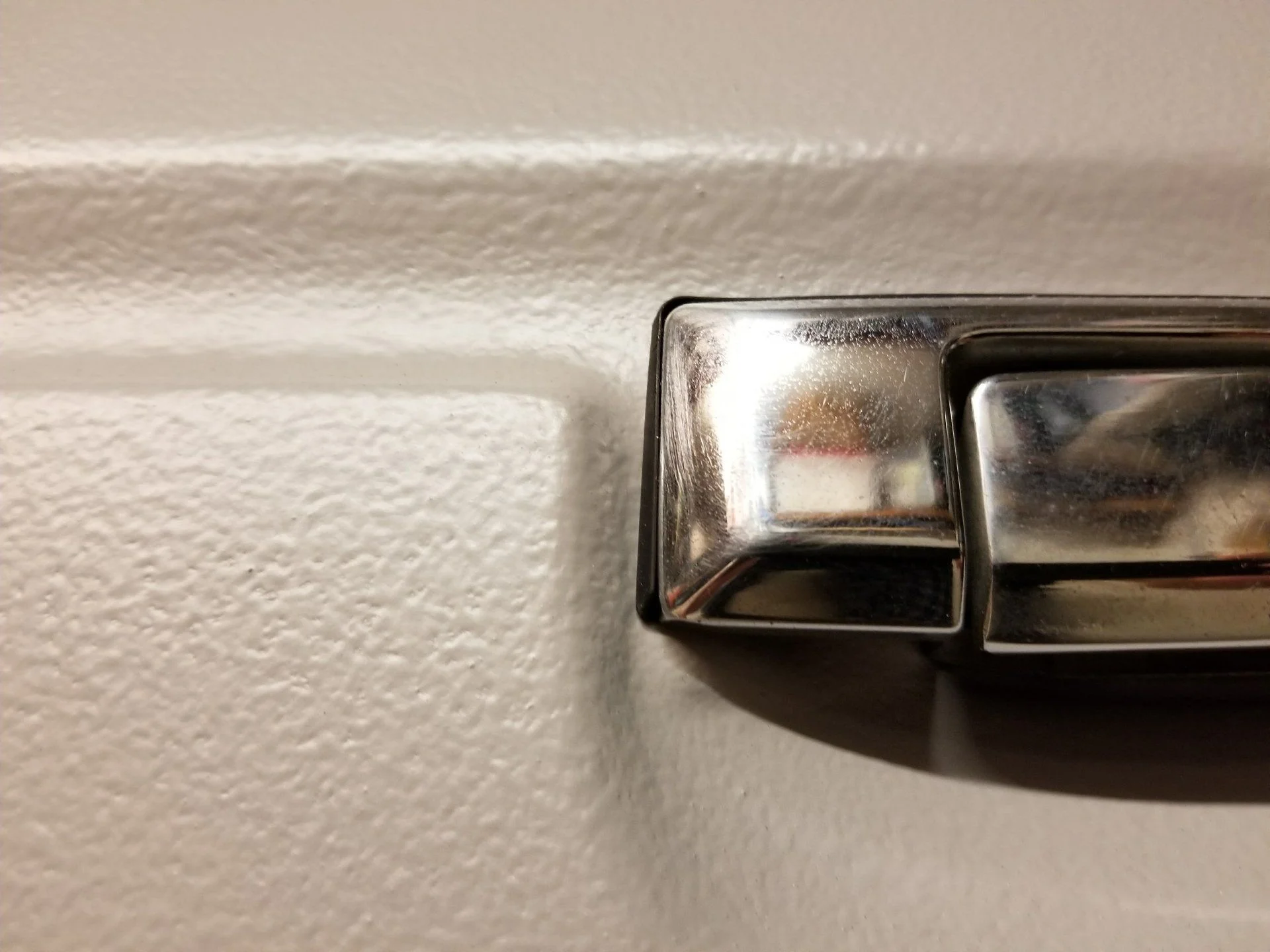

I reduced it with acetone since I don't think MEK is available in CA. About 8oz per gallon of monstaliner. Here are a couple more pics with a penny for scale:
Thanks, long project of rust repair and I was really looking for a finish that accomplished a few things:
1. I did not want to spray. I do not have a good workspace to do that and after brush / rolling everything I feel like it is better sealed than when I had sprayed parts.
2. I wanted a finish that at best could be hosed off. I painted it "nice" 15 years ago and never waxed or really washed it, it's a tool and I use it.
3. I did not want it to look too rough. In hindsight I wish I had experimented more but it is tough with the pot life. I did the roof with the monstaliner rollers so it has more texture and then moved to the small foam rollers for the rest. The larger areas like the hood would be easier with a smooth foam 9" roller.

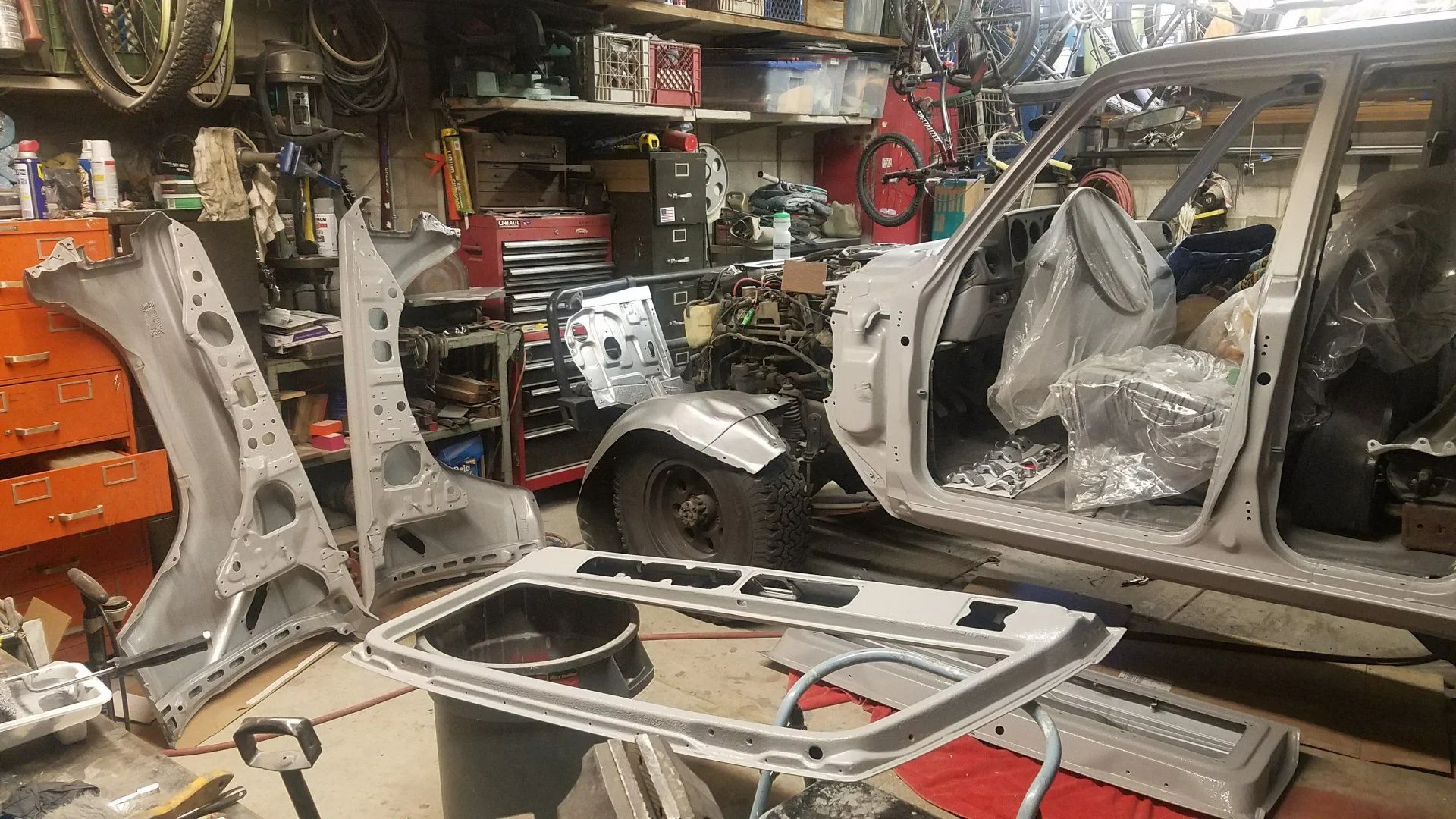

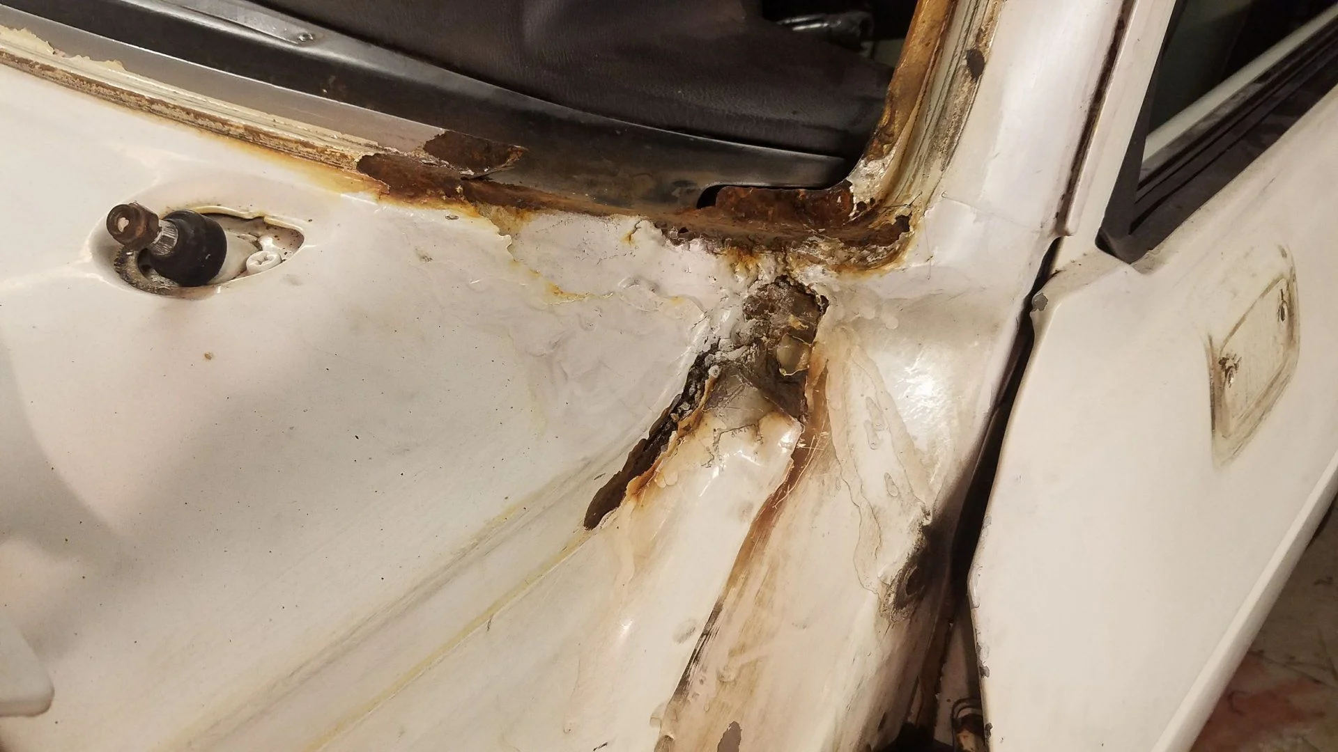

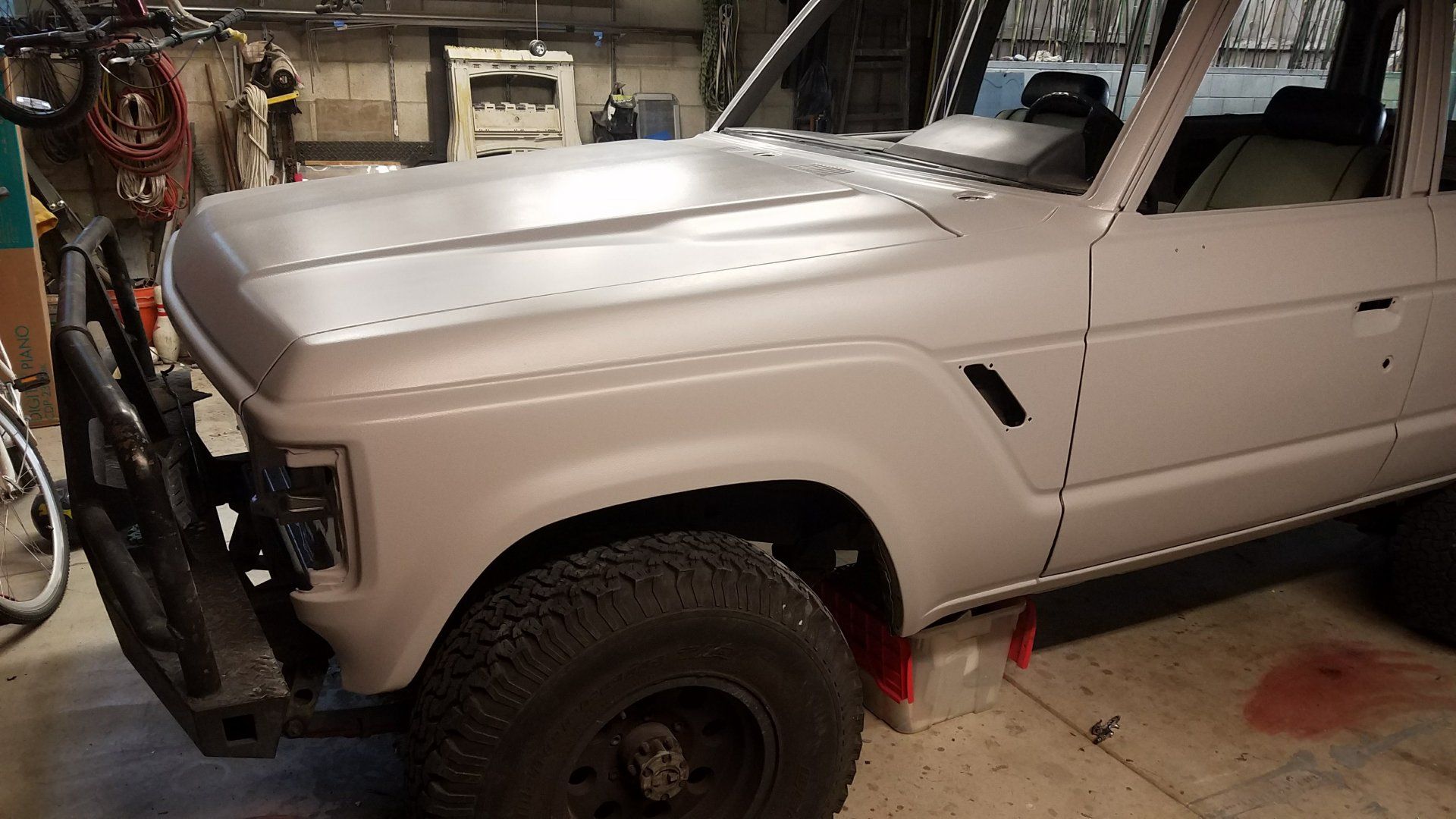

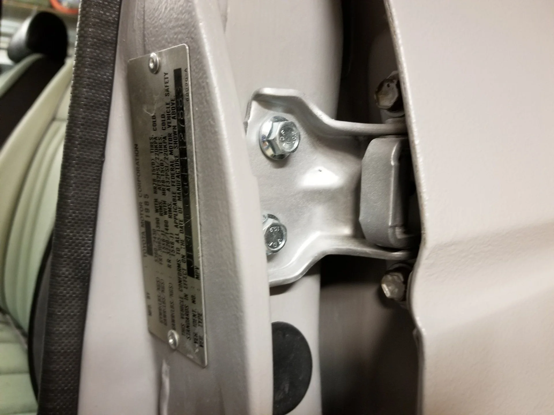

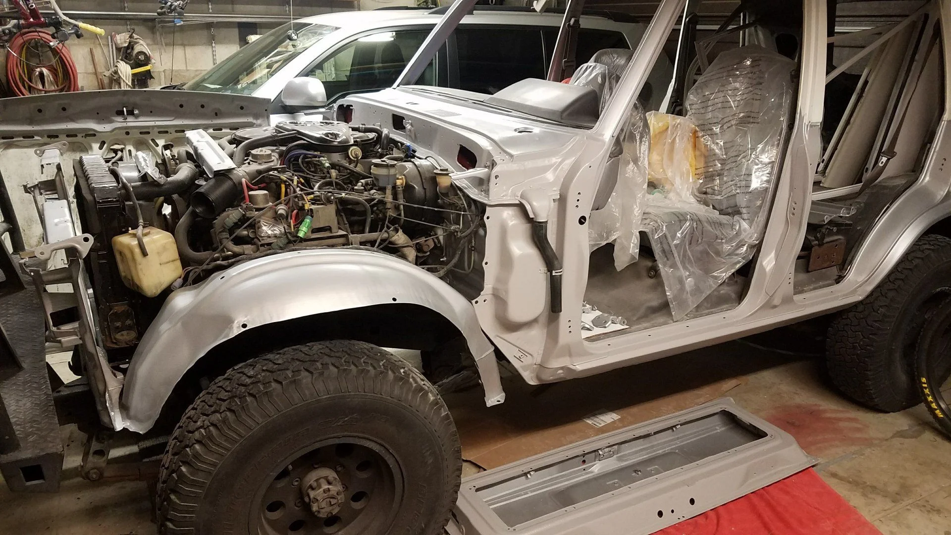

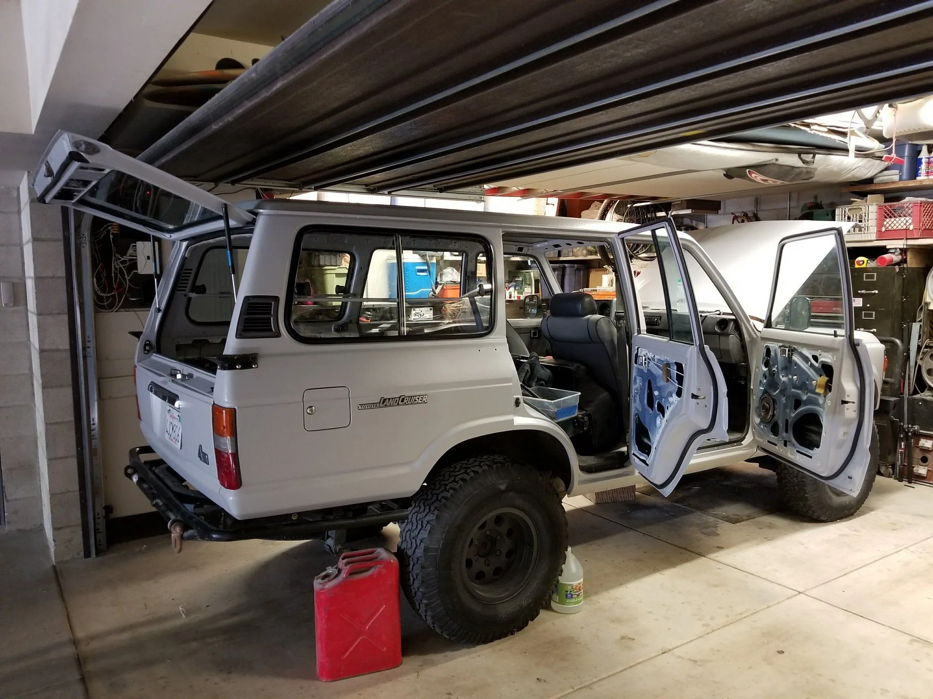

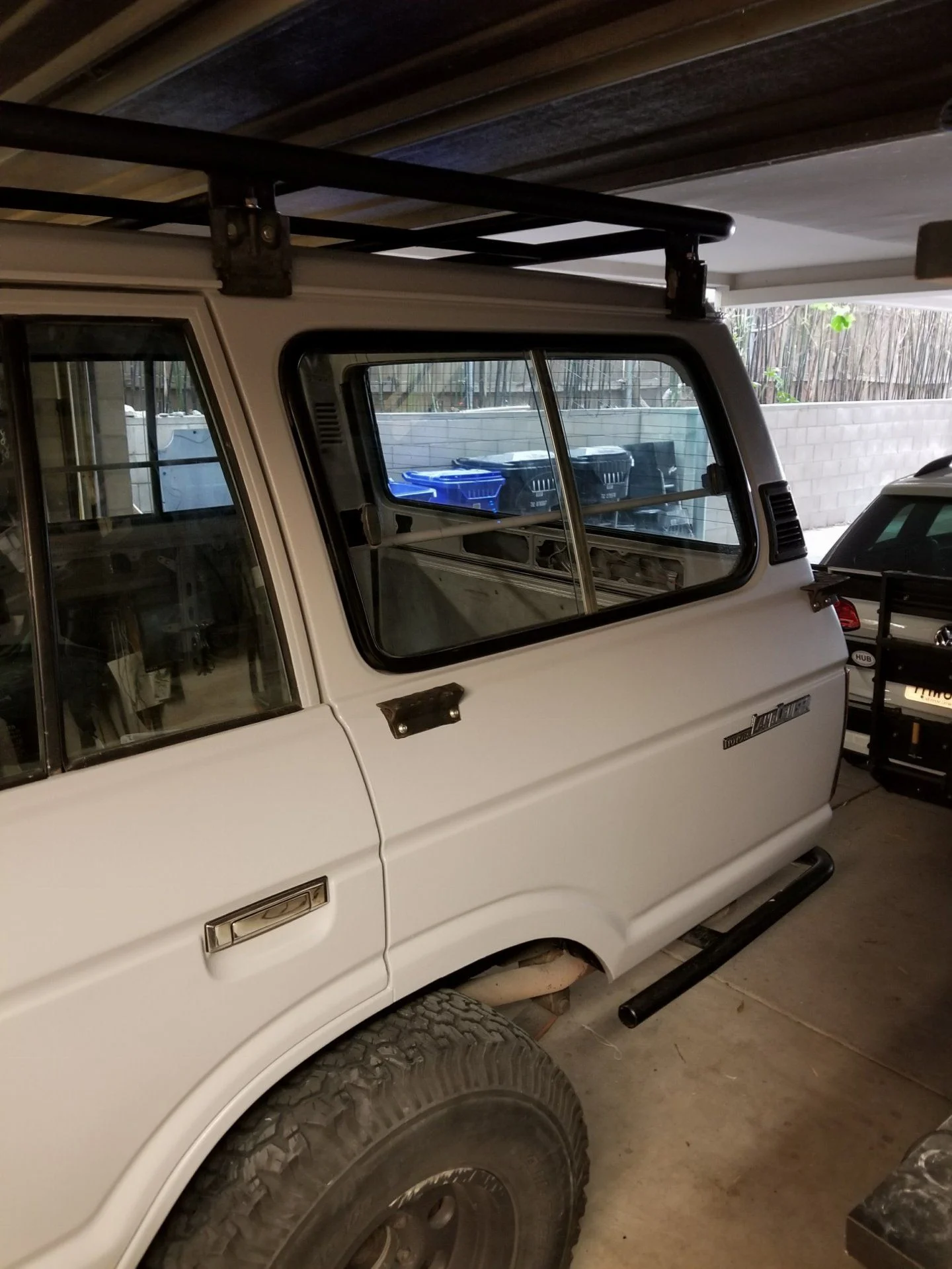

Thanks, It passed the 25mph and 20 ft test. I have had this truck since 98 and had repainted it once shortly after I got it. Years of trips, surfboards, kayaks, and not much love the body had some pretty bad rough spots. I started with the roof repairs and somehow ended up unbolting just about everything plus some to get at the cancer. Due to working in a tight space I primed everything with chassis saver and then went at it with the monstaliner, first the interior, then the jambs and inside of the doors / hatches, and last the exterior. Longer project than I planned on but plan on getting at least another decade out of it.

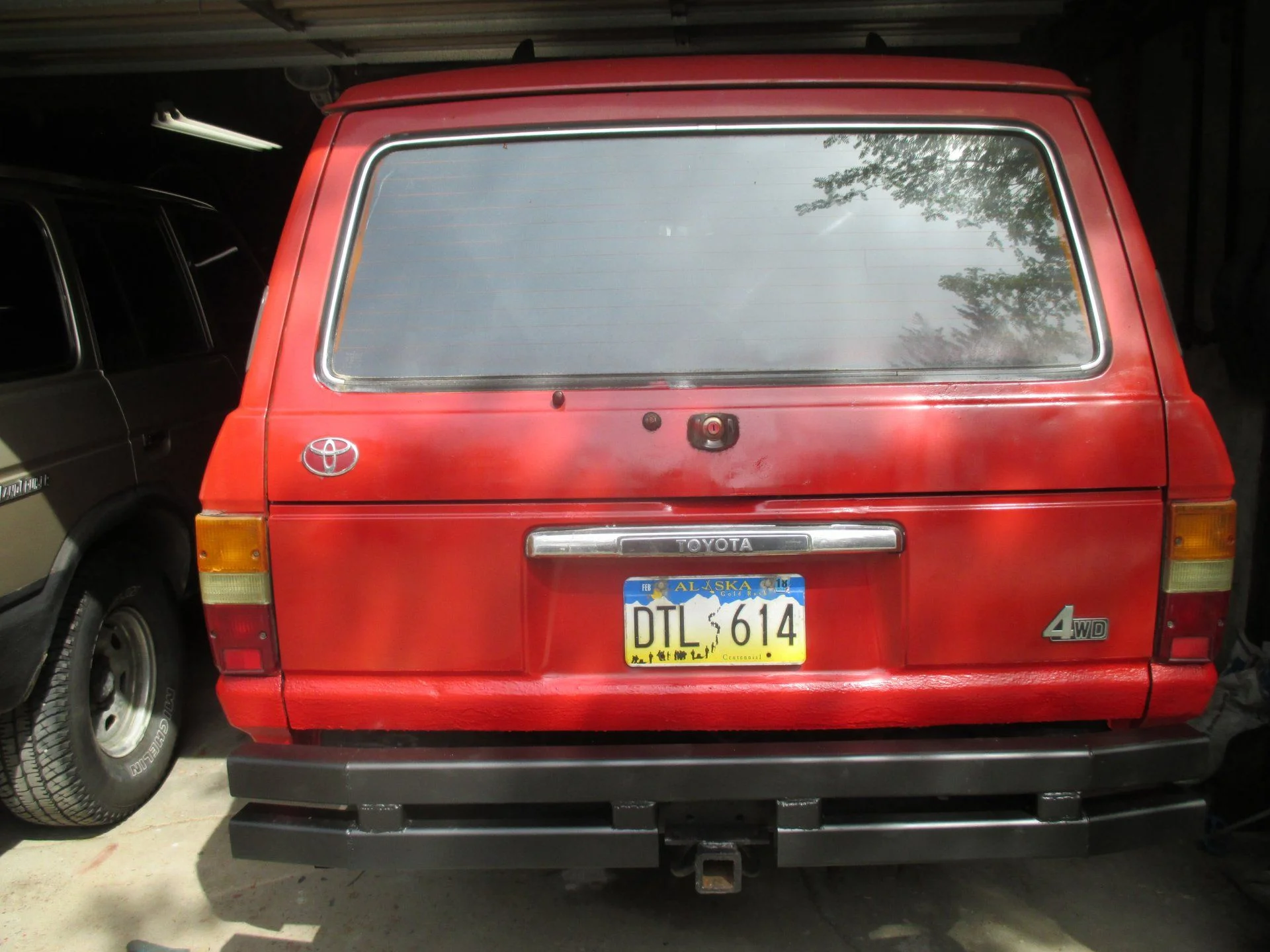

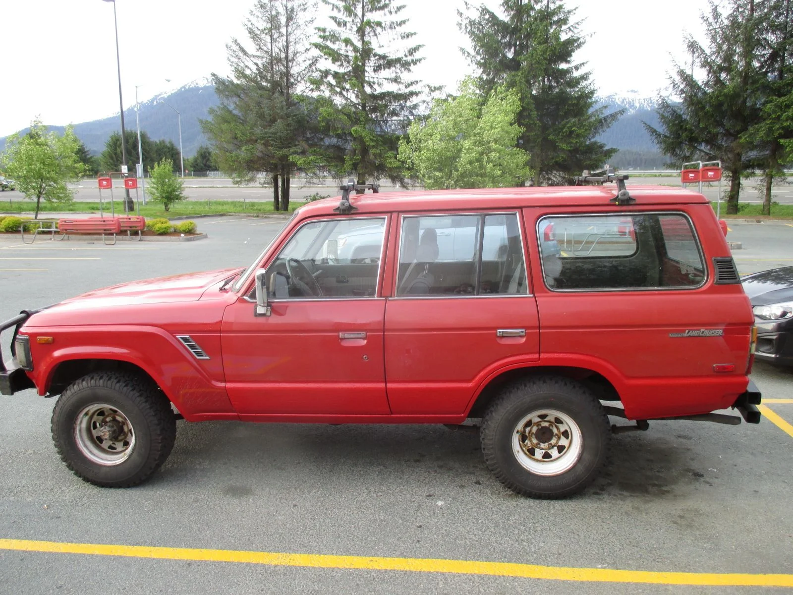

Monstalined with lady in red over the previously black bed liner along the bottom of my rig. So, this is what it looks like next to faded freeborn red. Note that the recently replaced fender is newly painted with a knock off freeborn red color, so there are three shades going on here. I plan to paint over the fainted doors and rear quarter with newer paint too
monsta line is below tail lights. I did paint above it with the newer freeborn red color spray can. For some reason it looks like a better match in this exposure.
