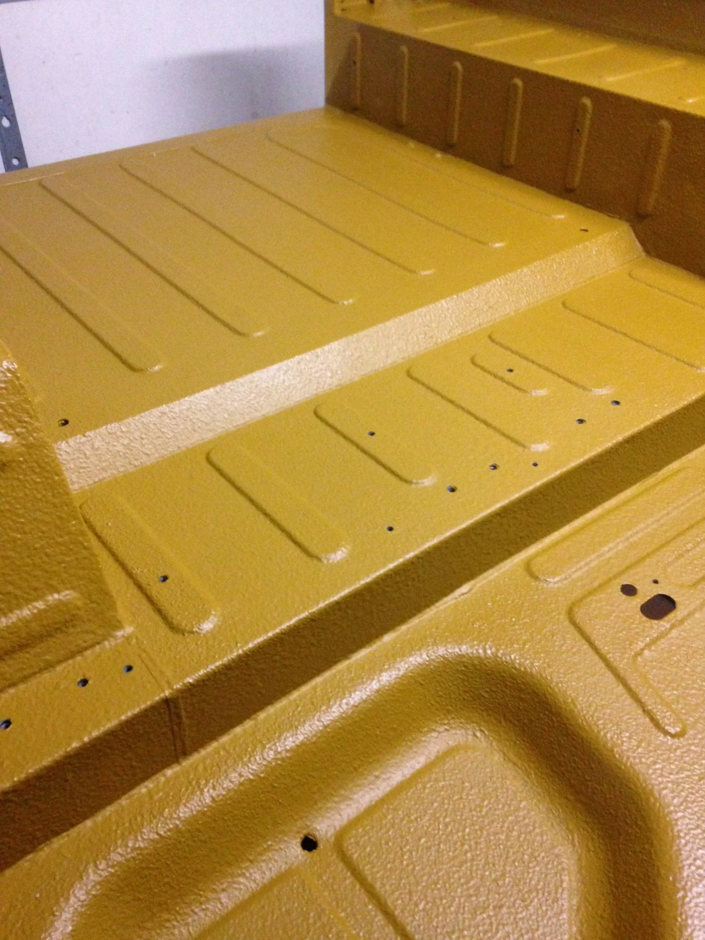

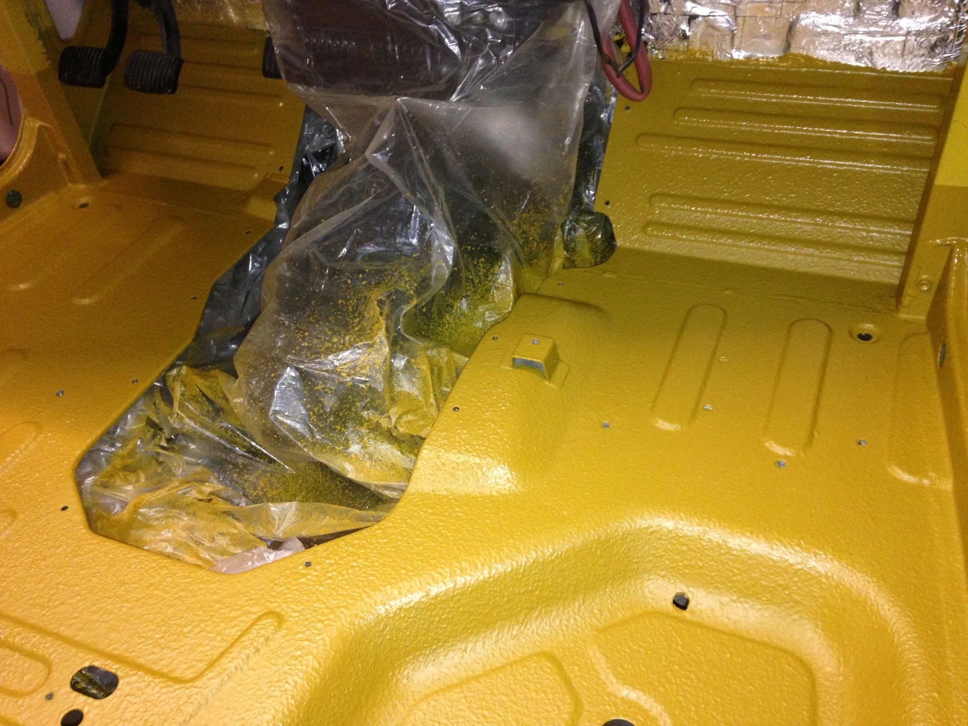

Used a shutz gun on my interior, color matched to Toyota 532 yellow with PPG toner. Definitely took two coats for full coverage over gray epoxy. Lots of masking off, but seemed easier than rollering...and since I already had the gun...Pretty happy with it :clap:
@1Fine40 That looks awesome!
What did you put in the bolt holes to keep them clean?
I rolled up some tin foil into a small bullet and pushed it in there, cheap and simple!
Good Job!
Thanks! Am pretty happy with how it has turned out. I ended up with one or two thin spots where I didn't get good
coverage, but that is on me, the painter, not the product. Bought an additional quart to go back and fix those minor
misses. I could have left them as is, but since I'm this far into it figured to just make it 100% now.:meh:
Yes I sprayed it with the Walcom Adjustable Tip Shutz Gun at 70-75psi.
Hi do you have any more pictures of your monstaliner up close. The texture you achieved is very intriguing. You mentioned that you sprayed with the nicer gun at 70-75psi. Did you also reduce it with MEK or anything. I am hoping to gain some clarity on how you were able to achieve the texture you wanted.
Thanks!

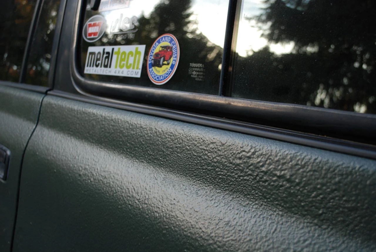

@magnetman : The three images I'm aware of - of the Monstaliner coating you had mixed in-house for this person, called "Toyota Army Green" :

Yep, that's the one! That looks to be darker than the FJ color while still giving off a military flavor. Love that color!
And it looks to be pretty close to the FS595 34066 color, at least on my monitor. REALLY looking forward to seeing the new colors, I've been waiting to pull the trigger on monstalining my rig for a while now because I wanted a darker green, and now hopefully we'll be seeing it soon!
