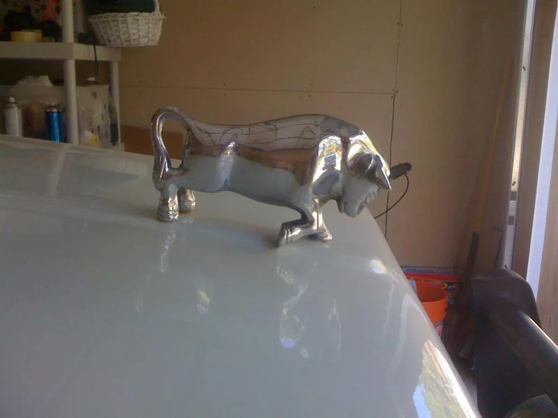

El Toro, named for its awesome hood ornament, started life as a Bolivian-spec 1978 FJ40.

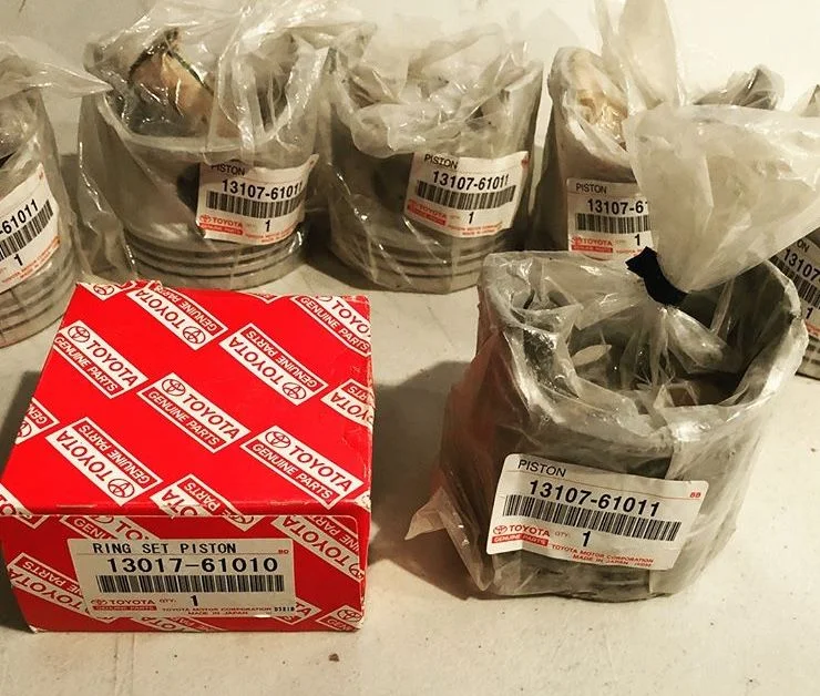

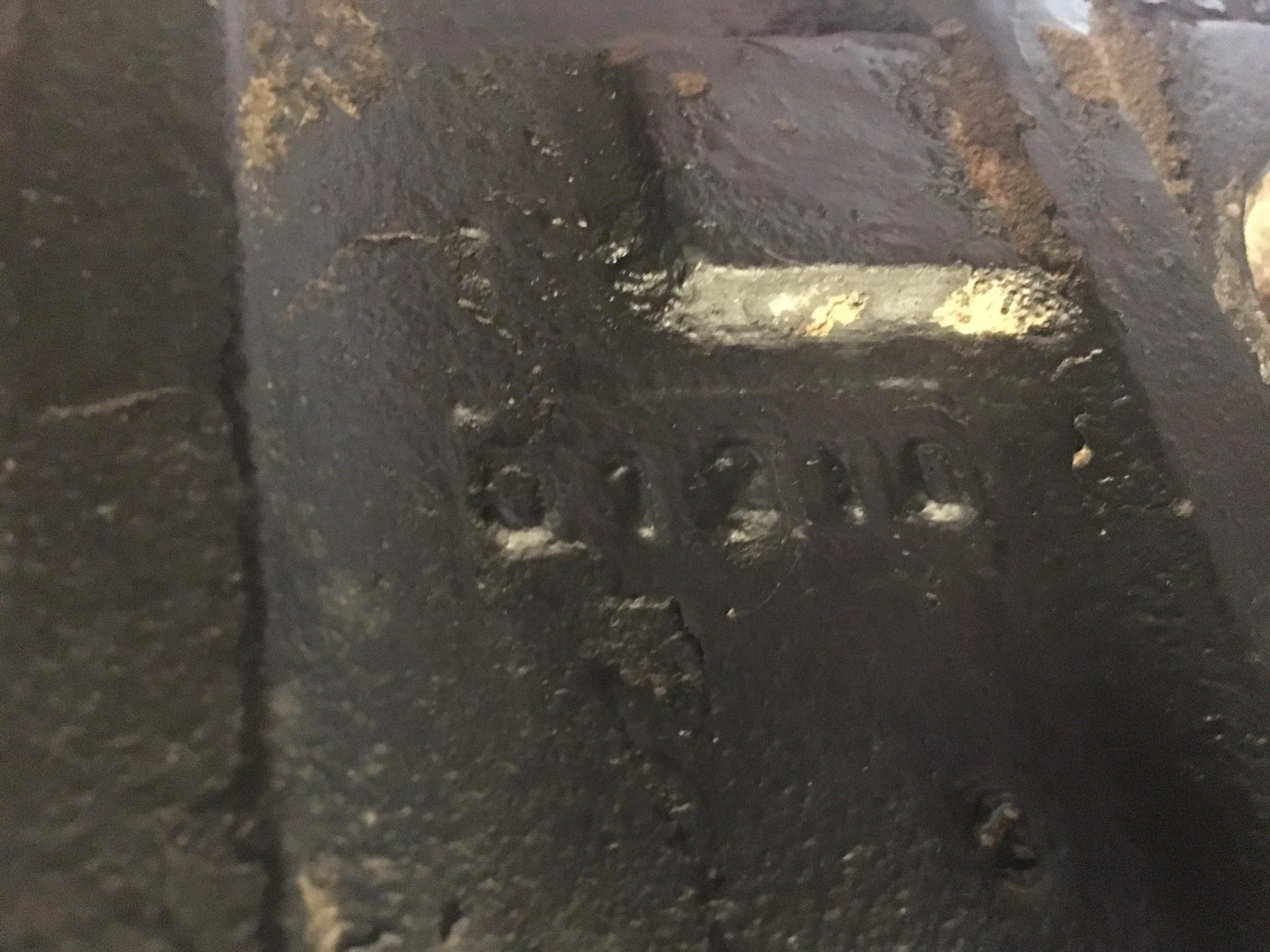

He sent me pictures of the casting numbers, which according to a quick mud search, had a 75% chance of having domed pistons. Searching yielded mixed results, mostly just speculation. It did come out a 78 after all, so maybe more like 95% chance.
So, I went down to Jackson to pick it up after first ordering a set of the super fancy by-special-order-only massive domed pistons from Jim.
You can see El Toro in the background, looking more like BigFoot than its former self.

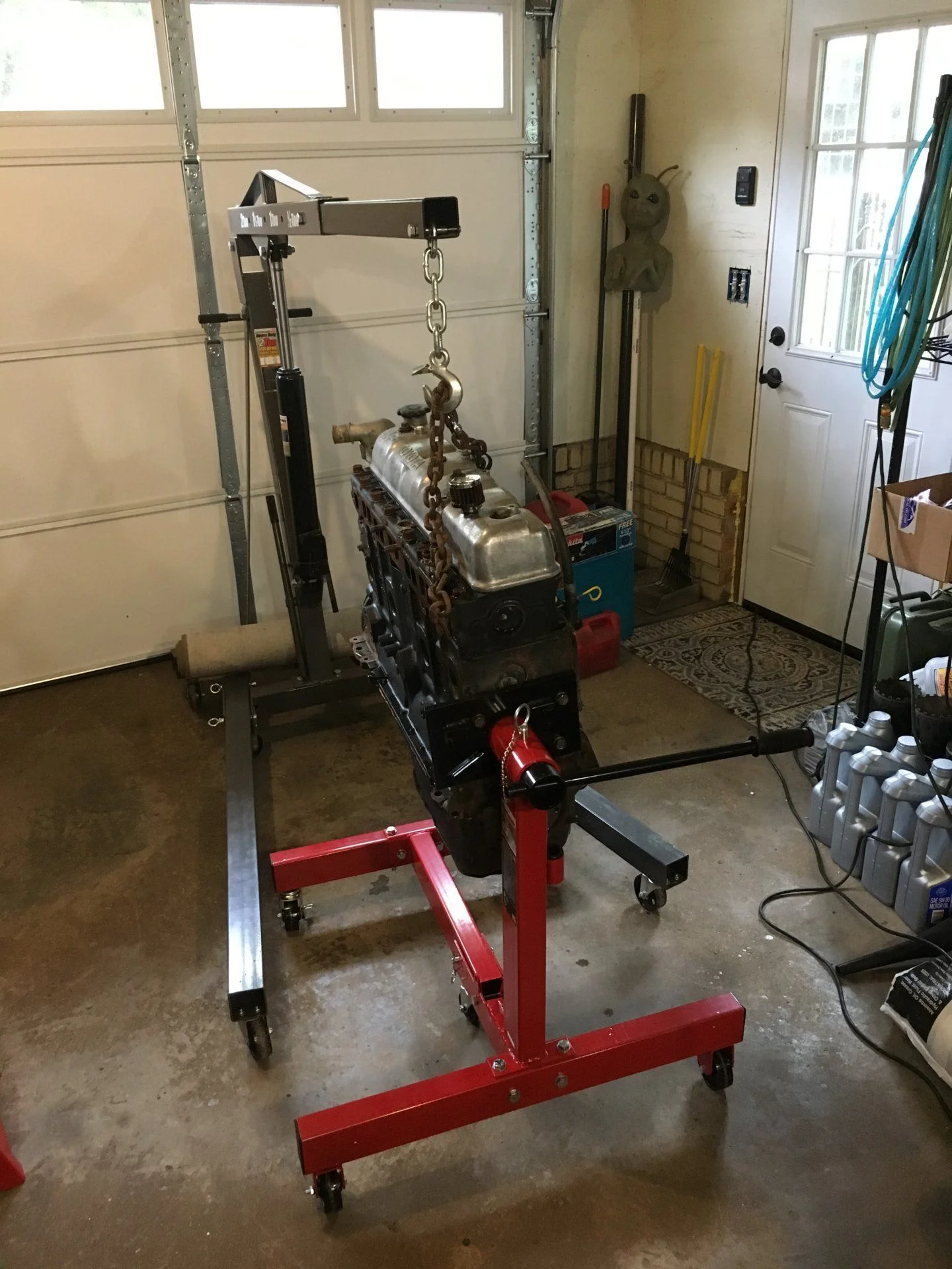

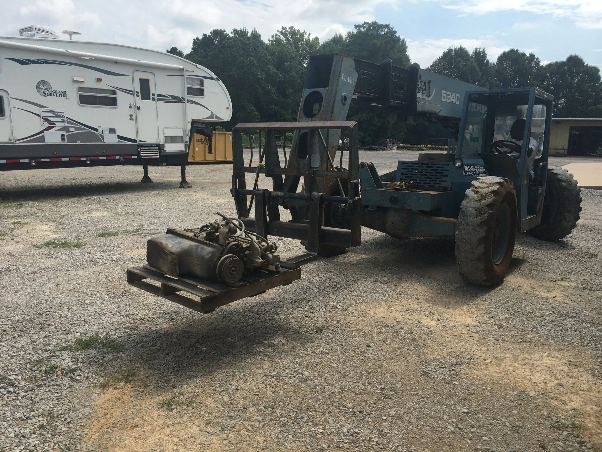

Back at MM World Headquarters, El Toro’s 2F was prepped for disassembly. Mascot #ETAF watches from the corner and bestows his(?) blessing on the project...

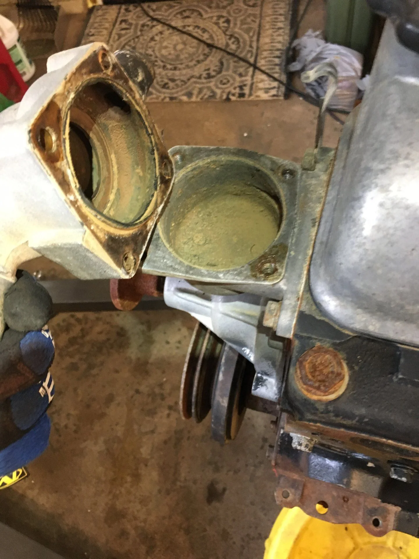

Dirt dobber nests? Check.
Third World Country evidence of muddy ditch water-for-cololant and no-thermostat operation? Check.

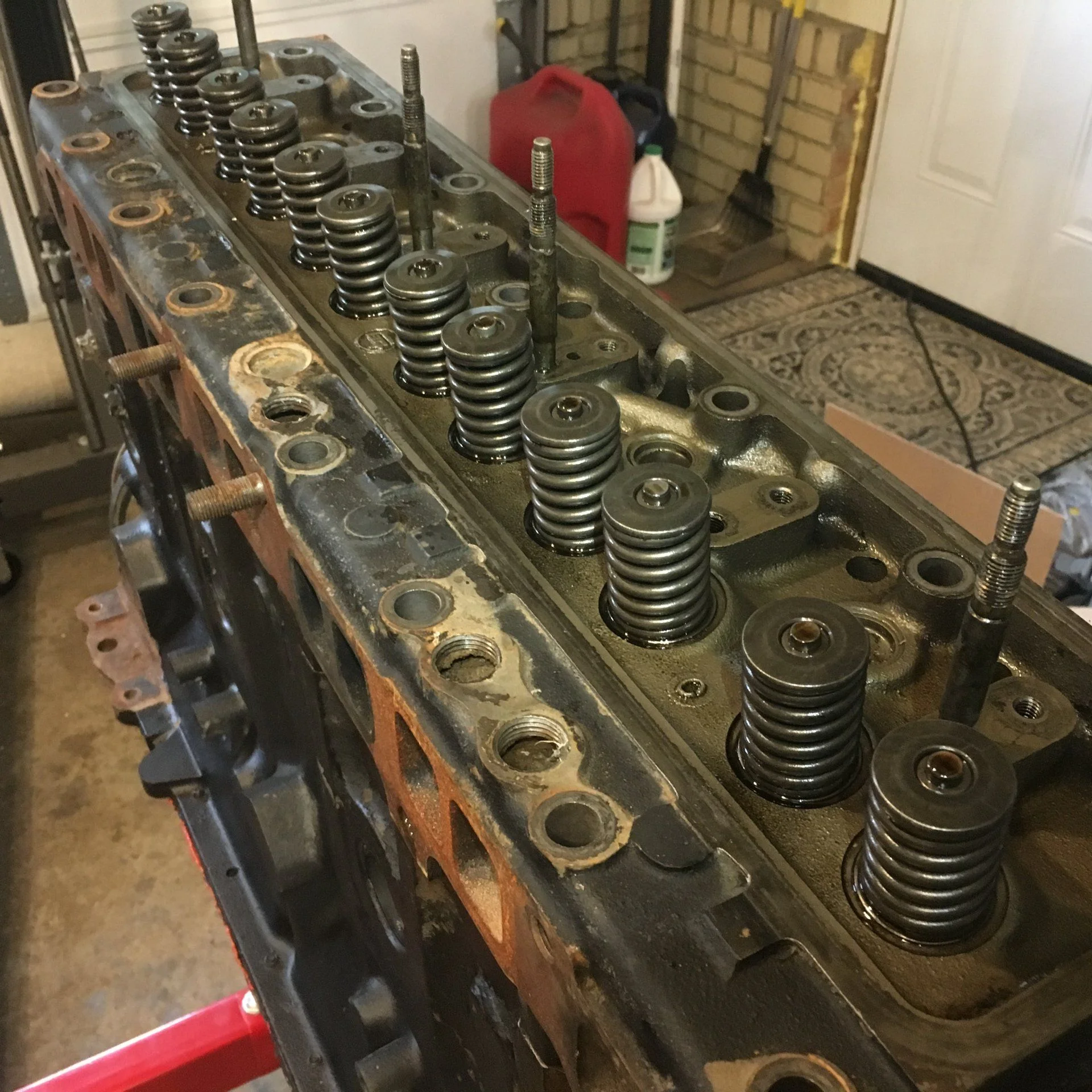

On the plus side, removing the valve cover revealed a nice clean topside with no signs of sludge.
Also note the lack of air rail ports on this non-US motor:

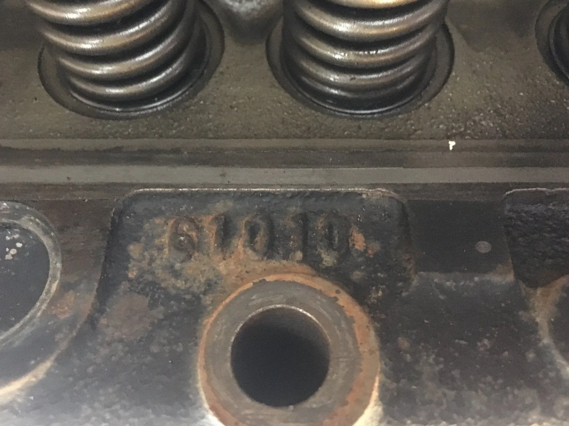

What is the casting date of the head and block?
The head has a “0” and “1215”. So, a December 1980, right?

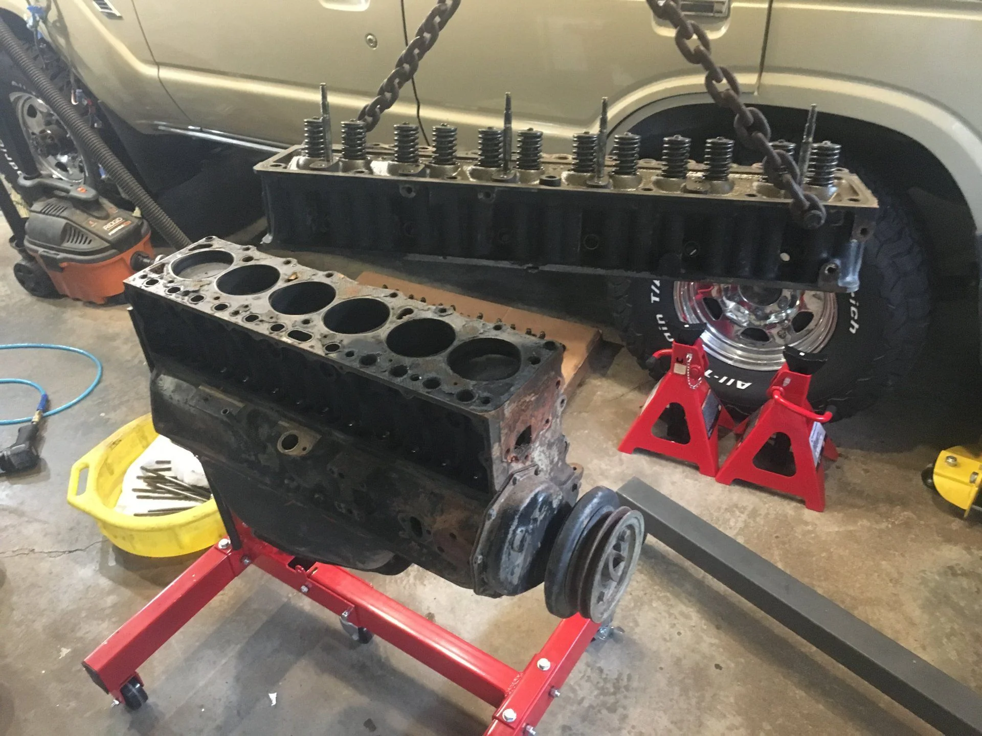

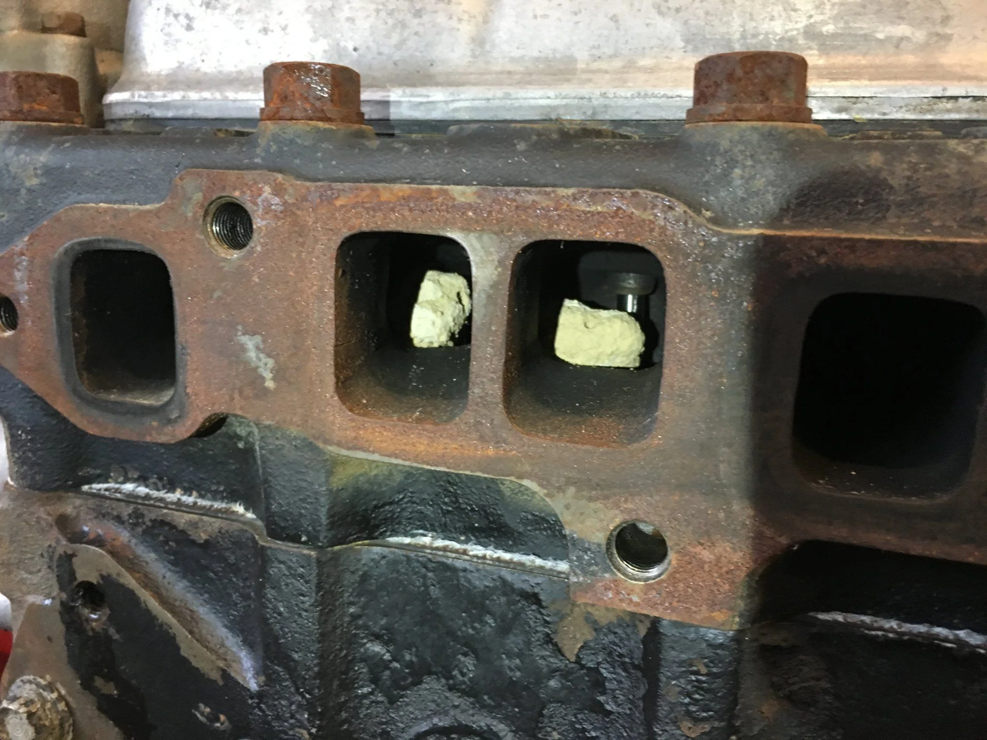

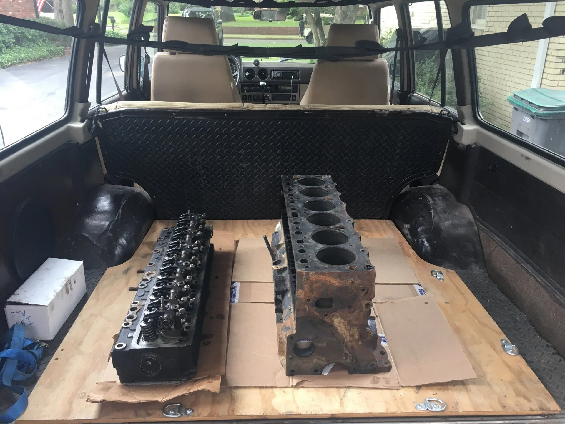

Which kinda ruins the surprise of what happened next, but I was sure surprised when I pulled the head and found flat pistons and a closed chamber head!

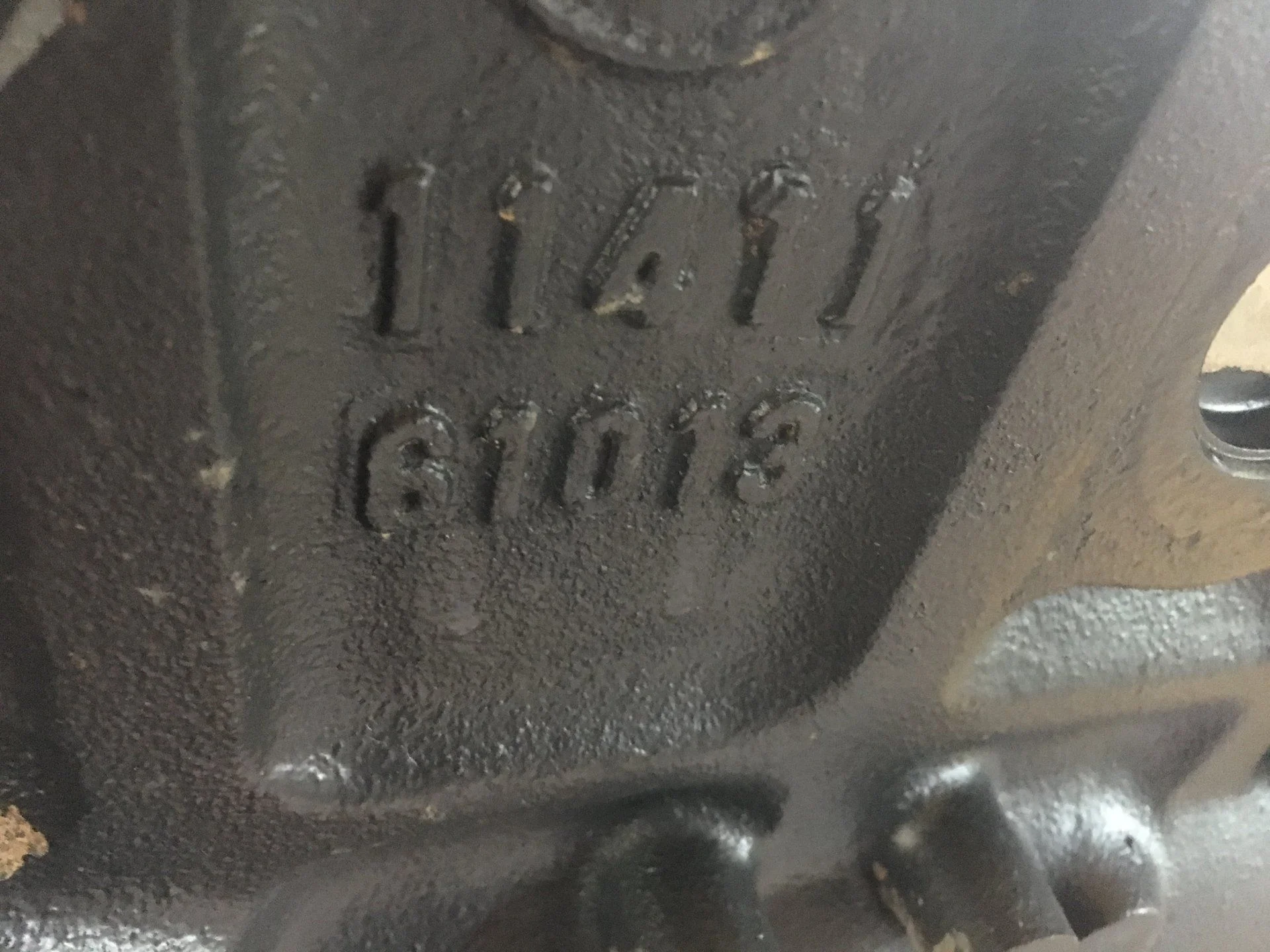

I found this in my pics. Looks like the block is a few days older.
It all makes perfect sense now. But not to me before I had it in my hands. It is definitely not original to the truck it came out of, since that is a ‘78.
For the archives: a 61013 block & 61010 head are flat piston & closed chamber.

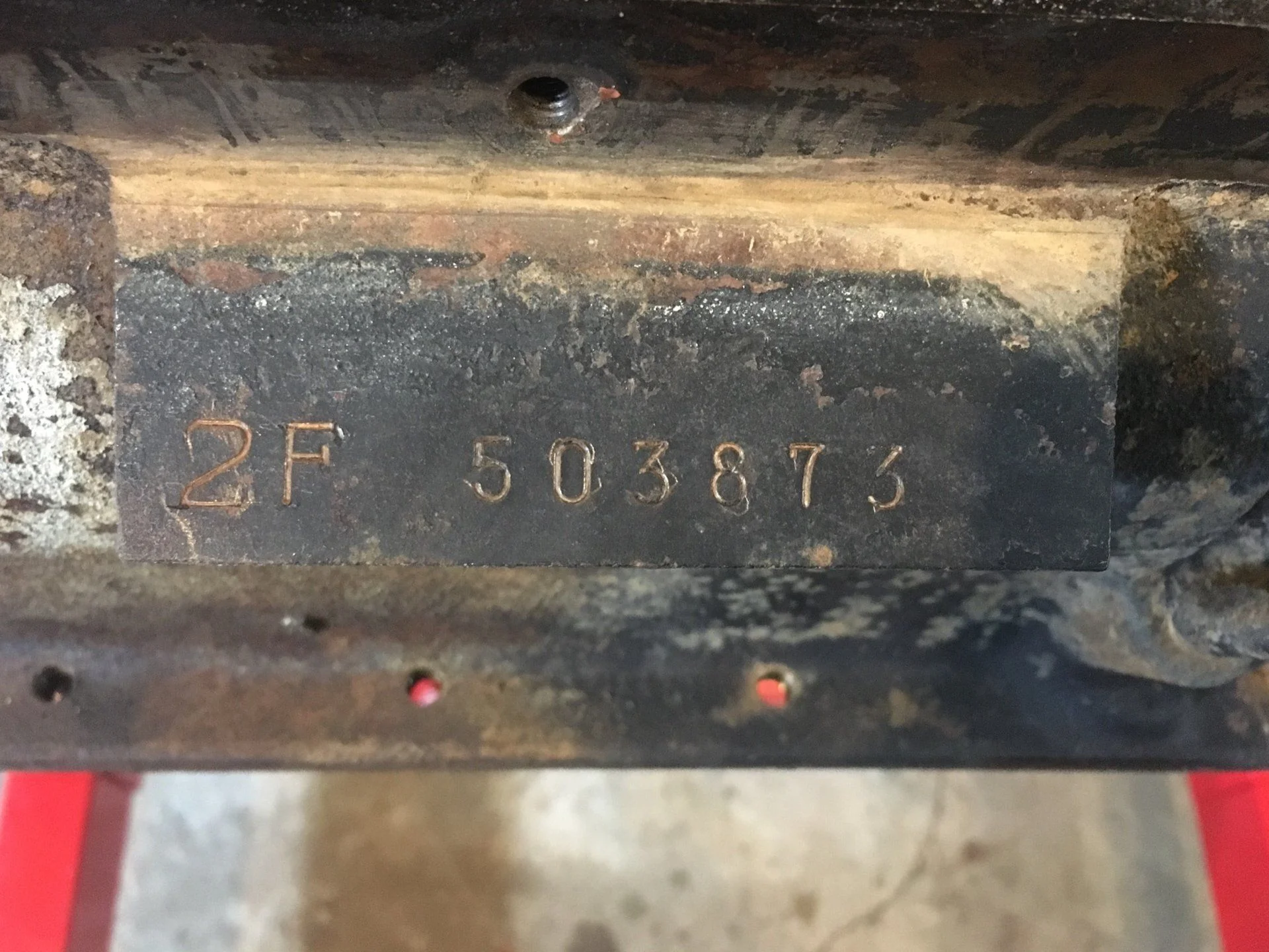

Serial number:

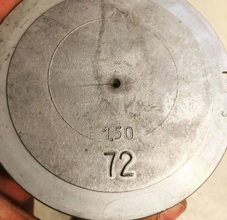

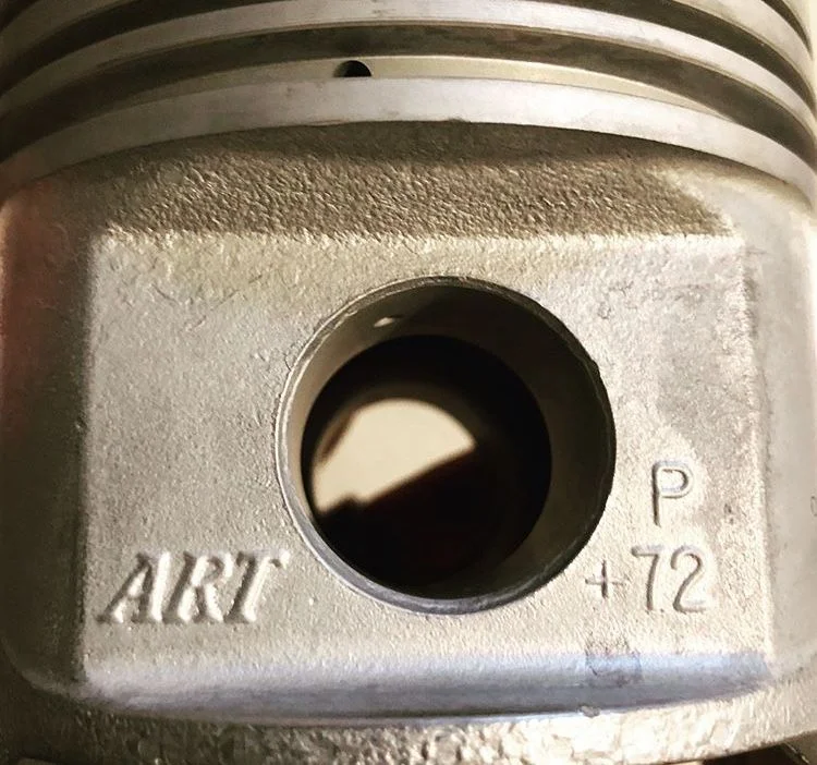

The bores looked pretty good, so it’s possible we could have maybe have just gone up one piston size, but where’s the fun in that?

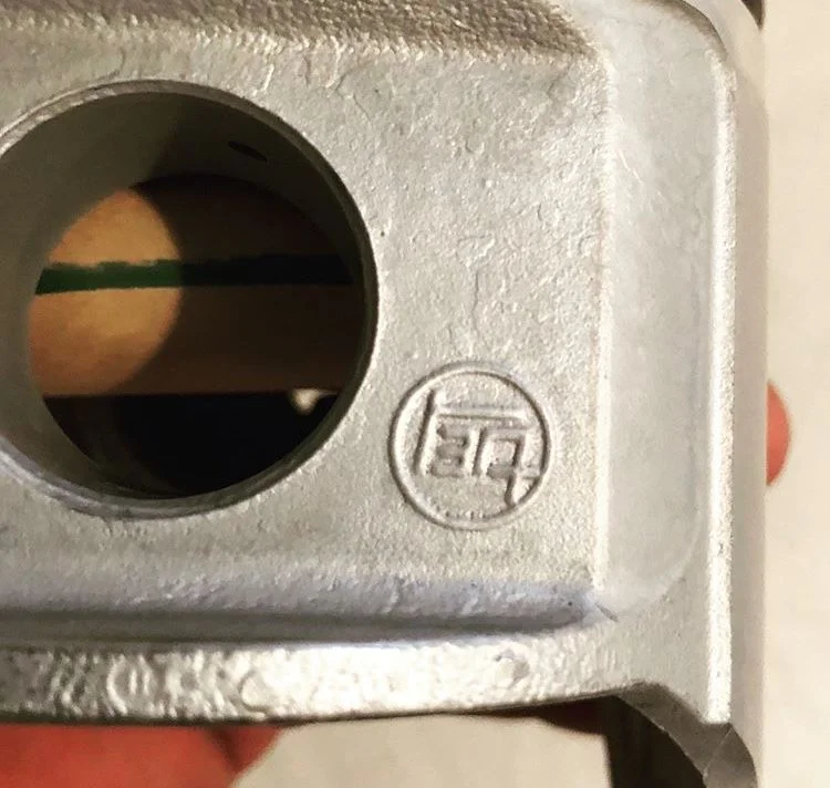

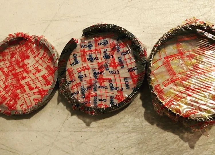

Just like in other areas of life, every mm counts, and this truck is named the Delta “Beast”, so we are going for the maximum 1.5mm oversized pistons, which will bump us up to 4.4L of displacement.
A call to @beno had a set of these beauties on the way from Mr. T...
Once they arrived, I gave them to the machine shop so they could confirm the new bore size.

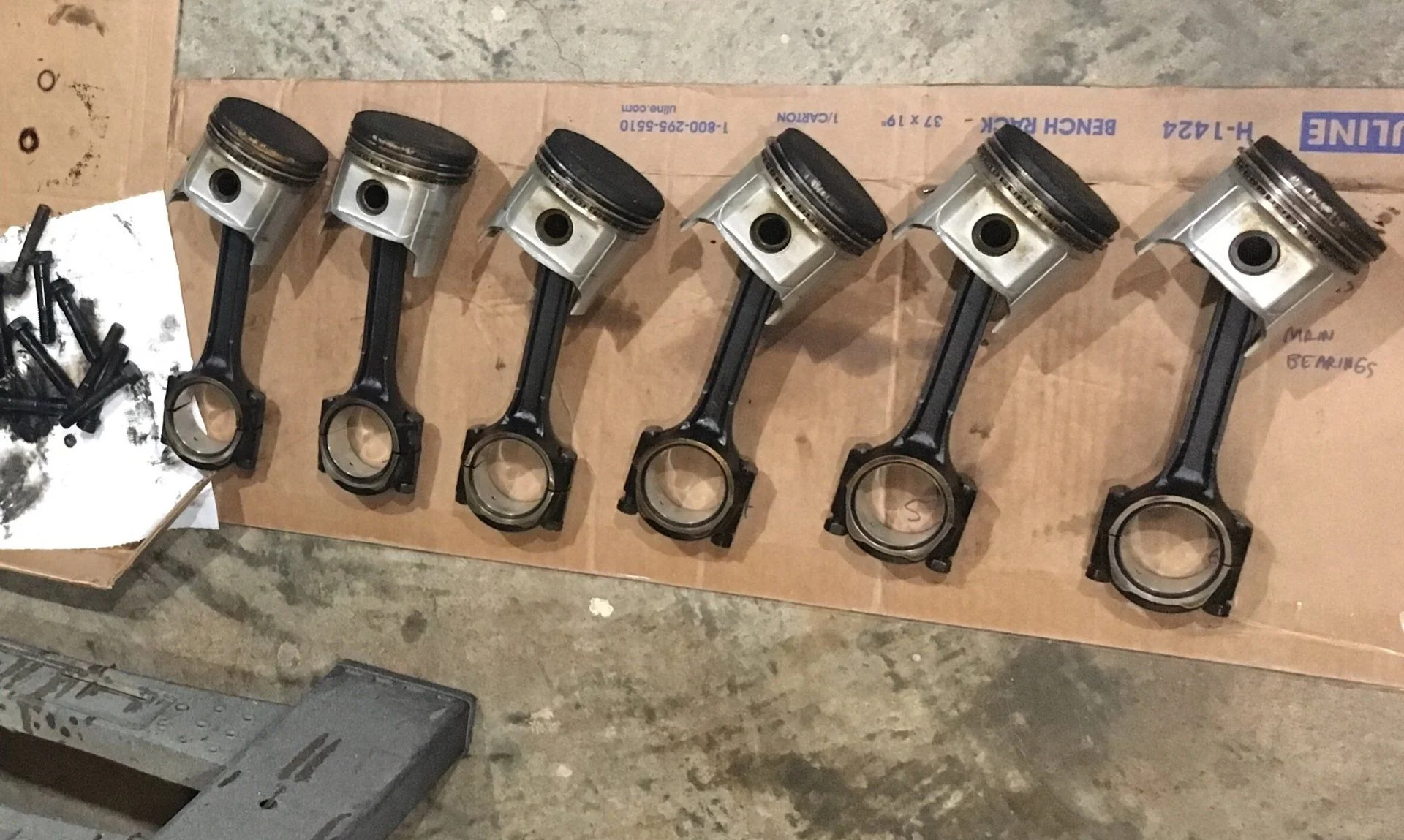

With the exception of two pushrods, I was able to re-use them. These are the same style as current issue, so I didn’t feel bad about just replacing the two.

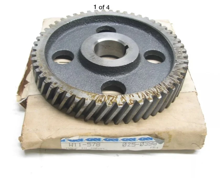

The camshaft timing gear was showing separation/deterioration of the rubber (dampening?) material.
I stumbled upon a new old Hecho en Japan all-metal gear on eBay, so I scooped that up...

Please save me some Carnage Award trophy parts. Gears always look cool.
Thanks!
I want to get my hands on an all-steel timing gear. Envious.
