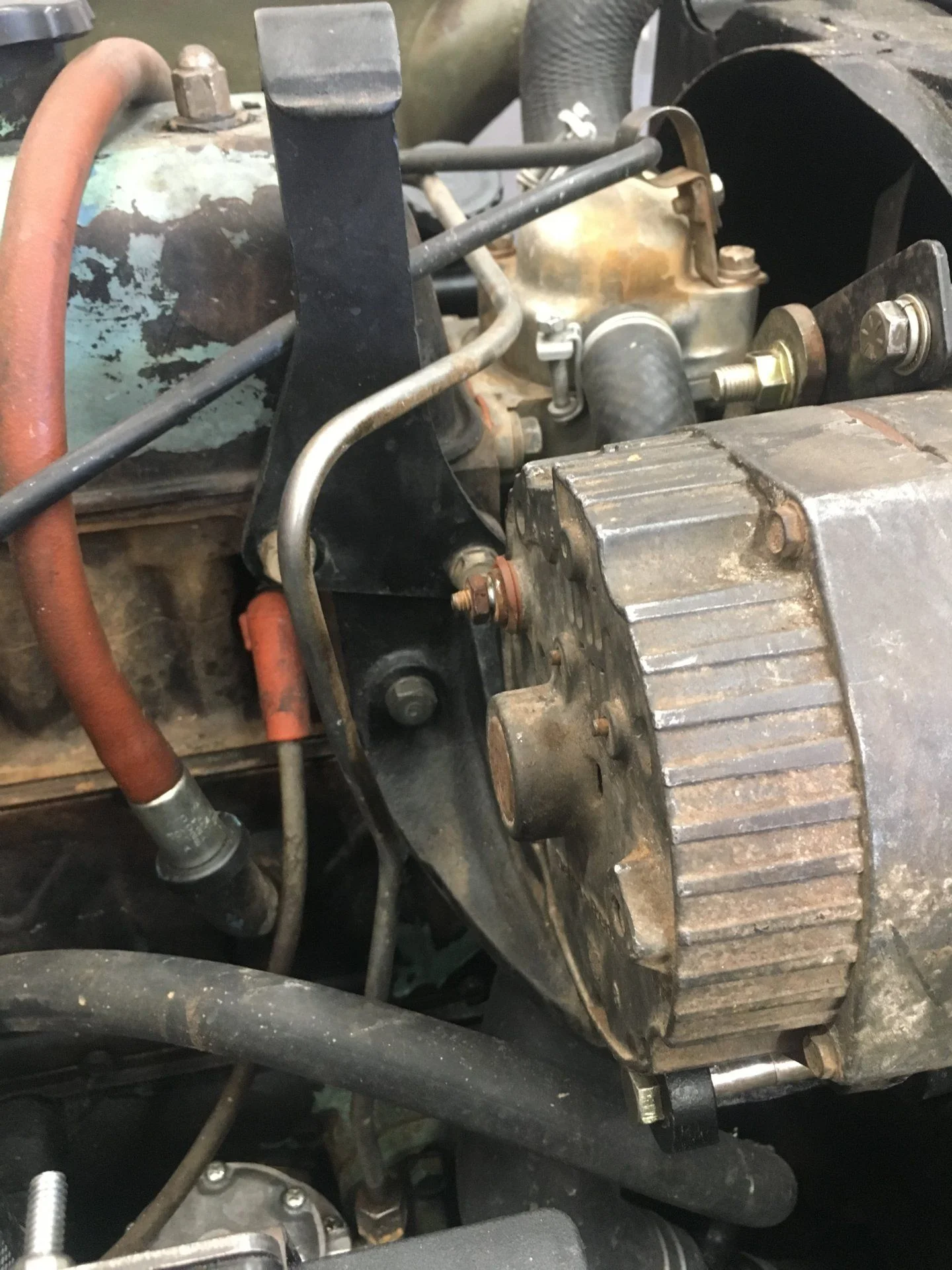

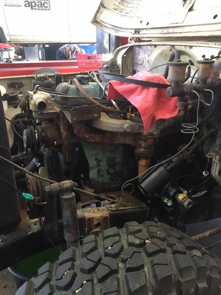

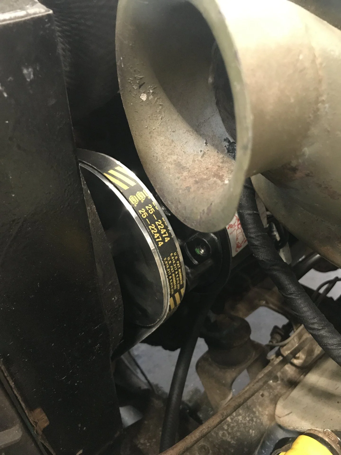

Easier said than done. Some owner at some time had broken 2/3 bolts for the alternator mount into the head off so they moved the alternator to the drivers side where the power steering pump goes.
I checked in on this today
Looking good @wct49
Alternator is back to the OEM spot

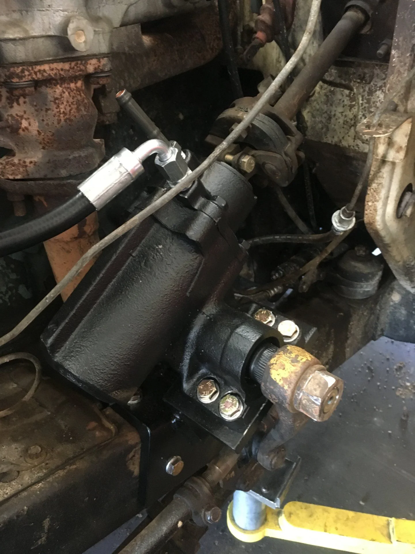

@orangefj45 PS kit going in.

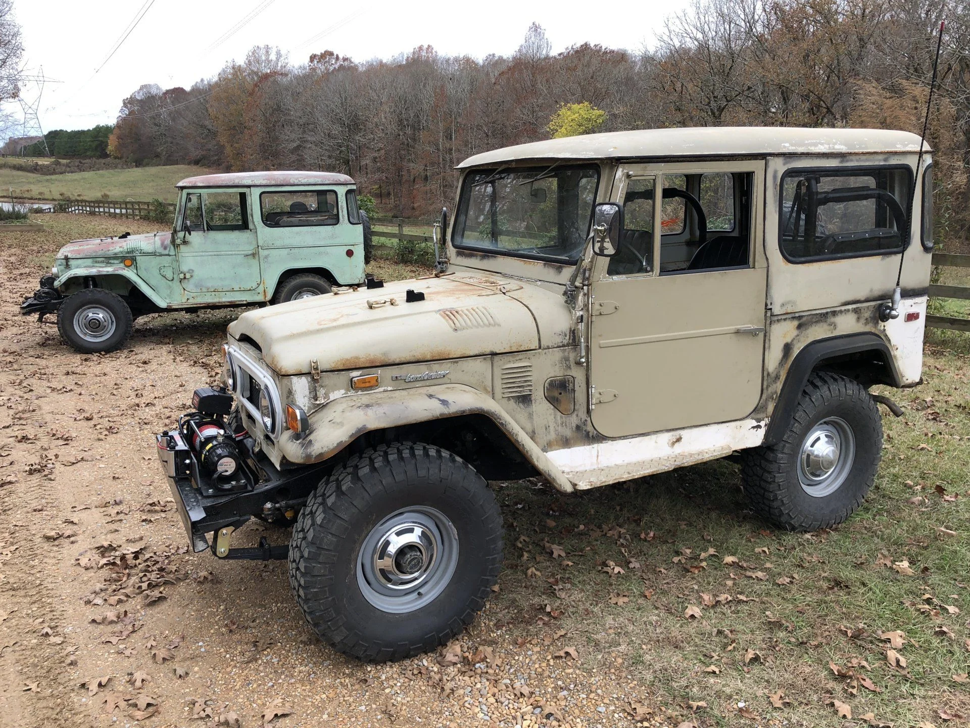

I think this round is almost finished. I saw new weather stripping and even rebuilt front door guts have happened.

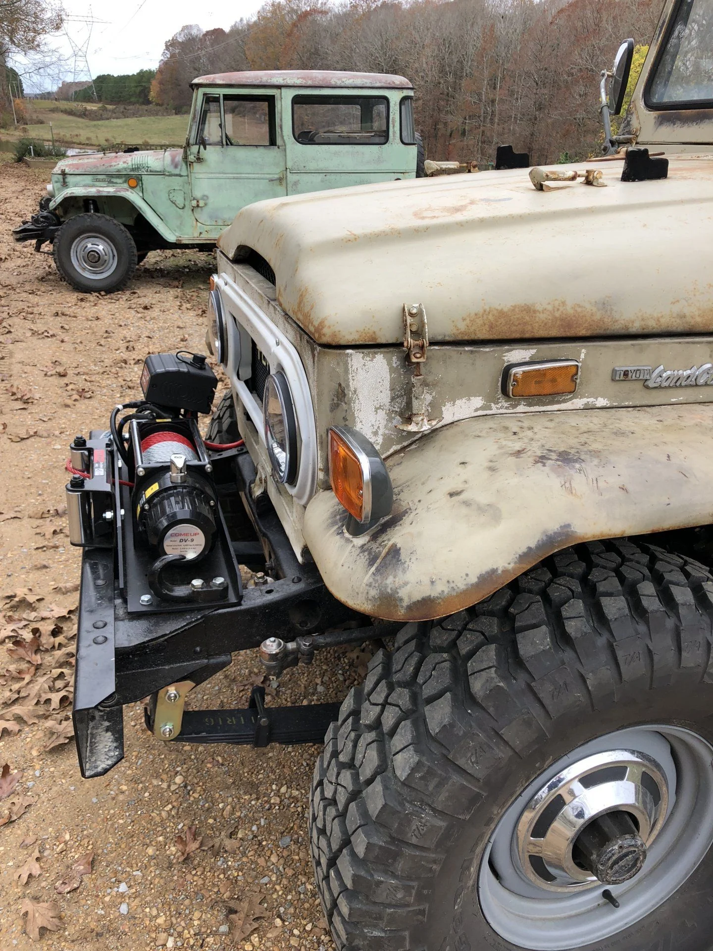

Lift and winch are on. Looking slick.

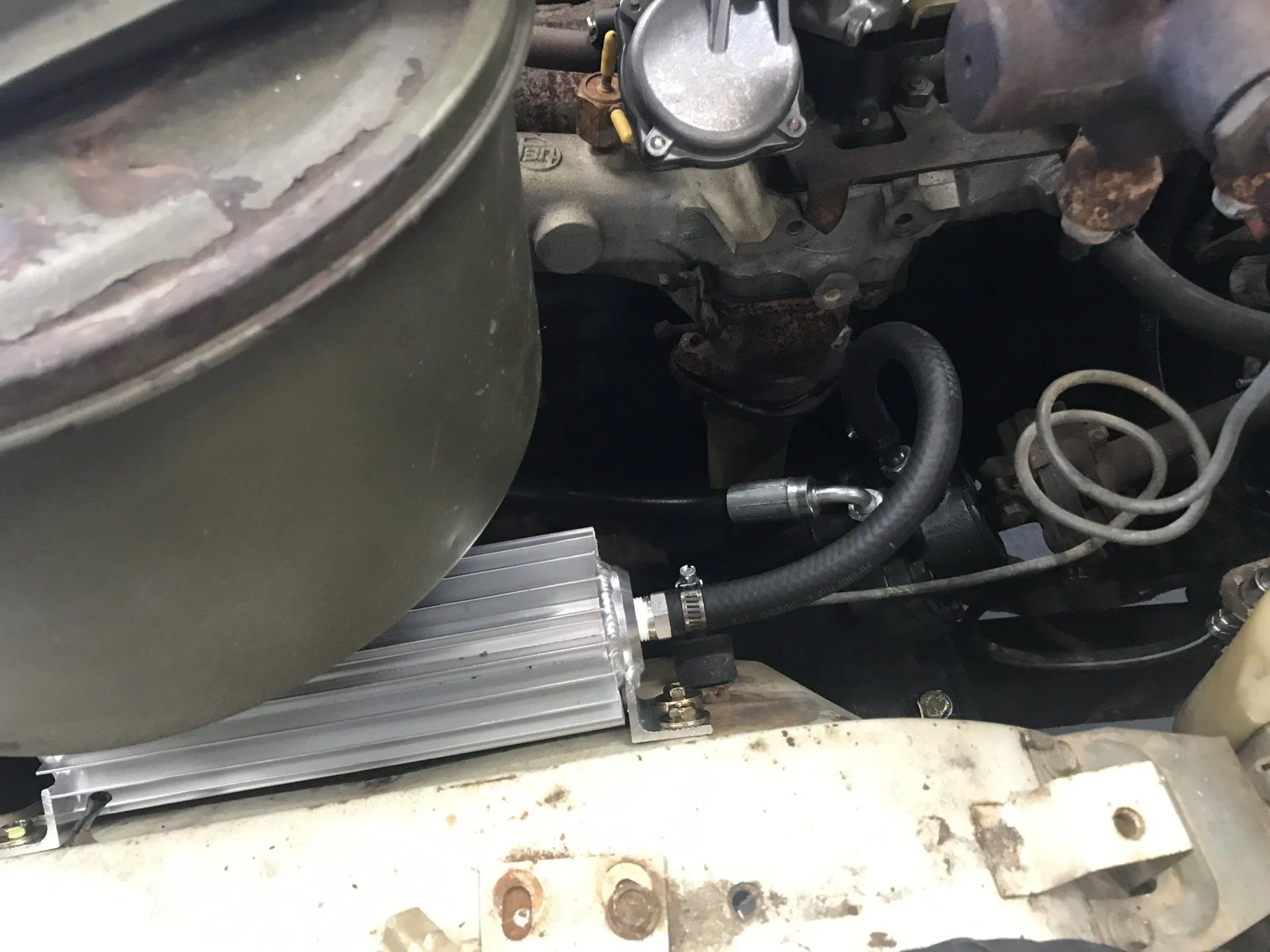

PS cooler

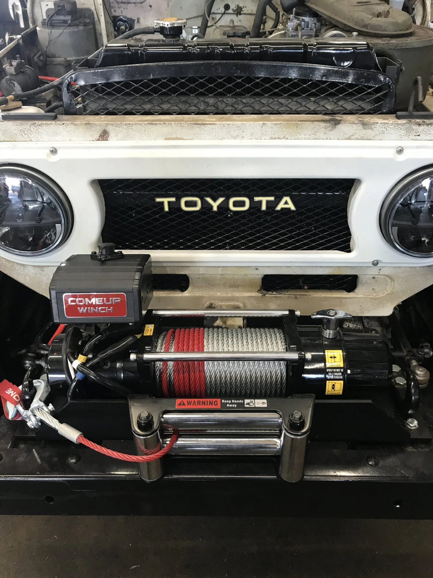

Come Up winch

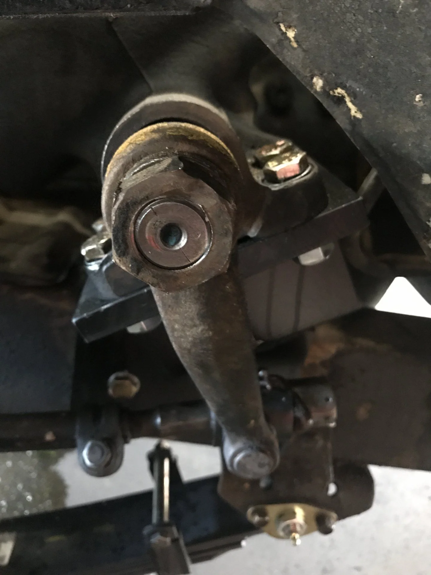

Rebuilt center arm
Mini Truck power steering box. These things are getting hard to find.

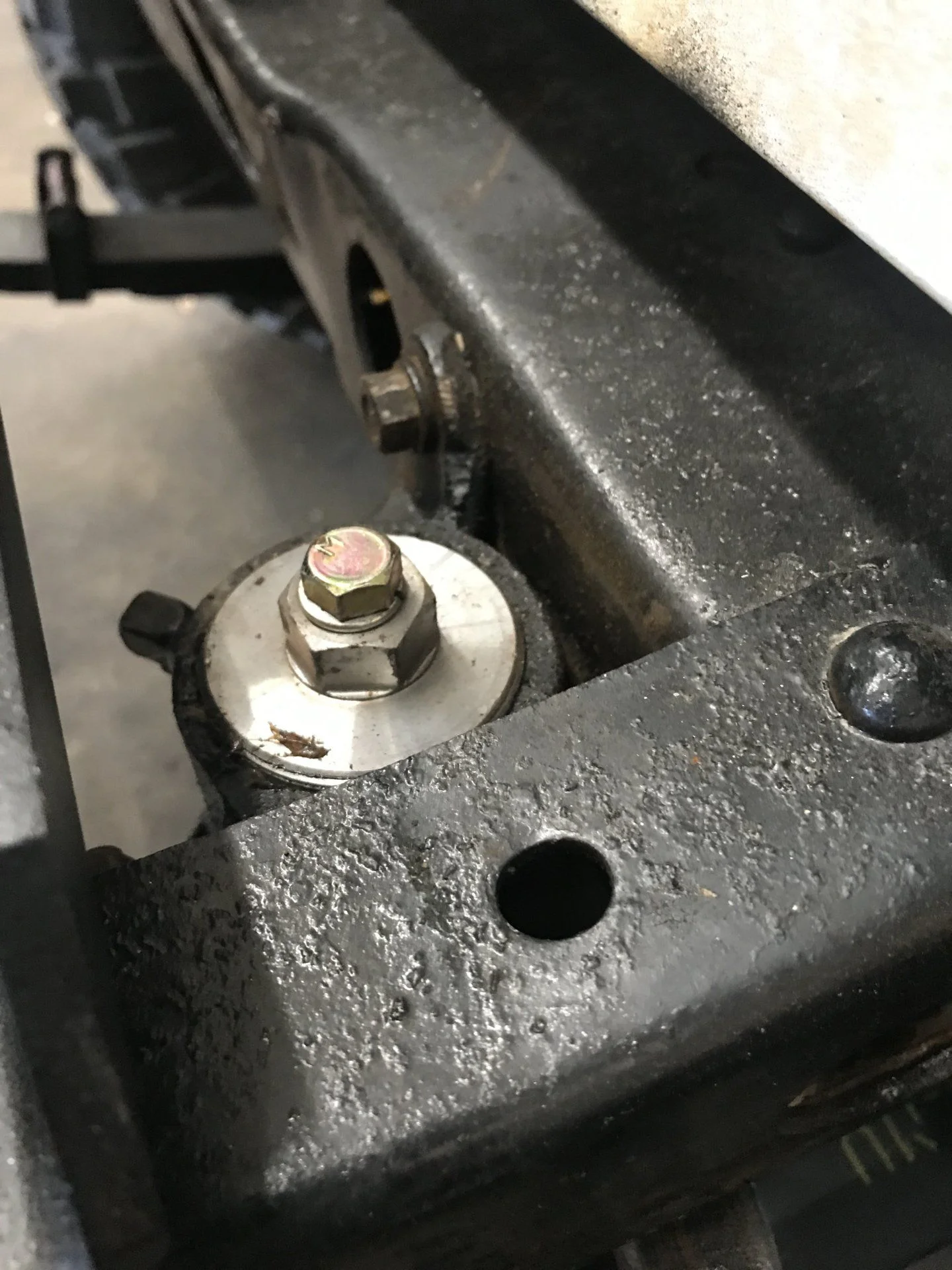

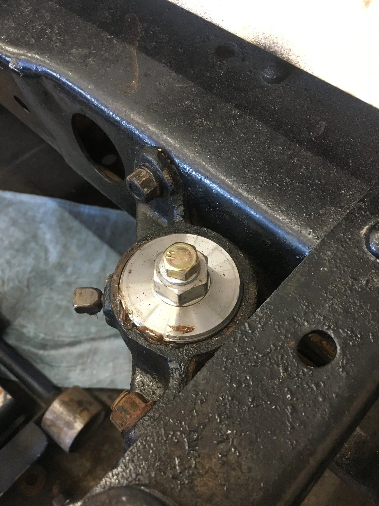

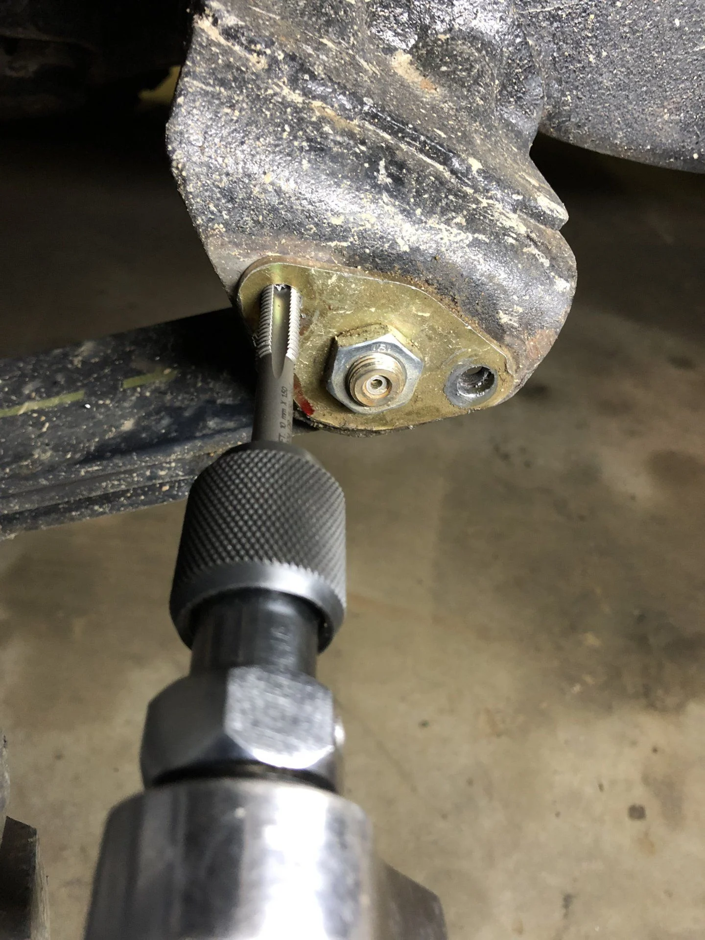

Third, the suspension is new and a lot of bolts had backed out of the fixed pins. I put new bolts in with red lock tight on 3 of 4. One though was stripped out and I had to tap it out to 10mm

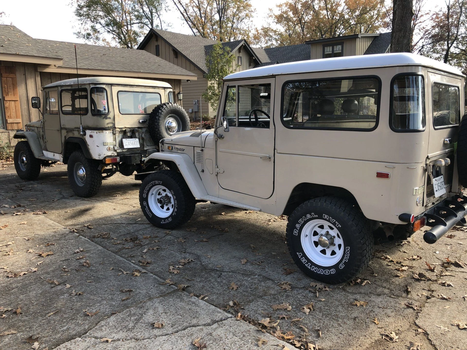

Yeah don’t get into a 40 if you don’t want to spend lots. I’ve got zero labor and zero body work costs in my Project Patina pictured there with the Delta Beast and I have $20,000 in it.
