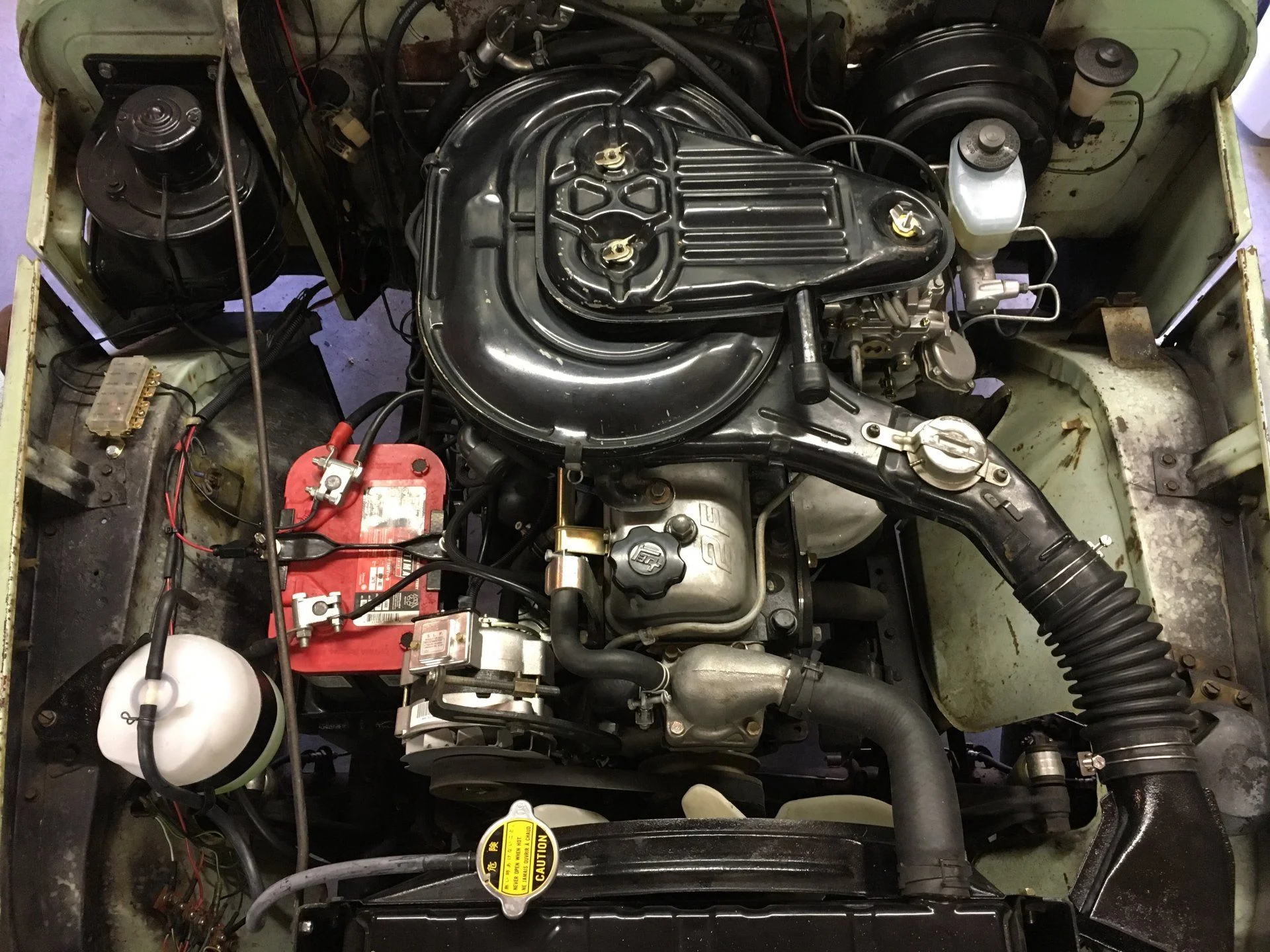

Well the day has finally arrived that I am calling my part of the new life of this Land Cruiser complete. After morning meetings at work I gathered some of the final parts and buried myself in the final push.

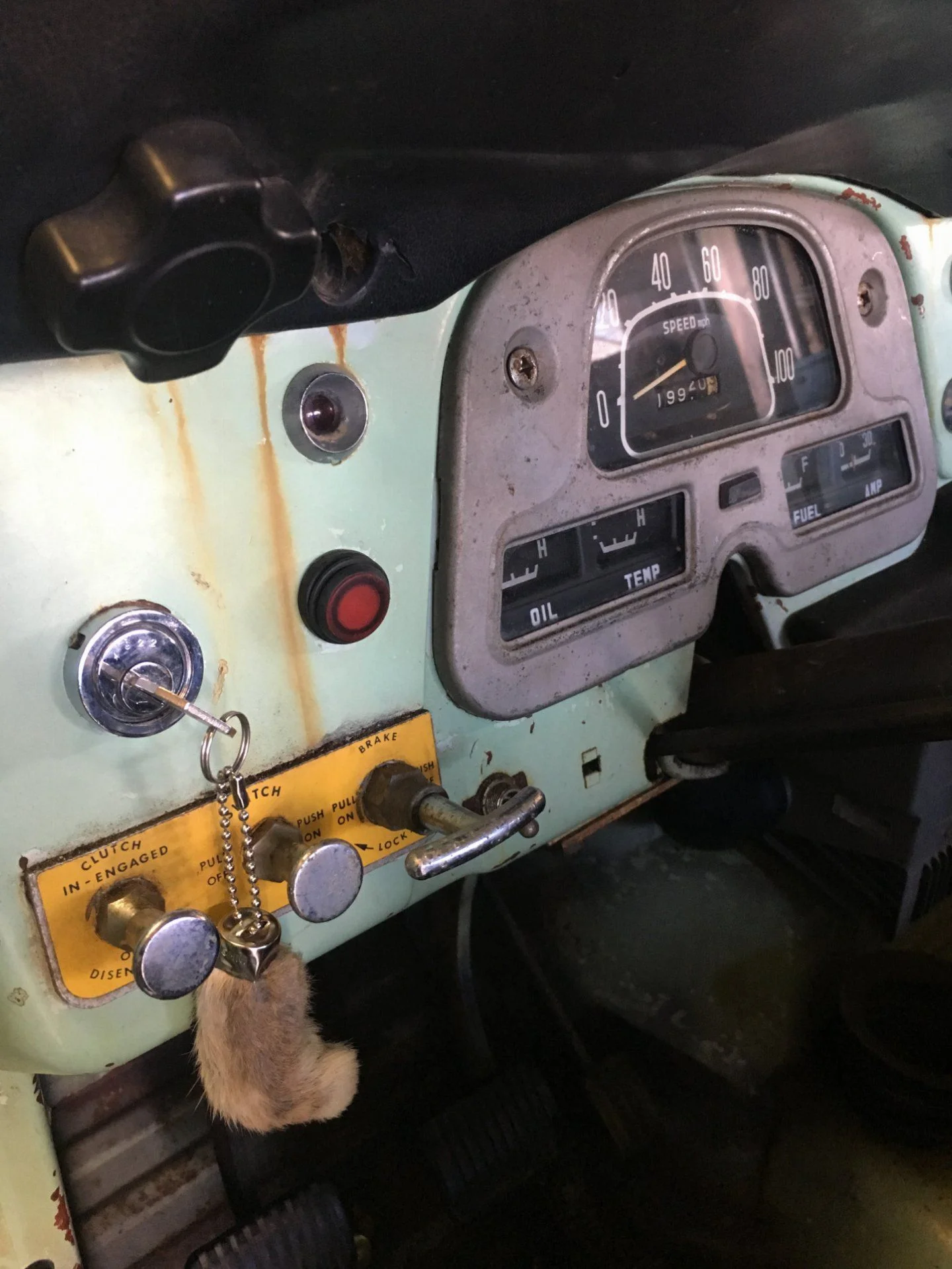

First, a friend made fun of the cheapo license plate holder that was on it so I located an OEM plate holder. I had to do a little work to make it work but finally I got the thing to glow.

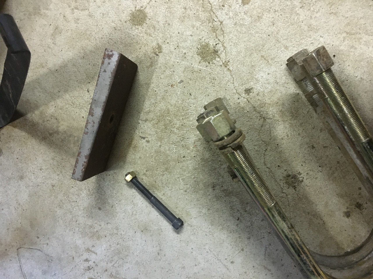

I asked around town and found a set of steel caster shims. This thing has 1.5" over stock shackles so it was out of caster and therefore it darted around on the road pretty badly. I grabbed a couple grade 8 bolts for new spring pins and dove in.
Steel is the only way to go on this mod. The aluminum ones always pound flat over time.
You might need longer Ubolts. I had one in my stash.....
Passenger side went quick but the drivers side threw me a curve. The fixed end of the spring had no bushings. Again, I have a stash so all that did was add time to my job.
