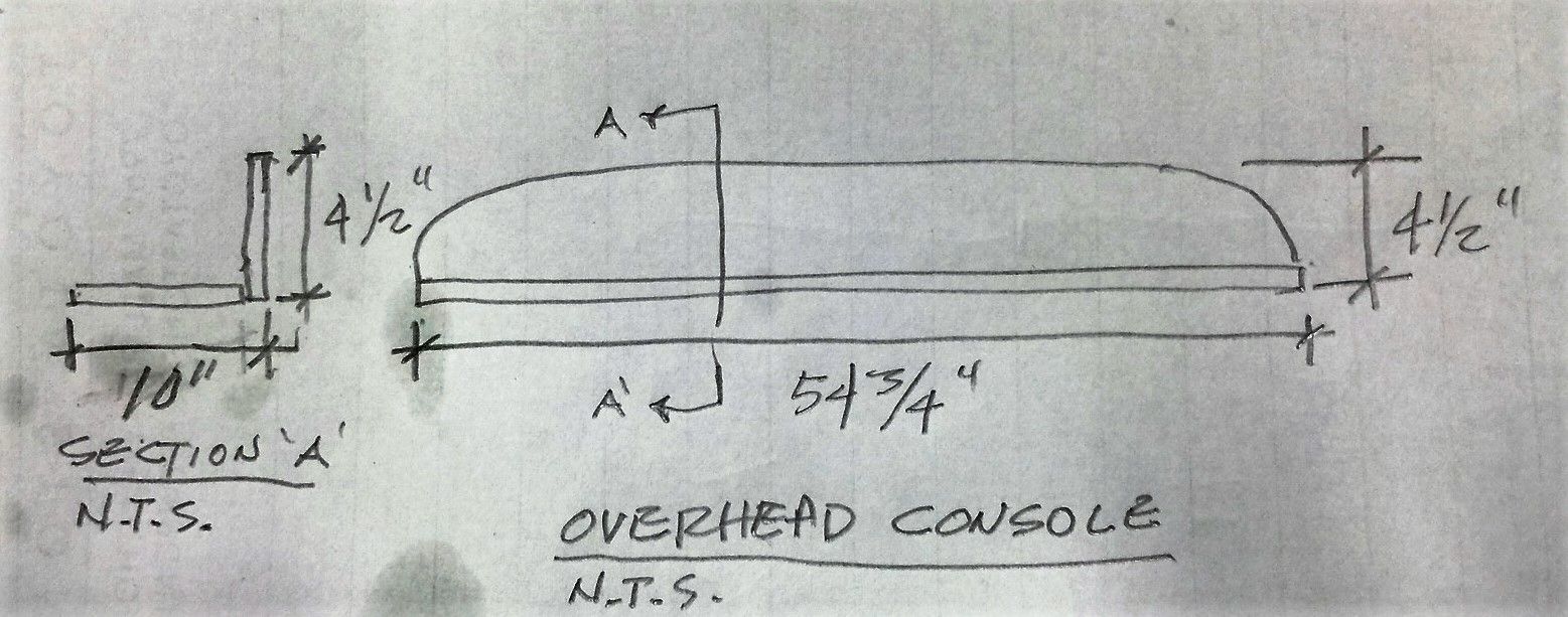

Mike's Overhead Console Build

Overhead console installed, wired for power and sound, installed two 3 way Kenwood speakers rated @ 220Watts RMS each.

That really looks awesome, Mike! You did a great job, I'm sure getting the contours to fit right wasn't the easiest thing to do! I've got so many other things to do first, but I have always wanted to do an overhead console, too. I'll certainly be coming back to this thread in the future...thanks for your great pictures and documentation of this project!
