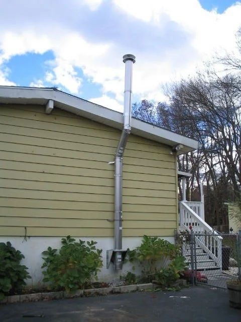

Out side of building mock up of thimble with Metalbestos 6" double wall piping on wall brace
full
Location of chimney on outside wall of building
full
Sample chimney, mine will look approximately the same, however, at a different elevation
full

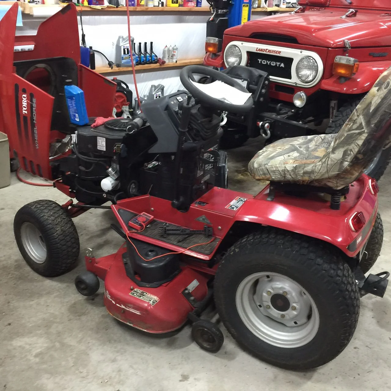

I'm also working on the Toro as it decided to quit working on me. I have a good battery, turn the ignition key all the idiot lights come on, including mine, but will not start. This thing has a multiplicity of micro switches so I suspect one them has gone to the dogs. My next step is to remove the cutting deck to expose all the micro switches and associated wiring and hopefully I may be able to correct the problem.
full
I have a similar Toro, hydrostatic tranny. You have to press the brake to get it to start. might be that microswitch. Yours looks in very good shape! Mine is probably 1998 vintage.
Thanks Ernest! Mine is also a 1998 hydrostatic 260H, the brake micro switch is the first one I'll check. I already by-passed the seat sensor switch, however, I'll check them all and hope it starts, I'd hate to trash it as its been the best tractor ever, and its been running perfectly until now. If I can't getting going again it will give me a reason to purchase a new 4WD tractor.

I rebuilt a burned up BadBoy mower. I had a few electrical gremlins, so I tested all the micro switches and relays... after removing, testing, adding electrical grease and reinstalling. All is well. My connections were corroded.:meh:

I cleaned all the relays (4) and they are good to go, I'm pretty sure it's one of the micro switches that's corroded, I'll post pics as soon as I get to them, waiting for the temp to go up a bit before I head to the shop this morning.
