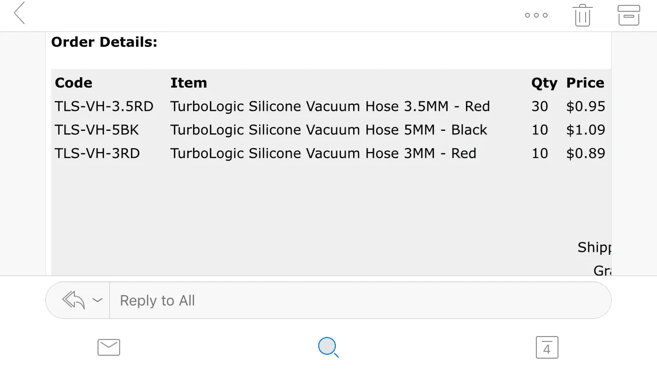

Here are the part numbers for the hose. Keep asking away, search can get frustrating. I used 6mm for the 60 (supposed to be 5.5) so I ordered 5mm to see how it fit. The silently stalking cracked me up this morning...good stuff.
Thanks for the part numbers. How does the 6mm line fit as opposed to the 5mm? I like the different color. Much easier to trace the vacuum soup of the EGR system. I've got to get the old beast to pass smog here in CA. Always a fun time on a carbureted vehicle that needs to meet current emissions standards.

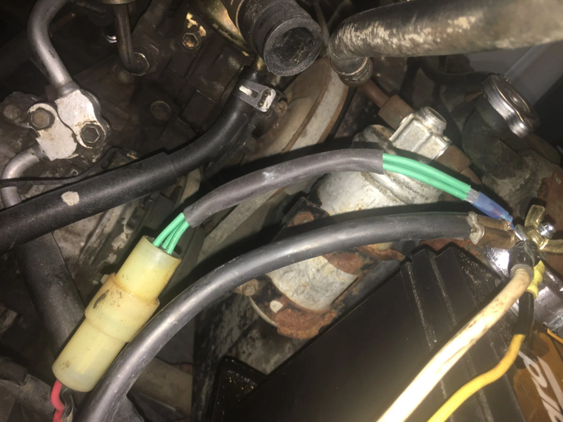

Got setup to do this yesterday, battery hooked up, jumper in, key on....nada...start checking power and find a bad fusible link. Thing checked fine for continuity out of the vehicle. Turns out I can twist the wire a little and make it go open. Crap...parts search...NLA...double crap...pull my 60s spare out of the bag...I could cut the connector off and use this one...can't start robbing it's parts...wasn't someone on here making some?...search search search ..maybe ..nope ..search.. aha coolerman....pm sent...didn't I buy some fusible link wire a while back?...

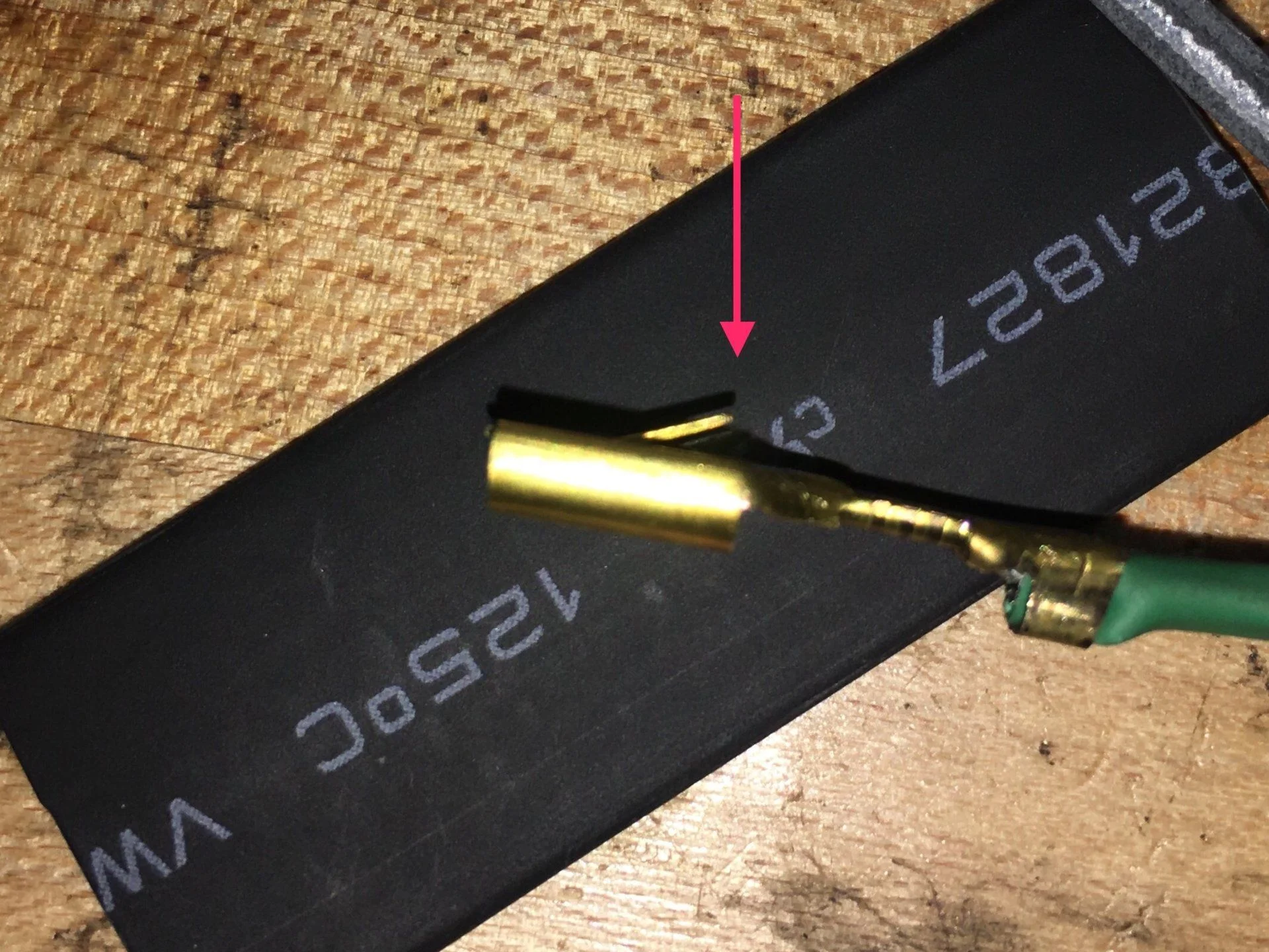

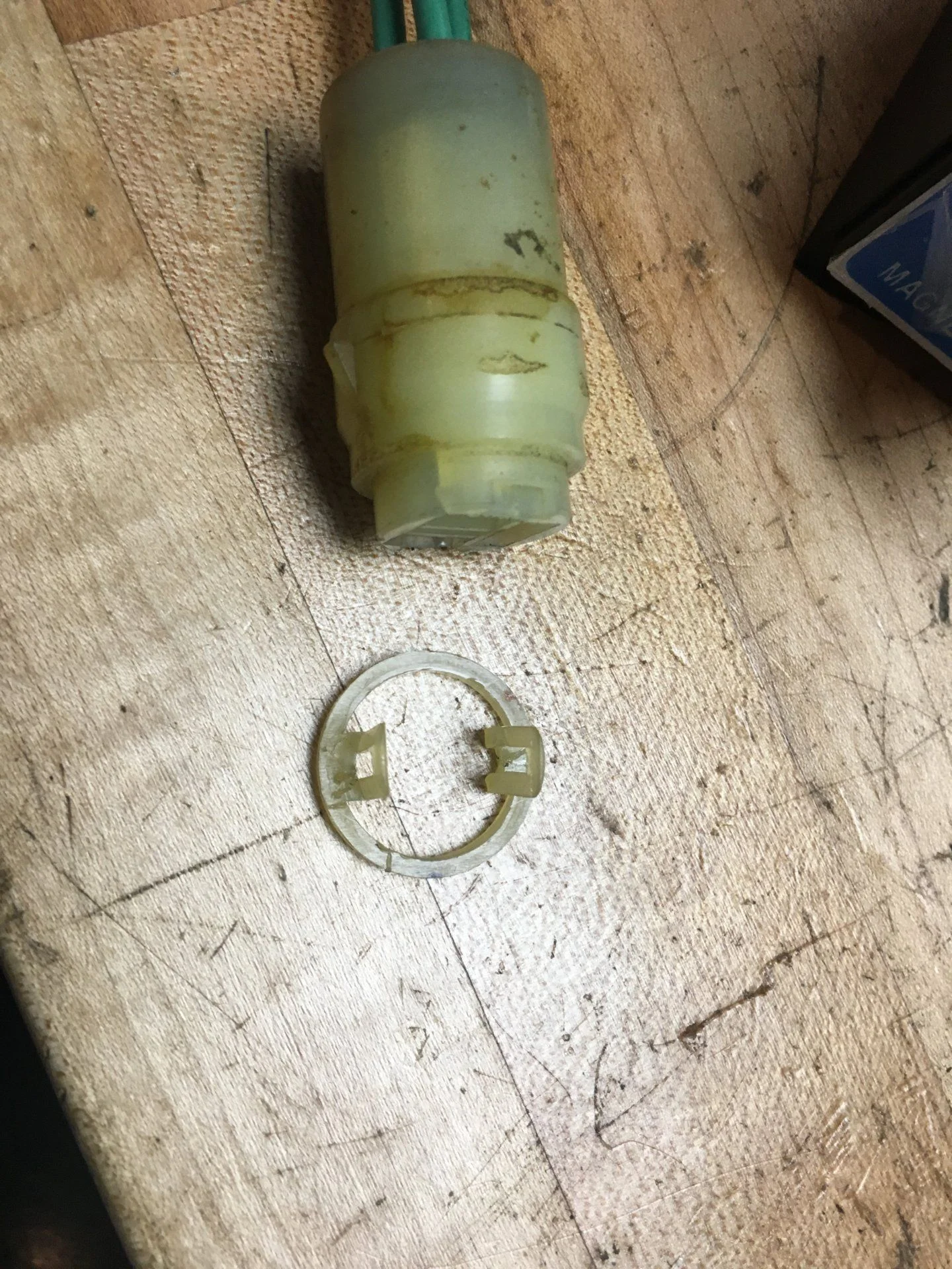

Just as a reference, once you get the rubber stopper out of the back of the connector, this is the tab that holds the terminal in..
There is no discernible reason why this piece comes off or is even a separate piece. Maybe just to give you something to puzzle with and give you hope that you're making progress, then...???
Replaced the 3 greens with 20ga

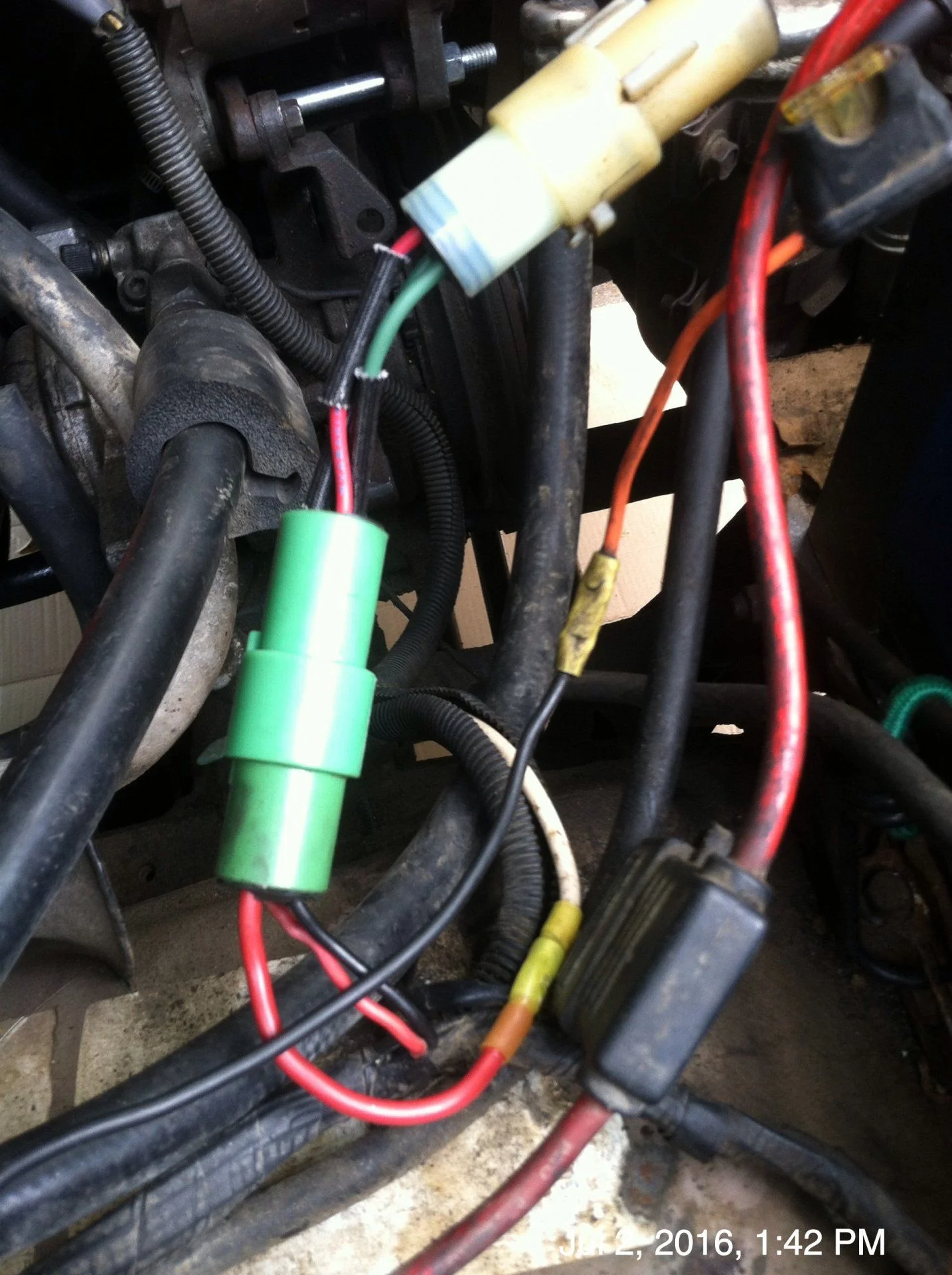

I rebuilt mine but did buy the one stretch of the section from the dealer. I’ll have to check my thread to find out which it was. The rest I pulled apart like you have and rebuilt it.

The 5mm definitely has a more secure feel to it and I don't think being .5mm under will effect airflow. What part of SoCal are you in?

I had replaced the middle section... probably a diff beast than the 62. The section I rebuilt was from the harness to the middle. I reused the female connector you show above because nothing was long enough at Napa. But yeah, Coolerman does nice work. He guided me on the wires gauge as mine was split and jumped to the positive.
