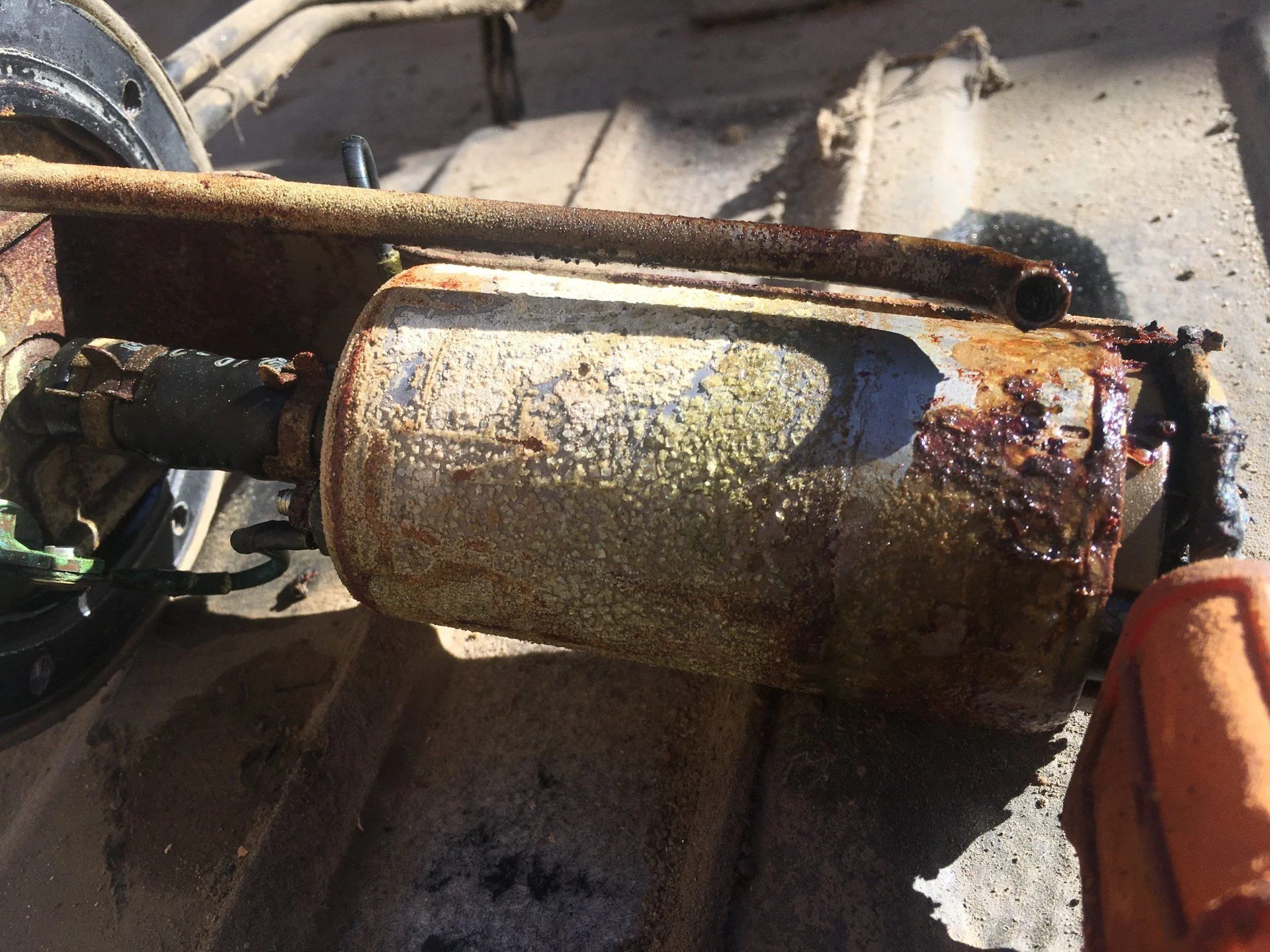

Waiting on parts...I never could get the fuel pump to work, there was 12V at the connector, just no life out of the pump.
So we dropped the tank today to inspect and found this mess...new pump and filter are ordered.
Yuk, how's the inside of the tank look?
It looks pretty clean, the B12 cleaner got most of the funk out. I will put some more in today and give it a final cleaning.

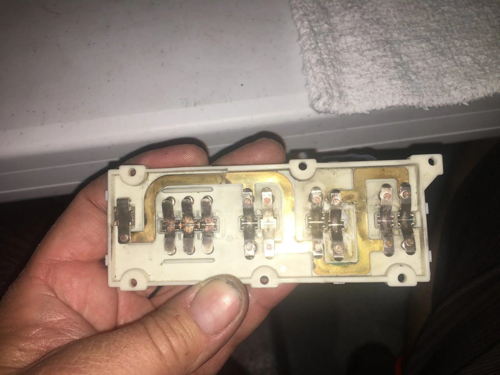

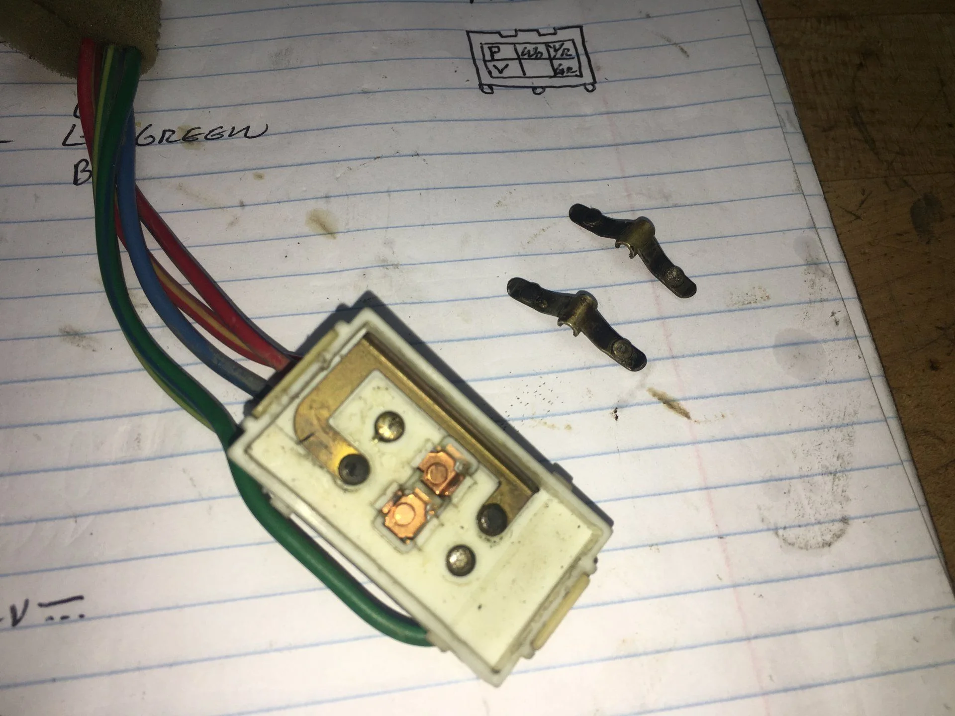

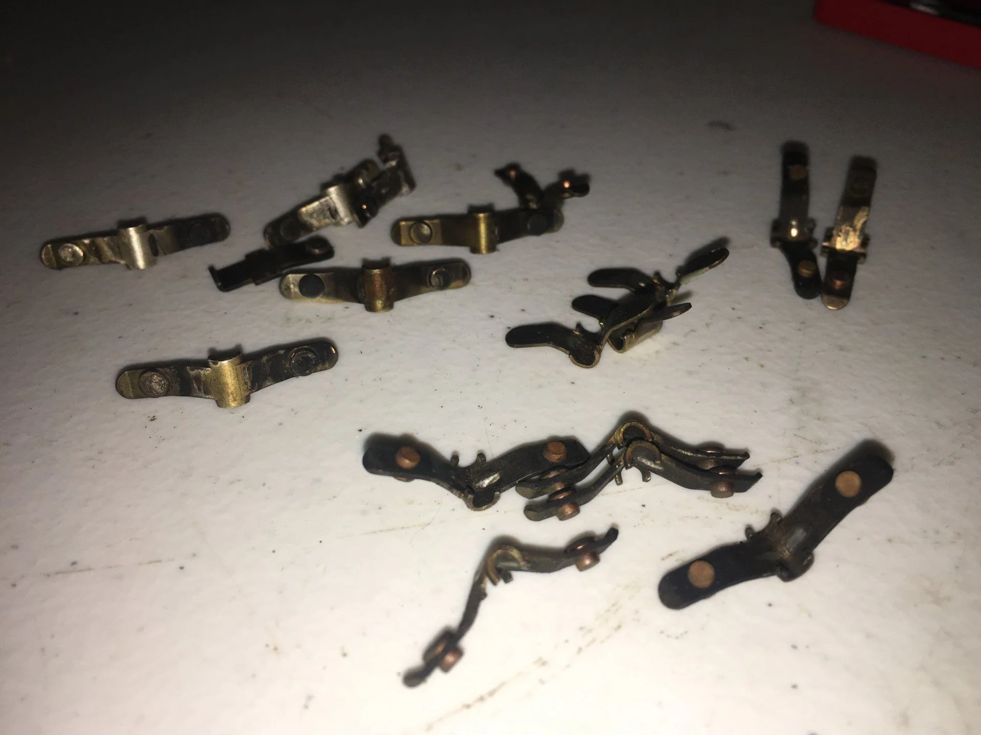

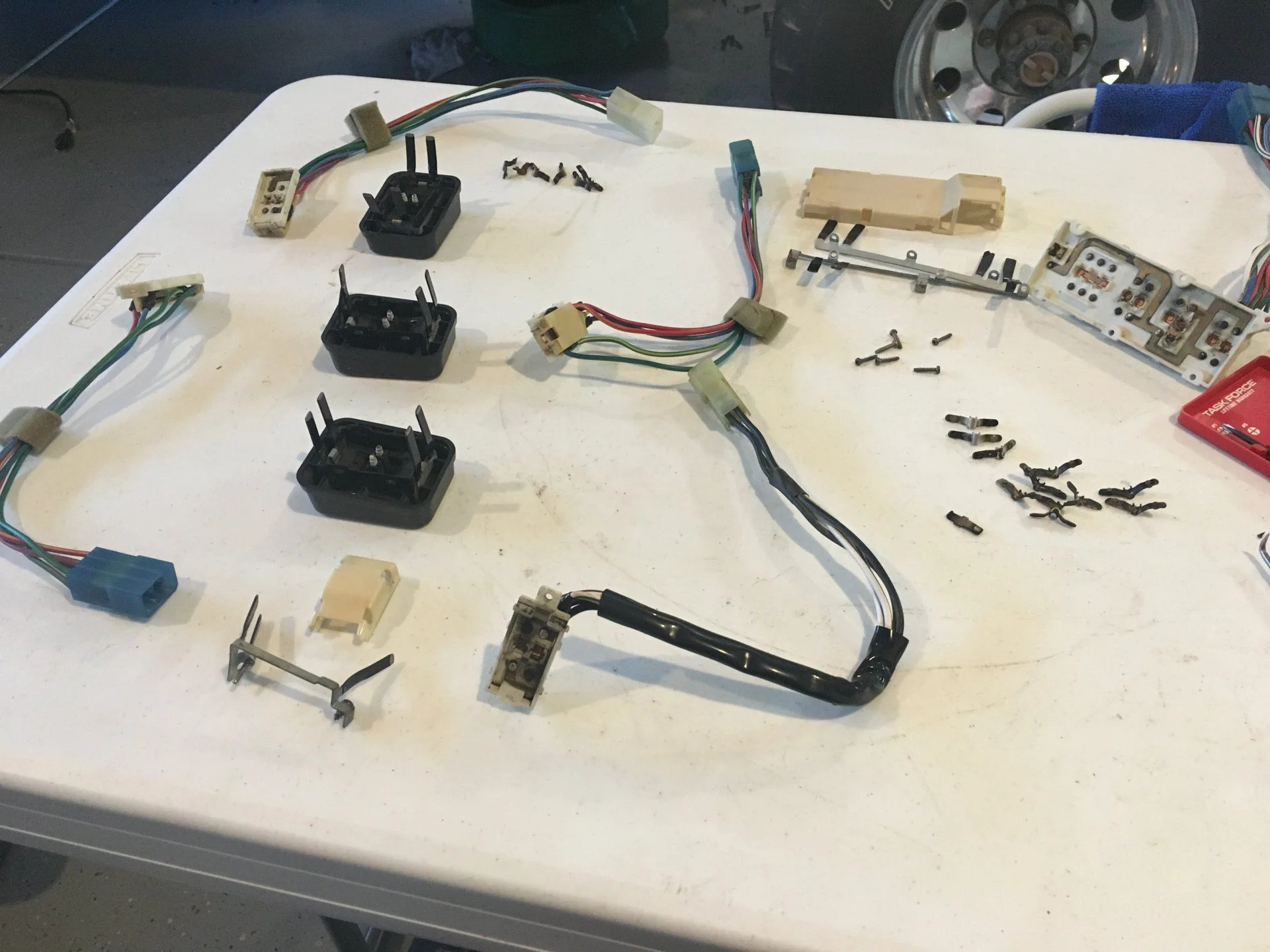

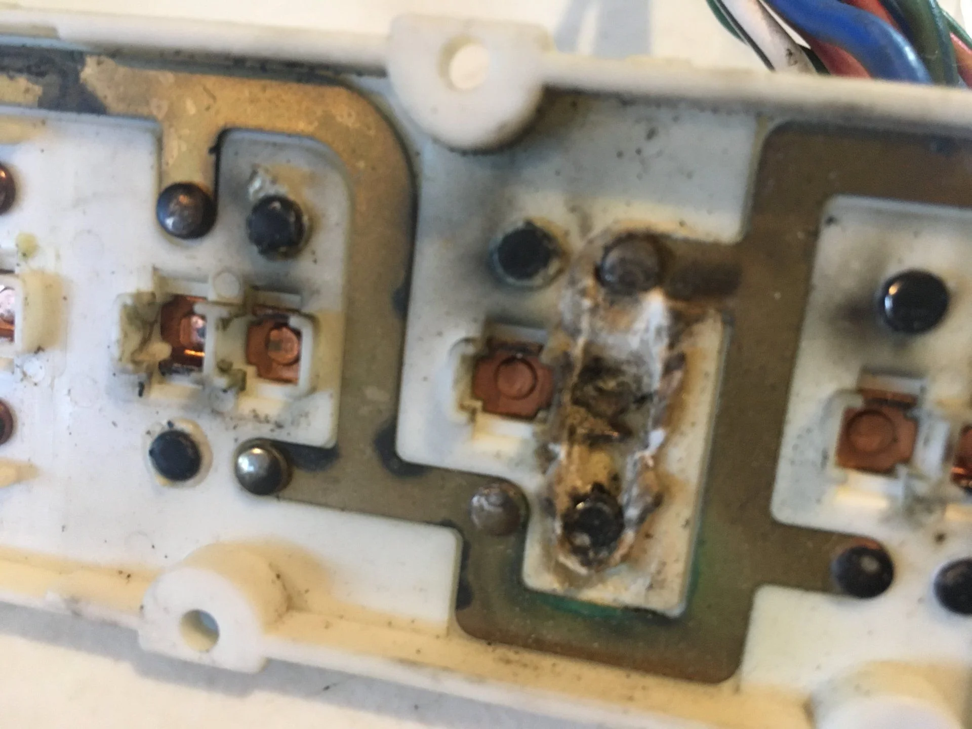

Well, being on a parts delay led to seeing if the windows worked...Driver's is sloooow, passenger rear decent, the other two a faint click and nada. Voltage is good and running a jumper to the motor works...so switches. There's a lot of buildup on the contacts and one of the driver's switches was pretty melted inside. All of the rocker contact things are in the ultrasonic cleaner.
Odds are, I will throw a relay in each door to switch power and take the stress off the switches. There's a really detailed write up somewhere on here. Simple enough I suppose. We'll see how well these clean up and operate.

So, tonight, finished cleaning up the contacts and such for the window controls. Everything came out clean but the passenger front window is sa lo oo oo oo w. An improvement from a slight click and no movement but still. Cleaned the tracks with a wire wheel, lubed every moving or friction surface, took motor apart and cleaned brushes and rotor surface, Meguires on all the rubber...either there is a big voltage drop or the motor is shot. Didn't put a meter on the motor. To be continued as the transmission gaskets and strainer are waiting for install.

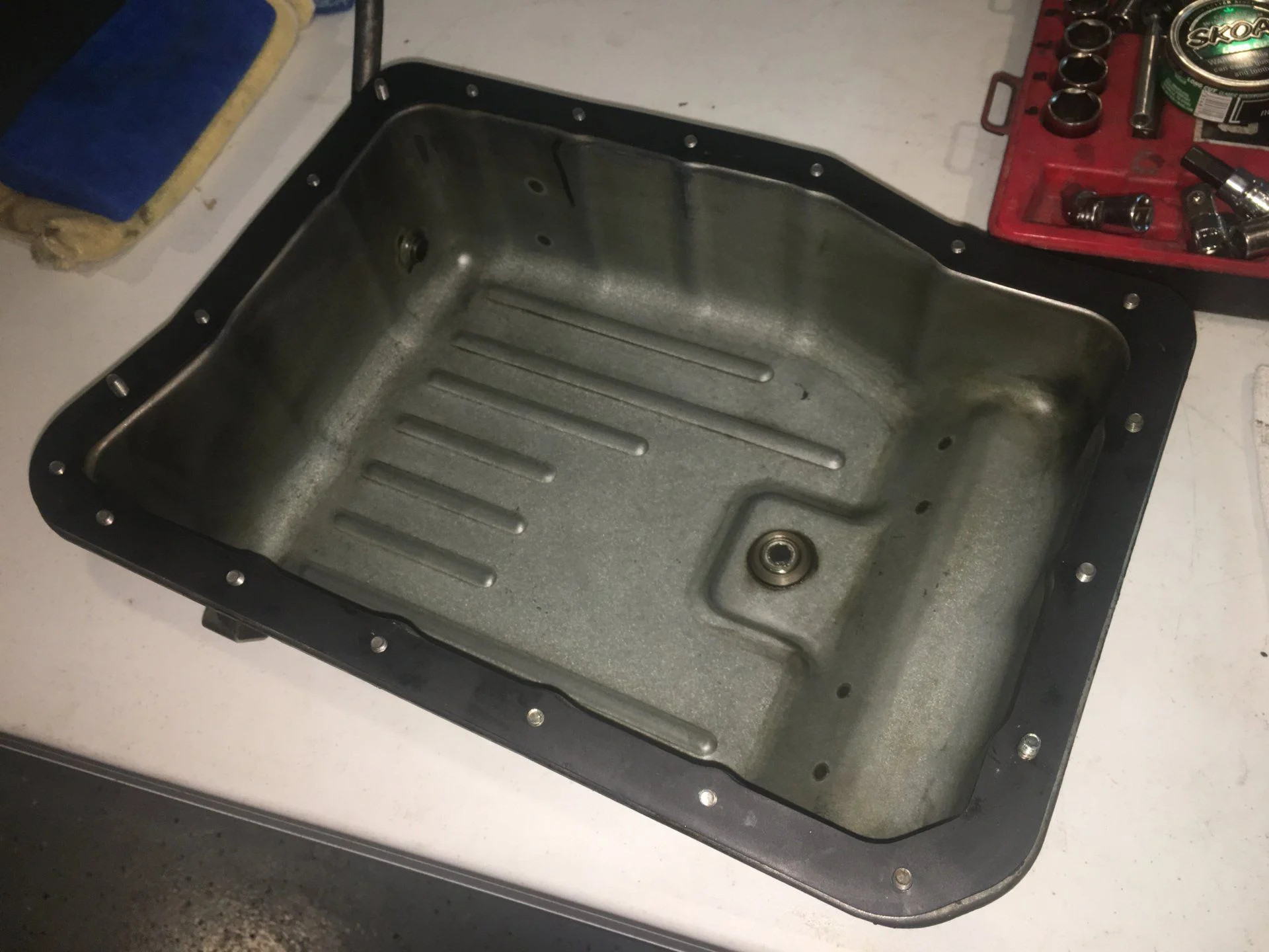

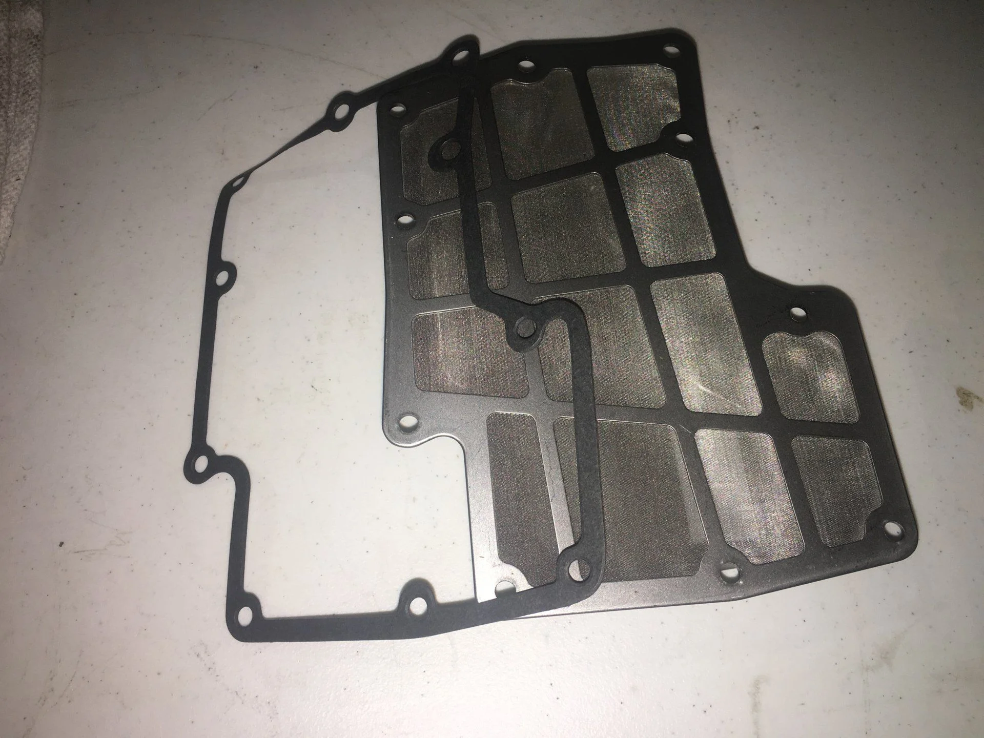

I sat here for a while trying to figure out how I was going to get the transmission gasket on and lined up...turns out, the holes on the rubber gasket are small enough to hold the bolts. Good stuff. This is the WIX kit.

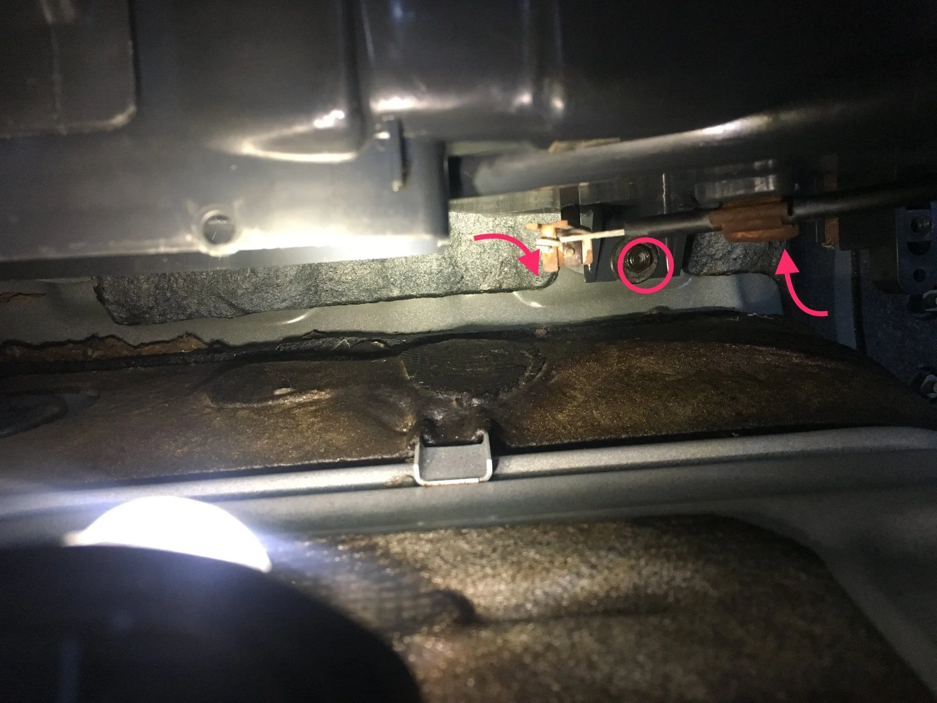

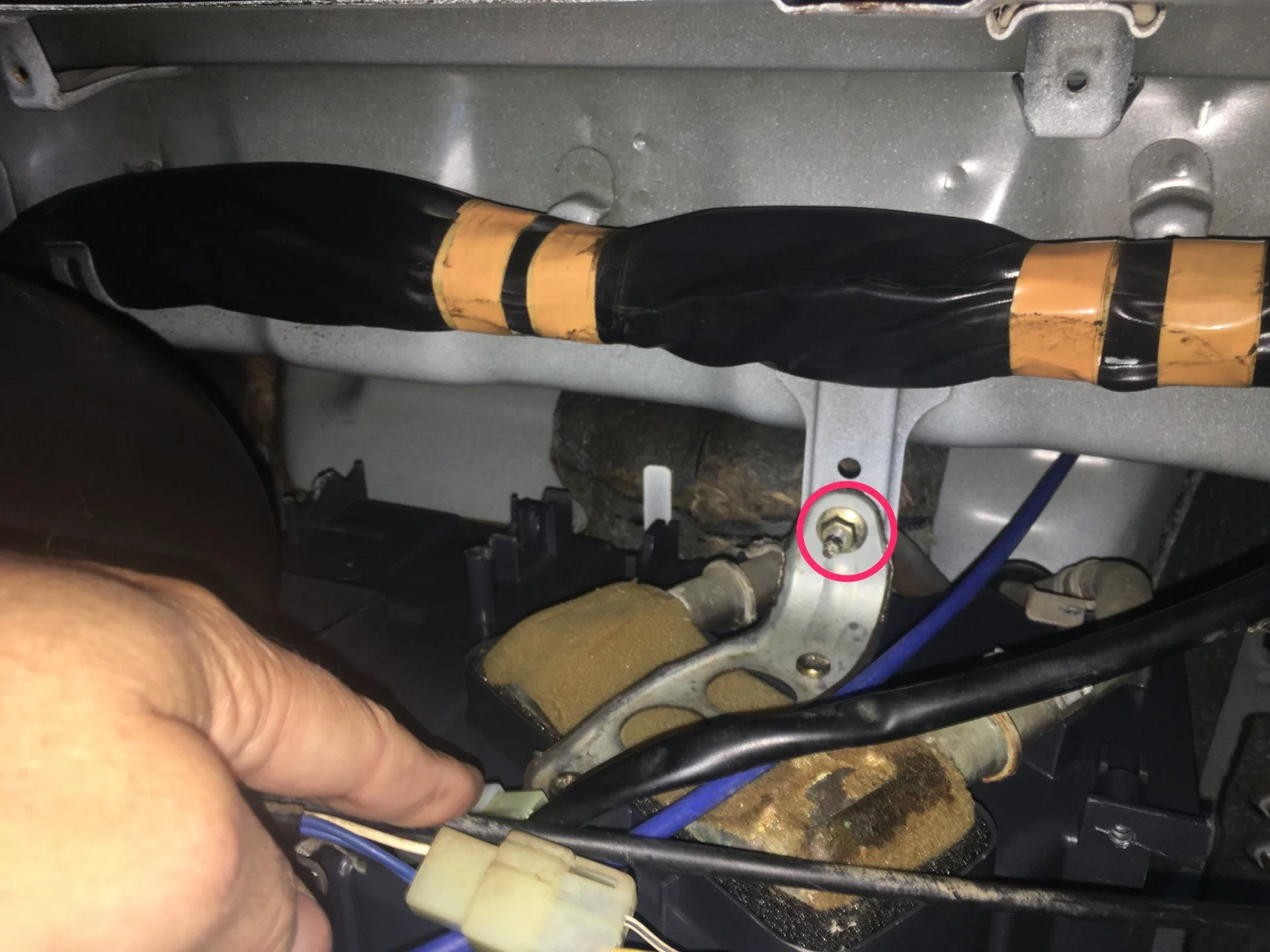

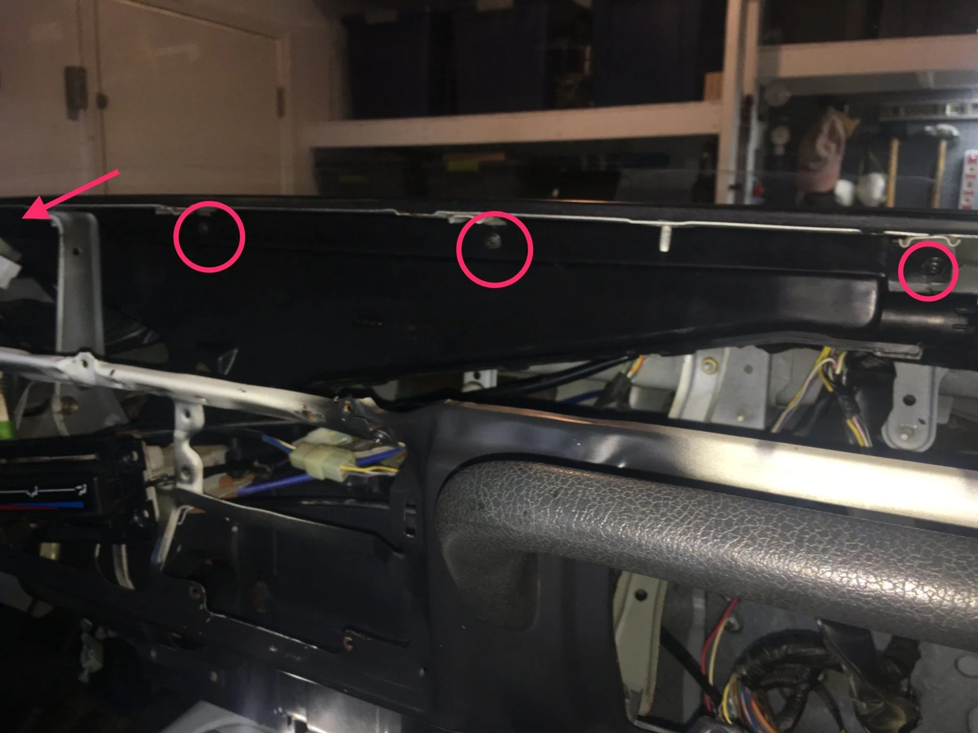

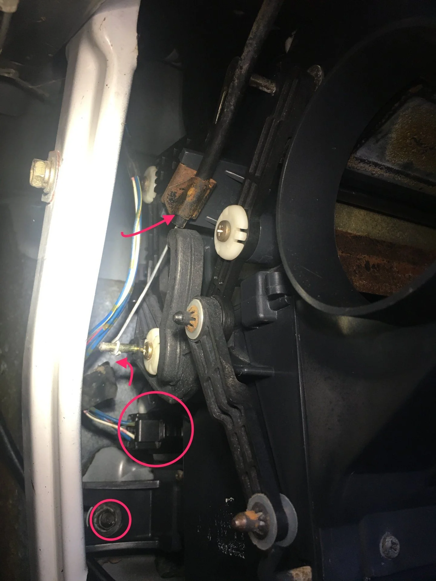

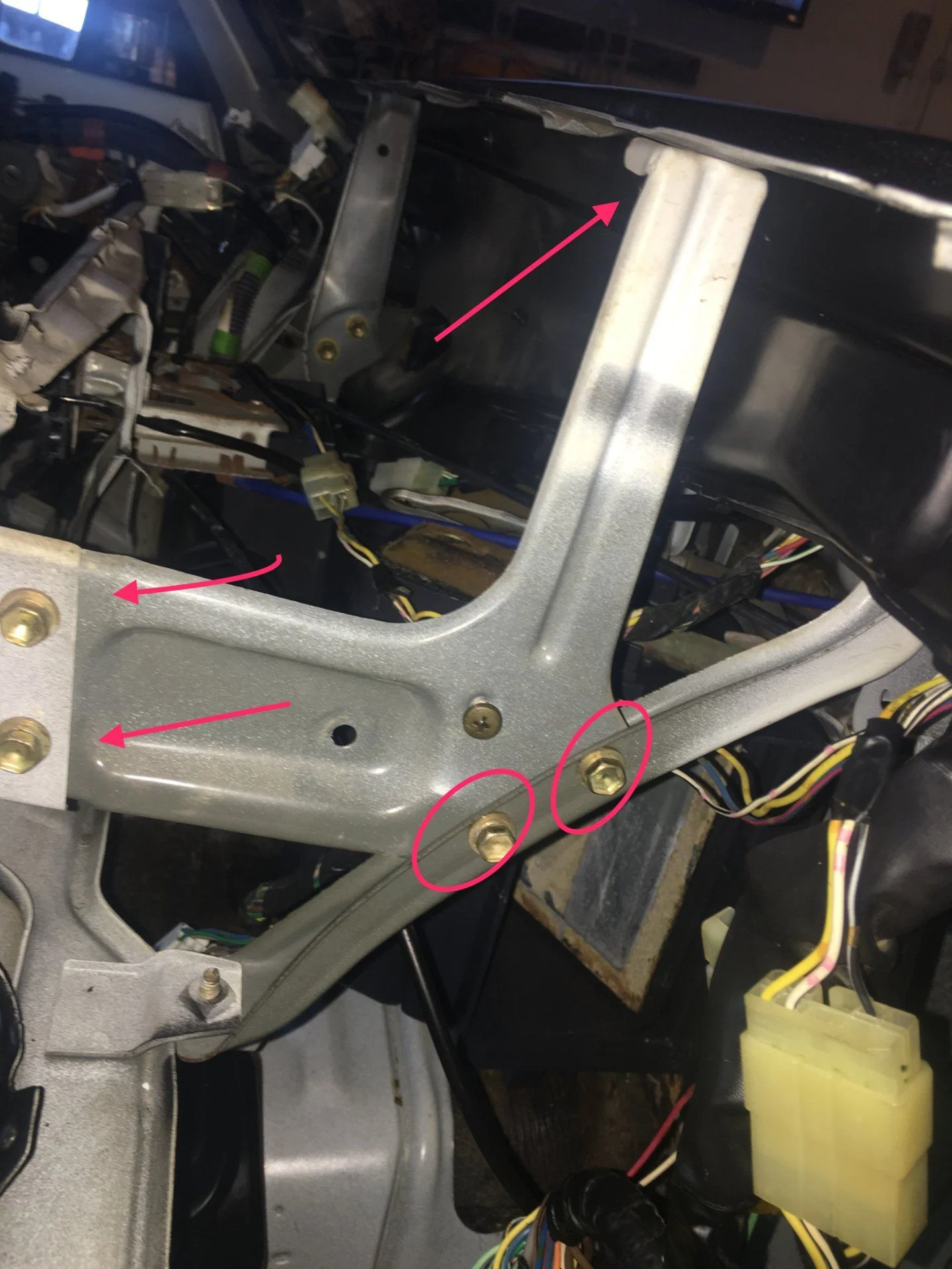

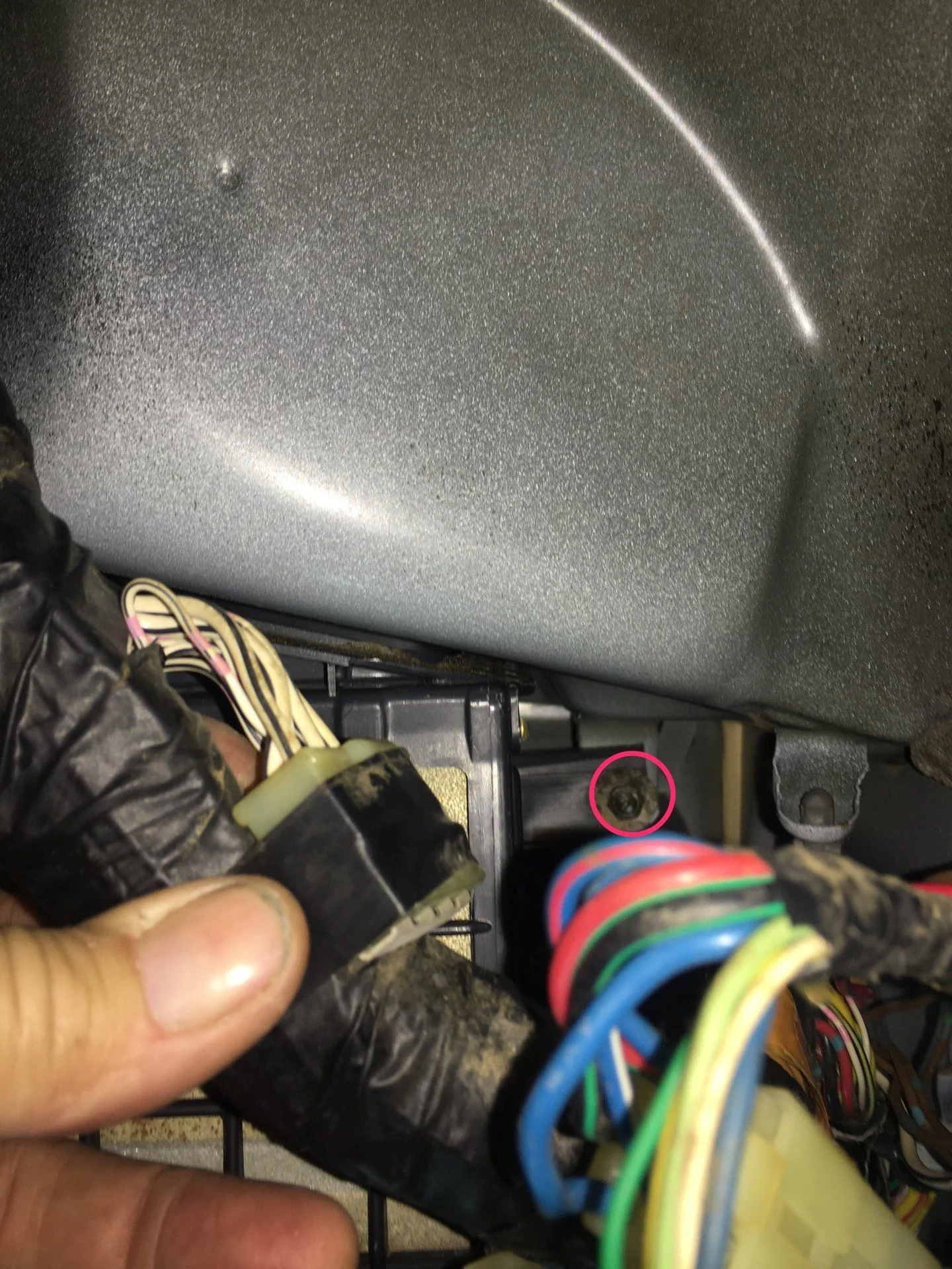

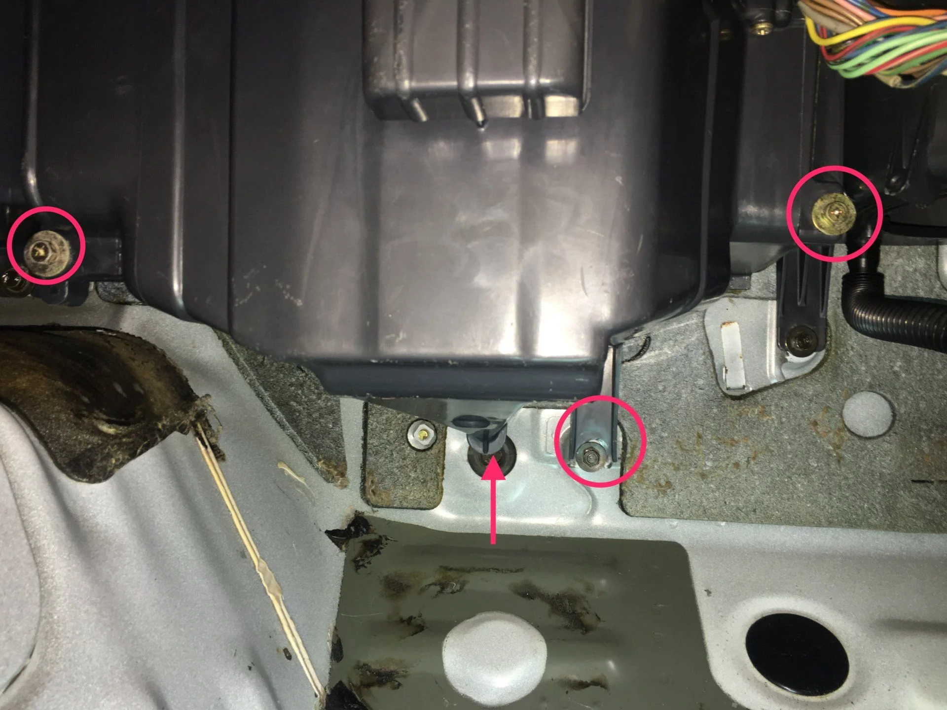

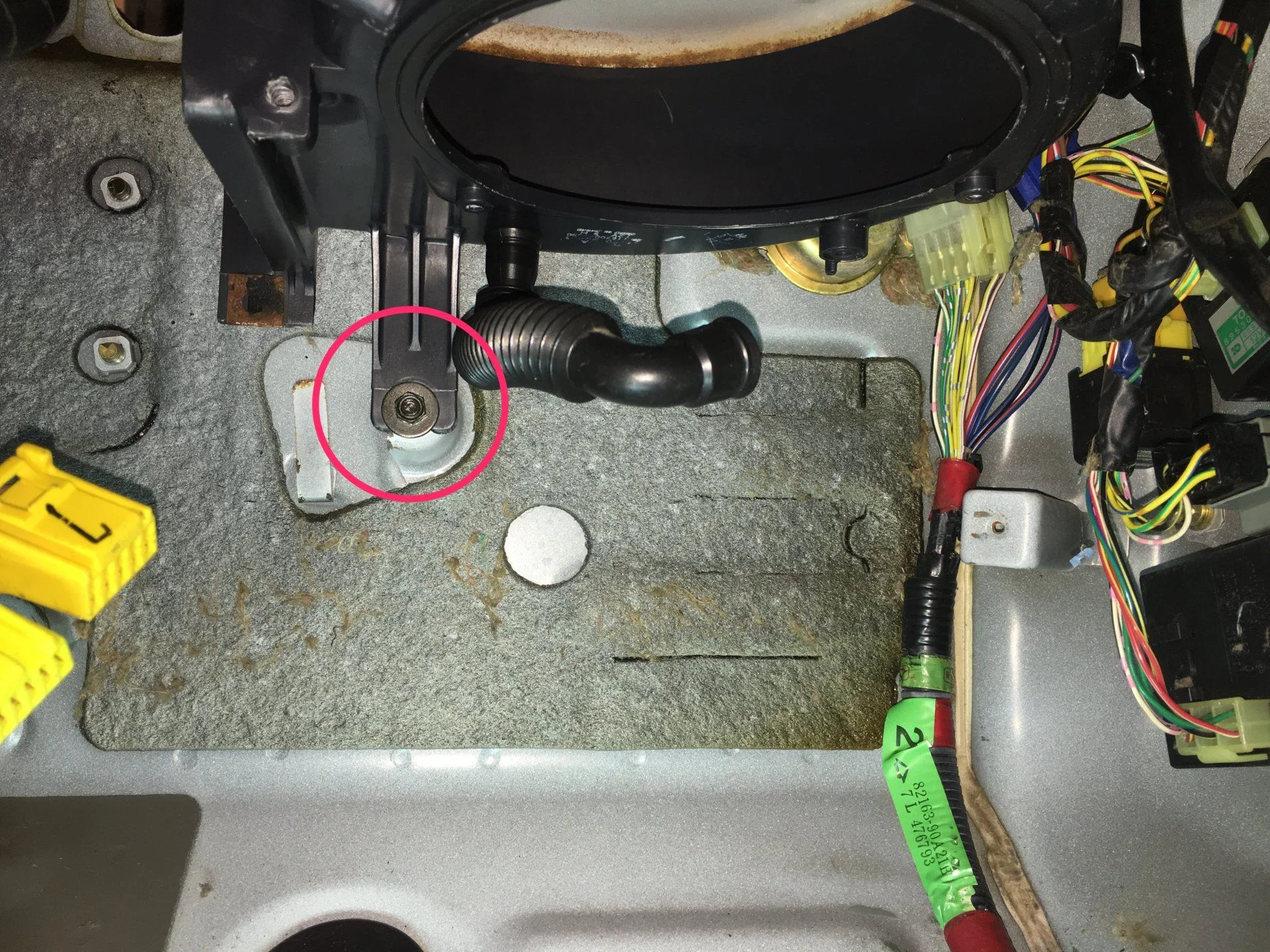

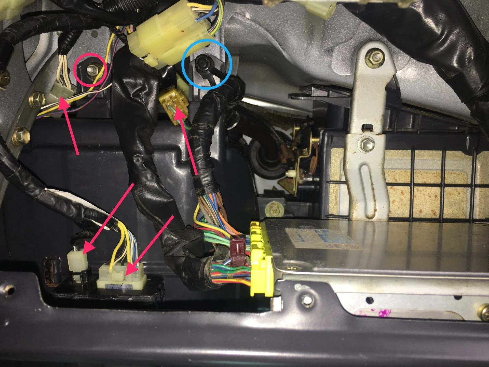

Order of removal of dash components, that worked for me. The last 4 need to be done in this order...you could take out the blower motor enclosure after the evap enclosure but the evap enclosure is first.
Glove box
Computer
Dash bezels and instrument clusters
Radio
Dash
Air ducts
AC evap enclosure
Heater core enclosure
Blower motor enclosure
Defrost ducting

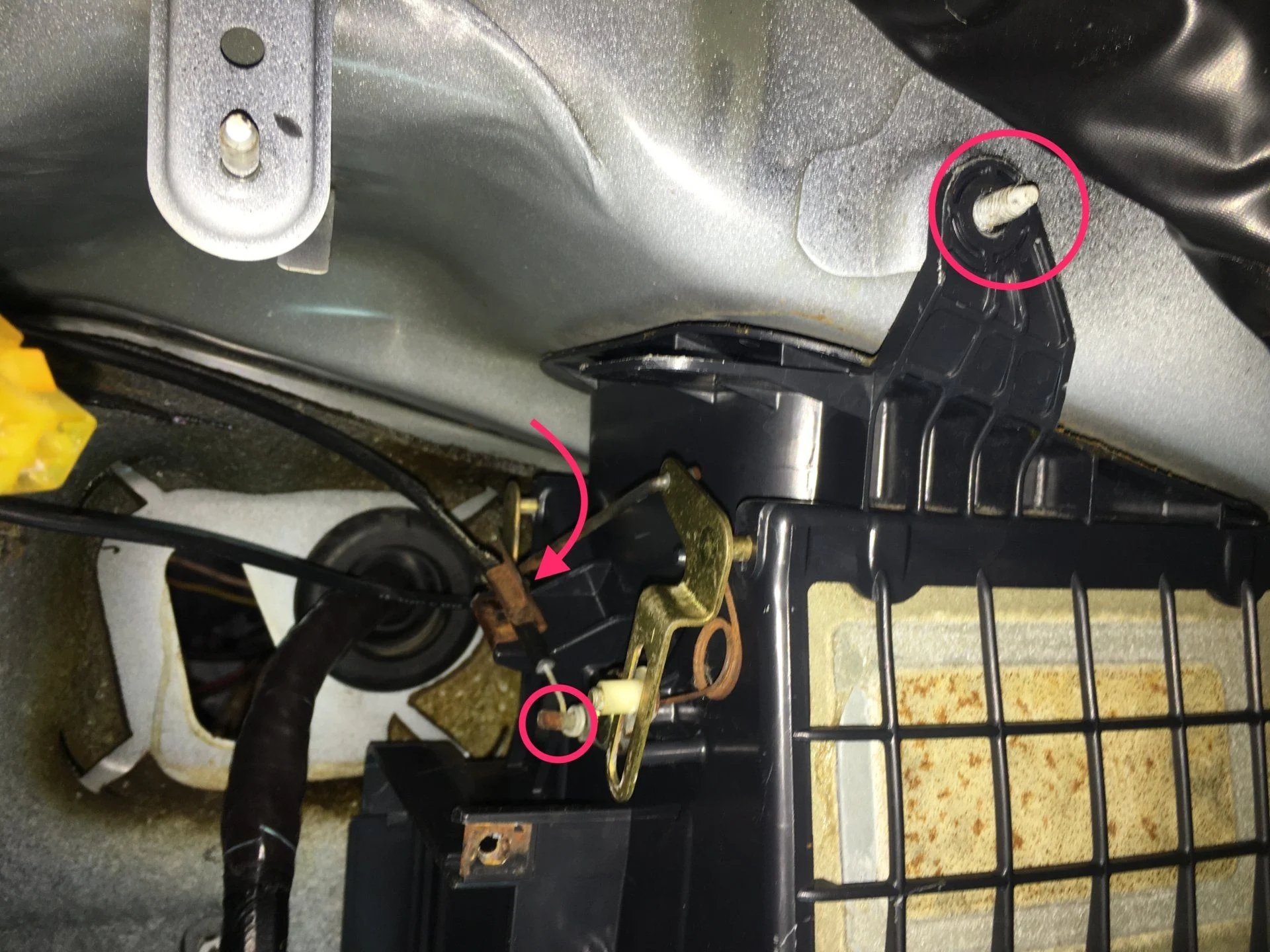

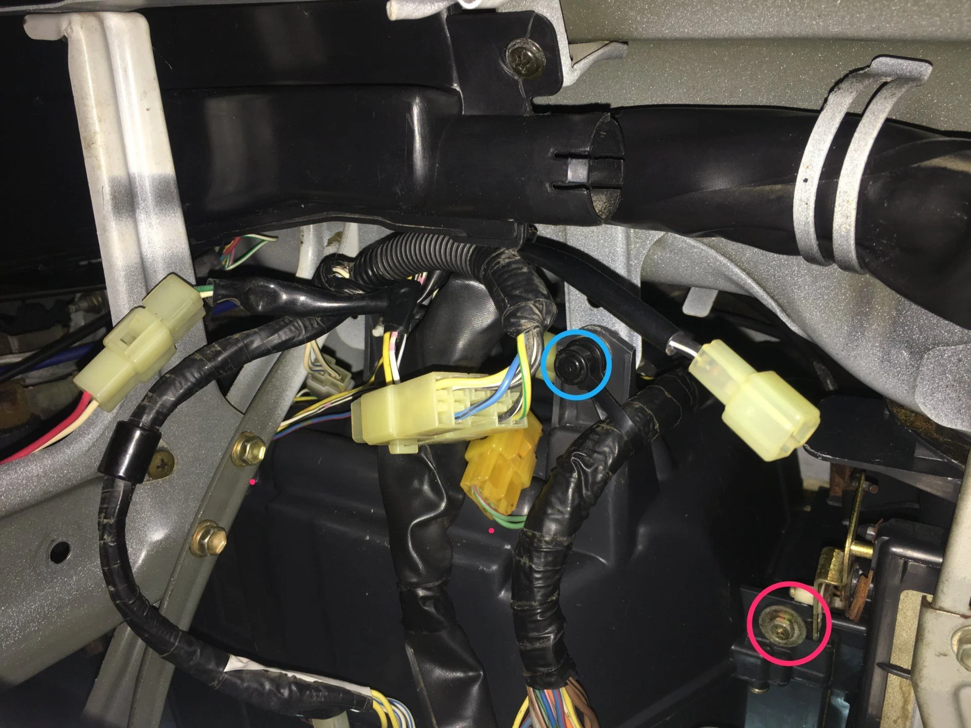

AC Evap enclosure
Remove hard lines in engine compartment and push rubber grommet into cab
Remove all things noted in pics
Slide enclosure off studs at top and rotate top toward you and slide ducts off of blower and heater enclosures
