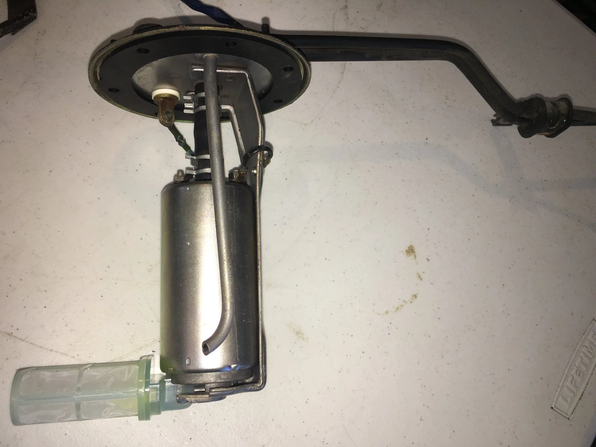

Got the tank back in, kind of a PITA. I left the passenger anti sway bracket on, made a pretty good shelf to rest the tank on.
Jumpered the +B and Fp pins on the diagnostic port, turned the key on and had a strong spray out of the union connector that hooks to the filter inlet.
What a relief that was. After all that wire repair and messing with the harnesses.

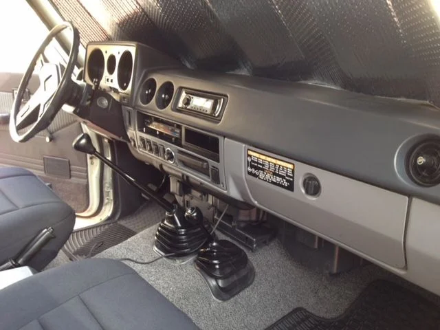

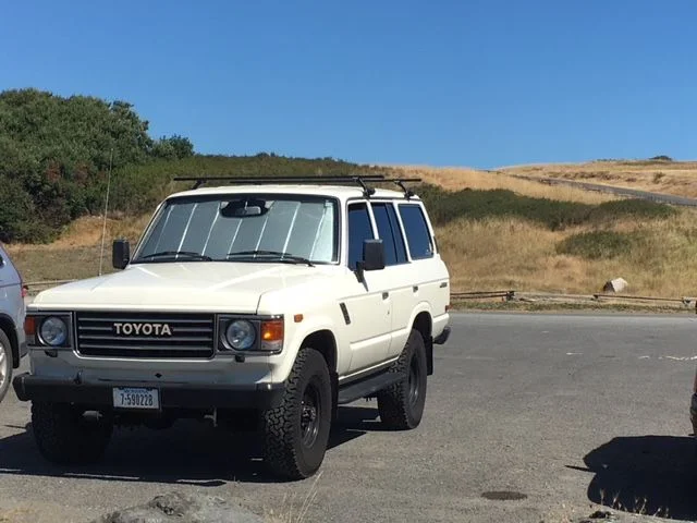

Gratuitous pic of my rig in the same color...
You can't see from the pic, but the gear shift goes 1-5 speed (have an H55 hiding under the tunnel) :D
    That's a clean 60. Very nice. I put the H55 in mine back in March or so. Still have mixed feelings about the in town 1st and 2nd ratios. I'm running 32s. Did you keep the stock gearing with the 33s? Curious what gear you normally start out in daily driving and your thoughts.
