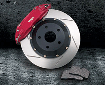

Though some red TRD Pro calipers would sure be some kind of purdy...

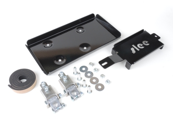

It was time to get a new battery. My old battery was starting to die on me. I could tell that it was going out because I'd leave my lights on for a few minutes and I would have trouble starting the truck afterwards.
So, instead of just buying a new battery, I decided to upgrade to a Group 31. I went with Interstate's new 31 (recommended by Slee) and Slee's new Group 31 primary battery upgrade kit. Installation was straightforward and took about 40 minutes. All that was needed were a few ratchets, and a step drill.
Old battery out:
New Group 31 and Slee Tray:
