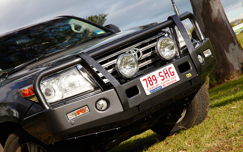

Ordered a TJM T13 Bullbar this morning!
Woohoo!
This is a stock photo, in case anyone wants to know what they look like
Why the TJM over the ARB?
1. The TJM does not require any cutting of the factory bumper.
2. The TJM has provisions for headlight washers (impossible with the ARB design).
3. The TJM has provisions for parking sensors (the ARB does not).
4. The TJM has High-Lift T-slots (the ARB does not).
5. The TJM does not protrude very far past the grille (the ARB is absurd, with how far it sticks out).
6. The TJM is also about $500 cheaper, but that doesn't matter; hell, if it was $500 more expensive, I still would have gotten it!
