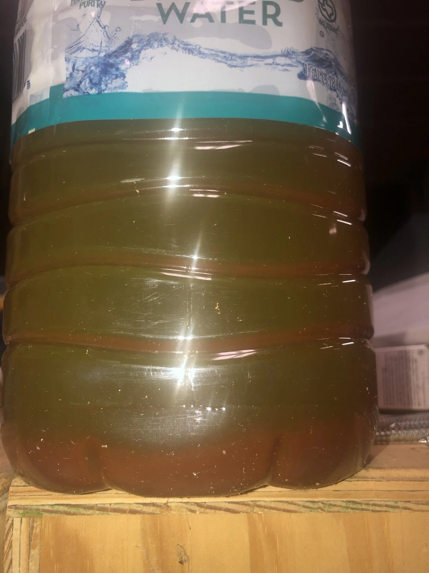

So I've been thinking about the gunk that was obstructing my radiator's petcock and went back through my flushing/cleaning techniques. I think I have figured out what was (were) the culprit(s). Hopefully documenting this will help others to know what to not do, or at least be aware of.

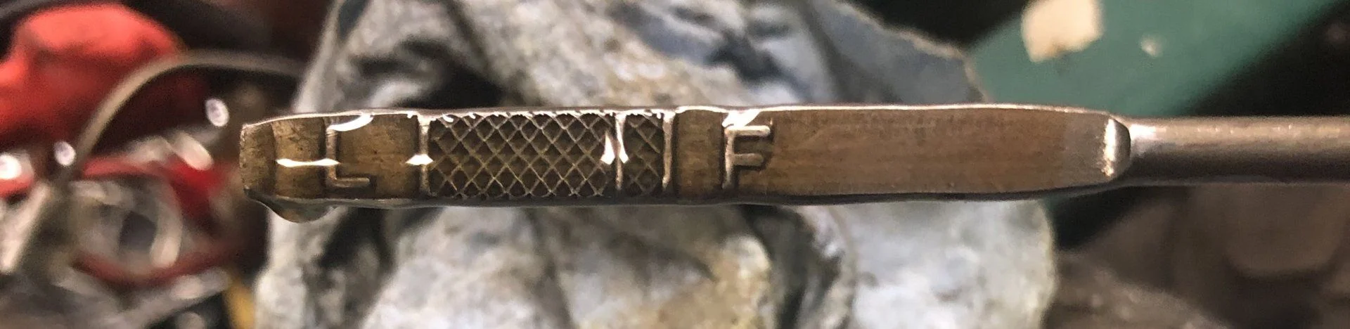

Check your dipstick.
I followed his sage advice and this is what I saw:
This is the oil that has been running since we changed it out when we first got Marion so I was happy to see how clean it was--no sign of coolant mixed in. Granted, we haven't had a bunch of run time but enough to where there would be coolant if there was some breach between the cooling and oiling systems.
I also still have the coolant that we drained out before pulling the head and there was no sign of oil in it (not planning on reusing it, just have not a chance to dispose of it at the hazardous waste drop off). Interestingly, the rust had all settled out to the bottom--I was surprised at how thick the layer was on the bottom of the bottles. Main realization for me with this is that rust particles settle out to the lowest place (this would be the petcock in the radiator in my case).
So what I forgot to mention in my previous postings is that when the head was pulled, it was drained through the block drain. This left coolant in the water pump, lower radiator hose and bottom of the radiator. After the extensive flushing of the block I filled the water jackets of the block with Evapo-Rust and let it sit for 2 days. In order to be able to fill the water jackets fully I had to leave the lower radiator hose attached. The Evapo-Rust is a chelating agent that removes the iron from iron oxide and then a sulfur bearing compound binds to the iron forming ferrous sulfate--this stays in solution--unless it mixes with coolant, which has a more alkaline pH, then precipitate forms.
So, following the the advice of @Steamer and @middlecalf I pulled the lower radiator hose and saw this--a nice thick layer of what I would guess is ferrous sulfate:
Of course, if it is this thick in the lower radiator hose it would be very thick at the lowest point in the system, which is the petcock. This would be in addition to whatever heavier sludge was being flushed from the block (despite my best efforts to get it to drain through the block drain). I guess it's no wonder the petcock was plugged.
Okay, so what I've learned. If you flush the block like I did (which I am not saying is best practice, just what I did), I would make sure that the petcock on the radiator is left open or at least opened as often as the block drain is opened to keep it cleaned out. Also, if you use Evaporators-Rust, make sure ALL the coolant is out. It is not harmful to the system, it just changes the pH of the solution which yields suboptimal performance and results. Of course, you could always disconnect the radiator--you just have to find a way to block the inlet on the front of the block so that the jackets can be completely filled.

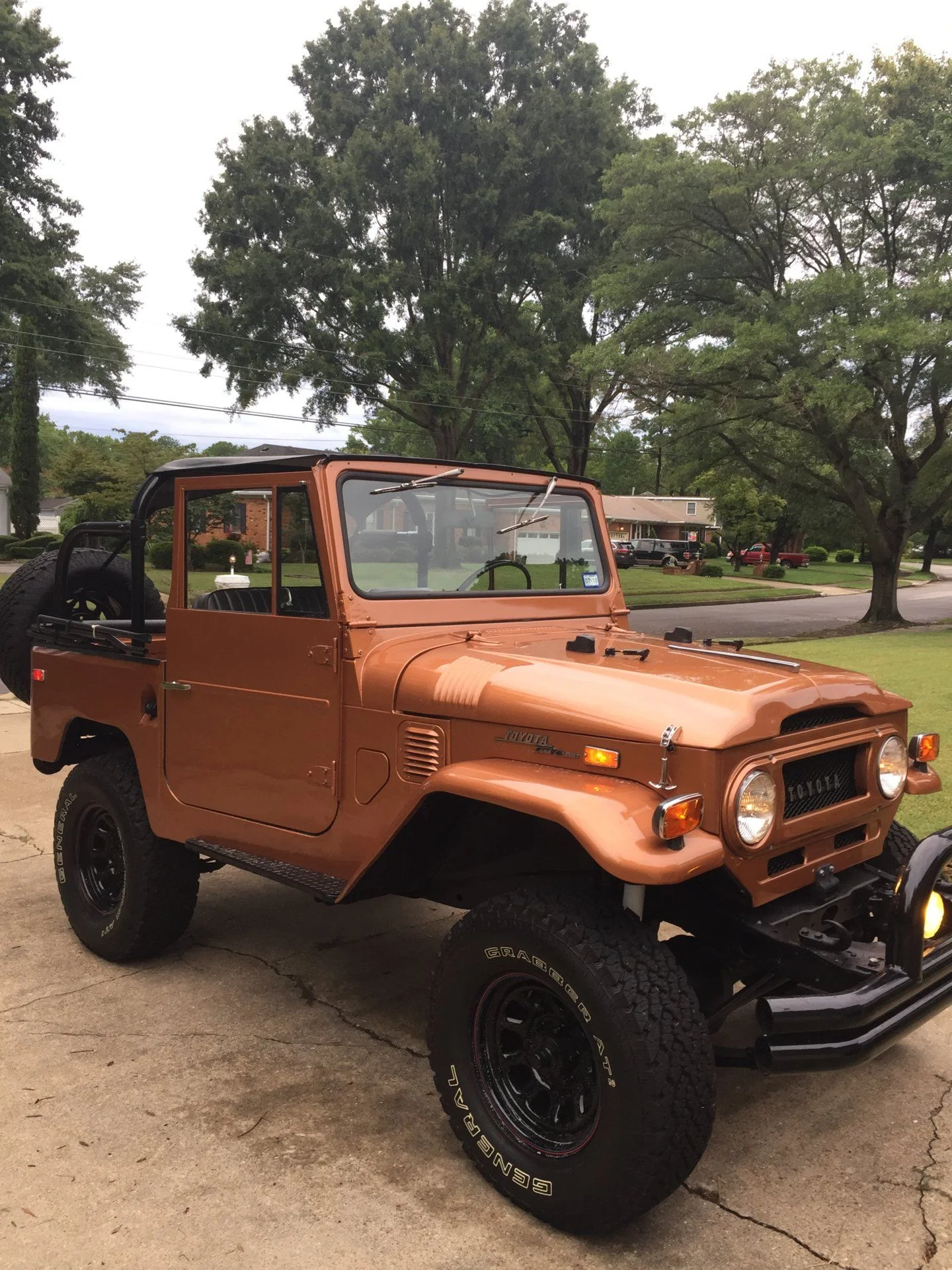

It was nice to get her out into the sun again...

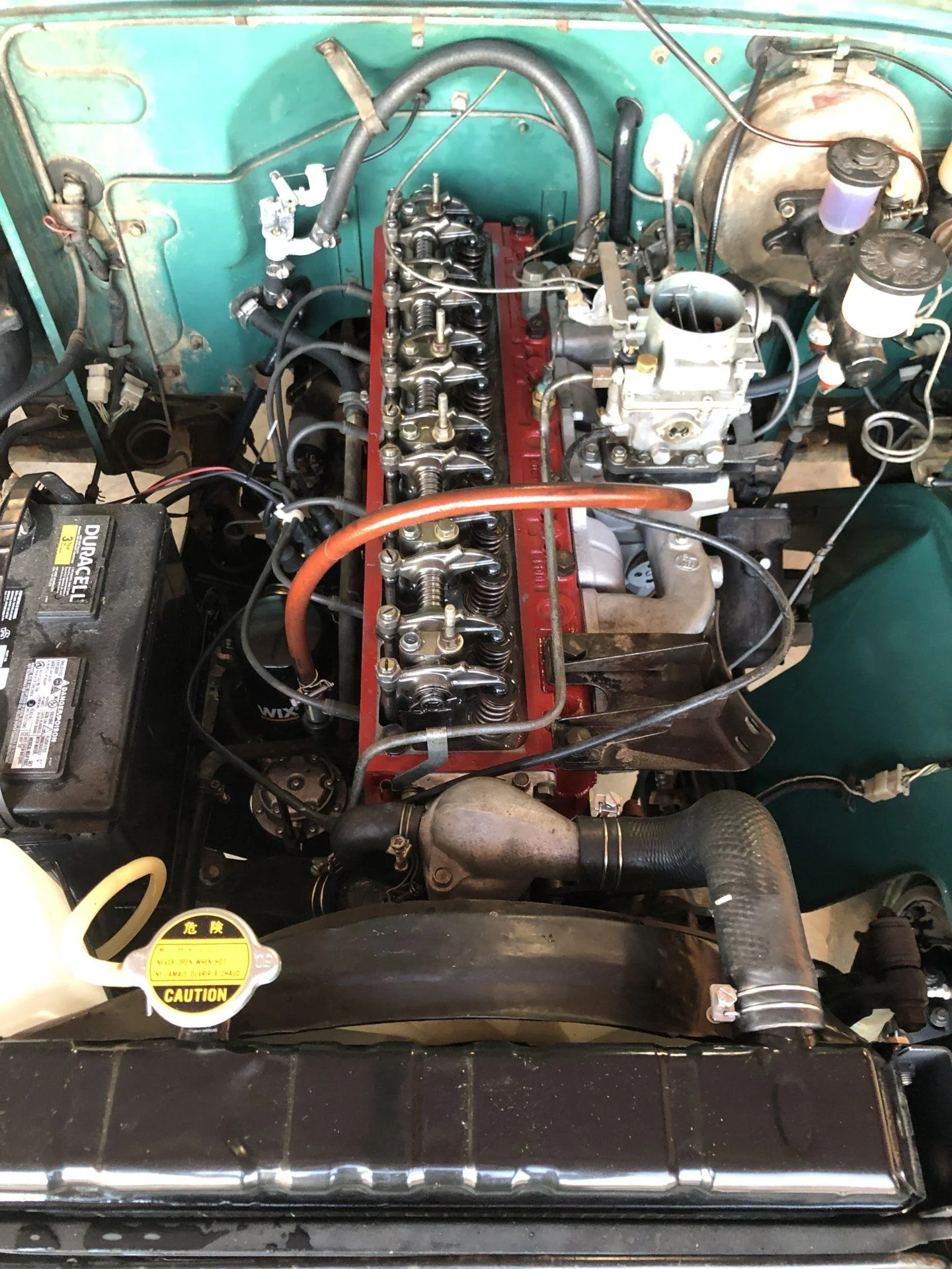

Hard to see in this picture but with the engine running we could see oil coming through all the rocker arms.

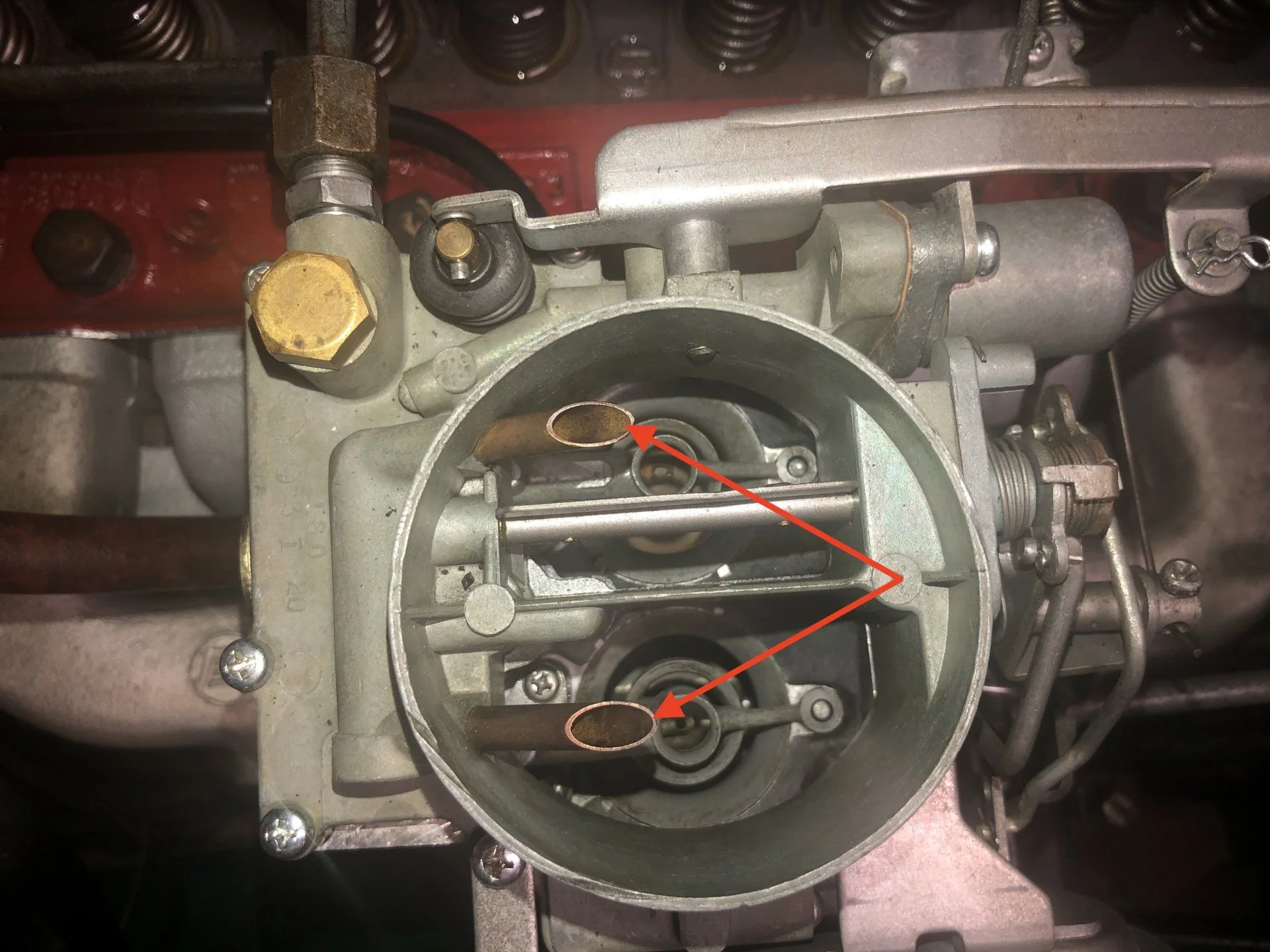

Reading your post again, I’m wondering about your description of the fuel level. If you see the level rising while your cranking, watch the two brass nozzles in the air horn above the fuel bowl. If you see gas in the vent nozzles, you’ve got dirt in the seat above the float and the needle is not closing properly (IOW it’s flooding)
Will do. I am fairly certain I know where on the carb you are referring to, but just to make sure, I should watch for any gas coming through the nozzles indicated by the arrows?

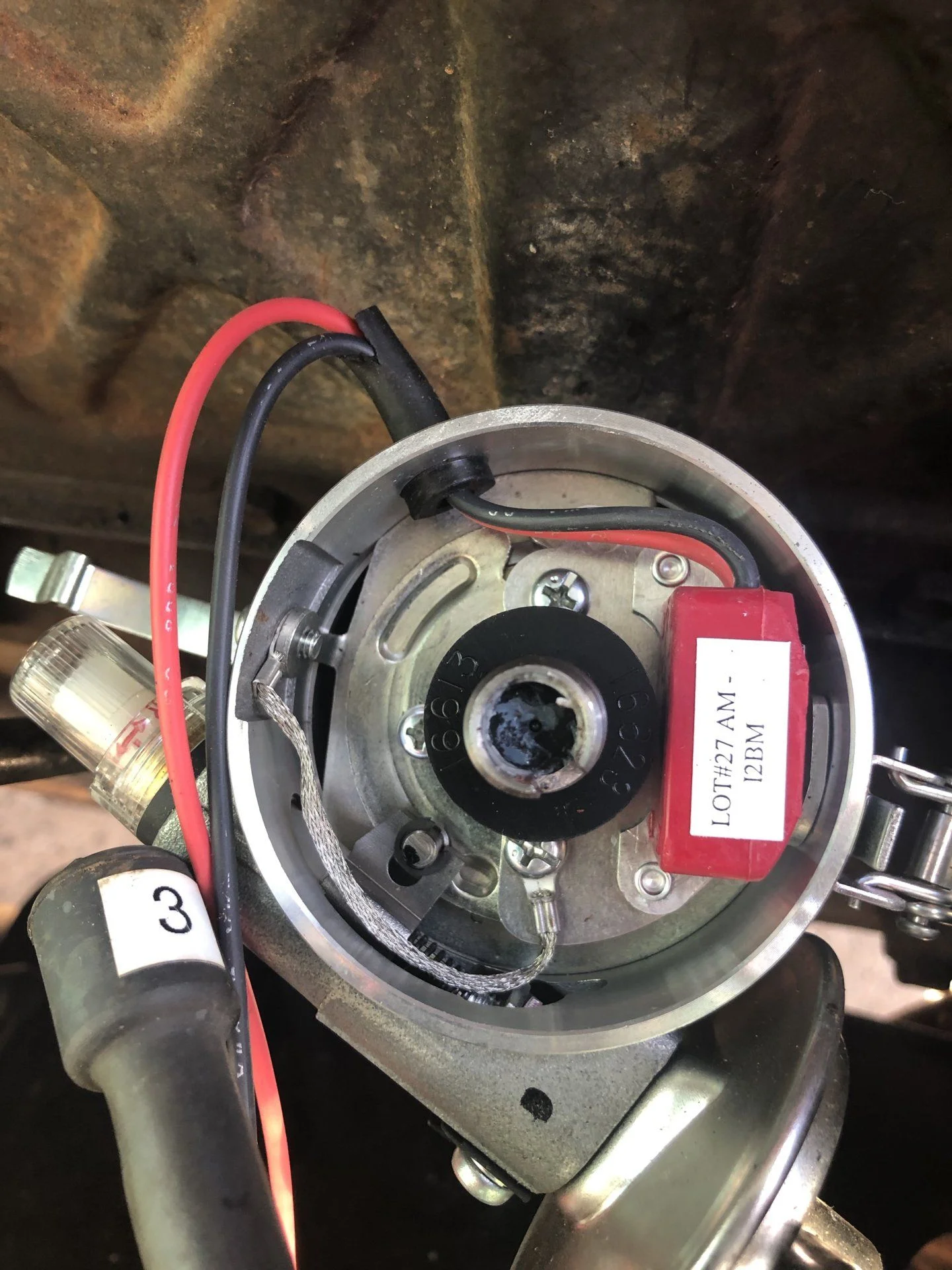

I took a picture of it before I took it out in case I want to put it back in. Of course, I am assuming I put installed it correctly. The picture might show differently.

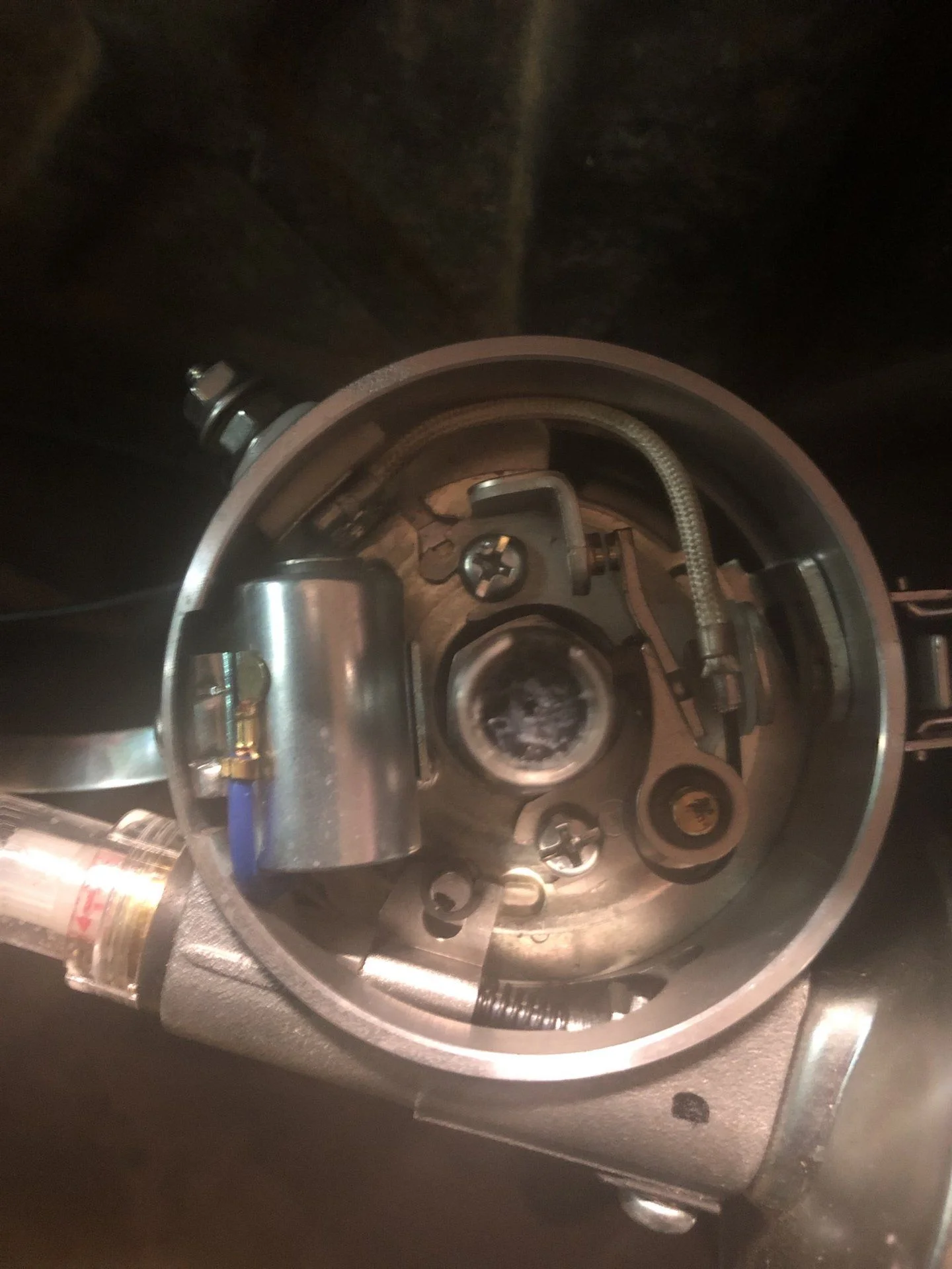

Here's the after, as it sits now. Adjusted the point gap to 0.018.
