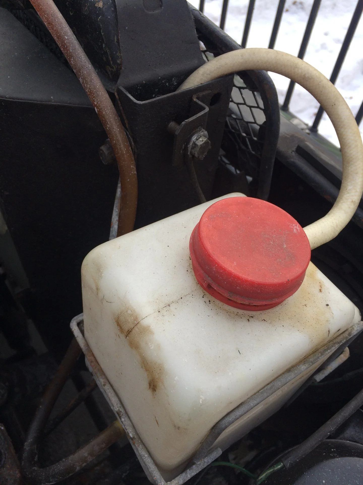

I have the same radiator overflow canister as you ... parts store special
I bent over the one tang to capture the front bolt ... much more stable using two mounting points

I did the exact same thing, one tab is bent forward to one of the bib bolts, and I welded up a little plate at an angle to catch another threaded hole under the bottle. Very stable.

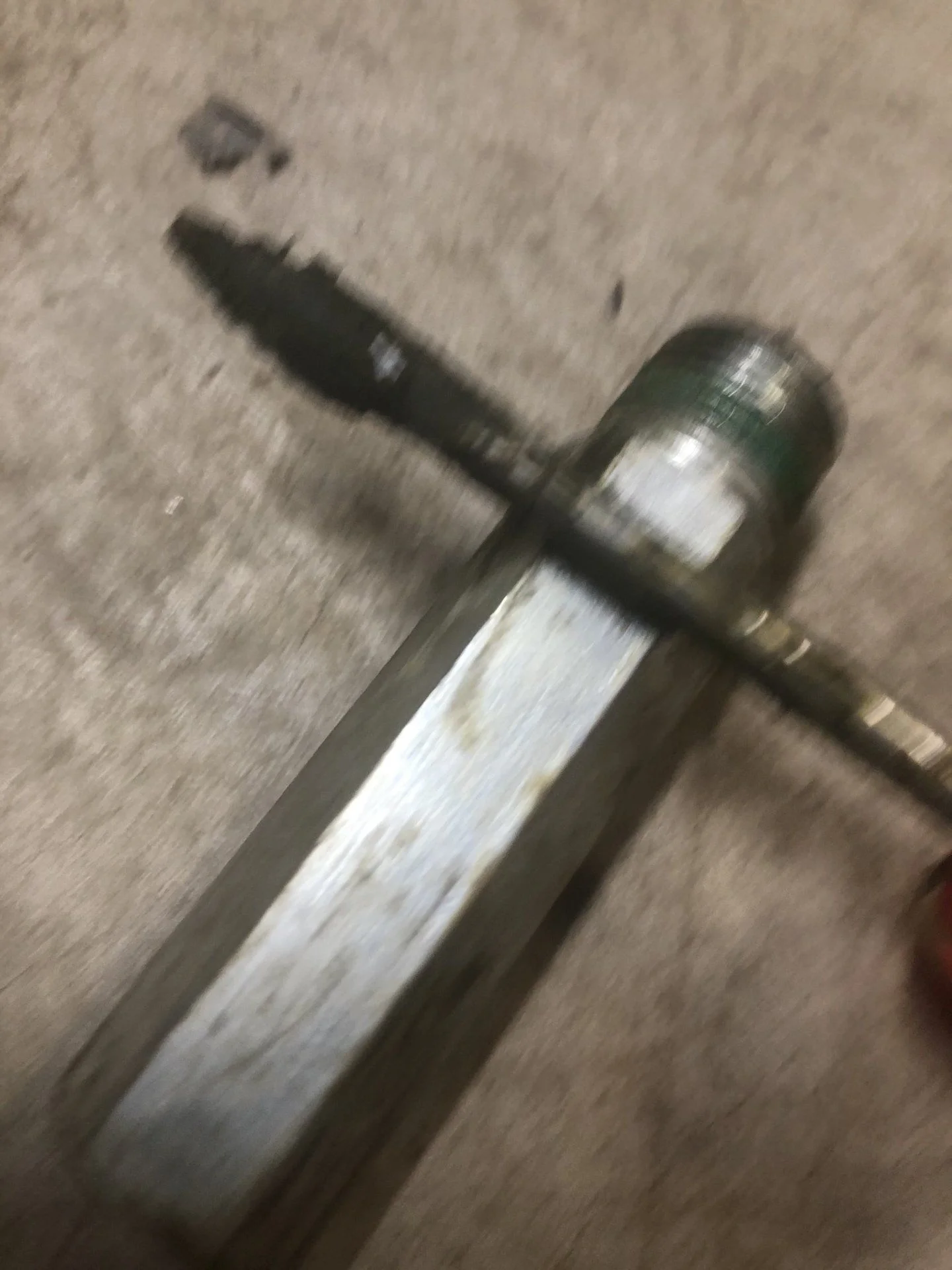

Moved onto the cooling system tonight in preparation for start-up. I ran into something I did not expect and I need ya'lls help.
I opened up the radiator plug on the petcock to drain any residual coolant that might have been sitting in there. Surprisingly, nothing came out. So I thought the radiator was empty. I poured a gallon of clean water through the radiator fill cap and still, nothing came out. I stuck a small screwdriver up there and it was full of grease.
Important to note that the radiator is new, OEM Toyota--I installed it shortly before I pulled the head off to have it rebuilt. It came with the petcock and plug that I installed. I would guess that the petcock was not filled with grease when I received it so the question is where did it come from? I did do a lot of washing of the water jackets while the head was off but I cannot imagine that there was grease like that in the jackets. I did leave the lower radiator hose connected while I was doing this. Did junk from the water jackets get flushed into the bottom of the radiator? Do I need to pull the radiator and have it serviced at a radiator shop?

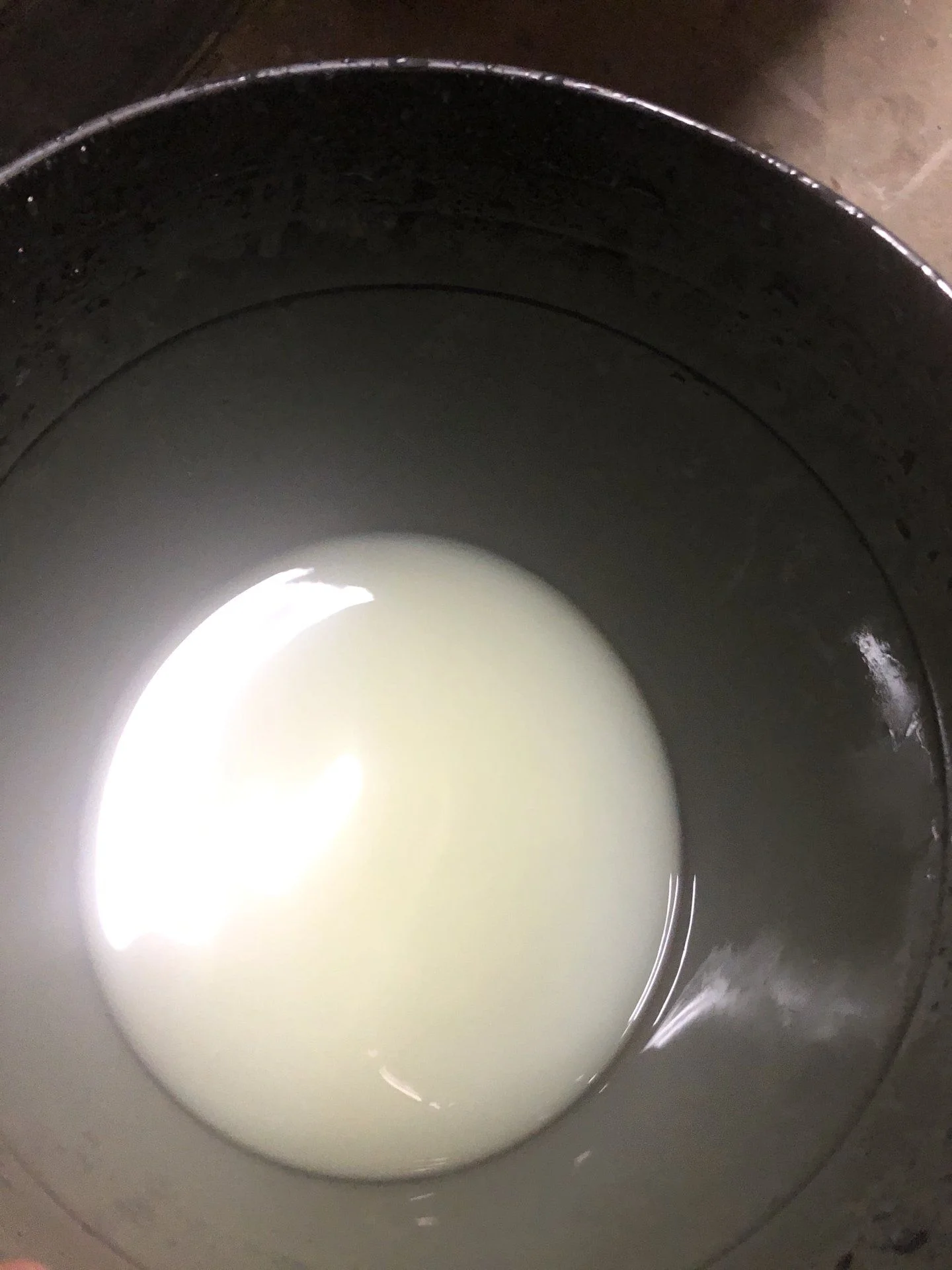

Clear water poured through the radiator fill came out cloudy at the bottom. Does this indicate anything to anybody in particular. I have included a couple of pictures below.
This was the grayish colored grease that came out of the petcock (picture makes it look black but it was gray). Sorry for the blurry picture.
This is the water after it runs through the radiator from the radiator fill to the petcock outlet.
