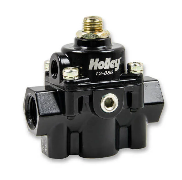

I have been researching, for some time now, EFI for Marion. I have read through several threads and the Sniper 2300 manual and one question that I have not found a definitive answer on is a pressure regulator. The Sniper has a pressure regulator built into the unit itself but I have seen members discuss a separate pressure regulator placed between the gas tank and the fuel inlet on the Sniper. The Sniper manual does not mention a separate one. A combination filter/pressure regulator by Wix seems to been one option discussed, the other is this one from Holley:
Any input on benefit/need for this is greatly appreciated (@wngrog @FJ60Cam).
Holley was including the GSL392 in their kits. (don't know about now). The 392 & the 394 are both well capable of 60 psi but the 392 delivers more GPM. The 394 delivers plenty of GPM. Most of what it pumps gets sent back to the tank anyway. I run the 394 without issue.

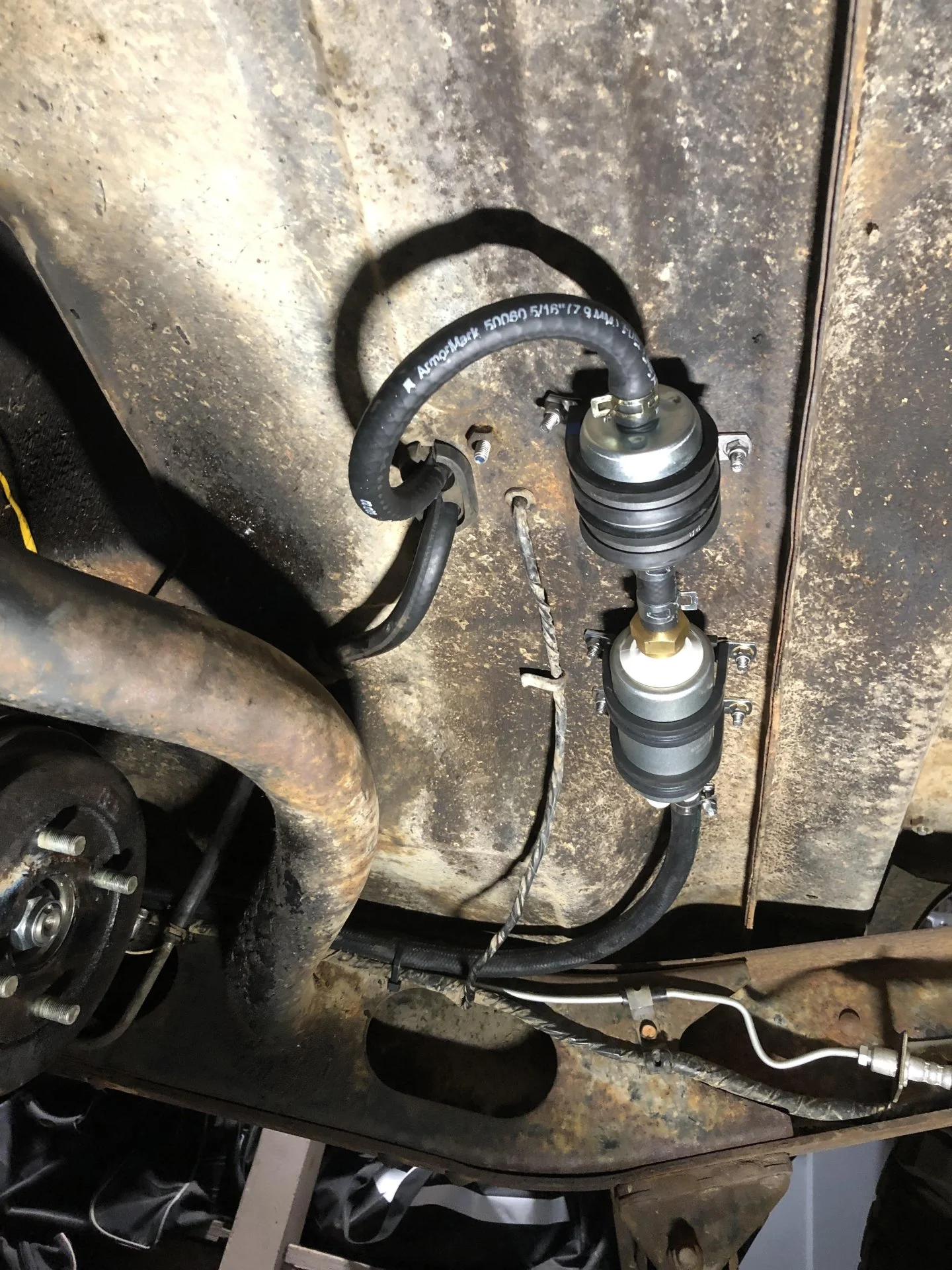

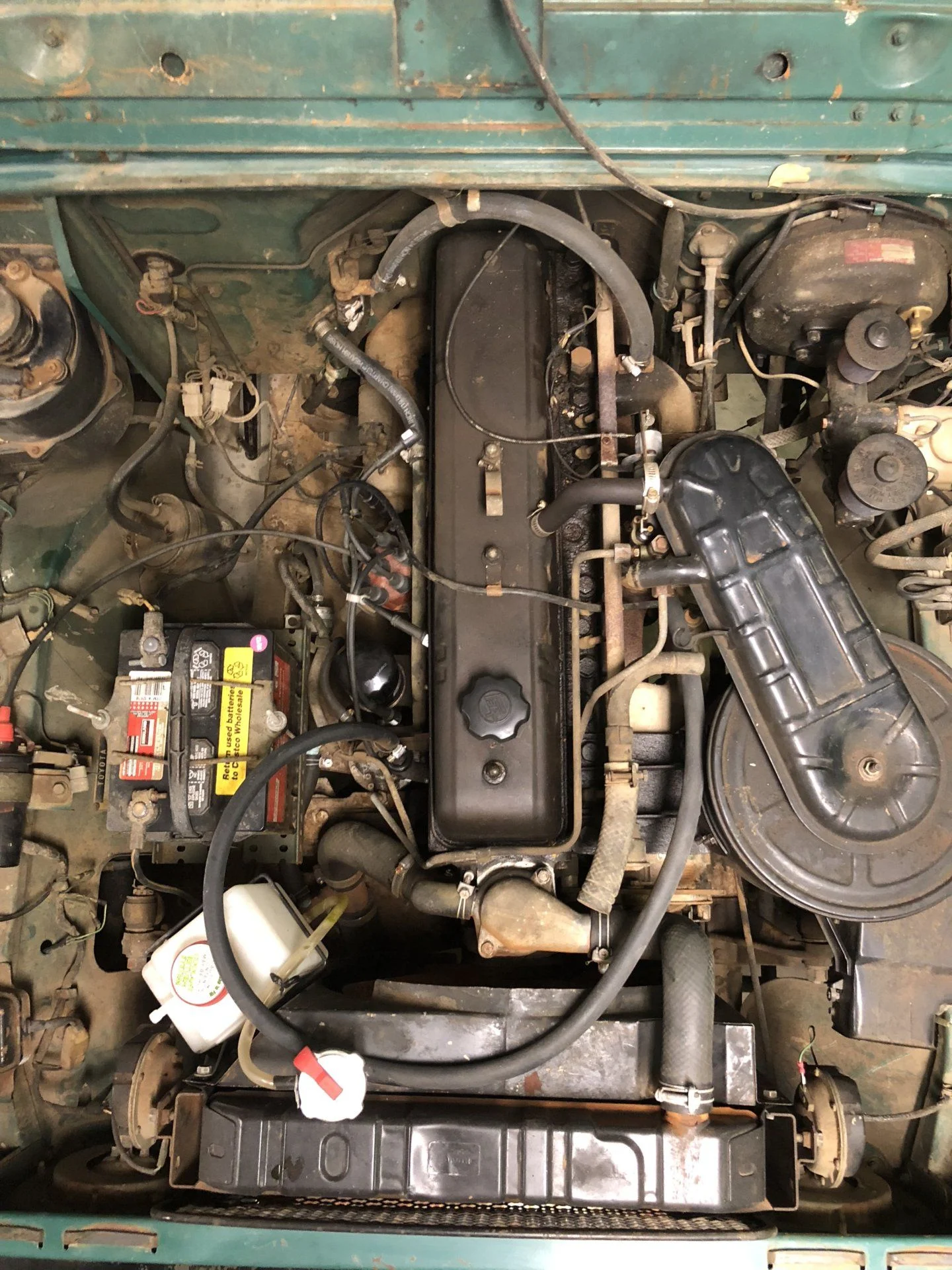

Where have others mounted their fuel pumps? I have the Sniper 2300 and mounted the pump under the body near where the passenger seat back would be. An EFI fuel pump sounds like a can of pissed off wasps and is really noticeable (even above a free flowing exhaust). I am looking for ways to quiet the pump without going full bore to install a in-tank option.
I’ve got my Walbro mounted on the frame rail. You can hear it at prime but once the engine is running it is silent.
Mounting the pump to the sheetmetal will give it the resonance of a snare drum. Move it to a rubber isolated bracket on the frame and I bet you would have better results with the noise.
The area to the right in the photo, above the brake line bracket is well protected. Make a "U" bend out of 5/16 fuel line, you could bring the line through the filter in its present spot, over to pump and reverse to the frame fuel line cleanly with the "U".
