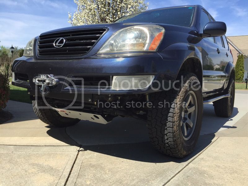

I'll get a complete side view in a bit. But here's an angle shot. It'll look real good once I get the tube bent and mounted. But even without it, it's not bad at all. The wife almost couldn't even notice :)
I might have missed it but what did you use to trim the plastic? I trimmed the rubber off of the rear mud flaps and found a razor blade knife worked like butter. I know cut off wheels and dremels tend to melt the plastic and not leave the best finish.
I used a cut off wheel, then just trimmed the melted edges with a razor knife. Real quick and easy.

Fantastic build. Are you getting any additional vibration at highway speeds with the trimmed front bumper?
Nope. The winch fairlead basically bolts the plastic to the frame. It's much more solid than it was stock.
I think I've just decided to trim bumpers and go with a hidden winch. It looks like you've basically solved the clearance problems that had me looking at bumpers.. that's pretty slick.
Yep - It provides the clearance, without adding any weight (other than the hidden winch, which added about 35 lbs, plus the winch. Plus, it still looks like a Lexus :). My plan is still to fab a tube bumper to run just under the cut line of the plastic, just to protect it from a drop on the rocks - or driving into a tree. I designed the mount to be able to bolt on a tube bumper. It just hasn't been a priority lately, so it's a future project.

What did you do with the fender liners / splash guards up front? Trimmed with the bumper or removed entirely?
Just trimmed with the bumper, then zip tied to pull them as far forward as possible.
