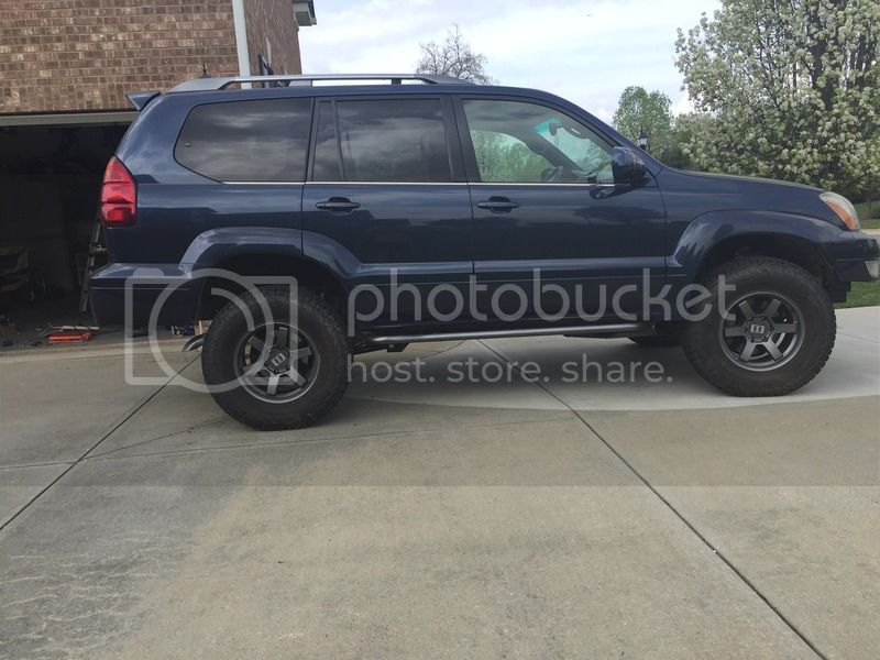

I had given them pics and dimensions a while back, so they could make the KDSS sliders. I just couldn't wait that long for the development. But they make very nice sliders. But also tells me they won't have a KDSS vehicle to design the skids for :/
Thanks for posting about the ARB skids - if they got tore up on Richland Rd or URE (aside maybe from Daniel), that is pretty sad and I'll stay away from them.
You're not too far from BuBuilt, he's up in the Lenoir area; and he's seemed willing to take in a vehicle to do a design for a product, maybe he can do some KDSS skids for ya?
It was indeed Richland Road that did the damage. I had Bud's on my Tacoma - definitely good stuff. But really wouldn't have the time to leave my truck with him for more than a few hours. I'd definitely prefer aluminum though. I don't want to weigh this truck down like I did the Tacoma. The ARB's would be ok if they were mounted better. But the way they made them, the vulnerable area has no stiffening behind it.

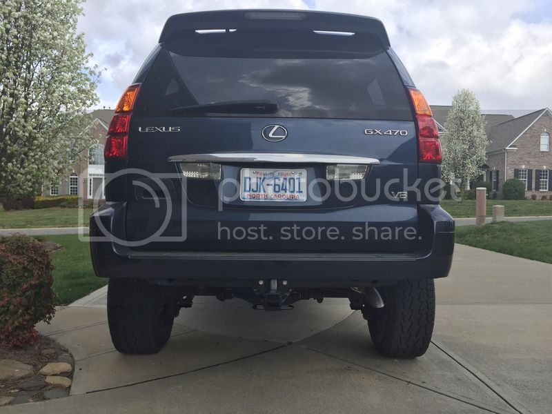

And the rear is cut. I figured out how I want to do the tube bumper around it, but that'll be a while.
Looks awesome. :clap:
Probably the easiest mod I've done so far. Cut it off with a grinding wheel in a matter of minutes :) Removing the low hanging hitch took the longest.
Are you going to reroute the exhaust to make it sit higher?
I might, but where it sits now is pretty much out of the way, even though the pics make it look like it's hanging out there. If I hit it where it is now, I'll have bigger problems :)
